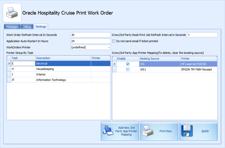

OHC Print Manager – This application manages the print jobs for Work Orders, Shore Excursion and Tickets.
OHC Board Card Print Manager – This application manages the Board Card Print jobs.
The usage of the application is controlled by the following parameters.
Table 1-1 Parameters used in Print Manager
PAR Group | PAR Name | PAR Value |
Fidelio Cruise |
HeartBeat Interval |
Default value: 60 |
General |
Do not send alert email if ticket is printed. Enable 3rd Party Kiosk Print Queue |
Default value: 0 |
Excursions |
Alert Email address for Web Service booking |
Default value: <empty> |
Figure 1-1 Print Manager Settings for Work Order
Log in to Print Manager program.
At the Settings tab, set the print job refresh interval seconds.
To disable the email notification once a ticket is printed, select the Do not send email if ticket printed check box.
Click the Add New 3rd Party App Printer Mapping button to enable a printer.
Select a printer for each type of booking source from the drop-down list.
Click Apply to save.
Restart the interface.

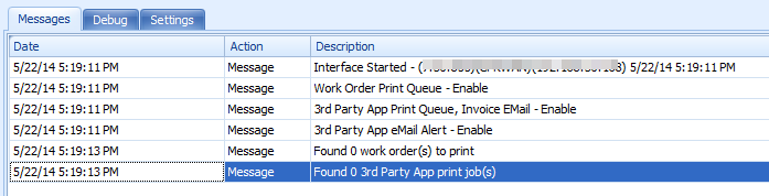

If the printer is set up successfully, the action task appears in the Messages tab.
Figure 1-2 Print Manager - Messages Tab

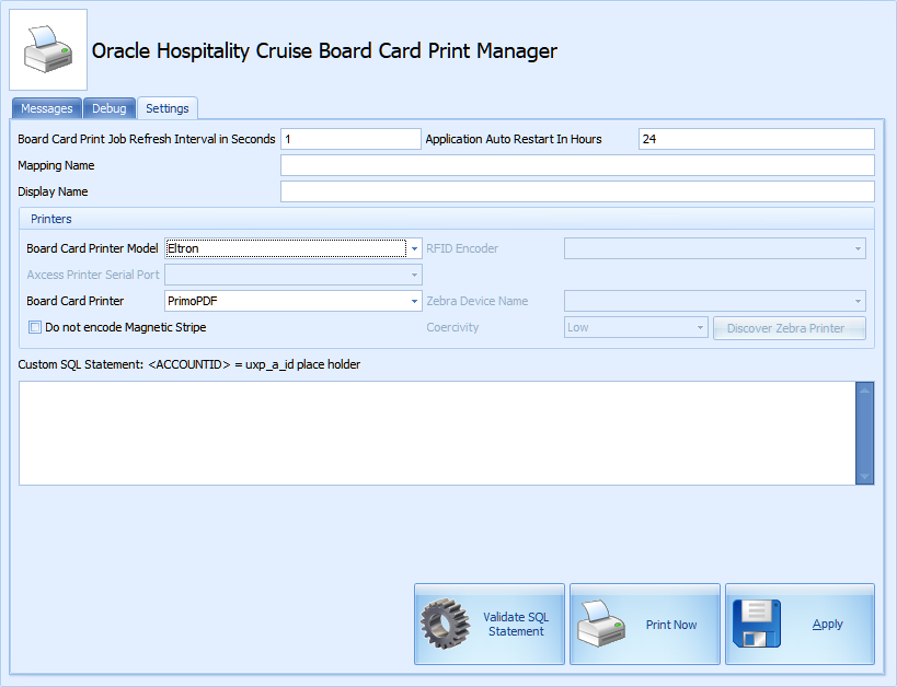

To print a board card, the OHC BoardCard Print Manager is used. This application works with Board Card printers only. It runs in the background and processes print job requests received during check-in.
In the Settings tab of the application, the default HeartBeat Internal value is set at 60 seconds. You can change this to meet your operational needs.
Log in to the OHC Board Card Print Manager application.
At the Settings tab, enter the Mapping Name and Display Name for the printer.
Set the print job refresh interval seconds.
Select the Board Card Printer Model and Board Card Printer from the drop-down list.
In the SQL statement section, leave the setting blank to print all card types.
If the printer is set up successfully, the number of active task appears in the Messages tab.
Figure 1-3 Print Manager Settings for Board Card Printing
[#Board Card Print Service.PARAM.Restart Interval=24#] [#Board Card Print Service.PARAM.Refresh Interval=1#] [#Fidelio Cruise.Hardware.RFIDEncoder=#] [#Fidelio Cruise.Printer.BoardCard=2#] [#Fidelio Cruise.Printer.Cards=PrimoPDF#] [#Fidelio Cruise.Hardware.Do not encode Magnetic Stripe=True#] [#Fidelio Cruise.Hardware.Card Reader Port=-1#]
