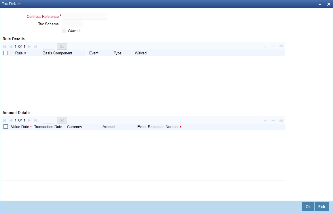

6.1.3 Tax Tab
The taxes and charges defined for the product default to the transaction. You can view the tax and charge details that apply on a transaction. In the ‘Teller Transaction Input’ screen choose the ‘Tax’ tab. The taxes and charges that apply to the transaction will be displayed. You can change the tax/charge amount calculated for the transaction. To change the charge/tax amount displayed, click the ‘Tax’ button in this screen.
While processing a transaction, you should indicate the following details.
Basis Amount
The transaction amount specified in the ‘Main’ tab is displayed here.
Total Charges
The sum of all charges applicable as per the linked product is displayed here.
Total Tax
The system computes the tax applicable on the transaction amount and displays it here.
Net Amount
The net transaction amount post deduction of applicable charges and tax is displayed here.
Charges/Tax Collection Account
Indicate the account from which you would like to collect the tax. Typically, this would be the account that you have designated as the Transaction Account. You may also choose the Offset Account or Transaction Account.
Click the ‘Tax’ or ‘Charge’ button to specify the collection account.

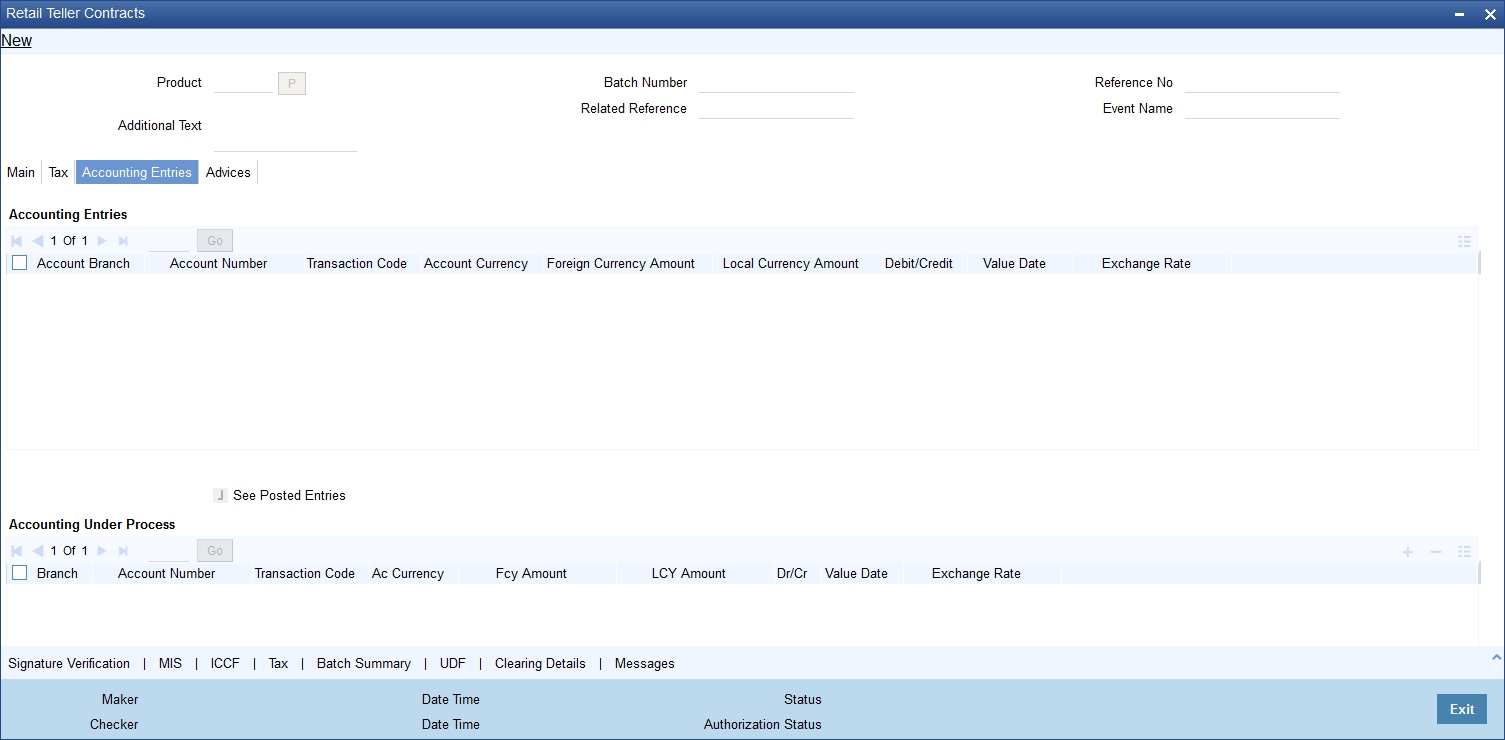

6.1.4 Accounting Entries Tab
You can view the accounting entries generated by the transaction that you are processing by clicking on the ‘Accounting Entries’ tab in the ‘Teller Transaction Input’ screen.
The following details are displayed here.
l Account Branch
l Account Number
l Transaction code
l Account Currency
l Foreign Currency Amount
l Local Currency Amount
l Debit/Credit
l Value Date
l Exchange Rate
l Contract Overrides
See Position Entries
Check this box to view currency position of the entries.
A list of all the system overrides displayed when the transaction was input can also be viewed.

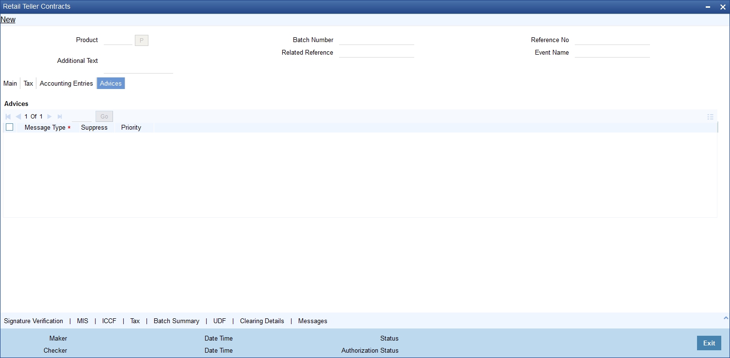

6.1.5 Advices Tab
You can print the advices specified for the product the transaction involves. You can view the advices specified for the product while processing a transaction by clicking on the ‘Advices’ tab in the teller input screen.
Here, you can opt to generate, or suppress, an advice that has been defined for the product the transaction involves. You can also prioritize advice generation according to your convenience.

6.1.9 Tax Button
Based on the tax maintenance at the product level, the tax details are defaulted for the contract. However, you can change them. Charges will be recovered from the charge or tax account specified in this screen. Click ‘Tax’ button and invoke the ‘Tax Details’ screen.
Refer the section titled ‘Specifying Tax Details’ in the chapter ‘Defining Attributes of a Teller Product’ in this User Manual for details about this screen.

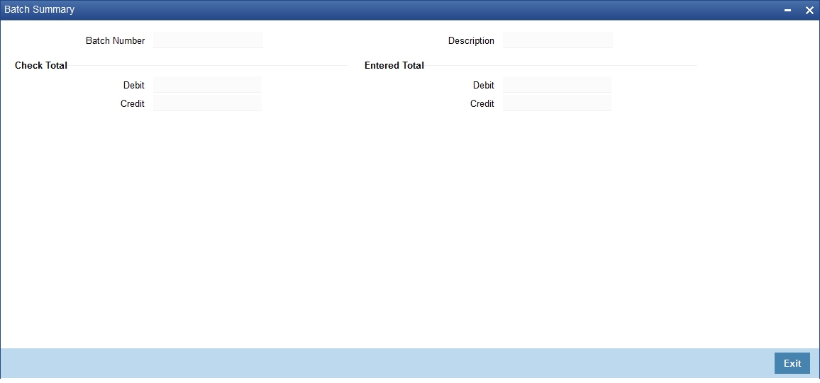

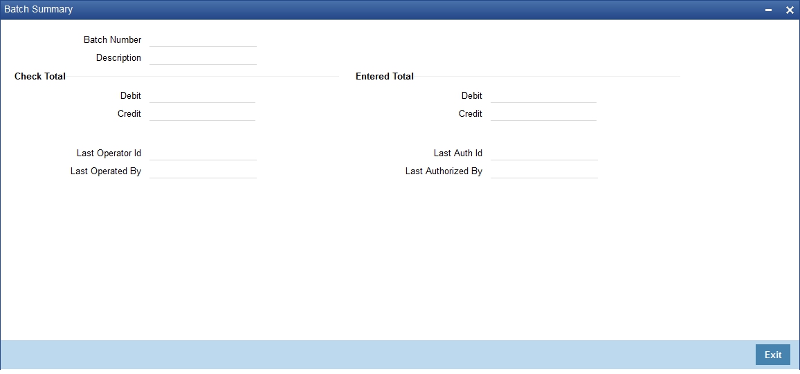

6.1.10 Batch Summary Button
Click ‘Batch Summary’ button and invoke the ‘Batch Summary’ screen. You can view the cheque and entry total pertaining to the batch.
You can view the following details here:
l Batch No
l Description
l Check Total Debit and Credit
l Last Operator Id
l Last Operated By
l Entry Total Debit and Credit
l Last Auth ID
l Last Authorised By

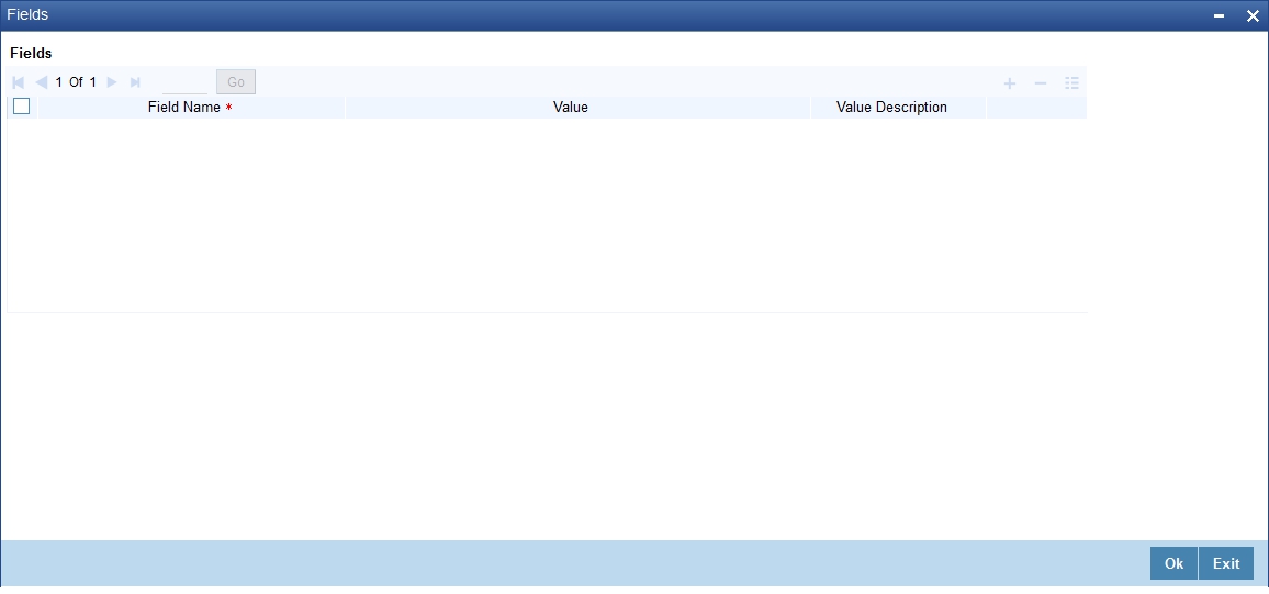

6.1.11 UDF Button
Click ‘UDF’ button and invoke the ‘Fields’ screen to specify values for user-defined fields.
Here you can capture the following details:
Field Name
The system displays all UDFs linked to the product.
Value
Specify a value for each UDF.

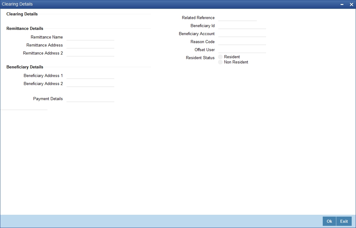

6.1.12 Clearing Details Button
Click ‘Clearing Details’ button and invoke the ‘Clearing Details’ screen to view clearing details for the transaction.
You can view the following details:
l Remittance Name
l Remittance Address 1 and 2
l Related Reference Number
l Beneficiary ID
l Beneficiary Account
l Reason Code
l Resident Status
l Beneficiary Address 1 and 2
l Payment Details

Print Button
Click the print button to print the advices that are generated. When you click the EXIT button the system displays a message if the advices are printed for the first time, click OK if the print is successful.
Note
When Duplicate Advice Tracker field is checked and you click the EXIT button on the ad­vice generation screen, the system displays a message “Print Successful?”. Click OK but­ton to confirm the successful printing. Every subsequent print of the advices will be    considered as duplicate advice. For more information on Duplicate Advice Tracker refer to section “Messaging Branch Parameters Maintenance” in the Core User Manual.
6.1.14 Saving and Authorizing Transaction
When you have entered all the details of a transaction you have to save the transaction in the system
To save a transaction, choose ‘Save’ from the Actions menu. The system checks whether the accounts mentioned in the ‘from’ and ‘to’ leg of the transaction belong to the same netting group or not. If they belong to the same netting group, the accounting entries will not be posted. Instead the transaction will be logged for the netting batch.
The system will automatically place an amount block on the debit account. However, for the credit account, the amount will be reflected only after the netting batch.
At the time of saving a Corporate Teller contract, the system will pass a certain information about the Corporate Teller contract to the FATCA accounts and obligations maintenance for the customer. This will be done if the beneficiary account’s customer has a reportable FATCA classification and if the Corporate Teller product used to book the contract is present in the FATCA Products, account class and Instruments maintenance.
If the Corporate Teller contract is closed or liquidated completely, then the corresponding row in FATCA accounts and obligations maintenance will be archived. If you delete the Corporate Teller contract before authorization, you should also delete the corresponding entry in FATCA accounts and obligations maintenance.
The system will update the transaction as an unauthorized transaction. The user ID of the teller who entered the transaction and the date and time at which the transaction was saved will be displayed at the bottom of the screen.
To authorize a transaction, select ‘Authorize’ icon from the Actions menu. On authorisation, the transaction will be made available for the netting batch if logged for netting batch.
Refer the section ‘Maintaining Netting Group’ in the chapter ‘Accounts for Inter-Branch Transactions’ in the Core Services User Manual for further details about netting.
Cross Validations
The system performs the following cross validations when you input a transaction. It ensures that:
l you have entered all the mandatory details in the appropriate fields
l the product related restrictions are not violated
l you have the Cash GL linked to the transaction currency and/or offset currency in case of cash based products
l the exchange rate variance conforms to that defined at the product level
Validations for a transaction
When you save a transaction the following validations will be carried out
l Transaction amount is within the Minimum and the Maximum specified in the Branch conditions Table
l Exchange rate conforms to the Variance limit defined
l Availability of funds in the specified accounts
l Teller limit verification
l Override incase the value date is back date or future dated
Authorisation Validations
You cannot authorise a transaction from the ‘Teller Transaction Input’ screen in the following cases:
l the contract has multilevel of authorization pending, the same will be done using the ‘Multilevel Authorization Detailed’ screen
l the level of authorization is greater than or equal to ‘N’
l  the ‘Nth’ or the final level of the users authorisation limit is less than the difference between amount financed and sum of the limits of all the users involved in authorizing a transaction, this case holds good when the ‘Cumulative’ field is checked in the ‘Product Transaction Limits Maintenance’ screen
l the transaction amount is greater than the authoriser’s authorisation limit if the ‘Cumulative’ field is unchecked in the ‘Product Transaction Limits Maintenance’ screen

Changing the Check Total
On occasion, you may not be able to close a batch because you entered an erroneous Check Total while opening the batch. In such a case, you can correct the check total in the Batch Summary screen.
To correct the check total, invoke the ‘Batch Summary’ screen from the ‘Teller Transaction Input’ screen. In the Check Total field in this screen you can enter the correct debit and credit check totals for the batch. The total of the debit and credit entries that you have posted in the batch will be displayed in the Entry Total field.
You can correct the check total values in the Check Total field and update them in the system. You may or may not opt to use the changed values. If you opt not to use the original Check Total values the system will use the original values to tally the actual entries that you post to the batch.

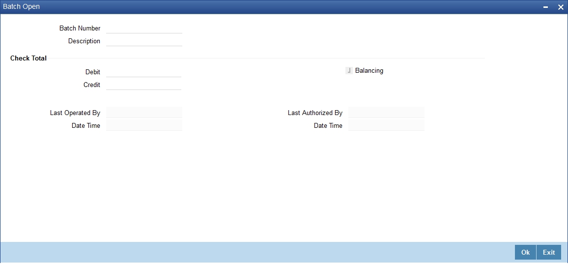

6.2.1 Closing a Batch
Once you complete operations for the day you can ‘close’ the batch that you opened before commencing teller operations. You cannot post further transactions to a batch that is closed. You have to reopen a closed batch to post transactions.
You can close a batch when you:
l complete operations for the day
l complete operations of a particular type (for instance, entering journal transactions) and proceed to other operations (for instance, selling travelers cheques)
Normally, you can close a batch by choosing the close icon in the Toolbar. However, in case of a General Protection Fault, you can close a batch using the Batch Closure screen.
Please refer to the chapter ‘Beginning and end-of-day operations in this User Manual for further details.
6.2.2 Reopening a Batch
The following example illustrates the concept of reopening a batch.
How to reopen a batch
When in the Batch Opening screen click on reopen icon on the Toolbar or choose Reopen in the Actions Menu to reopen a closed batch.
When you attempt to reopen a batch, the system ensures that you are the user who originally opened the batch. You cannot reopen a batch that was opened by another user. The System Administrator has to reassign the batch to you, before you can use it.
Note
You cannot reopen a batch that is in use.
6.2.3 Deleting a Batch
If you want to delete all the transactions that you posted to a batch you can opt to delete the batch.
You can delete a batch under the following conditions
l if you are original user of the batch
l if all transactions posted to the batch are yet to be authorized
l if the batch is not in use currently
How to delete a batch
Open the ‘Batch Browser’ screen. Navigate to the batch that you want to delete. Choose delete icon on the Toolbar or choose Delete from the Actions menu. All the transactions posted to the batch will be deleted
Remember that you can only delete a batch if all the transactions posted to the batch are unauthorized.
6.2.4 Balancing Teller Till
At the end of the day, when you complete all operations that involve the till, you must balance it. If you do not balance a till, you cannot proceed with the end-of-day operations. To balance a till is to ensure that the cash that is left in the till is the right amount. In other words, ‘Till’ balancing involves checking the physical balance in the Till (actual balance) against the balance in the Till according to the system.
Refer the chapter ‘Beginning and end-of-day operations’ in this User Manual for further details.

6.3.4 Fields Button
Click ‘Fields’ button and invoke the ‘Fields’ screen to specify values for user-defined fields.
Field Name
Value

Batch Number
Specify the batch number.
Description
Enter a brief description about batch.
Check Total
Debit
Enter the total debit amount of the journal transaction.
Credit
Enter the total credit amount of the journal transaction.
Balancing
Check this box to indicate whether the total debit amount and total credit amount has to be balanced.
Last Operated By
The system displays the name of the person who last operated the batch.
Last Authorized By
The system displays the name of the person who last authorized the batch.
Date Time
The system displays the date and time of the batch.
Date Time
The system displays the authorized date and time.

6.5.2 Batch Summary Button
Click ‘Batch Summary’ button on ‘Journal Entry input’ screen to invoke the ‘Batch summary’ screen.
You can specify the following details:
Batch Number
Description
The system displays the description for the selected batch number.
Check Total
The system displays the total debit and credit transaction details.
Entered Total
The system displays the total entered debit and credit transaction details.
