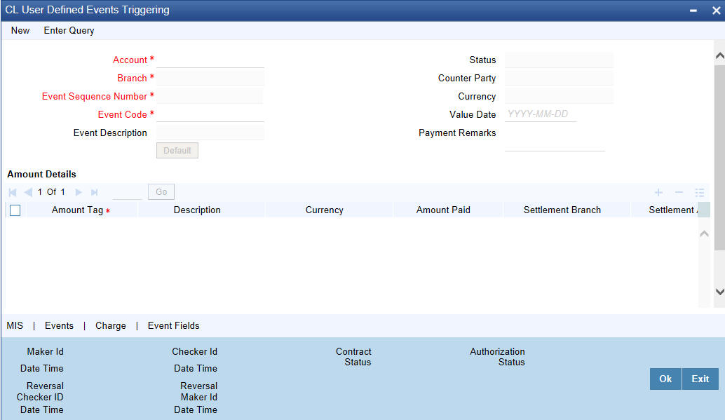

l Section 9.9, "Minimum Amount Due Batch Processing"
l Section 9.10, "EMI Change Batch (EMIC) Processing"
l Section 9.11, "User Defined Events Trigger for CL Accounts"

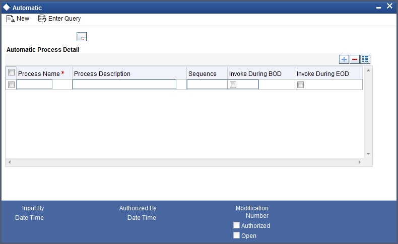

9.1 Configuring CL Batch Processes
You have the facility to configure the batch processes to be executed either at EOD or BOD or both, as per the bank’s requirement. This is achieved through the ‘Automatic Process Definition’ screen. You can invoke this screen by typing ‘CLDTPROC’ in the field at the top right corner of the Application tool bar and clicking on the adjoining arrow button.
In this screen, you can amend the order of the various operations in the CL batch and choose to trigger them at EOD or BOD or both.
The default configuration is given below:
Batch Operation
BOD/EOD
Forward Init of Loan Accounts
BOD
Calculation
EOD/BOD
Accruals
EOD/BOD
Minimum Amount Due
BOD
Auto Liquidations
EOD/BOD
Auto Disbursements
BOD
Rate Revisions
BOD
UDE Cascade
EOD
Maturity processing – Rollovers , Auto Closures
BOD/EOD
Automatic Status Change Processing
BOD
FEES
BOD
INTP (Interest Posting)
BOD
Billing &  Payment Notices
BOD
Statements generation
EOD
Penalty Computation
BOD
Forward VAMIs
BOD
Revaluation
EOD
Readjustment
EOD
These batch processes are factory shipped for your bank. Note that you need to set the ‘UDBATEVT’ batch as a predecessor to the CL batch ‘CLDBATCH’.
Defining Batch Processes

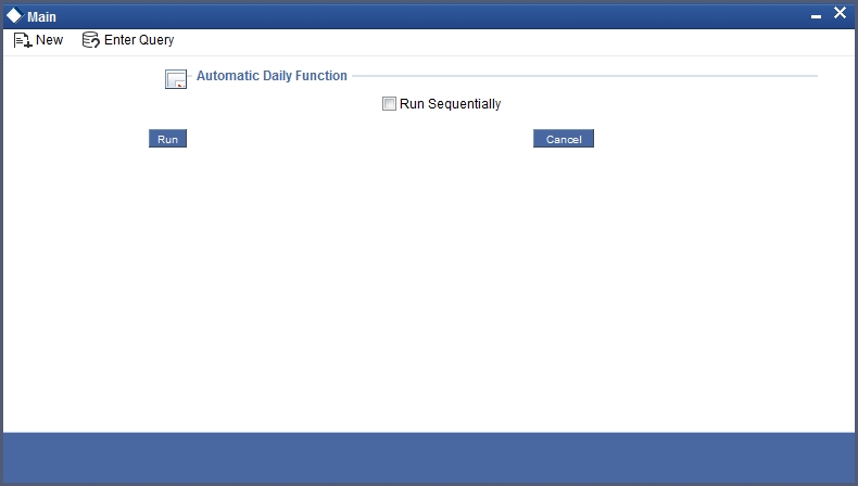

9.2 Initiating the Batch Process
If you have opted to trigger the CL batch programs at EOD, the same will be executed as part of the ‘End of Cycle Operations’ after marking the ‘EOTI’ for the day. If the trigger is maintained as ‘BOD’, the programs will be executed before the start of ‘Transaction Input’. However, the programs will be triggered both at EOD and BOD if you opt to trigger it at both the instances.
You also have the option to execute the batch programs through the ‘CL Batch’ screen. You can also invoke this screen by typing ‘CLDBATCH’ in the field at the top right corner of the Application tool bar and clicking on the adjoining arrow button
Run Sequentially
Check this box to opt to execute the processes as per the sequence maintained in the ‘Automatic Process Definition’ screen.
Click ‘Run’ button to run the batch process. Click ‘Cancel’ button to cancel the batch execution.

9.11.1 Triggering User Defined Events
You can use the ‘CL User Defined Events Triggering’ screen to manually trigger the user defined events for CL accounts. You can invoke this screen by typing ‘UDDCLETR’ in the field at the top right corner of the Application tool bar and clicking on the adjoining arrow button.
Here you need to specify the following details:
Account Number
Specify the account for which you want to trigger the user defined event. The adjoining option list displays all valid account numbers available in the system. You can select the appropriate one.
Branch Code
The system displays the code of the branch where the account resides.
Click ‘Default’ button. The system fetches values for the following fields based on the selected contract and displays them:
l Counter Party
l Currency
l Status
Event Sequence Number
The system displays the event sequence number.
Event Code
Specify the event that needs to be triggered for the selected account. The adjoining option list displays all events linked to the account. You can select the appropriate one.
A brief description of the event is displayed below.
Value Date
If the value date derivation rule has been maintained for the event code, the system will calculate the value date and display it here. However, you can change it.
Payment Remarks
Specify remarks pertaining to payment on the account.
Amount Details
Specify the following details.
Amount Tag
The amount tag is displayed based on the product-level maintenance of the specified account.
Description
The system displays a brief description of the amount tag.
Currency
If a derivation rule has been maintained for the event code, the system will derive the currency as per the rule and display it here. However, you can change it.
Amount Paid
If a derivation rule has been maintained for the event code, the system will derive the amount as per the rule and display it here.
Settlement Branch
Specify the branch where the settlement account resides. The adjoining option list displays all valid branch codes maintained in the system. You can select the appropriate one.  Alternatively, if you have specified the settlement account, the system will display the corresponding branch code here.
Settlement Account
Specify the account that should be debited or credited. The adjoining option list displays all valid accounts maintained in the system. If you have specified the settlement branch, the option list will display all accounts available in that branch. You can select the appropriate one.

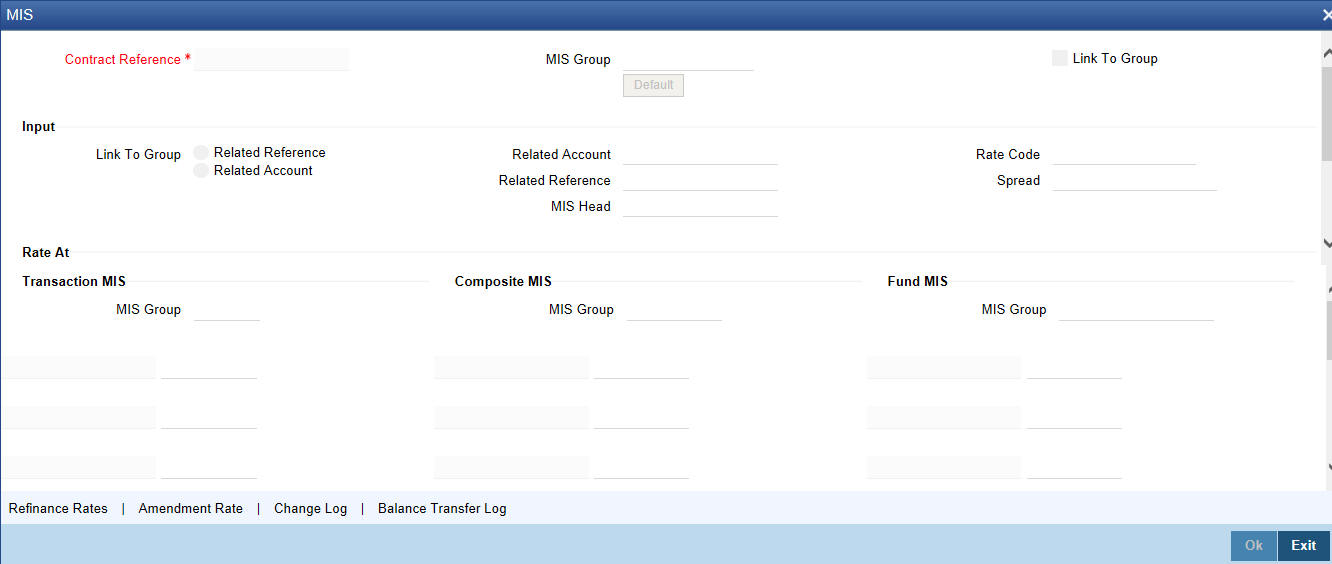

9.11.2 MIS Button
Click ‘MIS’ button the screen and invoke the ‘MIS’ screen.
You can view the following details:
l Contract Reference
l MIS Group
l Link to Group
l Input preference - Related reference/Related Account
l Related Account Number
l Related Reference Number
l MIS Head
l Floating Rate Code
l Floating Rate Spread
l Rate Type
l Rate at Pool Code/Contract Level
l Interest method
l Pool Code
l Reference Rate
l Cost Codes
You can view Transaction MIS, Composite MIS and Fund MIS details in this screen.

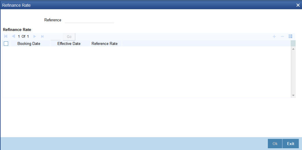

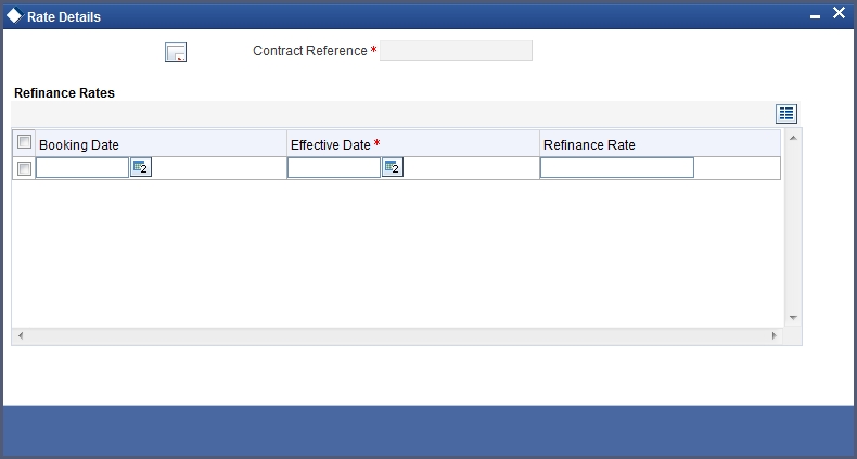

9.11.3 Rate Button
Click ‘Refinance Rate’ button on the ‘MIS’ screen and invoke the ‘Rate Details’ screen.
Here you can view the following details:
l Contract Reference Number
l Booking Rate
l Effective Date
l Refinance Rate

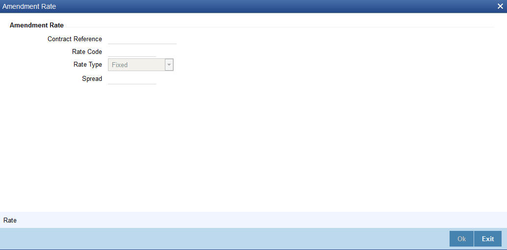

9.11.3.1 Amendment Rate Button
Click ‘Amendment Rate’ button and invoke the ‘Rate Details’ screen.
l Rate Type
l Rate Code
l Spread
9.11.3.2 Rate Button
Click ‘Rate’ button on the ‘Rate Details’ screen and invoke the ‘Rate Details’ screen.
l Booking Rate
l Effective Date
l Refinance Rate

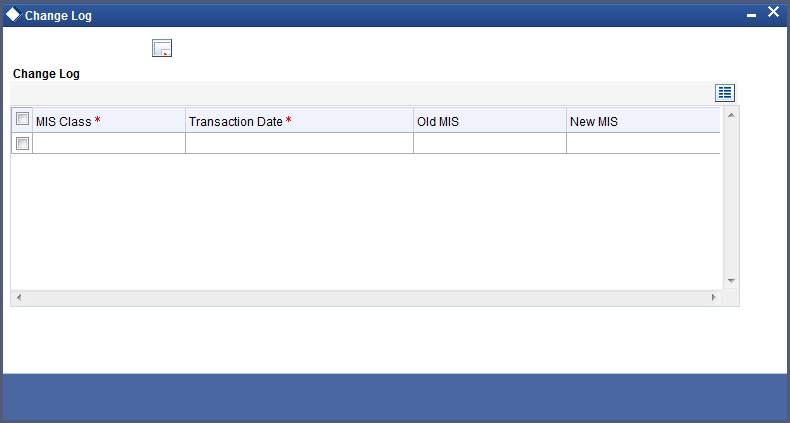

9.11.3.3 Change Log Button
Click ‘Change Log’ button on the ‘MIS’ screen and invoke the ‘Change Log’ screen.
If MIS reclassification occurs, through changing the MIS codes for transaction or composite classes, the System stores the changes made, in a Contract MIS Change Log. The following details are stored in the Contract MIS Change Log for the contract in respect of which the MIS reclassification occurred:
l MIS Class that was changed
l Date on which the change was made.
l The old code for the changed MIS Class (this information is stored only for the first amendment during a day)
l The new MIS code for the changed MIS class.

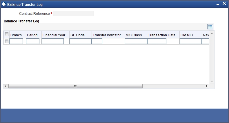

9.11.3.4 Viewing Balance Transfer Log
Click ‘Balance Transfer Log’ button on the ‘MIS’ screen and invoke the ‘Balance Transfer Log’ screen.
When an MIS reclassification occurs in respect of a the account, the balances in a GL associated with the old MIS code in each case are transferred to the GL for the new MIS code, if the option of transferring MIS balances upon reclassification has been set in the ‘Chart of Accounts’ screen for the GL.
l Branch
l Period
l Financial year
l Transfer Indicator
l MIS Class
l Transaction Date
l Old MIS
l New MIS
l Currency
l Amount
l Exchange Rate

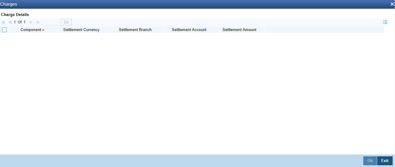

9.11.4 Charge Button
Click ‘Charge’ button on the ‘CL User Defined Events Triggering’ screen and invoke the ‘Charges’ screen.
l Component Name
l Settlement Currency
l Settlement Branch
l Settlement Account
l Settlement Amount

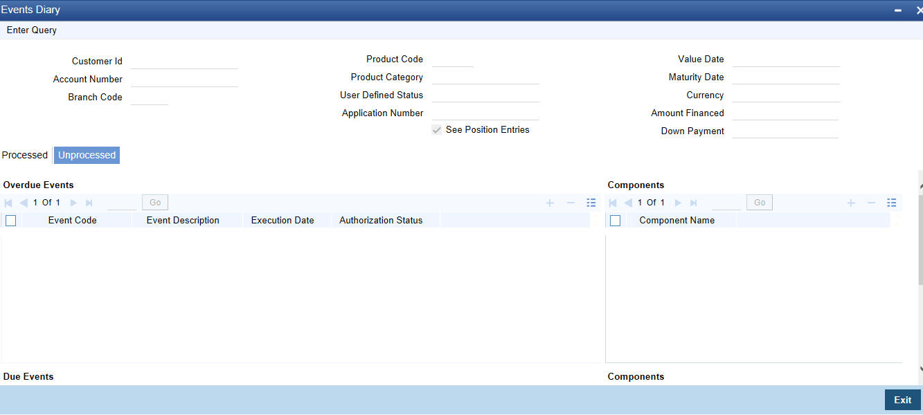

9.11.5 Events Button
Click ‘Events’ button on the ‘CL User Defined Events Triggering’ screen and invoke the ‘Events Diary’ screen.

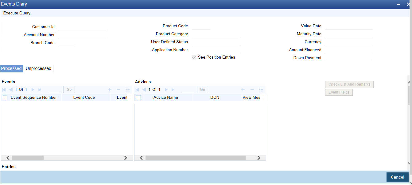

9.11.5.1 Unprocessed Tab
Click this tab to view the unprocessed event details.
Refer the section ‘Events Diary’ in the chapter titled ‘Account Creation’ in this User Manual for details about the ‘Events Diary’ screen.

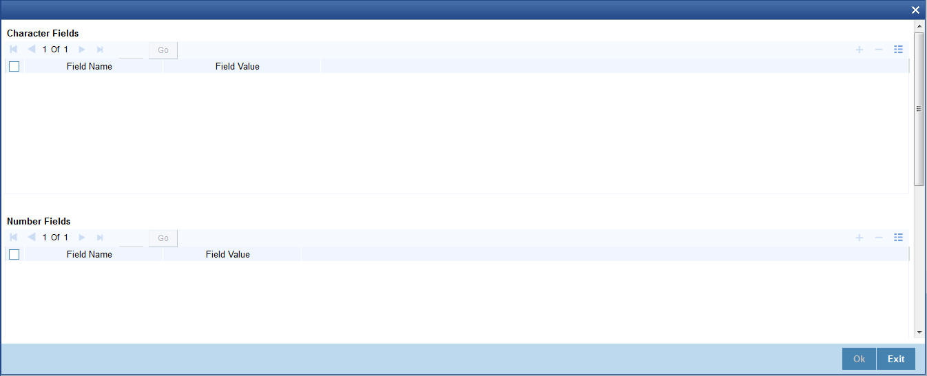

9.11.6 Event Fields Button
Click ‘Event Fields’ button on the ‘CL User Defined Events Triggering’ screen and invoke the ‘Fields’ screen.
Here you can view the UDFs and their values linked to the account.

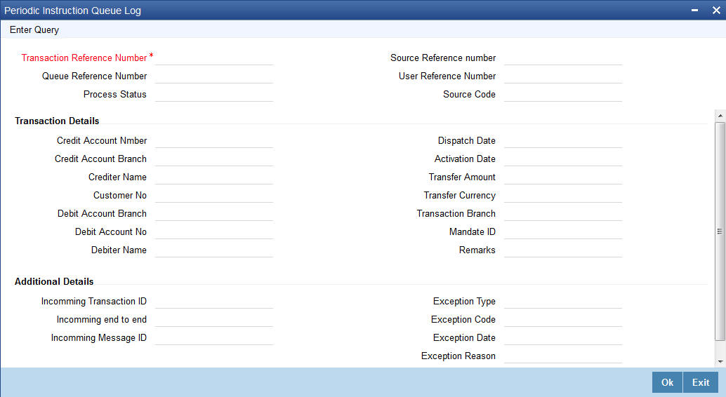

9.16 Periodic Instruction Queue Log
You can view the ‘Periodic Instruction Queue Log’ by typing ‘CLDPIQUE’ in the top right corner of the Application toolbar and clicking adjoining arrow button.
Transaction Reference Number
Specify the transaction reference number.
Queue Reference Number
Specify the queue reference number.
Click ‘Execute Query’ to view the following details:
l Process Status
l Source Reference number
l User Reference Number
l Source Code
Transaction Details
l Credit Account Number
l Credit Account Branch
l Creditor Name
l Customer No
l Debit Account Branch
l Debit Account No
l Debtor Name
l Dispatch Date
l Activation Date
l Transfer Amount
l Transfer Currency
l Transaction Branch
l Mandate ID
l Remarks
Additional Details
l Incoming Transaction ID
l Incoming end to end
l Incoming Message ID
l Exception Type
l Exception Code
l Exception Date
l Exception Reason
