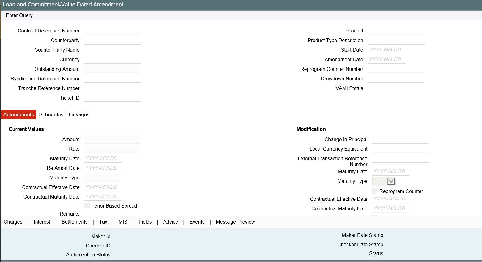

This chapter contains the following section:
Any change to the terms of a loan, which affects its financial details and the accounting entries, can be made through the Value Dated Amendment function of Oracle Lending. Through this function you can make changes to authorized loans on any day before the Maturity Date of the loan.
The changes to the terms of a loan, notified through this function, take effect on a date referred to as the “Value Date”. That is why the changes brought about by this function are called Value Dated Amendment.
A Value Date could be:
Using the Value Dated Amendment function, you can make changes to the various components of a loan such as:
When you make a value dated amendment, only the accrual entries are passed by the Value Dated Amendment function. All the other accounting entries are passed by the Automatic Daily function.
If the value date is a date in the past, it should not be beyond the last payment date for any component.
You should ensure that a contract - on which you plan to make backdated changes - does not have amortized schedules.
In addition, a value date in the future cannot be beyond the Maturity Date of the loan. If it has to be beyond the Maturity Date of the loan, you have to first postpone the Maturity Date of the loan so that your proposed future value date falls before the new maturity date. Only after this change is authorized can you fix a value date in the future for the loan.
The system defaults to today’s date.
Note
If a contract is pending for authorization in any screen and if you try to unlock in OLDVAMND to do changes, then an error message “Unauthorized amendments exist for contract in ‘function id’ “appears.
Note
You can do financial amendments in this screen, only for non-bearing products when 'Allow schedules for discounted' check box is selected at the contract level.You can invoke the ‘Loan and Commitment - Value Dated Amendment’ screen by typing ‘OLDVAMND’ in the field at the top right corner of the Application tool bar and clicking the adjoining arrow button.
Enter the reference number of the loan to which you want to make amendments. The main details of the loan is displayed in the screen.
Note
The ‘Ticket Id’ field is displayed only when the individual SLT trades get handed off to LS and then to OL (Origination). If the setup is to consolidate all the trades across the tickets for a CUSIP, the ticket Id is not displayed for any trade.
You can make an additional disbursement through the Value Dated Amendment function.
If you increase the principal amount, the increased amount is put into the last principal payment schedule. You, then, have to authorize the schedule, which the system has redefined to maturity. Only then you can define new schedules, as per your requirement, through the Contract Schedules screen.
For a loan, you can increase the principal through the Value Dated Amendment function. If you want to decrease the principal, you have to treat it as a repayment.
Note
VAMI reversal is allowed only for principal increase and not supported for interest rate or maturity date changes.
You can make payment on the value date and amendment can be done on the value date of the contract.
If a discount accrual component is attached to the contract and if there is a change in the amount due, then the IRR is recomputed.
For back value dated VAMI beyond the liquidation date, the IRR is recomputed, if there is a change in the amount due. The catch up YACR is due to the recomputation posted online, provided if there is a fee liquidation done prior to the VAMI.
The tier based spread is recomputed on payment of principal on the value date and on value dated amendment provided if there is a change in the principal amount.
If there is a VAMI beyond the liquidation date with the value date as value date of the contract, then the principal amount to be increased is adjusted in the bullet schedule and the interest amount is recomputed. The amount to be settled is adjusted based on the net amount paid (Total paid - Total amount reversed - Refund amount) depending on the parameter selected at the product level.
Value date amendment is not allowed for rate type change of capitalized type loans.

Enter the new Maturity Date in the screen.
When you change the Maturity Date or the Principal of a loan:
You have to authorize the change in Maturity Date, before you redefine the schedules according to your requirements, through the Contract Schedules screen.
When you extend the Maturity Date of a loan, the time code of the credit line to which the contract is linked should be beyond the new Maturity Date. If not, the system seeks an override.
The new Maturity Date is applicable to the loan from the Value Date of the contract. You can also change the maturity date of the active commitment after its maturity date.

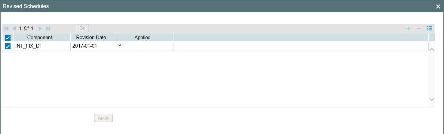

The schedule changes, which have come about as a result of value-dated changes, can be done through the Value Dated Amendments screen. For example, if the schedule change has come about following a change in the maturity date, you have to do this through this screen. Click on ‘Schedules’ in this screen.
When you change the rate applied on a fixed rate contract through the Value Dated Amendments screen, you can also apply the rate revision schedules to the contract. In the Schedules tab of the Loans and Commitment- Value Dated Amendments screen, any interest rate revision schedules defined for the contract are displayed. You can make these schedules effective by clicking on the “Apply” button.

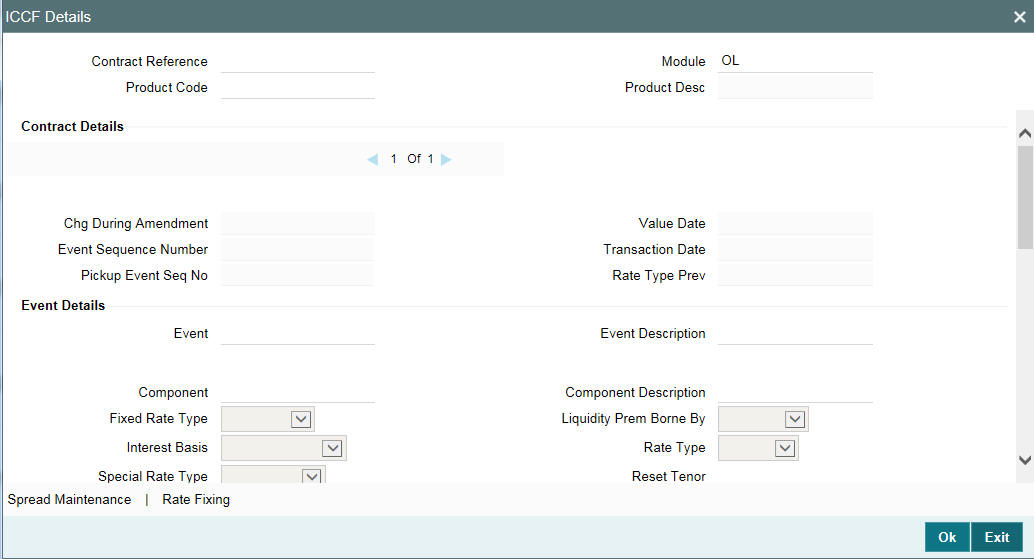

Through the Value Dated Amendment function, you can make changes to the maturity date, the principal and specify a new value date for the loan.
However, if you want to change the interest rate, the rate code, the
spread or the interest amount, you have to invoke the Contract ‘ICCF
Details ‘screen of the ICCF module through the ‘Loan and
Commitment Value Dated Amendments’ screen. Click the’Interest’ to invoke this screen.
You can make Value Dated Amendments only to the following components in the Contract ICCF screen.

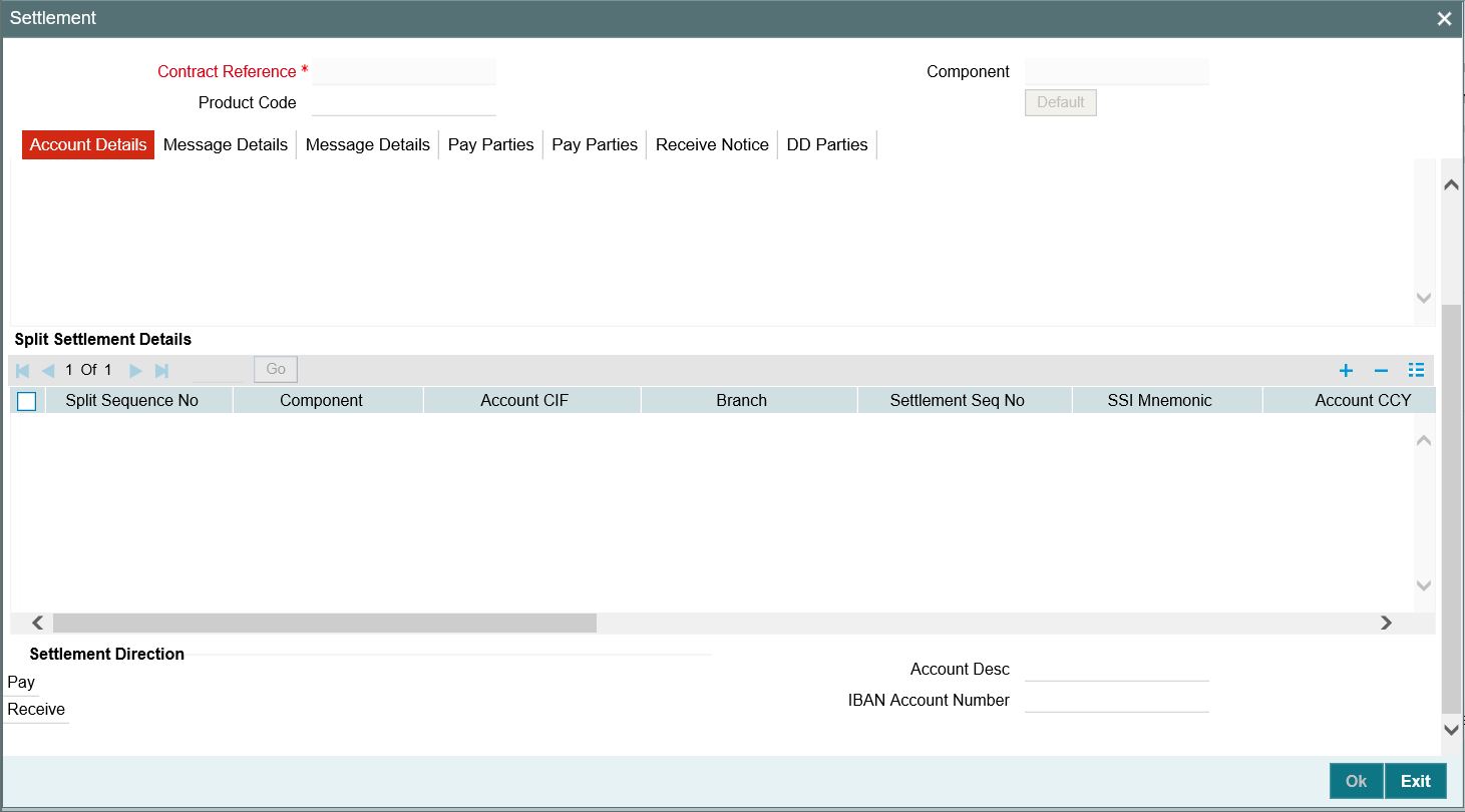

If you want to make changes to the settlement accounts and the currency conversion rates, you have to invoke the ‘Loans and Commitment - Contract Input’ screen and go to the ‘Settlements’ screen by clicking the ‘Settlements’.
For more information, refer to the Settlements User Manual.
The system amends the settlement instructions which are defaulted as a part of maintenance and the settlement accounts which are defaulted component (Amount Tag) wise.
Note
CAMD event is triggered when you upload amendment for settlement instruction.

You can delete the value-dated changes that you have made on a loan provided:
All the value-dated changes have to be authorized before the End of Day operations begin.
All future Value Dated Amendment is applied by the automatic contract update program when the changes are due. If the value date of the change is earlier than, or the same as today’s date, the changes will take effect immediately.
To delete value-dated amendments, call the contract on which you have
made Value Dated Amendment (that are still to be authorized) through
the Value Dated Amendment screen by entering the contract reference number.
The details of the contract is displayed. Choose delete from the Actions
Menu or click ‘Delete’on the
toolbar. The value-dated changes are deleted.

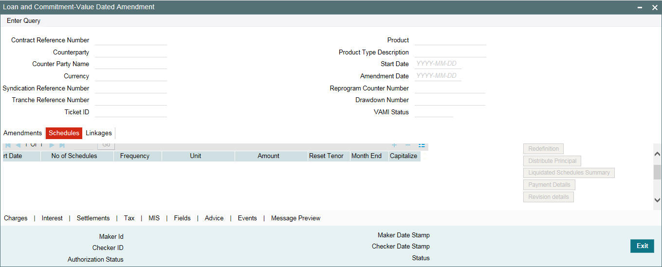

If there is any principal amount increase or maturity date change in the contract, you can distribute the amount equally among all the schedules and redefine the schedules from the amendment date till maturity date. You can do this using 'Distribute Principal' and 'Redefinition' button in 'Schedules' tab of 'Loan and Commitment Value Dated' screen.
In addition, you can use 'Default' button to default back to the original schedules as in contract and 'Liquidate Summary Schedule' button to view the overdue or liquidated schedules.
Note
Schedule amendments are not allowed for non-bearing, commitment, call, notice maturity type contracts. They are applicable only for loans.
If there is any principal increase or maturity date change, then the system performs the following:
Note
In case of reversal of VAMI, the system brings the original amount due before VAMI.
Capitalize
In case of Value Dated Amendment (VAMI), you can modify the schedules by selecting or clearing ‘Capitalize’ check box and then perform CAMD to increase ‘Interest Reserve Amount’. The system validates whether the interest reserve amount entered is not a negative value before saving the contract.
Capitalize due to Insufficient Funds
You can select the schedules and mark the 'Capitalize due to Insufficient Funds' check box which needs to be auto capitalized.
When you click ‘Payment Details’ button in this screen, you can see the ‘Payment Schedule Details screen’ similar to ’Loan and Commitment - Contract Input’ screen. Here you can view the details of the schedules for a particular contract. For more information, refer to ‘Revision and Repayment Schedules’ sub-section in Processing Repayments section.
When you click ‘Revision Details’, the changes made in the ’Loan and Commitment - Contract Input’ screen are displayed. For more information, refer to ‘Revision and Repayment Schedules’ sub-section in Processing Repayments section.

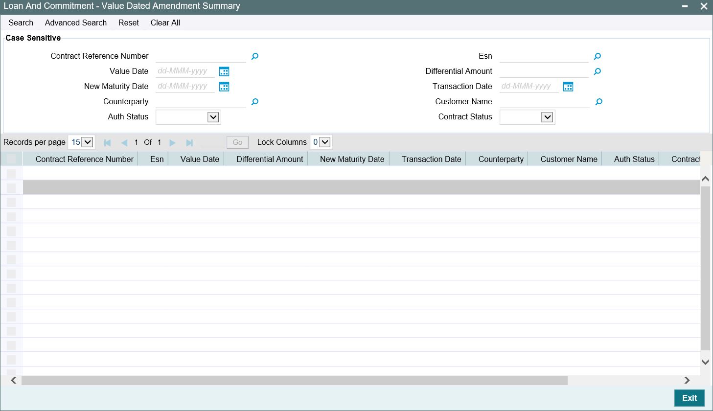

In Oracle Lending, you can authorize the value-dated amendments made on Loan contracts through the ‘Loans and Commitment - Value Dated Amendment Summary’ screen.
You can invoke the ‘Loans and Commitment - Value Dated Amendment Summary’ screen by typing ‘’OLSVAMND’ in the field at the top right corner of the Application tool bar and clicking the adjoining arrow button.
The authorization status of all unauthorized contracts is marked as ‘U’. The following stages of the contracts might be unauthorized:
To authorize the unauthorized contracts, double-click on the contract in the ‘Loans and Deposits Contract Summary’ screen. The screen that is displayed depends on the stage of the contract that is unauthorized.
In the screen that is displayed (based on the unauthorized stage)
click ‘Authorize’ to authorize
the contract.
If you double click on a contract for which the authorization status is marked as ‘A’, the ‘Contract Online’ screen is displayed.

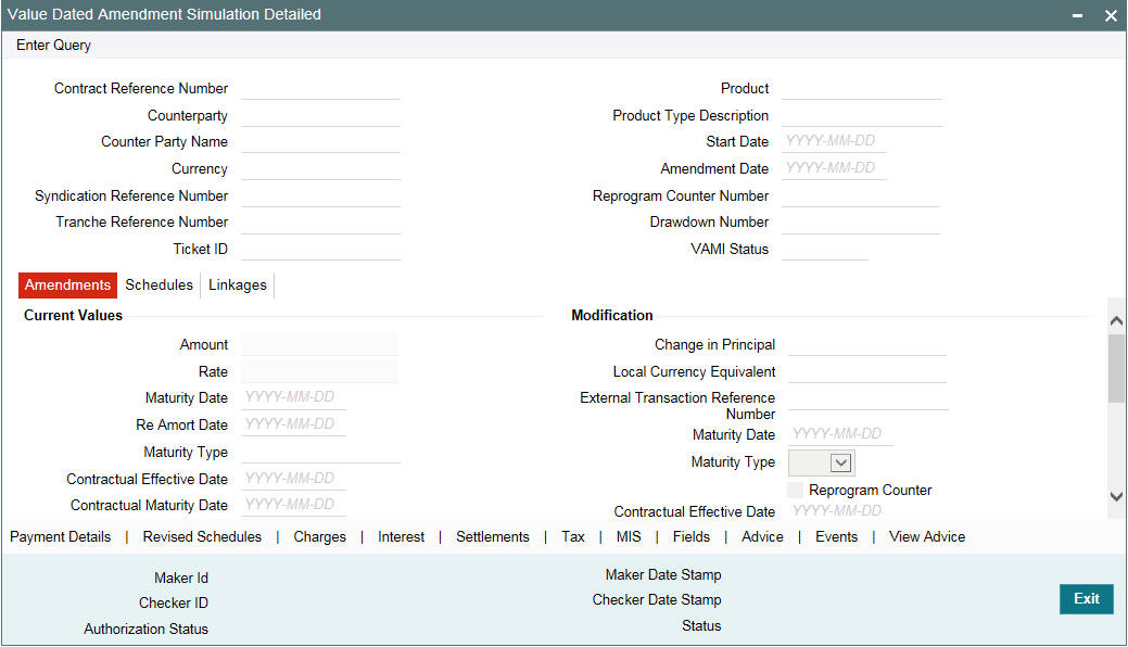

The value dated amendment simulation screen is similar to ‘Loan and Commitment - Value Dated Amendment’ screen. Once the VAMI is saved in this screen, you can view the revised schedules and view the advice.
Value Dated Amendment simulation is used to view the impact on repayment schedules, tenor and maturity date after the VAMI.
You can invoke the ‘Value Dated Amendment Simulation Detailed’ screen by typing ‘OLDVAMSI’ in the field at the top right corner of the Application tool bar and clicking the adjoining arrow button.

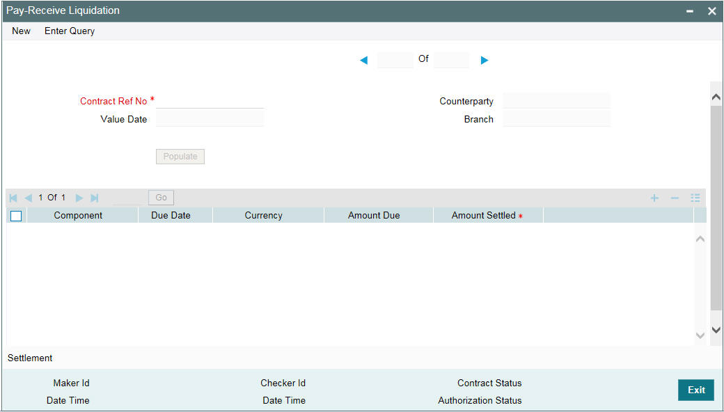

You can track and liquidate the differences in the settled amount using ‘Pay – Receive Liquidation’ screen.
You can invoke the ‘Pay - Receive Liquidation’ screen by typing ‘OLDPRLIQ’ in the field at the top right corner of the Application tool bar and clicking the adjoining arrow button.
Note
In case of any Pro Rata VAMI beyond any Payment, it may result in the change in the settlement amount for the settled schedules. These differences in the settled schedules (both positive and negative) you can track under the payable and receivables and can settle the differences to the Pay-Receive Liquidation option.
Contract Reference Number
Specify the contract reference number whose list of components you want to display in this screen.
The following fields are displayed
Value Date
Specify the value date of the payment for the selected component. The value date of the payment can be either backdated or current dated.
Amount Settled
Specify the amount to be liquidated for the selected component.
