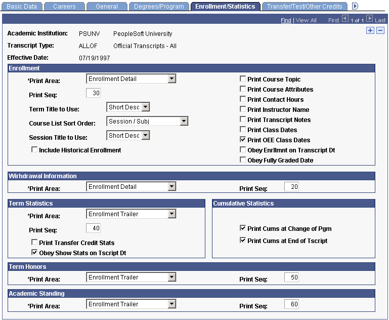

Enrollment/Statistics
SSR_TSTYPE_ENRL
Set Up SACR > Product Related > Student Records > Transcript > Define Transcript Type > Enrollment/Statistics
Define the print areas and details about appearance for enrollment information.

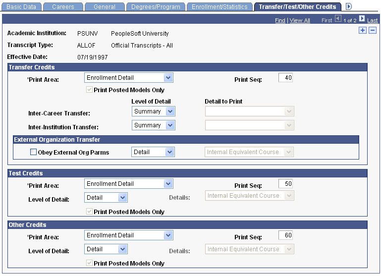

Transfer/Test/Other Credits
SSR_TSTYPE_TRNSFR
Set Up SACR > Product Related > Student Records > Transcript > Define Transcript Type > Transfer/Test/Other Credits
Define the print areas and details about appearance for transfer, test, and other credits.

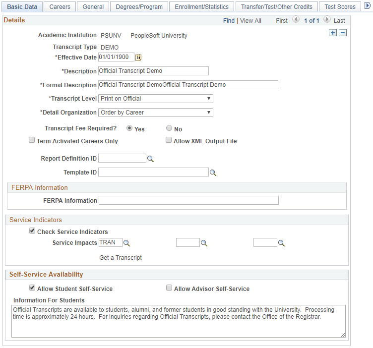

Access the Basic Data page (Set Up SACR > Product Related > Student Records > Transcript > Define Transcript Type > Basic Data).
This example illustrates the fields and controls on the Basic Data page. You can find definitions for the fields and controls later on this page.
Basic Data page
Enter an Academic Institution and an alphanumeric Transcript Type code (one to five characters in length).
You should not define a Transcript Type of ALL because this value is used on the Transcript Type Security page to grant users access to all transcript types.
See Setting Security for Transcript Types.
Field or Control
Description
Effective Date
Enter the effective date that determines when this transcript type is available on the batch and online transcript request pages.
Description
Enter a description. This information does not appear on the transcript. It is for related display purposes.
Formal Description
Enter a formal description. This information appears at the beginning of the transcript.
Transcript Level
Enter the transcript level that you want to associate with this transcript type. Transcript level is hierarchical and based on the two-position numeric code in the value column of the translate table. Values for this field are delivered with your system as translate values. Do not modify these values in any way. Any modification to these values requires substantial programming effort.
See Understanding Transcript Levels.
Detail Organization
Select how the system sorts information on the transcript. Values are:
by Career: Select this value to sort information by the student's academic career, and then by term. For instance, if the student has an undergraduate and graduate record, the system first displays all of the academic career information that matches one academic career, and then all of the academic career information that matches the other career. Within each academic career grouping, information is ordered by term. The system determines the order in which academic career records appear on the transcript by referencing the sequence number of each academic career on the Careers page. Those academic careers with the lowest sequence numbers print first, and so on. The system only seeks and evaluates the academic careers on the Careers page that match the student. Be sure to enter all possible academic careers that you want to capture and report with this transcript type.
Chrono: Select this value to sort information chronologically. For example, all academic careers in which the student has been active (that are also listed on the Careers page) print in chronological order, by term.
Note: If you set up for COBOL based transcripts, using the Transcript Type component (TSCRPT_TYPE), the Chrono setting is not intended for use with the advising check boxes. Advising reports always print by academic career.
Transcript Fee Required
If you select:
  • Yes, you require a transcript fee to be assessed when students request an official transcript through Fluid user interface.
    You must set how the transcript fee is assessed on the Fee Setup page. See Setting up Transcript Fees.
  • No, you do not require a transcript fee to be assessed. By default, this field is set to this value. If you do not select a value, the system also treats it as No.
Term Activated Careers Only
Select this check box to exclude career data from printing on the transcript for which a student has no academic history, such as those careers added to students for prospect records.
The following warning applies if you set up for COBOL based transcripts, using the Transcript Type component (TSCRPT_TYPE):
Warning! If your institution produces Academic Advisement reports for students who are not term-activated (for example, for prospective transfer students), this check box should be cleared for the transcript types associated with these report types.
Allow XML Output File
Use this check box to create your own XML file for testing.
If you select the Allow XML Output File check box, the Output XML File and Output File Path fields appear on the Process Transcripts page when you select a value of Generate and Print Transcript, Print Transcript, or Request, Generate and Print in the Process Action field on that page.
Report Definition ID and Template ID
Select the template to be used with this transcript type. First, select the Report Definition ID then one of the Template IDs associated with that Report Definition. If these fields are left blank, the default template from the Report Definition of SSR_TSRPT is used. The transcript type defined report definition and template can be overridden on the Process Transcripts component. If not overridden, the process uses the report definition and template ID as defined on the transcript type.
FERPA Information
The message that you define in this field prints in the header of the transcript when the FERPA check box is selected for a student on the FERPA page (Campus Community > Personal Information (Student) > Biographical (Student) > Student FERPA > FERPA).
If the field is left blank, nothing prints on the transcript for FERPA.
Check Service Indicators
Select this check box to have the transcript process identify indicators (holds or positive services) that you specify in the Service Impacts fields.
Service Impacts
Select the service impacts that the system evaluates in the transcript process. If the system finds on a student's record a service indicator with any one of the up to three service impacts you list, the system does not generate a transcript for the student. Instead, the system generates an error message in the transcript output. Service impact values are defined on the Service Impact Table page.
Allow Student Self-Service
If you select this check box and the transcript level is Official, the system generates a request for this transcript type on the Request Official Transcript self-service page. Select this check box for only one transcript type per institution.
If you select this check box and the transcript level is Unofficial, the system displays this transcript type on the Unofficial Transcript self-service page. You can select this check box for multiple transcript types.
If you select this check box and the transcript level is Degree Progress, the system displays this transcript type on the View Degree Progress Report self-service page, and the Evaluate Transfer Credit - Process a Degree Progress Report page. You can select this check box for multiple transcript types.
Allow Advisor Self-Service
If you select this check box and the transcript level is Unofficial, the system displays this transcript type on the View Advisee Information self-service page (unofficial transcript). You can select this check box for multiple transcript types.
If you select this check box and the transcript level is Degree Progress, the system displays this transcript type on the View Advisee Information self-service page (degree progress report). You can select this check box for multiple transcript types.
This check box does not have any use with a transcript level of Not Print and Stdnt Life (student life).
Information for Students
This free-form text appears to students for the respective transcript type on the View Degree Progress Report self-service page.

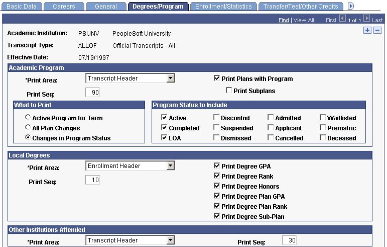

Access the Degrees/Program page (Set Up SACR > Product Related > Student Records > Transcript > Define Transcript Type > Degrees/Program).
This example illustrates the fields and controls on the Degrees/Program page (1 of 2). You can find definitions for the fields and controls later on this page.
This example illustrates the fields and controls on the Degrees/Program page (2 of 2). You can find definitions for the fields and controls later on this page.
Field or Control
Description
Academic Program Print Area
Select the print area to indicate where the system displays academic program information. Values are Enrollment Header, Enrollment Trailer, Transcript Header, and Do Not Display. Print area values are delivered with your system on the Print Area Table page. Any modification to these values requires programming effort. Depending on which print area you select, the system selects an option in the What to Print group box.
Academic Program Print Seq
The print sequence determines the order in which academic program information appears within the print area. The system populates the print sequence by default. You can change the value.
Print Plans with Program
Select this check box to display all the academic plans associated with each of the student's reported programs.
Print Subplans
Select this check box to display all the subplans associated with each of the student's reported programs.
What to Print
The system selects a What to Print option and a Program Status to Include check box based on your choice of academic program print area. You cannot override these defaults.
If you select Enrollment Header, the system selects the Active Program for Term option and the value of Active for the Program Status to Include field.
If you select Enrollment Trailer, the system selects the Changes in Program Status option and the appropriate academic program status values become available for selection in the Program Status to Include group box. Select the appropriate academic program status values.
If you select Transcript Header, the What to Print group box becomes available for entry, and you can select which information to print. In addition, the Program Status to Include group box becomes available for entry. Select the appropriate academic program status values.
Select the appropriate check boxes to indicate the program statuses that the system includes. Values are Active, Discontnd (discontinued), Admitted, Waitlisted, Completed, Suspended, Applicant, Prematric, LOA (leave of absence), Dismissed, Cancelled, and Deceased.
Local Degree Print Area
Local degrees are degrees that a student obtains at your institution. Select the print area to indicate where the system displays local degree information. Values are Enrollment Header, Enrollment Trailer, Transcript Header, Transcript Trailer, and Do Not Display. Print area values are delivered with your system on the Print Area Table page. Any modification to these values requires programming effort.
Note: If you configure Local Degrees to print on the transcript, the system displays all degrees for the student across all of the student's careers, regardless of whether or not the degrees were earned in association with the specific career for which the transcript is reporting.
Local Degree Print Seq
The print sequence determines the order in which local degree information appears within the print area. The system populates the print sequence by default. You can change the value.
Other Institution Attended Print Area
The system extracts information for other institutions attended from the student's education component. Select the print area to indicate where the system displays other institutions attended. Values are Transcript Header, Transcript Trailer and Do Not Display. Print area values are delivered with your system on the Print Area Table page. Any modification to these values requires programming effort.
Other Institution Attended Print Seq
The print sequence determines the order in which other institution attended information appears within the print area. The system populates the print sequence by default. You can change the value.
External Degree Print Area
The system extracts external degree information from the student's education component. Select the print area to indicate where the system displays external degree information. Values are Transcript Header, Transcript Trailer, and Do Not Display. Print area values are delivered with your system on the Print Area Table page. Any modification to these values requires programming effort.
External Degree Print Seq
The print sequence determines the order in which external degree information appears within the print area. The system populates the print sequence by default. You can change the value.
Print Honors
Select this check box to display honors that the student received from other institutions.
Milestones Print Area
Select the print area in order to indicate where the system displays milestone information. Values are Do Not Display and Transcript Trailer. Print area values are delivered with your system on the print area Table page. Any modification to these values requires programming effort.
Milestones Print Seq
The print sequence determines the order in which milestone information appears within the print area. The system populates the print sequence by default. You can change the value.
See Setting Up Milestones.
Print Honors
Select this check box to display any student honors on the transcript.
Sort Milestones by Program
Select this check box to sort and display milestones by academic program on the transcript.
Scholarships and Grants Print Area
Select the print area to indicate where the system displays scholarship and grant information. Values for this field are delivered with your system as translate values. Do not modify these values in any way. Any modifications to these values require a substantial programming effort. Values are Transcript Header, Transcript Trailer, and Do Not Display. The system extracts other institution-attended information from the student's admissions record.
Academic Project Print Area
Select the print area to indicate where the system displays Academic Project information. Values for this field are delivered with your system as translate values. Do not modify these values in any way. Any modifications to these values require a substantial programming effort. Values are Transcript Header, Transcript Trailer, and Do Not Display.
Thesis Print Area
Select the print area to indicate where the system displays thesis information. Values for this field are delivered with your system as translate values. Do not modify these values in any way. Any modifications to these values require a substantial programming effort. Values are Transcript Header, Transcript Trailer, and Do Not Display.
Access the Enrollment/Statistics page (Set Up SACR > Product Related > Student Records > Transcript > Define Transcript Type > Enrollment/Statistics).
This example illustrates the fields and controls on the Enrollment/Statistics page. You can find definitions for the fields and controls later on this page.
Field or Control
Description
Enrollment Print Area
Select the print area in order to indicate where the system displays enrollment information. Values for this field are delivered with your system as translate values. Do not modify these values in any way. Any modification to these values requires substantial programming effort. Values are Enrollment Detail and Do Not Display.
Enrollment Print Seq (enrollment print sequence)
The print sequence determines the sequence in which enrollment information appears within the print area. The system populates the print sequence by default. You can change this value.
Term Title to Use
Select the type of term title that you want to appear on the transcript. Values for this field are delivered with your system as translate values. Do not modify these values in any way. Any modifications to these values requires a substantial programming effort. Values are Long Description and Short Description.
Course List Sort Order
Select the course list sort order in which the system displays courses within a term. You can select to sort by Session Number and Subject Area or Subject Area and Course Catalog Number.
Session Title to Use
If you select a course list sort order of Session Number and Subject Area, the Session Title to Use field becomes available for entry. Select the Long Description or Short Description of the session title that you want to appear on the transcript.
Include Historical Enrollment
Select this check box for the system to display historical enrollment information that was entered into the Historical Course Enrollment page and its corresponding table.
This information is separate from the usual student enrollment data.
See Creating Historical Enrollment Records.
Note: If you select the Include Historical Enrollment check box, be sure that you set the Last Term for Historical Enrollment field to the latest term possible for historical enrollment records on the Academic Career Table page.
Also note that term 0000 does not allow historical enrollment data to print on a transcript. If you want historical enrollment data to print on a student's transcript, you must select a term value other than 0000.
See Describing Academic Career Parameters.
Field or Control
Description
Print Course Topic
Displays course topics associated with specific courses.
Print Course Attributes
Displays the course attributes associated with specific courses.
Print Contact Hours
Displays the instructor's contact hours.
Print Instructor Name
Displays the instructor name for each class.
Print Transcript Notes
Displays the transcript notes attached to student enrollment records.
Print Class Dates
Displays the class begin and end dates if set on the term/session table.
Print OEE Class Dates (print open entry/exit class dates)
Displays the student's unique begin date for each Open Entry/Open Exit class taken.
Obey Enrllmnt on Transcript Dt (obey enrollment on transcript date)
Select this check box for the system to display all enrollment information that is fully enrolled as of the transcript create date. The fully enrolled date is defined on the Academic Term Calendar 3 page. The date is set by default to the student's term activation record during term activation. You can manually change the date on a per student basis. The transcript process looks at the date on the student's term activation record. If you do not select this check box, all enrollment information that exists at the time that the transcript is processed appears on the transcript.
Obey Fully Graded Date
If you do not select this check box, partially graded terms and sessions print on the transcript.
Select this check box for the system to only display classes with fully graded dates less than or equal to the run date.
The fully graded date is defined on the Academic Term Calendar 3 page. The date is set by default to the student's term activation record during term activation. You can manually change the date on a per student basis. The transcript process looks at the date on the student's term activation record.
Withdrawal Information Print Area
Select the print area to indicate where the system displays withdrawal information. Values are Enrollment Detail and Do Not Display.
Withdrawal Information Print Seq (withdrawal information print sequence)
The print sequence determines the order in which withdrawal information appears within the print area. The system populates the print sequence by default. You can change the value.
In the example, the enrollment information appears before the withdrawal information because both types of information have a print area of enrollment detail, and the print sequence for withdrawal information is greater than the print sequence enrollment information.
Term Statistics Print Area
Select the print area to indicate where the system displays term statistics information. Values are Enrollment Header, Enrollment Trailer, and Do Not Display. The system calculates statistics when you run the grade posting process. Print area values are delivered with your system on the Print Area Table page. Any modification to these values requires programming effort.
Term Statistics Print Seq (term statistics print sequence)
The print sequence determines the order in which term statistics information appears within the print area. The system populates the print sequence by default. You can change the value. In the example, term statistics, term honors, and academic standing print in the Enrollment Trailer area. Term statistics print first because the print sequence is less than both term honors and academic standing print sequence values.
Print Transfer Credit Stats (print transfer credit statistics)
Select this check box for the system to include transfer credit statistics in the display.
When this check box is selected, transfer credit statistics appear separately from enrollment statistics wherever the term and cumulative statistics have been selected to print. In addition, when this check box is selected, the transfer credit is added into the combined statistics for both the term and the cumulative.
Obey Show Stats on Tscript Dt (obey show statistics on transcript date)
Select this check box for the system to display statistics only if the transcript process date is greater than or equal to the show statistics on transcript date value. The show statistics on transcript date value is defined on the Academic Calendar 3 page. The date is set by default to the student's term activation record during term activation. You can manually change the date on a per student basis. The transcript process looks at the date on the student's term activation record. If you do not select this check box, the system displays the statistics as of the last term.
Cumulative Statistics
The Cumulative Statistics group box enables you to determine where the system displays statistics. You can select the Print Cums at Change of Pgm (print cumulatives at change of program) check box. You can also select the Print Cums at End of Tscript (print cumulatives at end of transcript) check box on its own or in combination with the other check box.
Term Honors Print Area
Select the print area in order to indicate where the system displays term honors information. Values are Enrollment Header, Enrollment Trailer, and Do Not Display. Print area values are delivered with your system on the Print Area Table page. Any modification to these values requires programming effort.
Term Honors Print Seq (term honors print sequence)
The print sequence determines the order in which term honors information appears within the print area. The system populates the print sequence by default. You can change the value.
Academic Standing Print Area
Select the print area in order to indicate where the system displays academic standing information. Values are Enrollment Header, Enrollment Trailer, and Do Not Display. Values for this field are delivered with your system as translate values. Do not modify these values in any way. Any modification to these values requires a substantial programming effort.
Academic Standing Print Seq (academic standing print sequence)
The print sequence determines the order in which academic standing information appears within the print area. The system populates the print sequence by default. You can change the value.
Access the Transfer/Test/Other Credits page (Set Up SACR > Product Related > Student Records > Transcript > Define Transcript Type > Transfer/Test/Other Credits).
This example illustrates the fields and controls on the Transfer/Test/Other Credits page. You can find definitions for the fields and controls later on this page.
Transfer Credits
Field or Control
Description
Print Area
Select the print area to indicate where the system displays Transfer Credit information. Values for this field are delivered with your system as translate values. Do not modify these values in any way. Any modification to these values requires substantial programming effort. Values are Enrollment Detail, Enrollment Trailer, Transcript Header, Transcript Trailer, and Do Not Display.
Note: If you select a value of Enrollment Detail with a Level of Detail field value of Detail, then the system populates by default and makes the following fields unavailable for entry: Print Posted Models Only: Selected; Inter-Career Transfer (Detail to Print): Internal Equivalent Course; Inter-Institution Transfer (Detail to Print): Internal Equivalent Course; and External Organization Transfer: Internal Equivalent Course.
Print Seq (print sequence)
The print sequence determines the order in which transfer credit information appears within the print area. The system populates the print sequence by default. You can change the value.
If you select any print area other than Enrollment Detail, the Print Posted Models Only check box is available for entry. Select the Print Posted Models Only check box to display transfer credit from posted models only.
If this check box is available and you do not select it, transfer credit from all models (posted, completed, and not posted) appears.
Transfer credit print details are organized in three categories: Inter-Career, Inter-Institution, and External Organization transfers.
Transfers from academic career to academic career (or academic program to academic program, same academic career) in your institution. The source of data is the student's enrollment record at your institution.
Transfer between an external institution with which your institution shares a database. The source of data is the student's enrollment record at the external institution, but with a shared database you can bypass the data entry of external courses.
Level of Detail
Select the level of detail to print for each type of transfer. Values are:
Summary: The system only displays total units transferred.
Detail: The system displays the course details, depending upon your selection in the Detail to Print field.
Detail to Print
If you select Detail in the Level of Detail field, the Detail to Print field becomes available for entry. Values are External and Internal, External Courses, and Internal Equivalent Course.
Most transfers fall into this category. Transfers between an external institution and your institution. The source of data is the external organization and is entered as external course work.
Obey External Org Parms (obey external organization parameters)
Select this check box to obey the external organization transfer credit parameters on the Organization Affiliation page. Usually, you select this check box in order for official transcripts to follow the defaults set for printing external transfer information.
Test Credits
Field or Control
Description
Print Area
Select the print area to indicate where the system displays test credit information. Values for this field are delivered with your system as translate values. Do not modify these values in any way. Any modification to these values requires a substantial programming effort. Values are Enrollment Detail, Transcript Header, Transcript Trailer, and Do Not Display.
Print Seq
The print sequence determines the order in which test credit information appears within the print area. The system populates the print sequence by default. You can change the value.
Level of Detail
Select the level of detail to print for test credit. Values are:
Summary: The system displays only total test credit units.
Detail: The system displays the test credit details, depending upon your selection in the Details field.
Details
If you select Enrollment Detail as the print area and a level of detail value of Detail, the system populates the Details field with Internal Equivalent Course. You cannot alter the details value.
If you select Transcript Header or Transcript Trailer as the print area, and a level of detail value of Detail, you can select which details to print. Values are Internal Equivalent Course, Test and Internal Equivalents, and Test Credits.
Note: If you select a level of detail of Summary, regardless of the print area you select, the Details field is unavailable for entry.
If you select any print area other than enrollment detail, the Print Posted Models Only check box becomes available for entry. Select the Print Posted Models Only check box to display only test credit from posted models. If this check box is available but you do not select it, test credit from all models (posted and not posted) appears.
Other Credits
Field or Control
Description
Print Area
Select the print area where other credit information is printed. Print area values are delivered with your system in the Print Area Table page. Any modification to these values requires programming effort. Values are Enrollment Detail, Transcript Header, Transcript Trailer, and Do Not Display.
Print Seq
The system populates the print sequence by default. The print sequence determines the order in which other credit information appears within the print area. You can change the value.
Level of Detail
Select the level of detail to print for other credit. Values are:
Summary: The system only displays the cumulative total of other credit units.
Detail: The system displays the other credit details, depending upon your selection in the Details field.
Details
If you select Transcript Header or Transcript Trailer as the print area, and a level of detail value of Detail, you can select which details to print. Values are Internal Equivalent Course, Other Credit and Internal Equivalents, and Other Credits.
If you select any print area value other than Enrollment Detail, the Print Posted Models Only check box becomes available. Select the Print Posted Models Only check box for the system to display other credit from posted models only. If this check box is available and you do not select it, other credit from all models (posted and not posted) appears.
