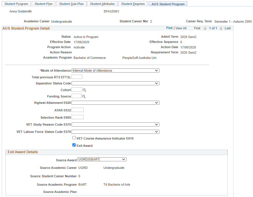

Access the AUS Student Program page (Records and Enrollment > Career and Program Information > Student Program/Plan > AUS Student Program).
This example illustrates the fields and controls on the AUS Student Program page 1 of 2. You can find definitions for the fields and controls later on this page.
This example illustrates the fields and controls on the AUS Student Program page 2 of 2. You can find definitions for the fields and controls later on this page.
Field or Control
Description
Mode of Attendance
Assign a mode of attendance for reporting element 329 to DIISRTE in the Load Liability, Past Course Completions, Offer Details, and Preference Details Files.
Values are:
  • Completed Course - OLAA
  • External Mode of Attendance
  • Internal Mode of Attendance
  • Multi-modal Mode of Attendance
  • Submission of Original Work
Total previous RTS EFTSL (total previous research training scheme equivalent full-time student load)
Enter any EFTSL amount for the student from a previous institution. This field is used only for research students who require a prior Research Training Scheme EFTSL to be reported to DIISRTE as element 460 in the student enrollment file.
Separation Status Code
Select the separation status code for higher degree research students.
This code is reported in the DIISRTE Enrollment file as element 465. If the field is blank, element 465 is reported as 9.
Values are:
  • Downgrade Doctorate to Masters
  • Other
  • Same level transfer
  • Upgrade Masters to Doctorate
Cohort
Select a cohort for the student that the system can use as the default value when you enroll the student. The system populates this value by default on the Australian regional enrollment data and the field is available to tuition calculation for HECS or tuition fees if the Australian Regional Installation Settings are selected.
Funding Source
Select a funding source for the applicant to indicate the type of place being offered. The funding source can be mapped to the code reportable as element 724 in the DIISRTE Applications & Offers Collection.
See Generating the Applications and Offers Files.
Exit Award
Select to indicate that you’re using this student program/plan as an exit award.
See Defining Cohort Years.
Exit Award Details
This region appears when you select Exit Award.
Here, you can select the source student program/plan. The source student program/plan would have been previously reported to TCSI as a course admission together with its reported unit enrollment packets. This student program/plan is reported in the exit award packet. The exit award packet is used to report a higher education award course completion for students who have course admission records with the provider, but these records aren’t for courses that were completed. This may be students who choose to exit early with a lesser qualification. For example, they originally attempt to earn a degree, but exit with a diploma.

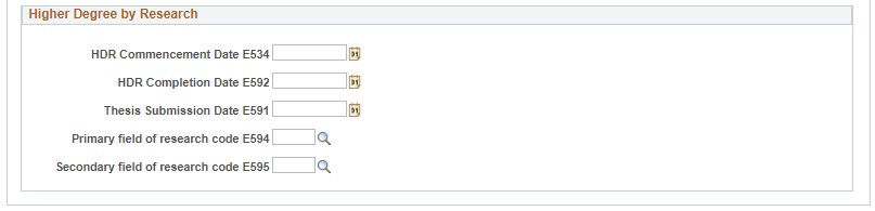

Higher Degree by Research
Field or Control
Description
HDR Commencement Date E534
Enter the beginning date for a research student. This date works as an override for the Course of Study commencement date (element 534) in the DIISRTE Load Liability file. If this field is blank, the system determines the date from the admit term begin date.
Thesis Submission Date E591
Enter the date on which the research student submits the thesis (element 591). This date is based on a student's first recorded thesis submission. Leave the field blank for those who are not higher degree by research students.
HDR Research Completion Date E592
Enter the date by which the research student completes the research (element 592). Leave the field blank for those who are not higher degree by research students.
HDR End User Engagement Codes
Click to access the Higher Degree by Research page.
Research Scholarships
Click to access the Research Scholarships page.
This example illustrates the fields and controls on the Higher Degree by Research page.
Use this page to record research engagements.

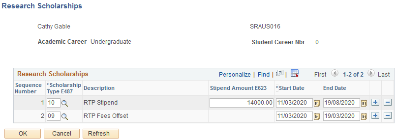

This example illustrates the fields and controls on the Research Scholarships page.
Use this page to record research scholarships.
Records of the same scholarship type can’t have overlapping start and end dates.
