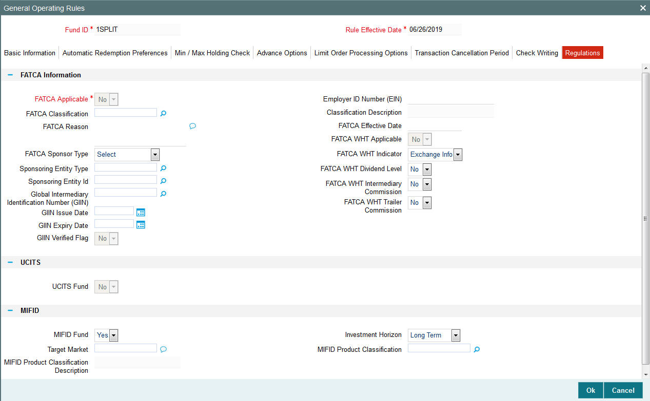

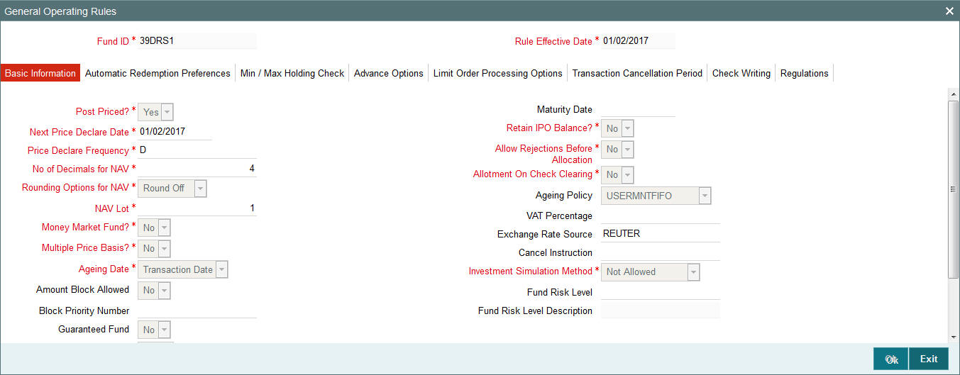

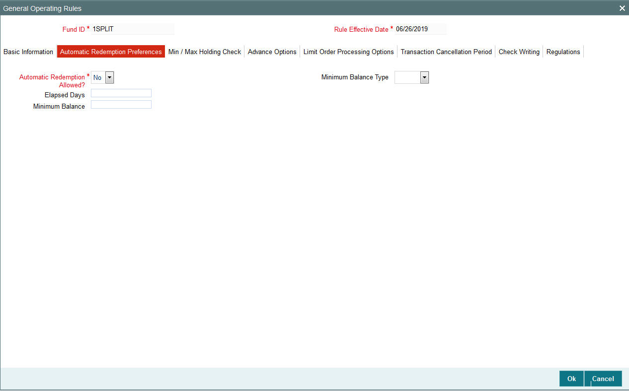

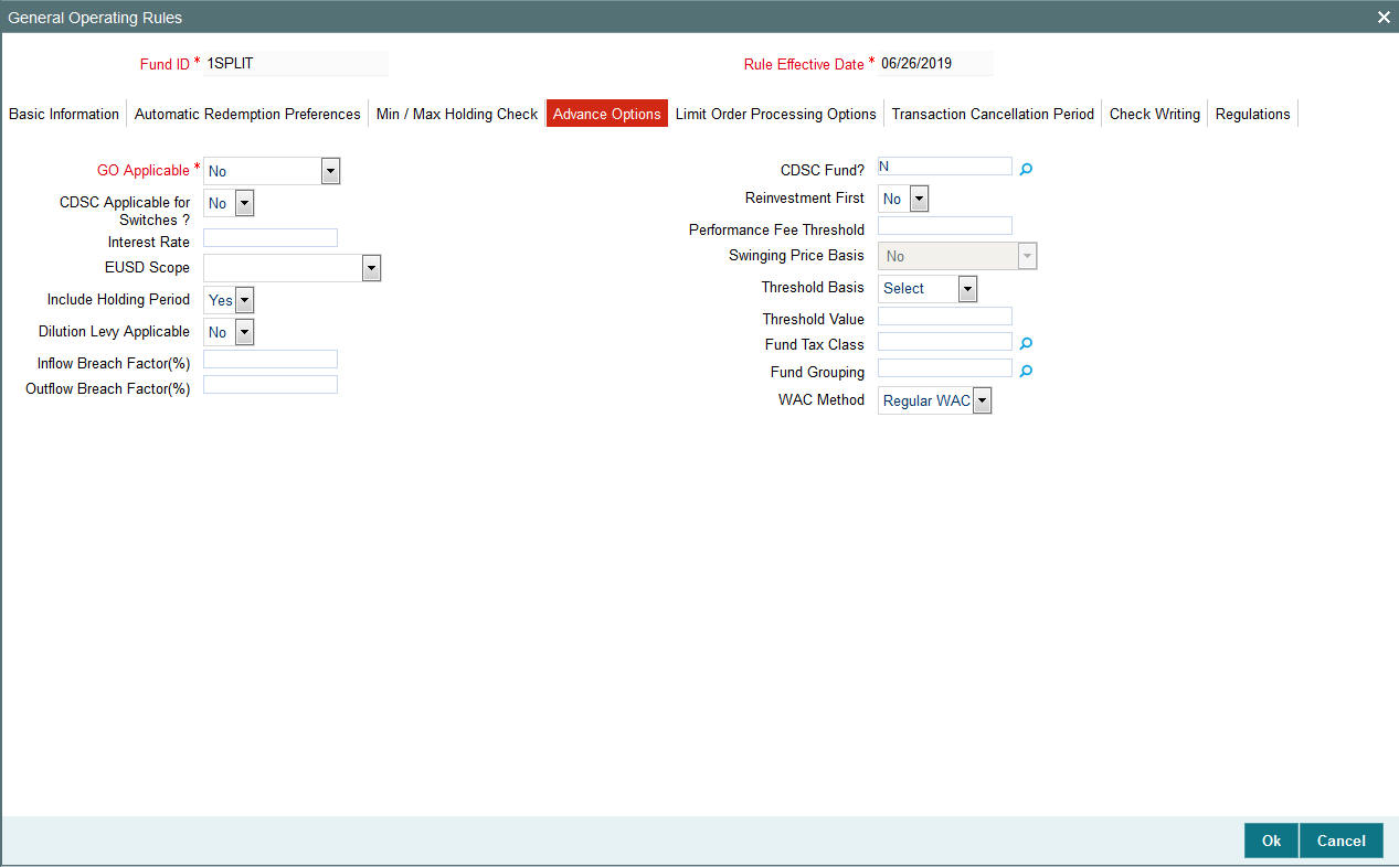

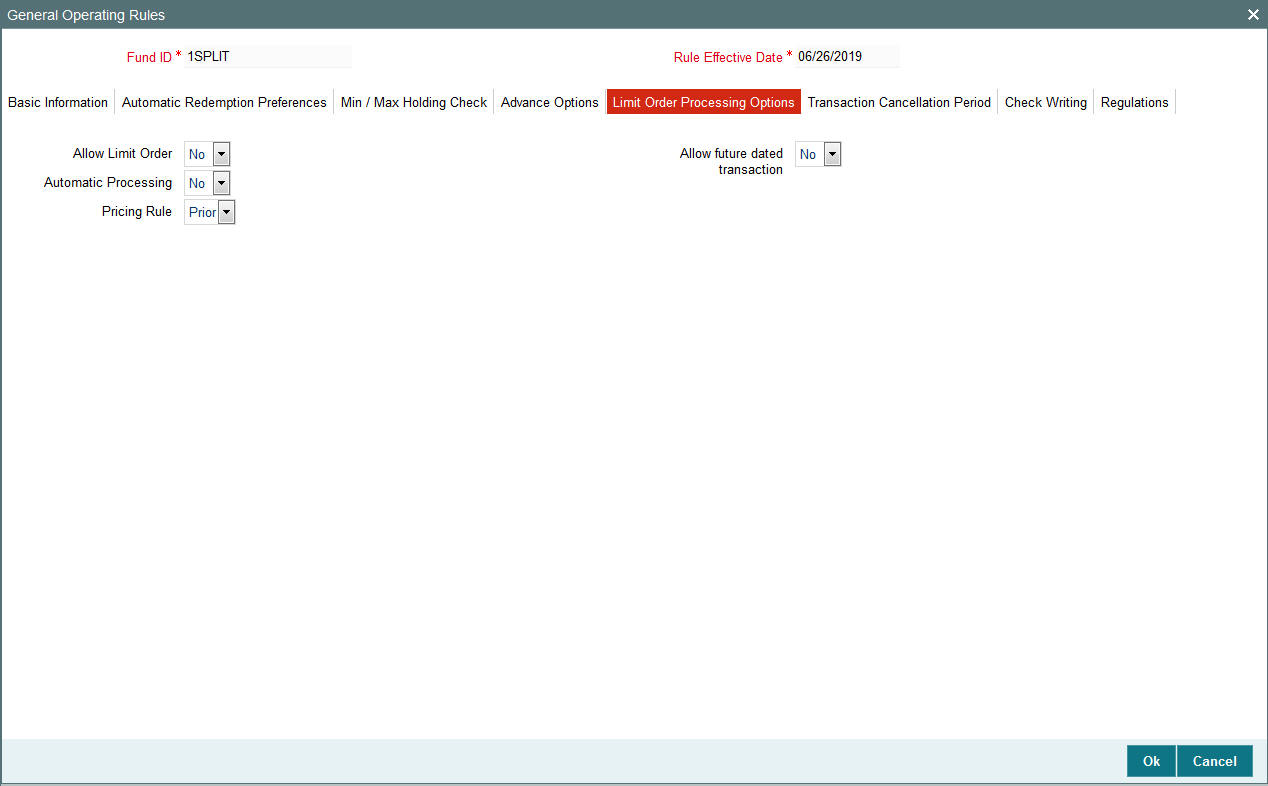

General Operating Rules
In this section, you can designate the rules that will govern the operation of the fund. You can specify the frequency at which the fund price is declared. You can also designate a fund to have automatic redemption.
This is a mandatory fund rule, and you must set it up before you authorize a fund.

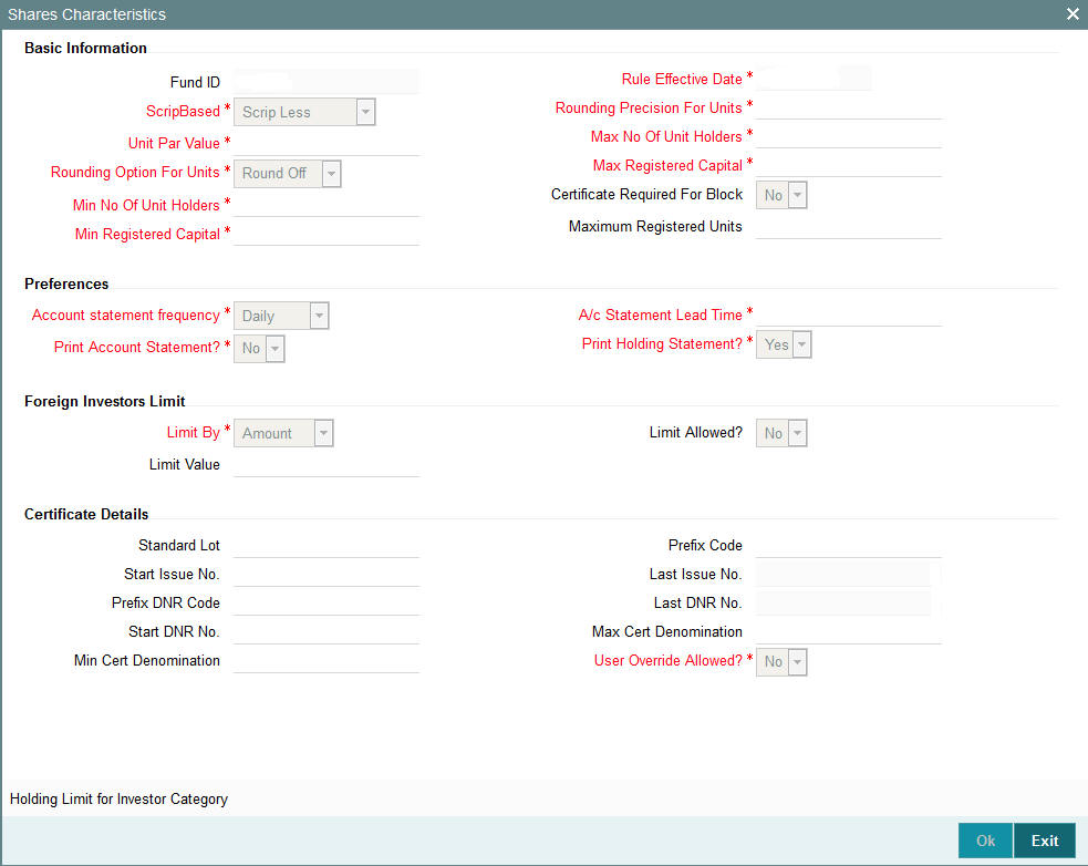

Shares Characteristics
These rules govern the features of shares that are issued in the fund. You can designate a fund as scrip-less fund or a scrip-based fund that issues certificates. The limits on the number of unit holders that must be allowed to subscribe to the fund and the ceiling on the capital that may be issued by the fund may also be specified in this rule. You can set up the standard lot, the maximum and minimum certificate denominations and the issue number range. You can also set up the limits for Foreign Investors in the fund, either as an amount or as a percentage of the issued share capital.

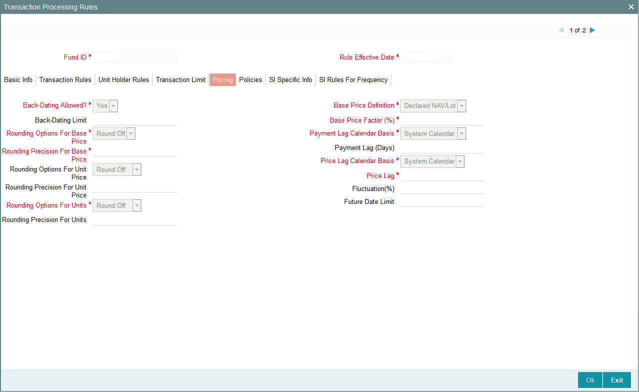

Transaction Processing Rules
These rules govern the parameters by which each transaction is processed in the fund, and these rules may be set up according to each transaction type. These parameters typically include the ranges of volumes allowed for each transaction type, the range of periods and times for the processing of a transaction, the processing policy for each transaction type and the base price definition types and factors. You may enable or disable a transaction type as the requirement may be.

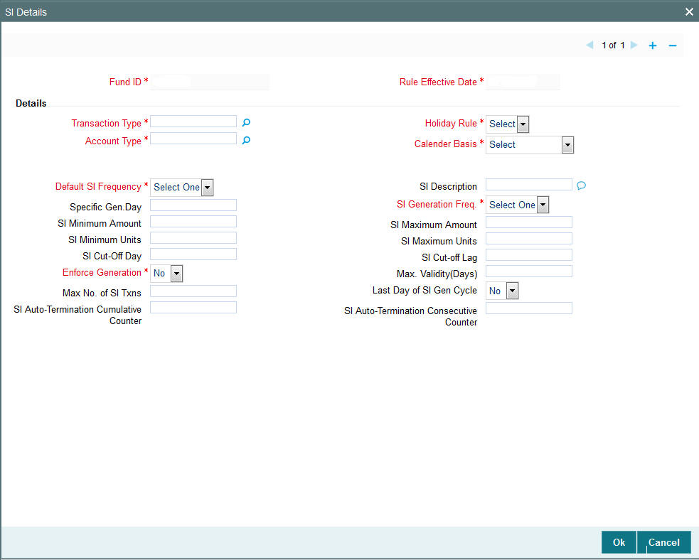

Setting up the Amount/Units Limits for Investment and Standing Instructions
The limits in the volume of investment for initial investments and standing instructions can be set up using this fund rule. This is a sub-rule that you can maintain as part of the Transaction Processing Rules rule.

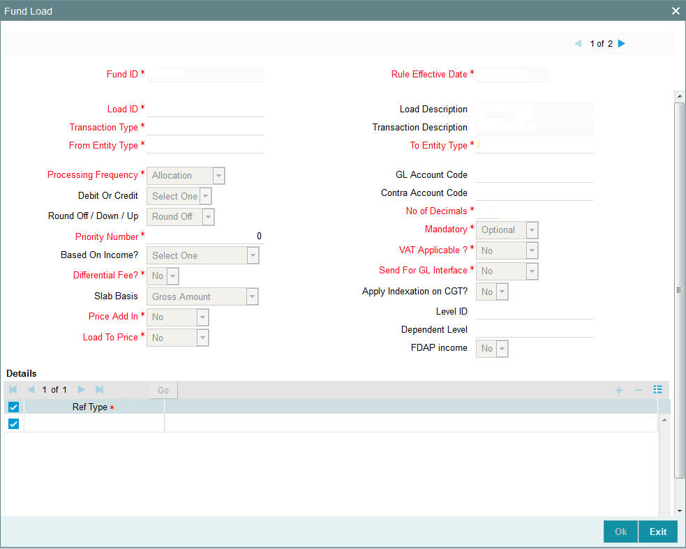

Fund Load Setup
These rules govern the ways in which an applicable fee or incentive will impact the processing of transactions in the fund.
Setting up this rule is optional, and you can set it up for a fund as and when required. It is recommended that you set it up before you authorize the fund.

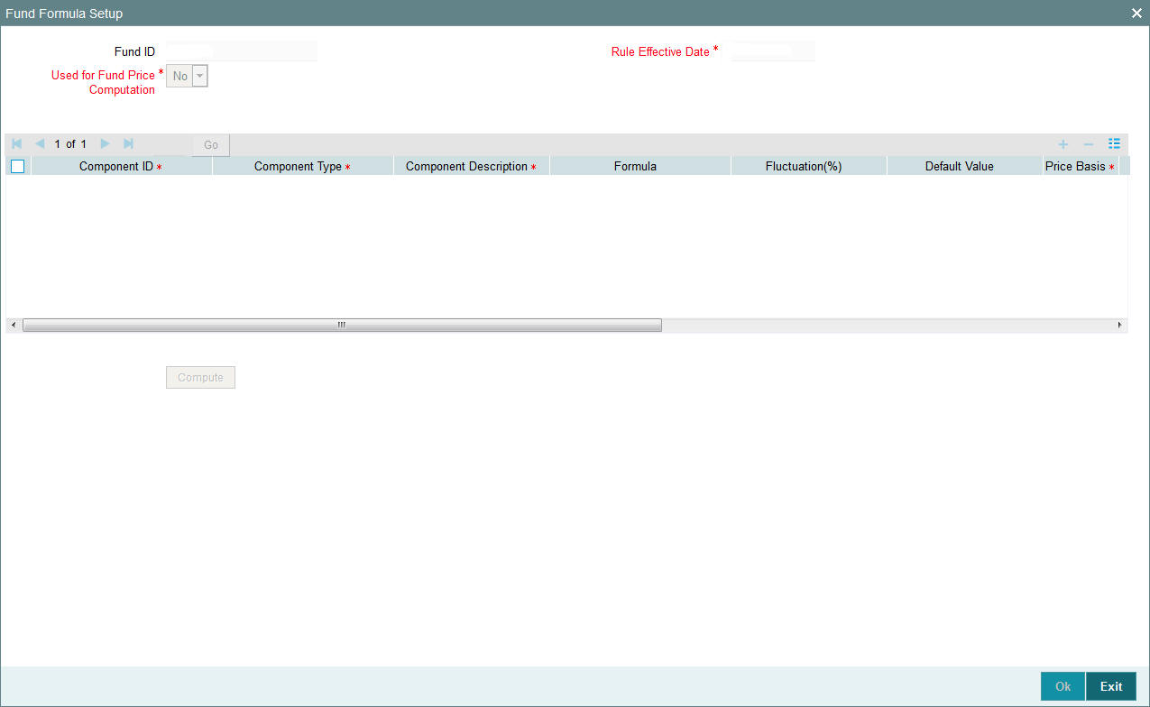

Fund Formula Setup
This fund rule facilitates the specification of any expression that will be used in estimating the base prices or the Net Asset Value for any transaction type.

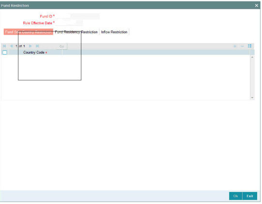

Fund Residency Restriction Setup
This fund rule enables the Fund Manager to make restrictions with respect to the nationality of the unit holders who subscribe to the fund.
Fund Sale Country Setup
If some funds are not to be opened for investment in specific countries, restrictions can be made in respect of that country, identifying that the fund cannot be sold in that country.

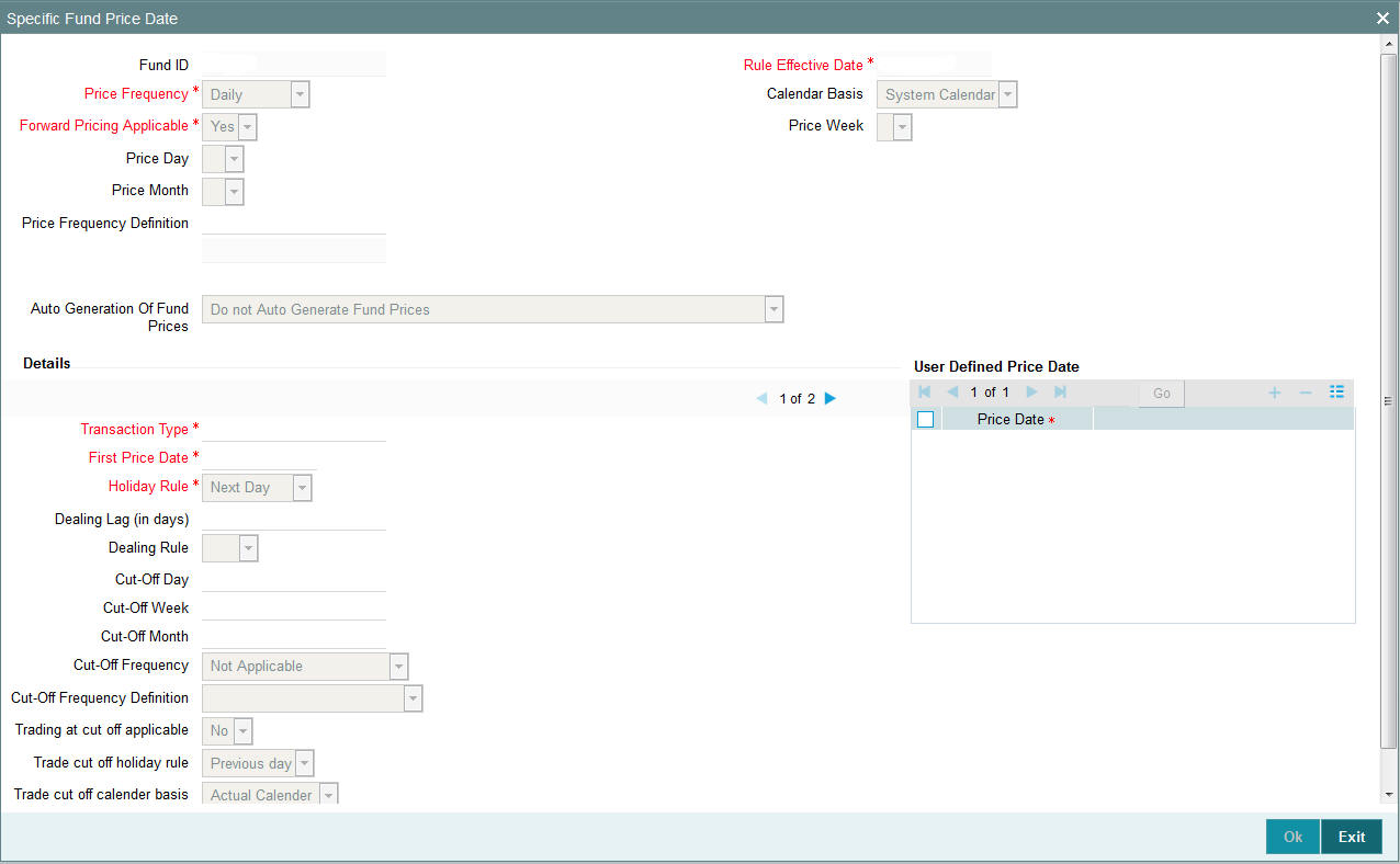

Specific Fund Price Date Setup
You can use this fund rule to specify specific price dates to be operable at a specific frequency for certain transaction types, for a fund. Setting up the specific price date is an optional fund rule, and may be edited, authorized or amended just as the other fund rules.

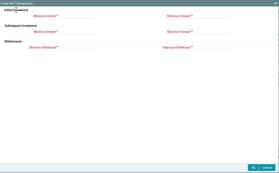

Amount Limits for IRA Transactions
For funds that form part of the investment portfolio of retirement products that you offer to investors, and in which you have opted to allow investment into retirement accounts (IRA), you can define the limits for the different kinds of transactions into such accounts that would apply to the fund.
This is an optional rule, and must be maintained only in the event of IRA investment being allowed for the fund.

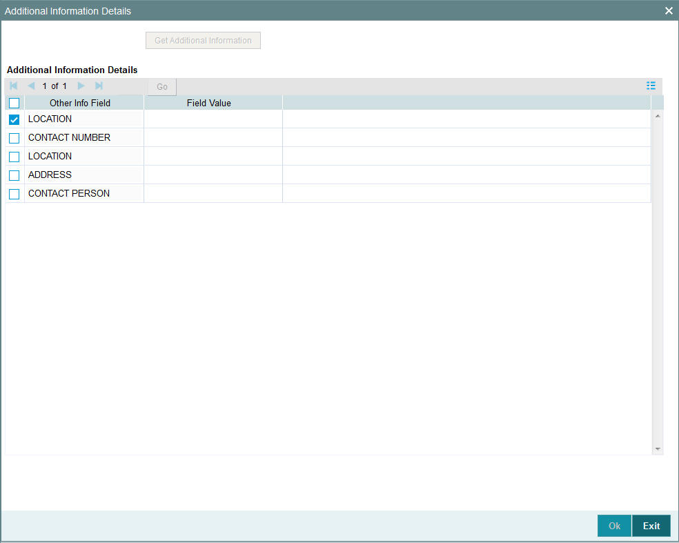

Additional Information Setup
You can also maintain additional information for a fund, if additional information heads have been maintained for the AMC, to be applicable for funds.
Though maintenance of additional information is not, strictly speaking, a fund rule, you can only maintain the information through the Fund Demographics screen, when you are setting up a fund, along with all the other fund rules.

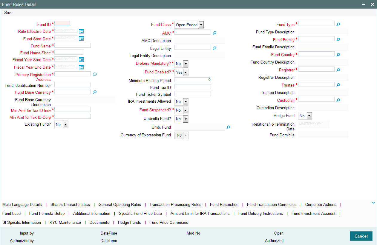

You can set up the fund rules for a fund in the ‘Fund Rules Detail’ screen. You can invoke this screen by typing ‘UTDFNDRL/ UTDFNDRA’ in the field at the top right corner of the Application tool bar and clicking on the adjoining arrow button.
In this screen, you must set up the first fund rule, the Fund Demographics rule, before you can set up the other fund rules.
After you have maintained the Fund Demographics rule, click ‘Ok’ button.
Click on any of the links to invoke the corresponding setup screen for any of the other fund rules. For instance, to set up Corporate Actions for the fund, click on the Corporate Actions link. The name, and ID of the fund is defaulted in each of the fund rule setup screen, from the Fund Demographics record.

This is the entry point for setting up a fund in the system.  A rudimentary, demographic profile is captured for the fund that includes the following basic details, and lays down a basis for defining other important rules and details for the fund:
l The Name of the fund and the unique ID that must be used by the system to identify the fund.
l The Start Date and the Rule Effective Date. The Start Date is the date after which the fund is open for transactions. The Rule Effective Date is the date after which the fund rule that is defined is effective. Also, the dates of the Fiscal Year that includes the Rule Effective Date are captured.
l The Type and Class of the fund and the Family of Funds that it must operate under.
l The AMC that floats the fund and other entities that the fund will interact with such as Registrar and Trustee.
l The Country of Domicile of the fund and the base currency that the fund will be denominated in.
l A prospectus for the fund, if any.
l The tax ID for the fund
l Any additional details such as the registration address, ticker symbol in the stock exchange and CUSIP number of the fund.
l The ISIN code for the fund
l Whether IRA transactions are allowed for the fund
l Whether the fund is suspended for transactions of all types. Transactions of all types (both those entered through the Transaction Detail screens as well as system-generated and uploaded transactions) into suspended funds are not allowed.
l Whether the fund is a hedge fund
A fund will not be identified within the system unless it has a Fund Demographics profile record, and all other rules and details for the fund cannot be set up unless the fund has this profile.
To set up the Fund Demographics profile for a fund, use the Fund Demographics screen. You can invoke this screen by typing ‘UTDFNDRL’ in the field at the top right corner of the Application tool bar and clicking on the adjoining arrow button.
Note
Before you set up a Fund Demographics profile record, it is desirable to ensure that the following information is already setup in the system:
Fund Types must already be defined.
Fund Families must already be defined.
Currencies and Countries of Domicile must already be maintained, and the Country-Currency mapping must be defined, so that each Country may be mapped to a default base currency.
Entities such as AMC’s, Registrars and Trustees must already have a profile in the system.
You can specify the following details in this screen:

Legal Entity field option list will default value only If (While creating AMC) AMC Structure is marked to YES. If AMC is Fund Structure Applicable AMC then Legal Entity Filed is mandatory
Legal Entity Description
Display
The system displays the description for the selected legal entity ID.
Brokers Mandatory?
Mandatory
Select Yes from drop-down list to indicate that brokers are to be mandatory for the given Fund. If not, select ‘No’ in this field.
Fund Enabled?
Mandatory
This field may be used to enable or disable a fund. By default, when you are setting up a new fund, this field has a ‘Yes’ value, indicating that every new fund is created in the system initially as an enabled fund. You can select one of the options from the drop-down list. The list displays the following values:
l Yes
l No
Minimum Holding Period
Numeric; 22 Characters; Optional
Enter the lock in period for the investors investing in a Money Market Mutual Fund.
Fund Tax ID
Alphanumeric; 25 Characters; Optional
You can use this field to indicate the Tax ID assigned to the fund. It is used for reporting and information purposes. The Tax ID you specify here cannot be specified for any other fund in the system.
Fund Ticker Symbol
Specify the ticker symbol that identifies the fund in the stock exchange list.
IRA Investments Allowed
Optional
You can use this field to indicate whether investment into the fund is allowed through an Individual Retirement Account (IRA). Select ‘Yes’ from drop-down list to indicate that IRA investments are allowed, into the fund. If so, you must maintain the limits for such investments by in the Fund IRA Transactions section in this screen.
Note
If you select ‘Yes’ option, it implies that the fund is a pension fund.
Fund Suspended?
Mandatory
You can use this field to suspend a fund for transactions of all types. Select ‘Yes’ from drop-down list to indicate that the fund is suspended for transactions. Transactions of all types (both those entered through the Transaction Detail screens as well as system-generated and uploaded transactions) into suspended funds are not allowed.
If a fund is suspended, transactions of all types are not allowed into the fund. If a fund is not suspended, transactions of specific types that have been suspended for the fund in the Transaction Processing Rules (if any) are not allowed.
Umbrella Fund?
Optional
To enter a Fund Demographics Profile for an umbrella fund, choose ‘Yes’ from the drop-down list. This will enable the Umbrella Fund Details.
Umb. Fund
Specify the umbrella fund
Currency of Expression Fund
Display
The system displays the currency of expression fund based on the fund price currencies maintained.
If price currency maintained in Fund Price Currency tab then this field will be Yes else it will be No
Fund Type
Alphanumeric; 38 Characters; Mandatory
Specify the Fund Type from the option list. This list is populated with the Fund Types set up in the Fund Type Maintenance.
You can use this field to identify if the fund is equity fund or money market fund.
Fund Type Description
Display
The system displays the description for the selected fund type.
Fund Family
Alphanumeric; 6 Characters; Mandatory
Specify the fund family under which the fund must be placed from the option list that is populated with all fund families that are maintained in the system as part of the Fund Family Maintenance. If this record is being set up for an umbrella fund, then the ID of the Immediate Parent Family is displayed here from the Fund Family Maintenance, and this cannot be altered.
Fund Family Description
Display
The system displays the description for the selected fund family.
Fund Country
Alphanumeric; 3 Characters; Mandatory
Specify the country of domicile of the fund. This information is used to determine whether a unit holder that subscribes to the fund must be considered a Foreign unit holder or not.
Fund Country Description
Display
The system displays the description for the selected fund country.
Registrar
Alphanumeric; 12 Characters; Mandatory
Select the Registrar for the fund being set up, from the options provided.
Registrar Description
Display
The system displays the description for the selected registrar.
Trustee
Select the Trustee for the fund being set up, from the options provided.
Trustee Description
Display
The system displays the description for the selected trustee.
Custodian
Enter the custodian details.
Custodian Description
Display
The system displays the description for the selected custodian.
Hedge Fund
Optional
Select ‘Yes’ from the drop-down list to indicate that the selected fund is a hedge fund and select ‘No’ to indicate otherwise.
Relationship Termination Date
Display
The system displays the relationship termination date.
Fund Domicile
Display
The system defaults the fund domicile value as off-shore or on-shore while saving the fund based on the fund country and installed entity country.

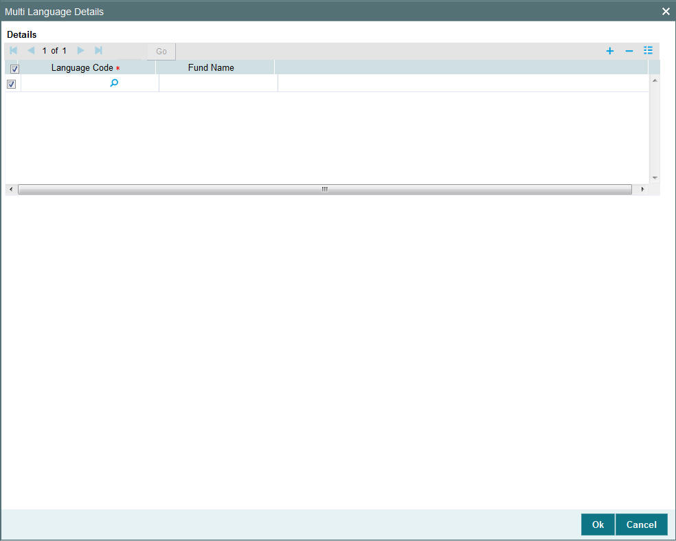

3.1.4 Multi Language Details Button
Click ‘Multi Language Details’ tab to access the Multi Language Details screen.
The Fund Name and the language specified in the Fund Demographics screen are displayed. You can re-enter the fund name in the languages shown in the screen.
Details
Language Code
Specify the language code.
Fund Name
Alphanumeric; 60 Characters; Optional
Specify the fund name.
Refer the chapter Maintaining Reference Information under Reference Information User Manual for information about Multiple language support.
3.1.5 Shares Characteristics Button
The Shares Characteristics fund rule enables you to maintain certificate details for the fund. Further, the fund corpus information, limits on the unit holders and the foreign investors and the account statement information are maintained here.
You can also maintain the rounding precision pattern for allocation of units in this screen.
To set up the Shares Characteristics rule for a fund, use the ‘Shares Characteristics’ screen. You can invoke this screen by clicking ‘Shares Characteristics’ tab from the ‘Fund Rules’ screen.
Note
Before you set up a Shares Characteristics profile record for a fund, it is desirable to en­sure that the fund already has an existing, unauthorized Fund Rules profile record.
You can specify the following details in this section:
Basic Information
Fund ID
Display
This field indicates the ID fund for which you are setting up the Shares Characteristics profile. This information is defaulted from the Fund Demographics screen.
Rule Effective Date
Display
The Rule Effective Date for the fund, which you specified in the Fund Demographics screen, is displayed here.
Scrip Based
Mandatory
Select the scrip based option from the drop-down list. The list displays the following values:
l Certificate -Option
l Scrip Based
l Scrip Less
In this field, you can designate the applicability of certificate issue for investment in the fund. According to the option you select here, you can:
l Designate that certificate issue for the fund is mandatory. This means that certificates must be issued to unit holders for transactions in the fund. To indicate this, choose the ‘Scrip Based’ option in this field.
l Designate that certificate issue is not mandatory for the fund. This means that certificates are not required to be issued to unit holders for transactions in the fund. To indicate this, choose the ‘Scrip Less’ option in this field. If you do so, the fund is a scrip less fund, and you can designate that certificates must be issued only for block transactions, if so needed, by checking the Certificate Required For Block check box in this screen.
l Designate that certificate issue is to be based on the choice of the investor at the time of transacting. In such a case, certificates will be issued only if the investor specifically requests for certificates at the time of entering into a transaction. To indicate this, select ‘Certificate Option’ in this field. Such funds are known in the system as certificate option funds.
You can specify the details of certificate issue for the fund, in the Certificate Details tab in this screen.
Unit Par Value
Numeric; 17 Characters; Mandatory
Enter the Par Value for the fund. Normally, this will be the base price for Initial Public Offer (IPO) period. However, you can change the base price for IPO.
Rounding Option for Units
Mandatory
Select the rounding options for the value of the number of allotted units, designated for the fund from the drop-down list.The list displays the following values:.
l Round Up - Choose ‘Round Up’ to indicate rounding the value at the precision decimal place to the next higher numeral
l Round Off - Choose ‘Round Off’ to indicate normal rounding at the precision decimal
l Round Down - Choose ‘Round Down’ to indicate truncation of the value at the precision decimal place
Example
Let us suppose that the number of allotted units reckoned for a subscription transaction is 100.36497, and that this value must be rounded to the 3rd decimal place.
If you indicate rounding up, then the value reckoned would be 100.365.
If you indicate rounding off, then, applying normal rounding off rules, the value reckoned would be 100.365.
If you indicate rounding down or truncation, then the value would be truncated as it is, in the 3rd decimal place, and it would be reckoned as 100.364.
Min No of Unit Holders
Numeric; 22 Characters; Mandatory
Enter a value to specify the lower limit (i.e.) Minimum Number of unit holders beyond which the system will disable the fund and await action from the Fund Manager. At any point of time, when the fund is enabled, the number of unit holders cannot fall below this value. This value must not be lower than zero.
Min Registered Capital
Numeric; 30 Characters; Mandatory
Enter an amount to specify the Lower limit of Fund Corpus below which the system will await action from the Fund Manager. At any point of time, when the fund is enabled, the fund corpus (registered capital) cannot go below this value.
Rounding Precision for Units
Specify the decimal value or negative value for the units and the units would be reckoned for rounding precision.
Max No of Unit Holders
Enter a value to specify the Upper limit (i.e.) Maximum Number of unit holders beyond which the system will disable the fund and await action from the fund Manager. At any point of time, when the fund is enabled, the number of unit holders cannot go above this value. This value must not be lower than or equal to zero.
Max Registered Capital
Enter an amount to specify the Upper limit of Fund Corpus beyond which the system will await action from the Fund Manager. At any point of time, when the Fund is enabled, the fund corpus (registered capital) cannot go above this value.
Optional
For scrip less funds, select ‘Yes’ from the drop-down list to indicate that certificates must be issued to investors for block transactions in the fund.
Maximum Registered Units
Enter a value to specify the maximum registered units for the fund. A transaction can be allocated only if it does not breach the maximum registered units specified here or at the investor category level. If breached, system will calculate the balance in the fund at the fund level as well at the investor category level, after considering the effect of the transaction to be allotted. If any of the limits are breached, the transaction will not be allocated and marked as error.
You can specify the limits at the fund-investor category level in the ‘Holding Limit for Investor Category’ screen. This screen is explained in detail further in the chapter.
Preferences
In this section, you can set up your preferences for the Foreign Investors limits and the frequency and lead times for Account Statements.
Account Statement Frequency
Mandatory
Select the frequency with which the system should initiate the Account Statement processing, from the drop-down list. The list displays the following values:
l Daily
l Bi-Weekly
l Half Yearly
l Monthly
l Quarterly
l Weekly
l Yearly
This is applicable only if Account Statement is required.
Print Account Statement?
Mandatory
Select ‘Yes’ from drop-down list to indicate that the Account Statement is to be printed for the fund that is being set up.
Account Statement Lead Time
Enter a lead-time in days. This lead-time is to prompt the Registrar that the processing of Account Statement should happen within this lead-time.
Print Holdings Statement?
Mandatory
Select ‘Yes’ from drop-down list to indicate that the Holdings Statement is to be printed for the fund that is being set up.
Foreign Investors Limit
Limit By
Mandatory
Choose ‘Amount’ from the drop-down list if the foreign investors limit is in terms of a flat Amount or choose ‘Percentage’ if the limit is to be defined in terms of percentage of Registered Capital.
Limit Value
Numeric; 12 Characters; Optional
Enter a value to specify the percentage of fund corpus that foreigners are allowed to hold. This could be either a percentage of Fund Corpus or a flat Amount. If it is a percentage, then it cannot be greater than 100.
If this is entered as a flat amount, then it should never exceed or be equal to the figure of one hundred trillion.
Limit Allowed?
Optional
Select ‘Yes’ from drop-down list to indicate the fund that is being set up is allows Foreign Investors to invest in the fund.
Certificate Details
For funds in which certificate generation is mandatory, or is at the option of the unit holder, you must specify the details of the certificate denominations as mandatory information in this section. Therefore, if you have chosen either the ‘Scrip Based’ option or the ‘Certificate Option’ in the Certificate Options field, then you must specify the certificate details as mandatory information in this tab.
If you have chosen the ‘Scrip Less’ option in the Certificate Options field, and have checked the Certificate Required for Block box, then this section is not applicable.
Standard Lot
Enter a value to specify the standard lot for fund. This is also the marketable lot.
Start Issue No.
Enter a value for this field. This is just for information. For a new Fund, the Certificate Numbers will start from this number.
Prefix DNR Code
Alphanumeric; 1 Character; Optional
Enter a character for this field. This will be used as prefix to the Distinctive Number Record (DNR) Number.
This information is only applicable if you have specified the number of decimals for units as zero, in the Number of Decimals for Units field in this screen.
Start DNR No
Enter a value for this field. This is just for information. For new funds, this will be same as last DNR issued number.
Min Cert Denomination
Enter a value to specify the minimum certificate denomination, i.e., the next level of denomination after the standard lot. The system will use this after exhausting the maximum certificate denominations.
Prefix Code
Enter a character for this field. This will be used as prefix to the Certificate Number.
Prefix Certificate Code and Prefix Distinctive Number Record Code will reflect as per maintenance in the report.
Last Issued No.
Display
The system displays the last issued certificate number.
This is to specify that this was the last certificate number that has been issued so far and system needs to start from next number. For new funds, this could be zero. This is also equal to the Start Certificate Issue Number in the case of new Funds.
Last DNR No.
Display
The system displays the last Distinctive Number Record number.
This is to specify that this was the last DNR number that has been issued so far and system needs to start from next number. For new funds, this could be zero. This is also equal to the Start Certificate Issue Number in the case of new Funds.
Max Cert Denomination
Enter a value to specify the maximum certificate denomination. This is the first level of denomination used by the system.
Note
Min. Cert Denomination is 100, Max. Cert Denomination is 1000 and a unit holder purchas­es 5500 units. The certificates will be issued for 5 of 1000 denomination and 5 of 100 de­nomination.
User Override Allowed
Mandatory
Select ‘Yes’ from drop-down list to indicate the user on the unit holder’s request can override the default denominations defined above. If this is enabled, system will allow the teller to override the fund default denominations. This is true only for minimum and maximum denominations. The Standard lot cannot be changed. This is applicable only to scrip-based funds.

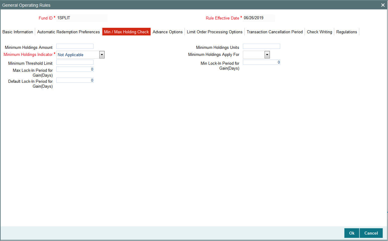

3.1.6 General Operating Rules Tab
This fund rule facilitates the maintenance of guidelines that will govern the operation of the fund with respect to the following parameters:
l The pricing policy, i.e., whether the fund is to be a pre-priced or a post-priced fund. You can also set up the price declare frequency and the next price declare date. If it is a closed-ended fund, you can also set up the maturity date.
l The automatic redemption details, if the fund is to have automatic redemption of units for a unit holder based on the threshold balance.
l The number of decimals for NAV declaration, as well as the lot for NAV
l The Ageing Policy of the fund
l The applicability of charges such as Contingent Deferred Sales Charge (CDSC) for redemption or switch transactions in the fund, as well as the processing order.
l Specification of the NAV Lot
l Dividend Equalization

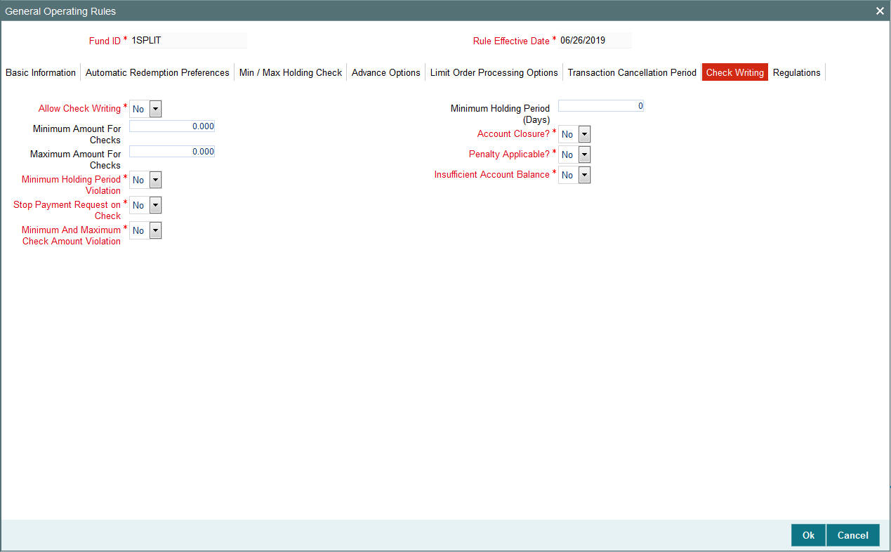

l Rules that govern check writing for the fund, such as:
The limits on the amount for a check
The minimum period for which units must be held in the investor account for the fund, before they are redeemed by a check.
Whether the unit holder can close the account through a redemption check
If the fund is a retirement fund, whether check facility can be made available for the fund
Applicable penalties on check redemption due to contravening any of the limits for check amount, minimum period, or insufficient account balance or stop payment instructions on a check.
l Whether the system should recompute the fund prices and adjust units as per forecast rates, if the fund is a Guaranteed Fund.
To set up the General Operating Rules for a fund, use the General Operating Rules screen. You can invoke this screen by clicking ‘General Operating Rules’ tab from the Fund Rules Detail screen.
Note
Before you set up a General Operating Rules profile record for a fund, it is desirable to en­sure that the fund already has an existing, unauthorized profile record.
Fund ID
Display
This field indicates the ID fund for which you are setting up the General Operating Rules profile. This information is defaulted from the Fund Demographics screen.

3.1.6.1 Basic Information Tab
Click ‘Basic Information’ tab in ‘General Operating Rules’ screen.
Post Priced?
Mandatory
Select ‘Yes’ from the drop-down list to indicate that the price for the fund will be announced Post Transactions.
Next Price Declare Date
Date Format; Mandatory
Specify the next date upon which the fund price is to be declared. This date must be after the Rule Effective Date of the fund, and the current system date.
Price Declare Frequency
Alphanumeric; 1 Character; Mandatory
Select a value to specify the frequency with which the price will be announced, from the options provided.
If you are specifying the General Operating Rules for a Post-priced Fund, you must specify this frequency as Daily
No of Decimals for NAV
Indicate the maximum number of decimals that would be reckoned for rounding precision, for the NAV.
Rounding Options for NAV
Mandatory
Select the rounding options for the value of the NAV for the selected transaction type, for the fund from the drop-down list. The list displays the following values:
Example
Let us suppose that the NAV for the fund on a certain date 02-03-2003 is 10.561234, and that this value must be rounded to the 3rd decimal place.
If you indicate rounding up, then the value reckoned would be 10.562.
If you indicate rounding off, then, applying normal rounding off rules, the value reckoned would be 10.561.
If you indicate rounding down or truncation, then the value would be truncated as it is, in the 3rd decimal place, and it would be reckoned as 10.561.
NAV Lot
Numeric; 6 Characters; Mandatory
Specify the NAV lot.
Money Market Fund?
Mandatory
Select ‘Yes’ from the drop-down list if the fund is for money market.
Multiple Price Basis?
Mandatory
You can use this field to indicate whether multiple price bases are allowed for the fund. Select one of the options from the drop-down list:
l Yes
l No
If you select this option, price bases other than the standard bases such as NAV and the Transaction Base Prices are also allowed for the fund.
Ageing Date
Mandatory
Select the ageing basis for the fund from the drop-down list. The list displays the following values:
l Confirmation Date
l Dealing Date
l Transaction Date
Based on the ageing date specified here, ageing for period based loads are calculated.
By default, the ageing date is the transaction date. You are allowed to specify the ageing basis if you are creating a new fund. You cannot modify this value, post authorization of the fund.
Amount Block Allowed
Optional
Select ‘Yes’ from drop-down list to indicate that the amount block is allowed at the fund level.
Note
You will be allowed to enter details in the Amount Block Maintenance screen provided this box is checked for the fund. Moreover, the amount blocked will not be available for re­demption.
Block Priority Number
Numeric; 4 Characters; Optional
The funds are selected in the ascending order of the priority number .When blocking is done at UH/ CIF level across funds. During Unblock, funds will be selected in the reverse priority of Block.
 This is field is not optional, if check box 'Amount Block Allowed' is Y, it is mandatory. If check box is N, Block priority will be disabled.
Guaranteed Fund
Optional
Select the option ‘Yes’ if you want the system to:
l Re-compute the fund prices and adjust the units to the investors based on the re-forecasted rates during interim periods and actual rate growth during annual rate declaration time
l Share the residual units of investors who have left before interim/annual rate declaration time among the existing investors.
Dividend Equalization Applicable
Optional
Select ‘Yes’ from drop-down list to indicate dividend equalization is applicable.
Funds typically consist of units which have received some benefit in the form of income or dividend distribution and units which have not received any such inflows. The former are G1 units and the latter G2 units.
Since the income and dividend distribution rates are different for units belonging to the G1 and G2 groups, you can apply an equalization rate to equalize the benefit for the G2 units during dividend distribution. This rate will be considered only for the G2 units. To enable application of this rate, select ‘Yes’. Else you can retain the default value ‘No’ to carry out normal dividend distribution.
Note
You cannot maintain stock dividend if you select this option.
Allow Fee Calculation in Transaction Currency
Mandatory
If you select ‘Yes’ from drop-down list, then the field ‘Fee Calculation Basis’ will be provided at the transaction level, where you can indicate that load should be computed in terms of the transaction currency in addition to the fund base currency for the fund.
Maturity Date
Specify the maturity date for the fund. This field is only visible and enabled if the fund is close-ended.
Retain IPO Balance?
Mandatory
Select ‘Yes’ from drop-down list to indicate that the IPO Balance of unit holders must to be stored for later use.
Allow Rejections before Allocation
Mandatory
Select ‘Yes’ from drop-down list to indicate that a rejection of a transaction as applicable, for all authorized transactions, prior to allocation. If this is not specified, then all authorized transactions will be taken up for allocation directly.
Allotment on Check Clearing
Mandatory
Select ‘Yes’ from drop-down list to indicate that allocation must be done on the check clearing date, using the price prevailing on that date, for transactions in which the payment mode is Check.
Ageing Policy
Optional
By default transactions are ordered in a First In First Out (FIFO) basis. If the unit holder has specified as to how transactions are to be ordered, then click on the drop-down menu and select Txn-Receipts. The drop-down list displays the following values:
l FIFO
l IOF/IRRF Optimization
l Txn-Receipts
l FIFO Across Products
l Hierarchy
l USERMNTFIFO
For AMCs, those service distributors, where the distributor books are maintained in the AMC at hierarchical levels mutually decided on through a service level agreement, the option of ageing based on the hierarchy is available.
For funds in which there is a daily declaration of dividend (typically money market funds), and in which redemption transactions would be requested across non-taxable and taxable products, you can select the FIFO Across Products option if required.  This feature is available only if your installation has specifically requested for it.
For Funds where IOF and IRRF taxes are applicable on the profits the ageing policy should selected to be ‘IOF/IRRF’ Optimization.
In case of Certificate Option funds, i.e. if certificate issue is to be based on the choice of the investor at the time of transacting, then the ageing policy can be specified as ‘Hierarchy’.
The USERMNTFIFO aging policy will use the Aging sequence maintained in Fund Preference Maintenance (UTDFPMNT) screen during allocation of outflow transaction.
VAT Percentage
Numeric; 5 Characters; Optional
Specify the VAT percentage.
Exchange Rate Source
Alphanumeric; 6 Characters; Optional
You can specify the exchange rate source from which the exchange rate for cash dividends must be obtained. By default, the exchange rate source that you specify here is used for cash dividends.
Cancel Instruction
Alphanumeric; 2 Characters; Optional
You can use this field to indicate whether standing instructions defined in respect of a unit holder, in the fund, are to be cancelled. If you select this option, the standing instructions for the transaction are cancelled, including those that are to be generated after an automatic redemption occurs. Select the ‘Standing Instruction’ option in this field to indicate cancellation of standing instructions.
If this option has been chosen in the General Operating Rules, the automatic redemption process generates redemption transactions for unit holders in the fund, with the ‘Cancel Instruction’ option automatically set.
If this option is set for an outflow transaction such as redemption, switch or transfer, the End of Day process cancels all standing instructions (irrespective of the transaction type) for the unit holder in the fund after the outflow transactions involving the unit holder have been allocated for the day.
Investment Simulation Method
Mandatory
Specify if the investment simulation option would be applicable for the fund or not by selecting an option from the drop down list. The options are:
l Not Allowed
l Historic NAV Based
Refer to the chapter ‘Generating Reports’ in Volume II of the Agency Branch User Manual for  further information regarding investment simulation.
Fund Risk Level
Numeric; 3 Characters; Optional
Specify fund risk level details. Alternatively, you can select fund risk level from the option list. The list displays all valid fund risk level maintained in the system.
If restricted fund is selected as ‘Yes’, then Fund risk level will be defaulted to null. You can modify it.
Note
You can configure Fund risk level and investor risk level at param maintenance for FUN­DRISKPROFILE and INVRISKPROFILE param codes respectively. The system will vali­date the fund risk for an investor in ‘Investor Fund Risk Rating Mapping’ screen.
Fund Risk Level Description
Display
The system displays the description for the selected fund risk level details.
3.1.6.2 Automatic Redemption Preferences Tab
If the fund is to have automatic redemption of units of the unit holder based on the threshold balance, the preferences and guidelines may be laid down in this section.
Click on ‘Automatic Redemption Preferences’ tab to maintain these details:
Automatic Redemption Allowed?
Mandatory
Select ‘Yes’ from drop-down list to indicate that Automatic Redemption is to be allowed for the fund. This is applicable only for Open Ended funds. When the balance the unit holder falls below a defined minimum level, then the investor will be intimated about it and will be provided with some lead-time to either increase the balance above the minimum level or redeem all his units. After the elapsed lead- time, if the unit holder balance still lies below the defined minimum level, then the automatic redemption of those units will be done.
If automatic redemption is allowed for the fund, and this box is checked, the following fields are enabled:
Elapsed Days
Numeric; 22 Characters’ Optional
Enter the number of days from the date of intimation after which Automatic Redemption will be initiated. This is the lead-time provided to the investor.
Minimum Balance
Numeric; 30 Characters’ Optional
Enter the minimum balance (in amounts / units based on what balance type has been specified above) to be maintained for Automatic Redemption.
Minimum Balance Type
Optional
Select the type of Minimum balance to be maintained for Automatic Redemption from the drop-down list. The list displays the following values:
l Amount
l Units
3.1.6.3 Min / Max Holding Check Tab
You can indicate the minimum/maximum holdings balance that is required for redemption, switch or transfer transaction, for a CIF or an individual unit holder, in the fund. The minimum holdings value can be specified either as an amount, number of units, or redeemable value of units.
Click on ‘Min / Max Holding Check’ tab to maintain these details:
As part of the minimum holdings options, you can also indicate whether the holdings considered for validation are those of all unit holders under a CIF, or for an individual unit holder.
Note
The above check is not validated online during transaction capture or authorization. When there are transactions into a fund violating the minimum holdings validation, the system logs an exception in the Pre-End of Day Check screen. During the End of Day processes, the system allocates the transactions, logging the exceptions in respect of them.
Minimum Holdings Amount
Numeric; 18 Characters; Mandatory if Minimum Holdings Indicator is specified
Specify the minimum redeemable value of holdings in the fund, for a redemption, switch or transfer transaction involving a CIF or individual unit holder.
Example
For the Royal Trust Growth Fund, you have selected the ‘Amount’ option as the Minimum Holdings Indicator for redemption, switch and transfer transactions. You have also specified the Minimum Holdings Amount value as 1200 USD (the fund base currency is USD).
The minimum holdings validation is required to be enforced for individual unit holders and not for CIFs.
Therefore, the redeemable value of total number of units held by an individual unit holder, in the Royal Trust Growth Fund must exceed or equal 1200 USD, for a redemption, switch or transfer transaction involving the unit holder.
Mandatory
Select the basis upon which the minimum holdings check is performed from the drop-down list. The list displays the following values:
l Amount: The value of holdings (at redemption price). If you choose this option you must specify the minimum amount in the Minimum Holdings Amount field. If the check is to apply at CIF level, the redeemable value of units held by all unit holders under the CIF in the fund is checked against the Minimum Holdings Amount.
l Units: The number of units held. If you choose this option you must specify the minimum number of units in the Minimum Holdings Units field. If the check is to apply at CIF level, the total number of units held by all unit holders under the CIF in the fund is checked against the Minimum Holdings Units.
l Lower of Amount/Units: The minimum amount specified or the redeemable value of minimum units specified, whichever is lower.
l Higher of Amount/ Units: The minimum amount specified or the redeemable value of minimum units specified whichever is higher.
l Not Applicable: The minimum holdings validation is not performed if you choose this option.
If you choose either of the last two options (Lower of Amount/Units or Higher of Amount/Units), you must specify the applicable minimum amount in the Minimum Holdings Amount field as well as the applicable minimum number of units in the Minimum Holdings Units field. Also, in either case, the redeemable value of the total number of units held by all investors under the CIF is considered for validation, if the check is to apply at CIF level.
Minimum Threshold limit
Specify the percentage value to be applied on minimum balance amount or units setup here.
Max Lock-in Period for Gain (Days)
Specify the maximum lock-in period beyond which if the subscription is redeemed gains would be passed over to the Unitholder and so IOF and IRRF taxes will be applicable. This should be greater than or equal to the Min Lock-in Period.
Note
When a transaction is redeemed within the Lock-In period, redemption happens at the low­est applicable NAV as on date of Subscription or on the date of Redemption.
Default Lock-in Period for Gain (Days)
Specify the default lock-in period within which if the subscription is redeemed no gains would be passed over to the Unitholder and so IOF and IRRF taxes will not be applicable.
Note
The default lock-in period should be within the minimum and maximum lock in period.
Numeric; 27 Characters; Mandatory if Minimum Holdings Indicator is specified
Specify the minimum number of units required to be held by an individual unit holder, or a CIF, in the fund, for a redemption, switch or transfer transaction.
Example
For the Carey Bugle Growth Fund, you have selected the ‘Units’ option as the Minimum Holdings Indicator for redemption, switch and transfer transactions. You have also specified the Minimum Holdings Units value as 1000.
Therefore, the total number of units held by an individual unit holder, in the Carey Bugle Growth Fund must equal or exceed 1000 units, for a redemption, switch or transfer transaction involving the unit holder.
A note on the minimum holdings validation
If the Minimum Holdings Indicator selected is ‘Lower of Amount/Units’, the redeemable value of the specified Minimum Holdings Units is arrived at, and compared with the Minimum Holdings Amount specified. The lower of the two values is considered as the minimum holdings value against which the minimum holdings validation would be made. Similarly, if the Minimum Holdings Indicator selected is ‘Higher of Amount/Units’, the redeemable value of the specified Minimum Holdings Units is arrived at, and compared with the Minimum Holdings Amount specified, and the higher of the two values is considered as the minimum holdings value against which the minimum holdings validation would be made.
Example
For the Burton Carey Growth Fund, you have selected the ‘Lower of Amount/Units’ option as the Minimum Holdings Indicator for redemption, switch and transfer transactions. You have also specified the Minimum Holdings Amount value as 1200 USD, and the Minimum Holdings Units value as 1000 units.
The minimum holdings validation is required to be enforced for CIFs, and not for individual unit holders.
To arrive at the minimum holdings value against which the validation would be made, the redeemable value of 1000 units is computed, at the redemption price. If the redemption price is 0.8, the redeemable value = 1000 * 0.8 = 800 USD.
The redeemable value obtained (800 USD) is compared with the Minimum Holdings Amount specified (1200 USD). Since the Minimum Holdings Indicator chosen is ‘Lower of Amount/Units’, the minimum holdings value to be validated against, is 800 USD.  Therefore, the redeemable value of total number of units held by all unit holders under a CIF, in the Burton Carey Fund must equal or exceed 800 USD, for redemption, switch or transfer transaction involving a CIF.
If the Minimum Holdings Indicator were selected as ‘Higher of Amount/Units’, the higher value (1200 USD) would be considered as the minimum holdings value against which the validation would be made. Therefore, the redeemable value of total number of units held by all unit holders under a CIF, in the Burton Carey Fund would have to equal or exceed 1200 USD, for a redemption, switch or transfer transaction involving a CIF.
Minimum Holdings Apply For
Optional
Select whether the minimum holdings check is applicable for CIFs, or for individual unit holders from the drop-down list. The list displays the following values:
l CIF
l Unit Holder
If you select ‘CIF’ option, the redeemable value of the total number of units held by all unit holders under the CIF in the fund is considered for validation.
Min Lock-in Period for Gain (Days)
Specify the minimum lock-in period applicable for the fund. During subscription transaction, the lock-in period specified at the transaction level should be equal to or greater than the minimum period indicated here.
3.1.6.4 Advance Options Tab
Click on ‘Advance Options’ tab to maintain specify advance options:
You can specify the following fields in this screen:
GO Applicable?
Mandatory
Select if GO is applicable or not from the adjoining drop-down list. Following are the options available:
l Yes
l No
l With Trading Box
.If the value ‘Yes’ is selected, then the fund will be eligible for ‘GO’ generation. If the value ‘No’ is selected, then the fund will not be eligible for GO generation. However, if the value ‘with trading box’ is selected, then the fund will be eligible for GO generation by applying the trading box functionality and not the GO Maintenance feature.
Refer the Suspense Accounts, Statutory Accounts and Trading chapter in the Fund Manager
User Manual for a fuller discussion of the trading functions available in the FC-IS system.
CDSC Fund?
If Contingent Deferred Sales Charge (CDSC) is applicable for transactions in this fund, then specify the CDSC calculation method to be used for the fund. The options are:
l LOCOM – Lower of cost or Market Value
l Market Price – Market appreciation method
l Class B – CDSC Class B method
l Not Applicable – CDSC not applicable
l Redemption Value - Redemption method
The CDSC load should be of period based. CDSC fund load set up for redemption method to derive the CDSC amount is calculated as follows:
CDSC Load Amount = NR Units * Redemption TBP * CDSC Load %
CDSC Applicable for Switches?
Optional
Select ‘Yes’ from drop-down list to indicate that the Contingent Deferred Sales Charge (CDSC) must be applicable to switch or exchange transactions.
Reinvestments First
Optional
Select ‘Yes’ from drop-down list to indicate that reinvestment transactions must be taken up first for aging during computation of Contingent Deferred Sales Charge for redemption transactions in this fund.
This field is not applicable for onshore funds having ‘USERMNTFIFO’ ageing Logic.
Interest Rate
Numeric; 15 Characters; Optional
Specify the interest rate.
Performance Fee Threshold
Specify the performance fee threshold details.
EUSD Scope
Optional
Select the EUSD scope of the fund from the drop-down list. The list displays the following values:
l Redemption and Switch
l Dividend
l Both
 i.e. if EUSD is applicable only for redemption and switch transactions or only for dividend or for both.
Swinging Price Basis
Display
The system displays the Swinging Price Basis as maintained at the Fund Family Level.
If swinging price basis is not ‘No’ at the fund level, then reference currency and exchange rate source fields should be maintained at the fund family level. The sale value of the funds is converted to the reference currency to arrive at the swinging price.
Include Holding Period
Optional
Select whether the holding period should be considered or not from the drop-down list, while calculating the age of investments during computation of Contingent Deferred Sales Charge.
Note
This option will be enabled only for CDSC applicable funds.
Threshold Basis
Mandatory if the swinging price basis is semi swinging
Select the basis as Amount or Percentage from the drop-down list.
Dilution Levy Applicable
Optional
Select ‘Yes’ from drop-down list if dilution levy is applicable for the fund or else select ‘No’. Outflow and inflow breach factor can be maintained only if the value in this field is maintained as ‘Yes’. To arrive at dilution breach limit amount the system considers the inflow breach factor for IN transactions and the Outflow breach factor for OUT transactions.
Threshold Value
Numeric; 30 Characters; Mandatory if the swinging price basis is semi swinging
Specify the threshold value for the semi swinging price basis fund.
Only daily priced funds can be grouped under a fund family. For non daily price funds, if swinging price is applicable, each fund will have to be mapped to a separate family.
Inflow Breach Factor(%)
Specify the breach factor for inflow transactions, as a percentage of the fund value upon which dilution levy is applicable.
Outflow Breach Factor
Specify the breach factor for outflow transactions, as a percentage of the fund value, upon which dilution levy is applicable.
Fund Tax Class
Alphanumeric; 3 Characters; Optional
Specify tax class of a fund details. Alternatively, you can select fund tax class details from the option list. The list displays all valid fund tax Class details maintained in the system.
Fund Grouping
Specify fund grouping details to group the funds under one fund. Alternatively, you can select fund grouping details from the option list. The list displays all valid fund grouping details maintained in the system.
You can group the different Tax Class Funds under one group for Tax Class Switch using this field. If you want to create four funds in the system, then the fund group ID should be one of the fund IDs of the four funds that you intend to create.
WAC Method
Optional
Select the WAC method from the drop-down list. The list display the following values:
l Regular WAC - To compute regular WAC
l Life WAC - to compute life WAC
If you select Life WAC and Base Cost is not provided while capturing a transaction, then the system will calculate Weighted Average Cost (WAC) as follows:
LIFE WAC = ((No of units in the fund before inflow) * (WAC before inflow) + (No of units in the inflow for fund) * (Unit Price of inflow)) / (Total Units in Fund)
Where,
Unit price = (Net investment amount) / number of units purchased
Net Investment amount = Gross investment amount – all Fee except the ones which are paid to AMC
The net investment amount will not exclude any Fee for which To Entity is AMC. The system will deduct any other fee (apart from those where To Entity is AMC) from the gross investment amount to arrive at the net investment amount.
Total units in Fund = (No of units in the fund) + (No of units in the inflow for the fund)
If you select a product with WAC method as LIFE WAC, and if a Switch transaction is done within the same Fund Family and Base Cost is not provided while capturing the transaction then the system will calculate WAC as follows:
Life WAC = ((No of units rolling over) * (WAC in ‘From’ Fund) + (No of units in the ‘To’ fund) * (WAC in ‘To’ Fund)) / (Total Units in ‘To’ Fund)
Where Total units in ‘To’ Fund = (No of units rolling over into To Fund) + (No of units in the ‘To’ fund)
The system will calculate Capital Gain or Loss as follows:
Gain / Loss = Units surrendered / redeemed from Fund* ((Price of fund on the date of Redemption / Surrender) – WAC for fund)
If there is a gain then Capital Gain Tax has to be deducted.
To deduct the capital Gain Tax, a separate Load will be mapped under Product load mapping as post allocation load. If the Slab basis is selected as weighted average then this load will be applied on the Gain portion and tax will be deducted and only the net amount will be paid to the customer.
If the Fund Family of Switch Out and Switch In Fund is same, the calculations for the Switch Out Leg will change to the extent wherein Gain will be calculated as 0.
Processing of Swinging Price
For a swinging price fund, the system computes the net transaction of sales value (Inflow - Outflow) on the application date (current date) at fund family level for the given fund and arrives at the fund price
l Net of Sales Value is Positive: The system applies the offer price to all transactions as per the maintenance at fund family level.
l Net of Sales Value is Negative: The system applies the bid price to all transactions as per maintenance at fund family level.
l Net of sales value is Zero: The system applies the mid price that is, (bid price+ offer price)/2
The gross amount in the fund family base currency is used for the net of sales value computation. For unit based transactions, the net sales is computed as follows: units applied * latest available NAV.
For Semi Swinging Funds, the system computes the net of sales value (Inflow – Outflow) for transaction date at fund family level for the given fund and arrives at the fund price based on threshold basis at fund level as follows:
If Threshold Basis is Amount then:
l System applies Offer price, if net of sales value is greater than threshold value.
l System applies Bid price, if net of sales value is less than (-1) * Threshold value.
l System applies Mid price ((Offer Price + Bid Price)/ 2), if Net of sales value is between (-1) * threshold value and threshold value.
If Threshold Basis is Percentage then:
l System applies offer price, if net of sales value is greater than threshold value percentage of Net Asset Value (NAV) of the fund.
l System applies bid price, if net of sales value is less than (-1) * threshold value percentage of net asset value of the fund.
l System applies mid price ((Offer Price + Bid Price)/ 2), if net of sales value is between (-1) * threshold value and threshold value percentage of net asset value of the fund.
Net asset value of the fund is computed as the BOD outstanding units * latest available NAV. The reference types mapped at fund family level is used to compute the net of sales value. The swinging price computed is used for unitizing all transaction types mapped at fund family level.
For transaction types not mapped at fund family level, the system does not use swinging price. The system uses the gross amount in fund base currency for net of sales value computation. For unit based transactions, the net of sales is computed by using units applied * latest available NAV.
A mini EOD computes and populates the swinging price and swinging price basis for Swinging Price and Semi Swinging Price Fund. This mini EOD is run during the day to arrive at the Total Inflow, Total Outflow, and Net Sales value.
3.1.6.5 Limit Order Processing Options Tab
Click on ‘Limit Order Processing Options’ tab to maintain these details:
Allow Limit Orders
Optional
Select ‘Yes’ from drop-down list to indicate that limit order processing is enabled for the fund.
Allow Future Dated Transaction
Optional
Select ‘Yes’ from drop-down list to indicate that future dated transactions, in respect of limit order processing, are allowed for the fund.
Automatic Processing
Optional
Select ‘Yes’ from drop-down list to indicate that automatic processing, in respect of limit order processing, is allowed for the fund.
This option is intended for funds floated by your AMC.  If automatic processing is enabled for such funds, the limit order transactions are automatically generated and allocated by the end of day processes according to the price and date options specified.  For third party funds, where your AMC would proceed with limit order processing only after appropriate confirmation is received, you could disable this option.
Pricing Rule
Optional
Select the option to be considered if the date on which the limit order is to be executed is a fund or system/ AMC holiday. You could indicate that the transaction be generated prior to the holiday, or following the holiday. Select the appropriate option (Prior or After) from the drop-down list.

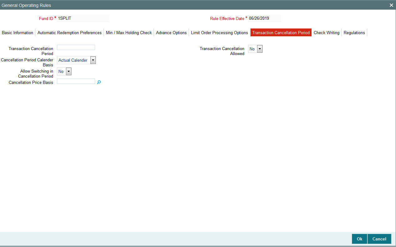

3.1.6.6 Transaction Cancellation Period Tab
In this section, you must maintain the options in the fund rules for processing cancellations of transactions. Click on the ‘Transaction Cancellation Period’ Tab to maintain the details:
You can specify a number of calendar days that represents a period from the date of transaction within which cancellations are allowed.
Transaction Cancellation Allowed
Optional
Select whether cancellation is allowed for the fund. Choose ‘Yes’ from the drop-down list if you wish to allow cancellation or else choose ‘No’.
Cancellation Period Calendar Basis
Optional
Select the cancellation period from the drop-down list. The list displays the following values:
l Actual Calendar
l System Calendar
l AMC Calendar
l Fund Calendar
Allow Switching in Cancellation Period
Optional
You can specify if you wish to allow switch transactions any time within the cancellation period. Choose ‘Yes’ from drop-down list to allow switches in the holdings due to the transaction else choose ‘No’.
Cancellation Price Basis
Alphanumeric; 10 Characters; Optional
Specify the price basis to be followed for cancellations. The price basis could be NAV for a single pricing fund. For other type of funds, the basis could be Bid or Offer Price.
The current market value computation as well as the cancellation amount would depend on the bid / offer / NAV.
The system will consider original Subscription price as cancellation price during allocation. While adding subscription load amounts to redemption proceeds, the system will consider only Fee paid by the unitholder.
3.1.6.7 Check Writing Tab
In this section, you can specify the rules that govern check writing for the fund, such as:
l Whether check writing is allowed to investors for this fund
l The limits on the amount for a check.
l The minimum period for which units must be held in the investor account for the fund, before they are redeemed by a check.
l Whether the unit holder can close the account through a redemption check
l If the fund is a retirement fund, whether check facility can be made available for the fund
l Applicable penalties on check redemption due to contravening any of the limits for check amount, minimum period, or insufficient account balance or stop payment instructions on a check.
Click on the ‘Check Writing’ Tab to indicate the check writing options:
Allow Check Writing
Mandatory
You can use this field to indicate whether cheque writing facility is allowed for investors who invest in this fund. Select ‘Yes’ from drop-down list to indicate that cheque writing is allowed.
Minimum Amount for Checks
Numeric; 18 Characters; Optional - If cheque writing is allowed for the fund, then this information is mandatory.
Specify the minimum amount that can be redeemed through a redemption cheque, for investors holding balances in the fund, who have opted for cheque writing facility. If the amount written on a cheque falls below this value, the cheque attracts penal charges.
Maximum Amount for Checks
Numeric, 18 Characters; Optional - If cheque writing is allowed for the fund, then this information is mandatory.
Specify the maximum amount that can be redeemed through a redemption cheque, for investors holding balances in the fund, who have opted for cheque writing facility. If the amount written on a cheque exceeds this value, the cheque attracts penal charges.
Minimum Holding Period Violation
Mandatory
You can use this field to indicate whether a violation of the holding period for balances in this fund, by a unit holder using the cheque writing facility must be validated for. Select ‘Yes’ from drop-down list to indicate validating of violation of the holding period.
Stop Payment Request on Check
Mandatory
You can use this field to indicate whether a stop payment request can be applied on a cheque issued by a unit holder availing cheque writing facility, for this fund. Select ‘Yes’ from drop-down list to indicate that a stop payment can be applied.
Minimum and Maximum Check Amount Violation
Mandatory
You can use this field to indicate whether a violation of the minimum and maximum cheque amounts by a unit holder using the cheque writing facility in this fund, must be validated for. Select ‘Yes’ from drop-down list to indicate validating of violation of the maximum and minimum cheque amounts.
Minimum Holding Period (Days)
Numeric; 5 Characters; Optional - If check writing is allowed for the fund, then this information is mandatory.
Specify the minimum number of days for which units must be held in the investor account before they can be redeemed through a redemption cheque.
Account Closure
Mandatory
You can use this field to indicate whether an investor can close the unit holder account through cheque redemption. Select ‘Yes’ from drop-down list to indicate that account closure through cheque writing is allowed.
Penalty Applicable
Mandatory
You can use this field to indicate whether an investor can close the unit holder account through a cheque redemption. Select ‘Yes’ from drop-down list to indicate that account closure through cheque writing is allowed.
Insufficient Account Balance
Mandatory
You can use this field to indicate whether insufficient balance in this fund, in the account of a unit holder using the cheque writing facility must be validated for. Select ‘Yes’ from drop-down list to indicate validating of insufficient balance situations.
3.1.6.8 Regulations Tab
In this section you can capture the details regarding Foreign Account Tax Compliance Act. Click on ‘Regulations’ tab to maintain the details.
FATCA Information
FATCA Applicable
Mandatory
Select Yes or No from drop-down list to indicate whether FATCA is applicable. However, the system defaults the value ‘No’.
Employer ID Number (EIN)
Display
The system displays the employer ID number.
FATCA Classification
Select the classification of FATCA from the adjoining option list. FATCA Classification is mandatory if FATCA Applicable is ‘Yes’.
Classification Description
Display
The system displays the description for the selected FATCA classification code.
FATCA Reason
Alphanumeric; 255 Characters; Optional
Specify the reason for FATCA classification.
FATCA Effective Date
Date Format; Optional
Specify the FATCA Effective Date if FATCA is applicable.
FATCA Effective Date cannot be lesser than the fund start date.
FATCA Sponsor Type
Optional
Select the type of FATCA sponsor from the drop-down list. Following are the options available in the drop-down list:
l Sponsoring Entity
l Sponsored
FATCA WHT Applicable
Optional
Select if FATCA WHT is applicable or not from the drop-down list. Following are the options available in the drop-down list:
l Yes
l No
Sponsoring Entity Type
Alphanumeric; 1 Characters; Optional
Specify the sponsoring Entity type. You can also select the valid sponsoring entity type from the adjoining option list.
FATCA WHT Indicator
Optional
Select the FATCA WHT indicator from the drop-down list. Following are the options available in the drop-down list:
l Exchange Info
l Withhold
Sponsoring Entity ID
Alphanumeric; 12 Characters; Optional
Specify the sponsoring Entity ID. You can also select the valid sponsoring entity ID from the adjoining option list.
FATCA WHT Dividend Level
Optional
Select the FATCA WHT dividend level from the drop-down list. Following are the options available in the drop-down list:
l Yes
l No
Global Intermediary Identification Number (GIIN)
Alphanumeric; 30 Characters; Optional
Specify the global intermediary identification number.
FATCA WHT Intermediary Commission
Optional
Select the FATCA WHT broker commission from the drop-down list. Following are the options available in the drop-down list:
l Yes
l No
GIIN Issue Date
Specify the GIIN issue date.
The GIIN issue date cannot be greater than the application date.
FATCA WHT Trailer Commission
Optional
Select the FATCA WHT trailer commission from the drop-down list. Following are the options available in the drop-down list:
l Yes
l No
GIIN Expiry Date
Specify the GIIN expiry date.
The GIIN expiry date cannot be lesser than the GIIN issue date.
GIIN Verified Flag
Display
System displays the GIIN verified flag based on the GIIN. If you specify the GIIN then, GIIN verified flag gets displayed as ‘No’. If you select the GIIN then, GIIN verified Flag gets displayed as ‘Yes’.
UCITS Fund
UCITS Fund
Optional
Select if the fund is UCITS or not from the drop-down list. The list displays the following values:
l Yes
l No
MIFID
MIFID Fund
Optional
Select if the fund is scoped under MIFID regulation or not from the drop-down list. The list displays the following values:
l Yes
l No
Target Market
Specify the country code of the Country to which the product is sold as part of MIFID regulation. Alternatively, you can select the country code maintained in the system. The system displays all valid country code maintained in the system.
Investment Horizon
Optional
Select the investment objective from the drop-down list. The list displays the following values:
l Long Term
l Medium Term
l Short Term
MIFID Product Classification
Specify the MIFID Product Complexity details. It is a mandatory field for MIFID funds.
MIFID Product Classification Description
Display
The system displays the description of the selected MIFID Product Complexity.

l Whether limit orders may be processed for the fund
l Whether future dated transactions are allowed for the fund
l Whether automatic processing in respect of limit orders is allowed for the fund
l The pricing rule to be applicable, if the specified date falls on a holiday
Automatic processing for limit orders involves the automatic generation of buy or sell transactions. If your AMC processes limit orders for third party funds, and must wait for confirmation before processing the orders on the specified dates, you might need to disable automatic processing.
You specify the limit order options in the Limit Order Processing Options section of the General Operating Rules screen.
3.1.6.11 Indicating Re-computation of Fund Prices and Adjustment of Units
The fund prices of funds like Employee Benefit Growth Fund are derived based on the forecasted rate of growth. The rates will be re-forecasted in the interim several times and the actual rate of growth is published at the end of the year.
If you choose the option ‘Yes’ for Guaranteed Funds, the system will:
Example
Let us assume that a Fund (F100) is launched with the price of 10 ZAR with the forecasted rate of 10% per annum. Consequently, 10 * 10/ (100 * 365) = 0.0027 will be the increase in price till a new rate is declared. Please note that the price used here is an example and not the exact formulae as such.
Day 0    10 ZAR
Day 1    10.0027 ZAR
Day 2    10.0054 ZAR
Day 3    10.0081 ZAR
Day 4    10.0108 ZAR
Day 5    10.0135 ZAR
Day 100    10.27 ZAR
Day 101    10.2727 ZAR
Day 102    10.2754 ZAR
Day 103    10.2781 ZAR and so on….
If an investor invests on Day 2 the transaction will get unitized using the price 10.0054…
Assume these are trades captured on Day 2 @ 10.0054…
UH ID
Fund ID
Subscription Amount (in ZAR)
Units
UH1
F100
10,000
999.460
UH2
F100
20,000
1998.921
UH3
F100
30,000
2998.381
UH4
F100
35,000
3498.111
UH5
F100
25,000
2498.651
UH6
F100
15,000
1499.190
Assume these are trades captured on Day 100 @ 10.27…
UH ID
Fund ID
Redeems Units
Redeems Proceeds (in ZAR)
UH1
F100
100
1027.00 ZAR
UH5
F100
2498.651
25661.15 ZAR
Therefore, the balance of the investors in Fund F100 will be:
UH ID
Fund ID
Balance (in Units)
UH1
F100
899.460
UH2
F100
1998.921
UH3
F100
2998.381
UH4
F100
3498.111
UH5
F100
0
UH6
F100
1499.190
Let us assume that a Fund Manager revises an interim forecast of 11% instead of 10%. Consequently, all the trades that are unitized during the current fiscal year of the fund will be considered for impact and the units will be recomputed based on the new prices.
Day 0    10 ZAR
Day 1    10.003 ZAR
Day 2    10.006 ZAR
Day 3    10.009 ZAR
Day 4    10.012 ZAR
Day 5    10.015 ZAR
Day 100    10.30 ZAR
Day 101    10.3030 ZAR
Day 102    10.3060 ZAR
Day 103    10.3090 ZAR
After subscription, the adjustment for the investors in F100 will be:
UH ID
Fund ID
Balance (in Units)
UH1
F100
999.1008 (Difference in  units - 0.3595)
UH2
F100
1998.2020 (Difference in  units-0.7190)
UH3
F100
2997.3020 (Difference in units - 1.0784)
UH4
F100
3496.8530  (Difference in Units - 1.2582)
UH5
F100
2497.7520 (Difference in Units - 0.8987)
UH6
F100
1498.6510 (Difference in units 0.5392)
The adjustment due to redemption will be:
UH ID
Fund ID
Balance (in Units)
UH1
F100
99.7087 (Difference units 0.3595)
UH5
F100
2491.3740 (Difference in units 0.8987)
The new/actual Balances are:
UH ID
Fund ID
Balance (in Units)
UH1
F100
899.3921
UH2
F100
1998.2020
UH3
F100
2997.3020
UH4
F100
3496.8530
UH5
F100
6.3780
UH6
F100
1498.6510
Based on this condition, the system redeems certain number of units from each investor.
UH ID
Fund ID
Balance (in Units)
UH1
F100
899.3921 - 899.460 = 0.0679
UH2
F100
1998.2020 - 1998.921 = 0.719
UH3
F100
2997.3020 - 2998.381 = 1.079
UH4
F100
3496.8530 - 3498.111 = 1.258
UH5
F100
6.3780 – 0 = 6.378
UH6
F100
1498.6510 - 1499.190 = 0.539
The system will generate a redemption transaction for the above adjustment units excluding the Investor UH5 and will be available for reporting only in case of interim run. If it is on actual rate at the end of the year, the same will be shared with other investors proportionately.
When the next interim or actual run is executed the system will ignore these adjustment redemptions and while adjusting units these adjusted units will taken into account.

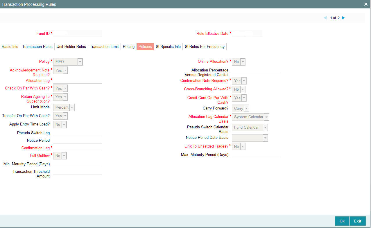

3.1.7 Transaction Processing Rules Button
This fund rule lays down the guidelines according to which transactions of each transaction type will be processed for each fund. These guidelines include the following:
l The frequency at which the transaction will be processed, and the times, periods and date ranges during which it may be processed. The cut-off times for accepting transactions can also be maintained here.
l The limits on the number of transactions allowed for a unit holder in the fund.
l The volume ranges of the transaction, both in amount and units, and the volumes allowed for specific investor categories in the fund.
l The pricing details, such as the basis of price definition, the base price factor, the number of decimals for the price, the price lag and the back dating limits.
l Allocation details such as allowing of online allocation, credit card/check allocation on par with cash, allocation and confirmation lags, and the allocation policies.
l The limit redemption mode, which can be either percentage of holdings, amount or units.
l The limits for initial transactions and standing instructions transactions.
l The limits for transactions accepted through different means of purchase.
l The final rounding precision patterns for transaction base prices and unit prices.
l The final rounding precision for the computation of units, for each transaction type.
l The rules for gross or net processing modes for IPO, subscription and redemption transactions for a fund.
l The payments lag, if any, to be applicable for redemption payouts.
l The minimum holdings required for standing instruction transactions in the fund
To set up the Transaction Processing Rules for a fund, use the Transaction Processing Rules screen.
You can invoke this screen by clicking ‘Transaction Processing Rules’ button from the ‘Fund Rules’ screen.
The screen displays the details of the fund for which the rules are being set up, in the Fund Information section, and the details of all Transaction Processing Rules already maintained for any transaction type, in the Maintained Transaction Details section. It also contains the following data entry sections, each of which can be invoked by clicking the appropriate tab:
l Basic Information
l Transaction Rules
l Unit Holder Rules
l Transaction Limits
l Pricing
l Policies
l Si Specific Info
l SI Rules for Frequency
The details of rules that have already been made for any transaction types, if any, are displayed in the Maintained Transaction Details section. The following information is displayed in the box for each transaction type, and clicking on the row of each transaction type will cause the transaction processing rules profile for that transaction type to be displayed in the lower portion of the screen, and in each of the sections.
If you need to view all the details of a particular transaction processing rules profile for a transaction type in the fund, click that transaction type in this box and the profile will be populated in the lower half of the screen and in the sections.
Note
Before you set up a Transaction Processing Rules profile record for a fund and transaction type, it is desirable to ensure that the following information is already setup in the system:
The fund already has an existing, unauthorized Fund Rules profile record.
The fund already has an existing, unauthorized Shares Characteristics profile re­cord.
You can specify the following fields:
Fund ID
Display
This field indicates the ID fund for which you are setting up the Transaction Processing Rules profile. This information is defaulted from the Fund Demographics screen.
Rule Effective Date
Display
3.1.7.1 Basic Info Tab
Transaction Type
Alphanumeric; 2 Characters; Mandatory
Specify the transaction type for which a transaction processing rules profile has been maintained for the fund.
Transaction Type Description
Display
The system displays the description for the selected transaction type.
Transaction Frequency
Mandatory
Select the frequency at which the transaction type will operate for the fund from the drop-down list. The list displays the following values:
l Daily
l Weekly
l Bi-weekly
l Monthly
l Quarterly
l Half-Yearly
l Yearly
Transaction Enabled?
Mandatory
Select ‘Yes’ from the drop-down list to indicate that the transaction is enabled for the fund. It is possible to set up a temporary suspension of transactions, even if the transactions are open for the fund.
Start Date
Specify the date from which the transaction type is enabled for transaction entry and processing for the fund.
End Date
Specify the date up to which the transaction type is enabled for transaction entry and processing for the fund.
Gross Amount
Mandatory
Select if the processing mode for transaction type is gross or not from the drop-down list.
Net Amount
Mandatory
Select if the processing mode for transaction type is Net or not from the drop-down list.
Gross Unit
Mandatory
Select ‘Yes’ for gross units from the drop-down list.
For transactions with a gross processing mode, the value of the transaction, whether as an amount or a number of units, will be processed as a gross value from which any applicable charges will be deducted.
Note
Opting for a gross or net mode in transaction processing is mode is only available for IPO, subscription or redemption transactions.
Net Unit
Mandatory
For transactions with a net processing mode, the amount value of the transaction will be processed as a net value apart from the charges.
Transaction Suspended?
Mandatory
You can use this field to suspend transactions of specific types for a fund.  Check this box to indicate that the transactions of the selected type are suspended for the fund.  The suspension would be enforced for transactions of the specific type both entered through the Transaction Detail screens as well as system-generated and uploaded transactions.
Note
If the fund is suspended (as specified in the Fund Demographics), transactions of all types are not allowed into the fund.  If the fund is not suspended, transactions of specific types that have been suspended for the fund in the Transaction Processing Rules (if any) are not allowed
Restrict Sale to Investor
Mandatory
You can use this field to indicate that transactions of the selected type, into the fund must only be available to existing customers, and not to new customers. Select ‘Yes’ from drop-down list to indicate this.
If no such restrictions are applicable, select ‘No’ in this field.
When the system applies this restriction, it considers a new investor to be one whose balance holding in the fund is zero. This restriction is only applicable to the inflow transaction types subscription, switch in and transfer.
Maximum IPO Issue Size
Numeric; 27 Characters; Optional
Specify the maximum issue size for IPO transactions in the fund. This value places a restriction on the total IPO order value for the fund. If the total order value units exceed the maximum issue size, the number of allocated units is computed as follows:
Quantity allotted = Quantity applied * (Maximum issue size / Total order value)
Allow Systematic Plans?
Optional
Select ‘Yes’ from drop-down list to allow systematic plans. Select ‘No’ if you do not wish to allow systematic investment plans.
This indicator would be allowed for capture for IPO Subscription, Subscription, Redemption, Transfer and Switch type of transactions.

SI Minimum Holdings Units
Specify the minimum number of units required to be held by an individual unit holder, or a CIF, in the fund, for an IPO or subscription transaction in respect of a standing instruction.
Example
For the Carey Bugle Growth Fund, you have selected the ‘Units’ option as the Minimum Holdings Indicator for IPO or subscription transactions that would be generated in respect of standing instructions. You have also specified the Minimum Holdings Units value as 1000.
Therefore, the total number of units held by an individual unit holder, in the Carey Bugle Growth Fund must equal or exceed 1000 USD, for an IPO or subscription transaction in respect of a standing instruction involving the unit holder.
Example
For the Burton Carey Growth Fund, you have selected the ‘Lower of Amount/Units’ option as the Minimum Holdings Indicator to be validated for successful generation of an IPO or subscription transaction in respect of a standing instruction. You have also specified the Minimum Holdings Amount value as 1200 USD, and the Minimum Holdings Units value as 1000.
The redeemable value obtained (800 USD) is compared with the Minimum Holdings Amount specified (1200 USD). Since the Minimum Holdings Indicator chosen is ‘Lower of Amount/Units’, the minimum holdings value to be validated against, is 800 USD. Therefore, the redeemable value of total number of units held by all unit holders under a CIF, in the Burton Carey Fund must equal or exceed 800 USD, for an IPO or subscription transaction in respect of a standing instruction involving a CIF.
If the Minimum Holdings Indicator were selected as ‘Higher of Amount/Units’, the higher value (1200 USD) would be considered as the minimum holdings value against which the validation would be made. Therefore, the redeemable value of total number of units held by all unit holders under a CIF, in the Burton Carey Fund would have to equal or exceed 1200 USD, for an IPO or subscription transaction in respect of a standing instruction involving a CIF.
SI Minimum Holdings Apply For
Optional
l CIF
l Unit Holder
If the check is to apply at CIF level, the redeemable value of the total number of units held by all investors under the CIF in the fund is considered for validation.
Max. Initial Transaction Amount
Specify the maximum amount permitted for an initial transaction, for an investor in this fund.
Max. Initial Transaction Units
Specify the maximum number of units permitted for an initial transaction, for an investor in this fund.
SI Minimum Holdings Indicator
Mandatory
l Amount: The value of holdings (at redemption price). If you choose this option you must specify the minimum amount in the Minimum Holdings Amount field. If the check is to apply at CIF level, the redeemable value of units held by all investors under the CIF in the fund is checked against the Minimum Holdings Amount.
l Units: The number of units held. If you choose this option you must specify the minimum number of units in the Minimum Holdings Units field. If the check is to apply at CIF level, the total number of units held by all investors under the CIF in the fund is checked against the Minimum Holdings Units.
l Higher of Amount/ Units: The minimum amount specified or the redeemable value of minimum units specified, whichever is higher.
l Not Applicable: The minimum holdings validation is not performed if this option is chosen. For standing instructions involving transactions in the fund, the holdings validation cannot be set.

3.1.7.5 Pricing Tab
In this section, you can set up the pricing details, such as the basis of price definition, the base price factor, the number of decimals for the price, the price lag and the back dating limits.
Back-Dating Allowed?
Mandatory
Select ‘Yes’ in this field to specify that backdating should be allowed for this fund. This means that on any given date, for this transaction type, the system will allow the user to enter transactions dated earlier to the current date.
Back Dating Limit
Enter a value to specify the number of days that one can back date. This is applicable only if Allow Back Dating is True. This has to be later than the transaction start date. Fund Price as effective on that date will be taken into account during allocation.
Rounding Options for Base Price
Mandatory
Select whether the base price value must be rounded off or truncated from the drop-down list, for the selected transaction type, for the fund. The list displays the following values:
l Round Off
l Truncate
Rounding Precision for Base Price
Indicate the maximum number of decimals that would be reckoned for rounding precision, for the transaction base price.
Rounding Options for Unit Price
Optional
Select the rounding options for the value of the unit price for the selected transaction type from the drop-down list. The list displays the following values:
Example
Let us suppose that the unit price computed for a subscription transaction is 10.561234, and that this value must be rounded to the 3rd decimal place.
Rounding Precision for Unit Price
Indicate the maximum number of decimals that would be reckoned for rounding precision, for the unit price for the selected transaction type.
Rounding Options for Units
Mandatory
Select the rounding options for the computation of the units allotted in respect of a transaction, for the selected transaction type from the drop-down list. The list displays the following values:
l Round Off - Choose ‘Round Off’ to indicate normal rounding at the precision decimal.
l Round Down - Choose ‘Round Down’ to indicate truncation of the value at the precision decimal place.
l Round Up - Choose ‘Round Up’ to indicate rounding the value at the precision decimal place to the next higher numeral.
The rounding options specified for the fund in the Shares Characteristics profile is displayed here by default, and you can alter this specification if necessary. The rounding option specified in this field will be deemed as the final specification for the fund and transaction type.
Base Price Definition
Mandatory
Select the Base Price definition for the transaction, from the drop-down list. The list displays the following values:
l Par Value
l Declared NAV/Lot
The Unit Price will be calculated based on this price and loads defined for this transaction.
Base Price Factor (%)
Numeric; 7 Characters; Mandatory
Enter a value to specify the Percentage of Base Price value that is defined above. This percentage will be applied to the price arrived from the above calculations to arrive at the Base Price for this transaction type for the fund.
Payment Lag Calendar Basis
Mandatory
Select whether the payment lag days should be considered based on the holiday calendar for the fund, the actual calendar, the System calendar or the payment currency calendar from the drop-down list. The list displays the following values:
l Actual Calendar
l Currency Calendar
l System Calendar
l Fund Calendar
Payment Lag (Days)
Specify a value to indicate the number of days by which the settlement for a transaction would be lagged or deferred, after it has been allotted and confirmed.
In the case of redemption transactions, to arrive at the actual date of redemption settlement, both the confirmation lag (if specified) and the payment lag (if specified here) are taken into consideration.  For instance, if the redemption transaction was allocated on 15th January and both the confirmation lag and payment lag were specified as 2, then the actual redemption payout to the unit holder would be effected on 19th January (15 + 2+ 2), provided it is not a holiday in the system, and provided there are no intervening holidays.
Price Lag Calendar Basis
Mandatory
Select whether the price lag days should be considered based on the holiday calendar for the fund, the actual calendar or the System calendar from the drop-down list. The list displays the following values:
l Actual Calendar
l System Calendar
l Fund Calendar
Price Lag
If you require the price applied for transactions of the selected type in the fund to be the prevalent price as on a date earlier than the transaction date (for cash-based transactions) or the clearing date (for instrument-based transactions), you can specify the number of lag days in this field.
The number of days you specify is considered based on the Price Lag Calendar Basis specified.
For instance, if you specify a price lag of 2, and the lag is based on the fund calendar, and the transaction date for a cash-based transaction is 12th December 2003, the price as of 10th December is used for allocation, provided both 11th and 10th December is working days for the fund. If the lag is based on the actual calendar, the price as of 10th December is used.
Fluctuation (%)
You can specify the fluctuation allowable in the base price for the transaction type, for the fund. When prices are entered for the transaction type for the fund, for the day, the system validates whether the fluctuation is within the allowable limit specified in this field.
Future Date Limit
Indicate the number of days (in terms of fund calendar days) up to which the future dating will be allowed. The transaction date should be within the future dating limit.
3.1.7.6 Policies Tab
In this section, you can set up the following information:
Policy
Mandatory
Select ‘First In First Out’ or ‘Proportionate’ option from drop-down list to specify the policy for allocation in case the maximum limit is reached for a given day. This policy is with respect to the allocation percentage that is allowed against the fund corpus.
Acknowledgment Note Required?
Mandatory
Select ‘Yes’ from drop-down list to indicate that the Acknowledgment Slip is to be printed after every transaction. Otherwise this can be printed only at the User’s request.
Allocation Lag
Enter a value to specify when the transaction should be allocated if the transaction is ‘T’. T + X, where ‘X’ signifies the number of lag days. Lag can only be positive.
Check On Par with Cash
Mandatory
Select ‘Yes’ from drop-down list to indicate that all cheque / Demand Draft transactions are to be treated on par with cash transactions. If this is true, then during allocation, the cheque / demand draft transactions will be taken for allocation for the same day. The units allocated will be provisional, and will be confirmed only after the cheque is cleared.
Retain Ageing to Subscription?
Mandatory
Select ‘Yes’ from drop-down list to indicate that the aging principle must be applied to subscription transactions in the fund. Aging is the process of keeping track of a transaction from the transaction date right up to when it is cleared in full from the account of the unit holder. Depending upon the policy specified for aging, (i.e., either FIFO or Proportionate), aging is applied.
In case of CDSC funds it is mandatory for you to select ‘Yes’.
Note
Retain Ageing to Subscription should be set to ‘Yes’ for transaction type ‘04’ but not to the transaction type ‘03’ in order to imply the functionality for TWITCH.
Limit Mode
Optional
Select the mode based on which redemption will be limited from the drop-down list. The list displays the following values:
l Percent
l Amount
l Units
Transfer On Par With Cash
Mandatory
Select ‘Yes’ from drop-down list to indicate that all transfer transactions to be treated on par with cash transactions. If this is true then during allocation the transfer transactions will be taken for allocation for the same day. The units allocated will be provisional, and will be confirmed only after the bank transfers are cleared.
Apply Entry Time Load?
Optional
For exit fee loads applied on outflow transactions such as redemption, switch-out and transfer, you can choose to apply the return values prevalent at the time of initiation of the inflow subscription or IPO transaction being aged, or the return values prevalent at the time of the outflow transaction.
To indicate that the entry load values must be applied, select ‘Yes’ from the drop-down list. To indicate that exit load values must be applied, select ‘No’ in this field.
Pseudo Switch Lag
Specify the pseudo switch lag.
Notice Period
Notice period is the number of days which an investor has to inform the Transfer Agent in advance before certain number of days, in case of transaction (Subscription / Redemption / Switch / Transfer/ IPO transaction) in a fund.
A notice period is set at each transaction type level for a fund. The system tracks the transaction breaches if any from the notice period. The person who authorizes the transaction is made aware of the notice period breach.
The following details are captured in the Fund rules - transaction processing rules screen to capture Notice period and the Notice period date basis:
l (Actual Calendar or System Calendar) for Subscription
l Redemption
l Switch
l Transfer transaction
l IPO transaction
The system raises a warning message for breach in notice period if the transaction date added to the notice period is greater than the dealing date during transaction capture. You can view the overridden warning messages at the time of transaction authorization.
The system internally tracks a transaction level indicator to indicate the breach in notice period. The criteria based flat percentage or amount based load can be setup for transactions which breached the notice period based on this indicator.
Note
There is no change in deriving dealing date logic. The system will not re-validate the trans­action for any changes in the holiday calendar post transaction save.
Confirmation Lag
Enter a value to specify when the redemption transaction should be picked for confirmation after allocation. T + X, where ‘X’ signifies the number of lag days. Lag can only be positive.
The confirmation lag can be defined to be applicable to both AMC as well as Distributor installations.
Full Outflow
Mandatory
Select ‘Yes’ from drop-down list to allow full outflow of a fund. Else select ‘No’.
If this option is checked for a redemption transaction, then partial redemption will not be allowed for the fund.
Note
If this checked then the maturity date of a fund will not be displayed and the transaction mode will be defaulted as “Percent” and transaction value as “100” in the redemption screen.
Min Maturity Period (Days)
Specify the minimum maturity period of the fund here. During subscription transaction, maturity date will be defaulted as the sum of the application date and the minimum maturity period specified here.
Transaction Threshold Amount
Numeric; 30 Characters; Optional
Specify a threshold amount for redemption type transaction. On saving a redemption transaction, the system will display a warning message if the transaction amount (in fund base currency) is greater than the maintained threshold amount.
In case of unit based transaction, units applied and latest available NAV will be used to derive the basis value for comparison. The system will use the par value if latest NAV is not available. Similarly, for multi-currency transaction, to derive the basis value for comparison, the transaction base currency is converted to fund base currency based on the transaction exchange rate. If transaction’s exchange rate is not available, then the system will use the latest available exchange rate (as per project allocation logic). The system will not validate the transaction value with maintained threshold amount if the exchange rate is not available.
Online Allocation?
Mandatory
Select ‘Yes’ from drop-down list to indicate that Online Allocation is to be allowed for the given transaction type. This can be enabled only if the fund is pre-priced.
For Post Priced Fund with Allocation as Online, the Transaction Frequency is Allocation.
Allocation Percentage Versus Registered Capital
Numeric; 20 Characters; Optional
Specify the percentage up to which allocation can be allowed for a given registered capital on a given day, for the selected transaction type.
Confirmation Note Required?
Mandatory
Select ‘Yes’ from drop-down list to indicate that the Confirmation Slip is to be printed after every transaction. Otherwise this can be user initiated after allocation of the transaction.
Cross Branching Allowed?
Mandatory
Select ‘Yes’ from drop-down list to indicate that the transactions of the selected type can be entered from a different branch.
Credit Card On Par With Cash?
Mandatory
Select ‘Yes’ from drop-down list to indicate that all credit card transactions to be treated on par with cash transactions. If this is true then during allocation the credit card transactions will be taken for allocation for the same day. The units allocated will be provisional, and will be confirmed only after the credit card transaction is cleared.
Carry Forward?
Optional
Select the manner in which the balance over redeemed quantity to be treated from the drop-down list. The list displays the following values:
l Carry
Allocation Lag Calendar Basis
Mandatory
Select whether the allocation lag days should be considered based on the holiday calendar for the fund, the System calendar or the actual calendar. Select one of the options from the drop-down list:
l Actual Calendar
l Fund Calendar
l System Calendar
Pseudo Switch Calendar Basis
Optional
Select the pseudo switch calendar basis option from the drop-down list. The list displays the following values:
l Actual Calendar
l Fund Calendar
l System Calendar
Notice Period Date Basis
Optional
Select the notice period date basis option from the drop-down list. The list displays the following values:
l Actual Calendar
l System Calendar
Link to Unsettled Trades?
Mandatory
Select the option ‘Yes’ from the drop-down list to indicate redemption transactions can be linked to unsettled inflow transactions. Select the option ‘NO’ to indicate redemption transactions can be linked to settled inflow transactions only.
Note
This field, by default, will be set to ‘NO’.
If entry time loads are being applied as specified here, and the loads are overridden at the time of transaction entry, the overridden load values are applied.
Similarly, if entry time loads are being applied, and a unit holder deal has been specified for the unit holder, the deal values are applied.
Note
This feature is only available if your installation has specifically requested for it.
Max Maturity Period (Days)
Specify the maximum maturity period applicable for the fund.
Note
The minimum and maximum maturity period can be specified only if ‘FundOutflow’ field is checked.
The subscription, maturity date should lie with in the Min/Max Maturity period spec­ified here.
Once the maturity date is reached, automatic redemption of the fund will take place as a BOD activity provided there is no judicial block (partial or full) on the subscription.
3.1.7.7 SI Specific Info Tab
In this section, you can maintain the rules for standing instruction generation that are to be applicable for the fund.
You can maintain the following rules:
l The holiday rule, that is, whether the generation date must be moved to the previous working day or the next working day, if it falls on a holiday.
For instance, if SI start date is 28th of every month, assuming, post maintaining the SI transactions 28th, 29th and 30th of that month has been marked as holiday. If the holiday rule is set as After, then the system will generate SI for that month on the next available Business day. There will not be any change in regular transaction of that month, i.e. the system will generate another transaction on 28th again.
The system will increment the successful debit counter on the date when clearing happens
Example
Assume SI Start date is 28th Mar 2017 and if the holiday rule is set as ‘Next’. Holiday is marked for 28th, 29th, 30th and 31st of March. In such cases, the system will generate SI on 03-Apr-2017. The next processing date will be on 28-Apr-2017
If the holiday rule is set as Prior, then the system will generate SI for that month on the previous available Business day.
l The calendar to be used for standing instructions generation – System, fund or actual
l The default frequency for standing instructions generation – Daily, Bi-Weekly, Weekly, Monthly, Quarterly, Half-Yearly or Yearly
l The generation cycle for standing instructions – Monthly, Quarterly, Half-Yearly or Yearly
l The specific generation day, if any
l If the generation of standing instructions must happen on the last day of the frequency period
l The cut-off day for SI generation
l The cut-off lag for SI generation
l Whether the SI rules must be enforced
l The lead time period based on the system calendar for the standing instruction
l The default description for the standing instruction
l If an override message in case of inflow is to be displayed
l The maximum number of times the SI payment rejections are allowed before the auto termination.
l The maximum number of times successive SI payment rejections are allowed before being automatically terminated
l The maximum number of SI transactions allowed for the fund. If you specify a limit here, while saving the SI, the system will extend the end date for the SI to a hundred years from the system date, subject to the validation for ‘Transaction End Date’ in the transaction processing rules for the specific transaction for the specific fund. If the number of transactions generated for a fund equals this limit, the SI will be cancelled.
Note
If you set the cumulative and consecutive counters for SI auto-termination to zero, then the system will cancel the SI the first time an SI payment is rejected. If you do not specify any value for the counters, auto-termination will not be activated for SIs whose payment has been rejected.
If the client country parameter is set to “SIRULEATFREQ” for your bank, in order to maintain SI specific details click on the link ‘SI Rules for Frequency’ under the Transaction limit tab. For further reference please refer to the Annexure.
If the client country parameter is set for your bank, and provided the ‘Inflow Over­ridable msg’ check box is checked, the system will check for the existence of any scheduled SWP / STP for the Unitholder during subscription transaction. If it is avail­able, then the  override message is displayed as “THE NEW SUBSCRIPTION (PARTLY OR FULLY) WILL BE REDEEMED BY AN SI”.
You can specify the following details:
Holiday Rule
Optional
Select holiday rule from the drop-down list. The list displays the following values:
l Prior
l After
Specific Gen.Day
Specify the specific generation day.
Default SI Frequency
Optional
Select default SI frequency from the drop-down list. The list displays the following values:
l Daily
l Monthly
l Quarterly
l Weekly
l Yearly
l Bi-Weekly
l Half-Yearly
SI Cut-Off Day
Specify the SI cut-off day.
Enforce Generation
Optional
Select ‘Yes’ from drop-down list to enforce generation.
Max No. of SI Txns
Specify the maximum number of SI transactions.
SI Lead Time
Specify SI lead time.
SI Auto-Termination Cumulative Counter
Specify the SI auto termination cumulative counter.
Default SI Description
Specify the default SI description.
Calendar Basis
Optional
Select the calendar basis from the drop-down list. The list displays the following values:
l Actual Calendar
l Fund Calendar
l System Calendar
SI Generation Freq.
Optional
Select SI generation frequency from the drop-down list. The list displays the following values:
l Monthly
l Quarterly
l Half Yearly
l Yearly
SI Cut-off Lag
Specify the SI cut-off lag details.
Max. Validity(Days)
Specify the maximum validity in days.
Inflow Overridable Msg
Optional
Select ‘Yes’ from drop-down list to inflow overridable message.
Last Working Day
Optional
Check this box to indicate the last working day.
SI Auto-Termination Consecutive Counter
Specify SI Auto-Termination Consecutive Counter details.
Specify SI minimum holdings amount.
Specify SI minimum holdings units.
Optional
Select SI minimum holdings apply for option from the drop-down list. The list displays the following values:
l CIF
l Unit Holder
Mandatory
Select SI minimum holdings indicator from drop-down list. The list displays the following values:
l Amount
l Units
l Higher of Amount/Units
Min No of SI
Specify the minimum number of SI.
No. Of Consecutive Failures
Numeric; 2 Characters; Optional
Specify the number of consecutive failures.
Holiday Rule
Optional
Select the holiday rule to be applied from the drop-down list. The list displays the following values:
l Prior
l After
SI Auto-Termination Counter
Specify the SI auto termination counter.

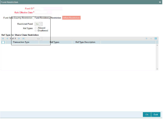

3.1.8 Fund Restriction Button
To set up a fund restriction, use ‘Fund Restriction’ screen. You can invoke this screen by clicking ‘Fund Restriction’ button in ‘Fund Rule Details’ screen.
Fund ID
Display
The system displays the fund ID.
Rule Effective Date
Display
The system displays the rule effective date.
3.1.8.1 Fund Sale Country Restriction Tab
This fund rule facilitates the maintenance of restrictions in respect of the fund being allowed for sale or operations in certain countries. You can maintain a list of countries as the only countries where the fund is allowed for sale.
To set up the country of sale restrictions for a fund, use the Fund Sale Country Restriction screen. You can invoke this screen by clicking the ‘Fund Sale Country Restriction’ Tab in ‘Fund Restriction’ screen.
Checks
Before you set up a Fund Sale Country Restriction profile record for a fund, it is desirable to ensure that the following information is already setup in the system:
l The fund already has an existing, unauthorized Fund Demographics profile record.
l The countries of domicile must be identified in the system in the Country Maintenance.
Country Code
Specify the country code. The adjoining option list displays all valid accounts maintained in the system. You can choose the appropriate one.

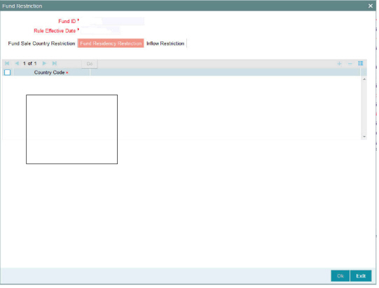

3.1.8.2 Fund Residency Restriction Tab
This fund rule facilitates the maintenance of restrictions in respect of the nationalities of unit holders who must not be allowed to transact in the fund.  You can maintain a list of countries that must not be excluded from operating in the fund, and all unit holders whose country of domicile is found in this list will be allowed to subscribe into the fund.
To set up the nationality restrictions for a fund, use the Fund Residency Restriction screen. You can invoke this screen by clicking the ‘Fund Residency Restriction’ Tab in ‘Fund Restriction’ screen.
Checks
Before you set up a Fund Residency Restriction profile record for a fund, it is desirable to ensure that the following information is already setup in the system:
l The countries of domicile must be identified in the system in the Country Maintenance..
Country Code
3.1.8.3 Inflow Restriction Tab
In this tab you can specify the inflow restriction details.
Restricted Fund
Optional
Select if transaction type or ref types should be allowed or not from the adjoining drop-down list. Following are the options available:
l Yes - If you select this value, then you can maintain a list of allowed/disallowed transaction type/ref types
l No - If you select this value, then you cannot maintain a list of allowed/disallowed transaction type/ref types
Ref Types
Optional
Select if ref type is allowed or not.
If you have selected ‘Restricted Fund’ field as ‘Yes’, then you should choose the allowed/ disallowed option and provide restriction list.
If you have selected ‘Allowed’ option, then on transaction posting, the system will display warning message for the transaction/ reftypes, which are not part of the restriction list.
If you have selected ‘Disallowed’ option, then on transaction posting, the system will display warning message for the transaction/ reftypes, which are part of the restriction list.
If you have selected ‘Restricted Fund’ field as ‘No’, then the system will validate that no transaction should be provided in the restriction list.
Ref Type for Share Class Restriction
Transaction Type
Specify the transaction type. The adjoining option list displays all valid transaction type maintained in the system. You can choose the appropriate one.
For switch / transfer transaction, the system will display the warning message if the Restricted fund field is enabled for the To fund.
For Twitch (Transfer Switch) transaction, Ref Type ‘TS’ is applicable for the Transaction Type ‘02’ and ‘03’. The Ref Type ‘TS’ is available for Fund Load mapping under Fund Rule Details.
Ref Type
Specify the ref type. The adjoining option list displays all valid ref type maintained in the system. You can choose the appropriate one.
Ref Type Description
Display
The system displays the description for the selected Ref type.
In case of fund transaction suspension, RSP will continue to generate transaction. This can be achieved by maintaining Fund Restriction in Fund Rule Maintenance (UTDFNDRL) by only allowing transaction type ‘02’ and ref type ‘41’ (RSP).

3.1.11 Fund Load Button
This fund rule enables you to designate different fees or incentives that are levied during the processing of transactions, as applicable for transactions in specific funds.  A simple mapping can be done where the appropriate fees or incentives, called loads in the system, may be tagged as applicable to the appropriate transaction types for the appropriate funds.
You can also designate the loads as applicable to certain reference types of transactions, such as standing instructions, policy transactions and so on.
The load details maintained will be attached to the funds using this maintenance screen. Only authorized loads can be attached to a fund, whose fund rules are not authorized. Transfer Switch for fund load mapping will be done using this screen.
To map loads to a fund, use the Fund Load Setup screen. You can invoke this screen by clicking the ‘Fund Load’ tab from the Fund Demographics screen.
Fund ID
Display
This field indicates the ID fund for which you are setting up the Fund Load Setup profile. This information is defaulted from the Fund Demographics screen.
Rule Effective Date
Display
Load ID
Numeric; 5 Characters; Mandatory
Specify the name of the Load (fee/incentive) that must be applied for the selected Fund. You may make your choice from the options provided in the drop-down list.
Note
Loads defined as ‘price basis loads’ cannot be mapped to a fund in the Fund Load Setup.
Load should be maintained as period based ageing Load (in percentage).
Load Description
Display
The system displays the description for the selected load ID.
Transaction Type
Specify the transaction type for which the loads are being defined. The adjoining option list displays all valid transaction type codes along with their description. You can choose the appropriate one.
Transaction Description
Display
From Entity Type
Specify the entity that bears this load. Alternatively, you can select From Entity Type from the option list. The list displays all valid entity types maintained in the system.
To Entity Type
Specify the entity that will be recipients of the load. Alternatively, you can select To Entity Type from the option list. The list displays all valid entity types maintained in the system.
Processing Frequency
Mandatory
Select the frequency at which this load is to be applied from the drop-down list. The list displays the following values:
l Allocation: This will mean that you will be charging the investor a fee or giving an incentive at the time of allocation of units. Allocation time loads cannot be designated for any transaction types other than IPO, subscription, redemption, and switch.
l Transaction: The charge (fee) or incentive will be applied at the time the transaction request is accepted from the investor.
l Post Allocation: This frequency is applicable typically to the Capital Gains Tax, which may be applied after allocation, on the gross amount. If indexation is applicable to capital gains tax computation based on this load, then you must select this frequency.
Note
Capital Gains Tax may also be designated as an allocation time load.
GL Account Code
Specify the code that will be used to map this load to its corresponding charge code in the external system.
When transaction information is exported to an external system, if separate books of accounts are to be posted for different loads, this code will be used to identify this load information in the export data.
Debit or Credit
Optional
Indicate whether the applied load would result in a debit or credit for the fund from the drop-down list. The list displays the following values:
l Debit
l Credit
This data is captured for information purposes only and has no processing implications in the system database.
Contra Account Code
Specify the code that will be used to identify the second leg of accounting entries for any transaction, in the event of exporting of transaction information to an external system.
Round Off / Down / Up
Optional
Indicate the rounding options for the load amount for the selected transaction type, for the fund.
Example
Let us suppose that the load amount computed for a subscription transaction is 10.561234, and that this value must be rounded to the 3rd decimal place.
No. of Decimals
Numeric; 1 Character; Mandatory
Indicate the maximum number of decimals that would be reckoned for rounding precision, for the load amount.
Priority Number
Enter a value to specify the priority number in case of optional loads.
For a mandatory load, the priority number is set to 0 and for an optional load the priority number should be unique, i.e., for a given fund, no more than one load can have the same priority number.
Mandatory
Mandatory
Select Mandatory or Optional from drop-down list to specify whether the load is mandatory or optional.
Based on Income?
Optional
Select the based on income details from the drop-down list. The list displays the following values:
l Capital Gains - Gross
l Non Capital Gains - Net
l Capital Gains
l CDSC
l Performance Based
l IOF
l Default IRRF
l Optional IRRF
l Dilution Levy
l Short Trade Period
l Short Trade Units
If the load is a Capital Gains Tax, and it is to be applied based on the gross amount after allocation, choose the Capital Gains – Gross option in this field, for such a load.
If indexation is being applied for capital gains tax computation, choose the Capital Gains – Indexation option in this field. The capital gains load is then applied using appropriate indexation, according to the option chosen by the investor.
If Contingent Deferred Sales Charge (CDSC) is applicable for transactions in this fund, choose the option CDSC option in this field to identify the CDSC load. This option will be available only when Fund chosen is CDSC applicable Fund.
If the ageing policy for the fund has been specified as ‘IOF/IRRF’ optimization in the General Operating Rules screen, then the following additional options are available:
l IOF
l Default IRRF
l Optional IRRF
If Dilution Levy is selected, then the system applies the load only if the sum of transactions for the combination of unit holder, fund, and transaction type exceeds the breach factor (inflow/outflow) for the corpus, even though all other criteria are satisfied. An EOD batch computes the aggregated net transaction amount at unit holder, fund, and transaction type level for dilution levy enabled fund. If dilution levy limit of a fund is breached, then the system applies the dilution levy load is applied for specific or all transactions for that unit holder, fund and transaction type combination based on the parameter set.
A system parameter DILUTIONLEVY governs whether Dilution Levy needs to be applied for specific or all Unit Holder (for Unit Holder, Fund, Transaction Type combination) transactions. The parameter value S indicates that Dilution Levy is applicable for specific transactions only whereas parameter value A indicates that Dilution Levy is applicable for all transactions for Unit Holder, Fund, and Transaction Type combination.
The above options are provided under the criterion that the transaction type is redemption and price to load is set to ‘No’. These options are applicable only for normal and systematic withdrawal ref types.
Note
Optional IRRF can be maintained only for pension funds.
IOF load is applicable up to one year for pension funds and up to 30 days for non pension funds.
You can select the load with Short Trade Units option to calculate penalty charge for outflow transactions with short trade units, i.e., in case of outflow transaction captured with Nominee Account and Short Trade Units Details are entered.
You can select the load with Short Trade Period option to calculate penalty charge for outflow transactions when the transaction is captured for other than Nominee account.
The system will identify Off-Shore/ On-Shore fund based on the Installed entity country and Fund country.
If Installed entity country and Fund country are same, then the system will classify the fund as Off-Shore fund.
If Installed entity country and Fund country are not same, then the system will classify the fund as On-Shore fund.
Installed EntityID
Installed EntityID Country
TWDDISTE
TWD
Fund ID
Fund Country
Classification
OFFSHR
HKG
OFFSHORE
ONSHR
TWD
ONSHORE
VAT Applicable?
Mandatory
Select ‘Yes’ from drop-down list to indicate that the Load to Price is applicable. Therefore VAT Load to Price is dependent on Load to Price.
Differential Fee?
Mandatory
Select ‘Yes’ from drop-down list to indicate that the differential fee in the case of switch transactions for any fund is to be applicable.
Send for GL Interface
Mandatory
Select ‘Yes’ from drop-down list to indicate that accounting entries due only to the selected load must be posted to the external asset management system, for the fund.
Slab Basis
Optional
Select the basis on which the slabs will be reckoned for an amount-based load that you are designating as applicable for the fund from the drop-down list. The list displays the following values:
l Gross Amount
l Net Amount
l Average Cost
l Weighted Average Cost
Apply Indexation on CGT?
Optional
If the load is a capital gains tax load, you can use this field to indicate whether indexation is to be applied on capital gains tax computation, for transactions in this fund. Select ‘Yes’ from drop-down list to indicate application of indexation. Else select ‘No’.
Price Add In
Mandatory
Select ‘Yes’ from drop-down list to indicate that the add-in factor is to be applicable for computing the return value for the load, for the selected transaction type. The add-in factor is used to arrive at the return value for a load, at the time of allocation.
Level ID
Indicate the order in which the load is to be applied. Load is computed based on the fund transaction amount and applied in the order of level id specified.
Note
Level ID is not applicable for LTP loads.
Load To Price
Mandatory
Select ‘Yes’ from drop-down list to indicate that this load is to be loaded to the base price.
Note
Load To Price to be set to No at fund load level.
Dependent Level
Indicate the dependent level for the selected load, if any.
In case the load has a dependent level, then load will be applied on the difference between the transaction amount and the sum of all dependent level load amounts, without considering all recursive levels.
Note
The dependent level Id must be less than the Level Id. The dependent level Id is not ap­plicable for LTP loads.
FDAP Income
Optional
Select ‘Yes’ from drop-down list to indicate the load maintenance is a FDAP income.
This field is applicable only when ‘To Entity’ is Broker/Agent/Agency Branch/AO/IFA and ‘From Entity’ is fund/AMC/Unit holder. For other cases, if you check this field, then the system will display the warning message. However, if you wish to continue, then the system will do the WHT deductions and processes.
Details
Ref Type
Alphanumeric; 4 Characters; Optional
To designate a load as being applicable for a reference transaction type for the selected fund, select the load reference type from the Available Reference Types box and move it to the Mapped Reference Types box, using the arrows.
If loads are to be designated applicable to reference types for a fund, you must set up an individual fund-load mapping record in this screen for each reference type for the fund, just as you do for each transaction type.
Example
If the AMC wants a fee to be charged on subscription transaction but not on reinvestment transaction, it can map only subscription transaction in the Ref Type field and not the reinvestment.
Note
It must be remembered that, while mapping a load to a reference transaction type, the sys­tem does not support the mapping of the Ref Type 68 (Funding Repayment) to any load.
For more information, refer the chapter ‘The Allocation Process’ in the ‘Fund Manager User Manual’.
3.1.12 Fund Formula Setup Button
This fund rule is an optional one that facilitates the definition of mathematical expressions and factors that will be used in computation of any of the components in the NAV, Transaction Base Prices, etc.
To set up a formula for a fund, use the Fund Formula screen. You can invoke this screen by clicking the ‘Fund Formula Setup’ link from the Fund Demographics screen.
Before you set up a Fund Formula record for a fund, it is desirable to ensure that the following information is already setup in the system:
l The fund already has an existing, unauthorized Shares Characteristics profile record.
l The fund already has an existing, unauthorized Transaction Processing Rules profile record.
Fund ID
Display
This field indicates the ID fund for which you are setting up the Fund Formula.  This information is defaulted from the Fund Demographics screen.
Rule Effective Date
Display
Used for Fund Price Computation
Mandatory
Select ‘Yes’ from drop-down list if the rule is for fund price computation or not.
Fund Formula Section
Component ID
Alphanumeric; 10 Characters; Mandatory
Specify the component of the fund price, for which an expression is being defined for computation, by selecting any one of the Component ID’s, from the list given. This is an Alphanumeric ID that is used to build the fund formula.
The component could be one of the standard price bases such as the Net Asset Value or Transaction Base Prices; or an additional price basis such as Offer Price, Bid Price, Price Before Performance, Price After Performance and so on.  These additional price bases are built on the appropriate parent standard price bases.
For instance, the additional price basis ‘Offer Price’ could have the standard price basis TBP02 as its parent.
Additional price bases can be defined only if multiple price bases are allowed as indicated in the General Operating Rules for the fund.
If multiple price bases are defined, you must also indicate the applicable inherent fees or incentives.
Component Type
Alphanumeric; 5 Characters; Mandatory
Specify the component type. Alternatively, you can also select component type from the option list.
l User Entered: indicates that the user enters the value.
l Default: indicates that there is a specified default value, which can be edited.
l Formula : indicates the component value is computed as per this formula, based on other Component ID’s
l Constant: indicates a fixed value that cannot be changed.
Component Description
Alphanumeric; 50 Characters; Mandatory
Enter any text message or remark regarding the formula. This is a free format text.
Formula
When Formula is selected as the Component Type, then this field becomes mandatory. Any text or value entered here should be equal to the result of the formula. When Formula is not selected as the Component Type, then this field becomes unavailable for data entry.
Fluctuation(%)
You can specify the fluctuation allowable in the additional components (typically tax components) for the transaction type, for the fund. When prices are entered for the transaction type for the fund, for the day, the system validates whether the fluctuation is within the allowable limit specified in this field.
Default Value
Specify the data value.
Price Basis
Mandatory
If multiple price bases are allowed as indicated in the General Operating Rules for the fund, you can use this field to indicate whether price bases other than the NAV and Transaction Base Prices are being specified for computation of the fund price component, using the formula specified.
For the NAV and Transaction Base Price components, the ‘Yes’ option is defaulted in this field and cannot be changed. For additional components, you can select ‘Yes’ to indicate additional bases, or ‘No’ if no additional bases are being used in the formula.
Parent Basis
For components used for additional price bases, specify the standard price basis from which the additional price basis derives, in this field. You can select either the NAV or the Transaction Base Price as the parent price basis.  NAV can be chosen as the parent price basis only for NAV components.
Additional price bases can only be defined if allowed for the fund in the General Operating Rules.
For components used for standard price bases such as NAV and Transaction Base Price, the parent price basis is defaulted to the component itself.
Inherent Fee
If multiple price bases are defined, you must also indicate the applicable inherent fee in this field. You can use the ‘Find’ link to select the applicable loads. The selection list displays loads tagged as Price Basis Loads in the Load Definition.
For Transaction Base Prices, the inherent fee / incentive cannot be parameterized.
Note
Any loads that have been defined as price basis loads are only used as the indicator for computing load values, and are not picked up during evaluation of criteria.  That is, the oth­er load details specified for such loads, such as the return value, slabs and so on, are not taken into consideration. The difference between the Transaction Base Price and the Price Basis defined for the transaction is considered as an inherent fee or incentive, during allo­cation.
For instance, if the Price Basis for a transaction is ‘Offer Price’, and Transaction Base Price is 1.009 and the Offer Price is 1.060, the difference (1.06-1.009 = 0.051, without currency rounding) is considered as the inherent fee (since the TBP is less than the offer price).  If the offer price were less than the TBP, the difference between the two is considered an inherent incentive.
Inherent Incentive
If multiple price bases are defined, you must also indicate the applicable inherent incentive loads in this field.
Exclude
Mandatory
Select ‘Yes’ option from drop-down list indicate that the selected price component must be excluded from capital gains computation. This specification can only be made for the user-entered components.
Default
Mandatory
For each of the standard price basis components that are used as parent price bases, (that is, the NAV and the Transaction Base Prices) you must assign one default price basis value. Check this box to default price basis value.
For instance, you have defined the components Offer Price 1 and 2, with the parent price basis TBP02. You must choose either Offer Price 1 or 2 as the default price basis value for TBP02.
Click ‘Compute’ button to compute the fund price.
3.1.12.1 Entering Fund Formulae
The following considerations must be kept in mind while entering Fund Formulae:
l If a formula is entered for a particular component, the formula cannot contain the component itself as an operand. For instance, if NAV is one of the components, and a formula is being specified for NAV, it cannot contain NAV as one of the factors.
l A component cannot be part of the factor (operand) and result for any other component. For example, if the formula for the component NAV contains the component TxnBP01 as an operand, then the formula for the component TxnBP01 cannot contain NAV as an operand.
l Once you enter a formula, it must be tested successfully for it to be saved and applied. To test a formula, click the Test button. The Fund Price Component screen is opened and you must specify a component value that will be used in computing the results of the formula.
The maintained fund formula for that fund will be applicable to all the prices in all allowed currency of expression for the Fund along with FBC.
The formula maintained for OFFER component as OFFER = NAV+3%of NAV (or the formula maintained can be NAV+2). This formula will be considered to derive the OFFER price component in FBC and other maintained Fund Price currencies for that fund using the NAV entered for respective currencies. This will be similar for other price components maintained in Fund Formula.
The price calculation method must be identical for each transaction currency within each share class. Trailer commission will be calculated in FBC.
In case of load held as amount, the system to apply the COE conversion factor and also the floor, ceiling and return value held in FBC will also use COE currency factor. All the amount values maintained in Load maintenance will be in FBC and the system will use CEO conversion factor for amount based load.

3.1.13 Additional Information Button
To maintain any additional information for a fund, click on the Additional Information button in the Fund Demographics screen. The Additional Information Details screen is opened, with the different information heads maintained for the AMC, where you can specify the information.
You can only maintain additional information if any information heads have been maintained in the System Parameters, to be applicable for funds, for the AMC.
Click ‘Get Additional Information’ button to view the following additional information details:
l Other Info Field
l Field Value
The information heads that you maintain are user defined. You will have to map the same against the entity type ‘Fund’ in the Entity Mapping Maintenance screen.
Note
The Additional Information section allows you to capture valuation data and has no pro­cessing implications.
Refer to the chapter Maintaining System Parameters in Volume 1 of the Fund Manager User Manual for further information.
3.1.14 Specific Fund Price Date Button
The price (Real NAV) applicable for a fund is declared on a daily basis by the Fund Manager. On any business day, the transactions that are entered are picked up and allocated by the End of Day process using the Real NAV declared for that business day.
You can also set up a specific date on which all transactions entered during a period can be allocated, using the price as on that date. This specific date can be maintained for each transaction type mapped to a fund. A specific pricing frequency can also be set up for the application of the specific pricing date.
Example
For the Carey Bugle Memorial Fund, a specific price date has been maintained for IPO and subscription transactions, which is the 15th January 2002. The specific pricing is to be applied on a monthly frequency basis, the first specific price date being 15th January 2002. The declared price on this date is 12.45 for IPO, and 12.34 for subscription.
All IPO and subscription transactions that have been entered into the Carey Bugle Fund from the 1st January 2002 till the 15th January 2002 will be allocated on 15th January 2002, using the prices 12.45 and 12.34 respectively.
Any IPO or subscription transactions entered between 1st January and 15th can be redeemed by the concerned unit holders only after 15th January.
The next specific pricing date for IPO and subscription transactions will be 15th February 2002, (the pricing frequency being monthly), and all IPO and subscription transactions entered between 16th January 2002 and 15th February 2002 will be allocated on this date.
Note
If specific pricing has been defined for a fund, the specific pricing parameters would take precedence over the pricing method and frequency defined in the General Operating Rules for the fund.
To set up specific price dates for any transaction types mapped to a fund, use the ‘Specific Fund Price Date Setup’ screen. Invoke this screen from the ‘Fund Rules’ screen by clicking ‘Specific Fund Price Date’ link.
For a fund, you can specify whether specific prices are to be applicable:
l With the first specific price date being the rule effective date (application date). In such a case, specific pricing date parameters can be defined for individual transaction types, in the main Specific Fund Price Date screen.
l With the first specific price date being a date in the future (forward pricing). This option can be set only for post-priced funds, and the specific pricing date parameters so specified will be applicable for all transaction types. In such a case, specific pricing date parameters cannot be defined for individual transaction types.
Fund ID
Display
This field indicates the ID fund for which you are setting up the Specific Price Date rule. This information is defaulted from the Fund Demographics screen.
Rule Effective Date
Display
The Rule Effective Date for the fund, which you specified in the Fund Rules Detail screen, is displayed here.
Price Frequency
Mandatory
Select the frequency at which the pricing dates will occur, from the options in the drop-down list.
l Daily
l Weekly
l Fortnightly
l Monthly
l Quarterly
l Half-Yearly
l Yearly
If you choose an option other than daily, you must define the frequency of pricing for the fund in Pricing Frequency Definition screen. The frequency of fund-price input and allocations will happen on dates based on the definitions in Pricing Frequency Definition screen
Forward Pricing Applicable
Mandatory
You can use this field to indicate whether forward specific pricing is applicable for the fund. To select this option, choose ‘Yes’ from drop-down list.
When you opt for forward pricing, you should choose the ‘User Defined’ option for Price Frequency and define the price dates  in the ‘Details’  section in the Pricing Frequency Definition screen. You may, if you choose, also maintain a Cut-off frequency.
If forward pricing is applicable, then you must also indicate the parameters given below in addition to the pricing frequency and the holiday rule:
l Whether the pricing frequency is applied based on the system calendar, fund calendar or actual calendar
l The specific day on which the price would be made available
Note
Forward specific pricing can be indicated only for post-priced funds.
Calendar Basis
Optional
In this field you can indicate whether the pricing frequency takes into consideration the fund calendar, system calendar or the actual calendar. Select the desired option from the drop-down list.
Select ‘Yes’ from drop-down list if forward pricing is applicable. Else select ‘No’.
If you indicate forward pricing is not allowed, you will be able to view the fields in the screen given above. You must specify the following information in the Details section to set up a specific pricing date.
Price Day
Optional
Select the specific date on which the price used for allocation is declared from the drop-down list. Consequent to this first price date, the system will arrive at the next price date by taking into consideration the price frequency.
The date specified here must be the Rule Effective Date. Future dates cannot be specified.
Price Month
Optional
Select the month when the price is to be user input from the drop-down list.
Price Week
Optional
Price Frequency Definition
Specify the frequency at which the pricing dates will occur. The adjoining option list displays the valid price frequency definition codes maintained in the system. You can choose the appropriate one. In the option list you will find information on price frequency and the price frequency definition.
The system displays the description the adjacent field.
Auto Generation Of Fund Prices
Optional
Choose one of the following options for automatic fund price generation from the drop-down list:
l Auto Generate Fund Prices using the last available price and authorize the same
l Auto Generate Fund Prices using the last available price, but do not authorize the same
l Do not Auto Generate Fund Prices
The unauthorized auto generated fund prices which are generated by ‘Auto Generate Fund Prices using the last available price but do not authorize the same option’ will be allowed to modify the price details in Fund Price maintenance screen. The maker id for this fund price record will be the user id who is modifying the record. User can be allowed to modify the same maintenance more than once even after authorization.
Note: As mentioned earlier, if specific pricing has been defined for a fund, the specific pricing parameters would take precedence over the pricing method and frequency defined in the General Operating Rules for the fund. Also, the prices for funds with specific pricing are only picked up on the specific pricing date (the Price Day).
For such funds, you may require fund price information on all working days of the selected calendar (fund or system), even though the price is picked up for transactions only on the specific pricing date. You can indicate automatic generation of fund prices, for such funds.  When you indicate automatic generation of fund prices, the system uses the last available price for the fund, and automatically generates the fund price for each working day.
You can specify the required option for automatic generation of prices, in the Auto Generation of Fund Prices field.
Note
Automatic generation of fund prices is available only for funds with specific pricing
Automatic generation of fund prices takes place only for those funds with specific pricing, for which the specific pricing frequency is any frequency other than ‘Daily’.
Details
Transaction Type
Select the type of transaction for which the specific pricing date is applicable, for the fund.
First Price Date
Indicate the specific date on which the price used for allocation is declared.  Consequent to this first price date, the system will arrive at the next price date by taking into consideration the price frequency.
The date you specify here should be the same as the Rule Effective Date.
If you wish to specify the first price date as a future date, then you must indicate forward pricing.
Holiday Rule
Mandatory
In the event of the price date being a holiday in the system, indicate whether the next or previous working day is to be considered as the price date.
If the next working day is to be considered, select ‘Next Day’ from the drop-down list. If the previous working day is to be considered, select ‘Previous Day’ from the drop-down list.
Dealing Lag (In Days)
Indicate the lag period (in days) for the dealing date. The lag value is interpreted in fund calendar days, and is used to arrive at the dealing date for the fund price.
Dealing date is the number of business days (based on the fund calendar) prior to/after the price date of the fund.
Dealing Rule
Optional
Select the dealing rule from the drop-down list to be applied while deriving the dealing date. Dealing date for a transaction is derived based on the forward or backward lag with regard to the fund price date.
If the dealing rule is ‘After’, then the dealing lag will be added to the price date. If the dealing rule is ‘Prior’, then the dealing lag will be deducted from the price date.
Cut-Off Day
You may choose to maintain cut-off dates for funds to facilitate ease of operation.
Cut-Off Week
Specify the cut-off week for funds
Cut-Off Month
Specify the cut-off month for funds
Cut-Off Frequency
Optional
Select the transaction cut-off date options for different frequencies, from the options in the drop down list.
l Daily- Based on Price Date
l Weekly
l Fortnightly
l Monthly
l Quarterly
l Half-Yearly
l Yearly
Cut-Off Frequency Definition
Optional
Specify the frequency at which the cut-off should take place by choosing one of the following from the drop-down list:
l Based on Week and Weekend
l Based on Month Day
Trading at cut off applicable
Optional
Select if trading at cut off is applicable or not from the drop-down list. The list displays the following values:
l Yes
l No
If you select ‘Yes’, the system will derive the transaction date as single date in the specified pricing frequency. You will not be able to change transaction date/Order received date and time post authorization.
If you select ‘No’, the system will derive the transaction date entered in the system. The Price Date will be derived using the transaction date and based on fund pricing rules that will remain unchanged.
Trade cut off holiday rule
Optional
Select the trade cut off holiday rule from the drop-down list. The list displays the following values:
l Previous Day
Trade cut off calender basis
Optional
Select the trade cut off calendar basis from the drop-down list. The list displays the following values:
l Actual Calendar
l System Calendar
l Fund Calendar
User Defined Price Date
Price Date
If you choose the option User Defined, you should specify the price dates.
You can specify the Price Dates in the Details section by clicking on the option list. This is enabled only when the Pricing Frequency Definition option is User Defined.
In all cases, if the next price date falls on a holiday, the holiday rule set for the specific date setup is applied to arrive at the next price date.
You can also specify the last day of the cycle (month, quarter, half-year or year) as the price date. To do this, check the option ‘Based on last specified day of the cycle’. Prices are made available on the last day of the cycle that you specify. You can specify any weekday from Sunday to Saturday as the last day. For instance, if you have specified a monthly frequency, enabled the ‘Based on last specified day of the cycle’ option, and specified Sunday as the last day, prices are made available on the last Sunday of each month.
Note
The prices that are generated will be used for reporting only. You will however, be allowed to Edit/Amend the Unauthorized/Authorized fund price that is generated if any Adhoc Price Dates are maintained that day.

3.1.14.3 How pricing frequency is considered
Without Forward Pricing
If the first specific price date is the rule effective date (application date), the next price date is arrived at based on the pricing frequency as follows:
Pricing Frequency
Next price date
Daily
Last price date + 1 calendar day
Weekly
Last price date + 7 calendar days
Fortnightly
Last price date + 14 calendar days
Monthly
Last price date + 30 calendar days
Quarterly
Last price date + 90 calendar days
Half-Yearly
Last price date + 180 calendar days
Yearly
Last price date incremented by one year
If the next specific price date so arrived at falls on a holiday, the holiday rule defined for the specific price date is taken into account. Accordingly, the actual price date is taken as the next working day (if the holiday rule is ‘After’) or the previous working day (if the holiday rule is ‘Prior’)
Note
The actual calendar is considered in arriving at the next price date, in the logic discussed above.
Forward Pricing
If the first specific price date is a date in the future (forward pricing), the next price date is arrived at based on the following factors:
l Pricing frequency that has been specified.
l Whether the frequency takes into account the Fund Holiday Calendar or System Holiday Calendar.
l The specified price day, week or month.
l The holiday rule indicated for the specific pricing.
The next price date is arrived at as given in the example below for various combinations:
Price Frequency
Price Month
Price Week
Price Day
Price available on
Daily
Price can be entered from Sunday to Sat­urday
Weekly
3
Third day (Tuesday) of every week
Fortnightly (Price week specified)
1
4
Fourth day of the first week of the fort­night.
Fortnightly (Price week not specified)
4
Fourth day of the fortnight
Monthly (Price week speci­fied)
4
2
Monday of fourth week of every month.
Monthly (Price week not specified)
2
Second day of the month
Quarterly
1
1
1
Sunday of first week of first month of every quarter.
Half Yearly
5
2
4
Fourth day of second week of fifth month of every half.
Yearly
9
3
5
Last day of third week of every Septem­ber.
If the next specific price date so arrived at falls on a holiday in the specified calendar (Fund or System), the holiday rule defined for the specific price date is taken into account. Accordingly, the actual price date is taken as the next working day (if the holiday rule is ‘Next Day’) or the previous working day (if the holiday rule is ‘Previous Day’).
Note
System will derive the days based on locale settings.
3.1.14.4 How Cut-off Frequency is Considered
The system determines the specific pricing cycle (either current or subsequent) to be used based on the cut-off frequency and cut-off days defined for the transaction type.
If the transaction date exceeds the cut-off date, the price date is moved to the next specific pricing cycle.
The cut-off date is arrived at as given in the example below for various combinations:
Cut-off Frequency
Cut-off Month
Cut-off Week
Cut-off Day
Remarks
Weekly
3
1
4
Fourth day of the first week of the fortnight.
4
Monthly (Price week specified)
4
2
2
Quarterly
1
1
1
Half Yearly
5
2
4
Yearly
9
3
5
Last day of third week of every September.
The examples given below illustrate how the cut-off frequency is considered.
Example 1
Pricing Frequency
Price Day
Cut-off Frequency
Cut-off Day
Weekly
4 (Thursday)
Weekly
1 (Monday)
Let us suppose the current date is a Wednesday.  Since it is beyond the cut-off day for the week, the specific price date is moved to the next cycle, that is, the specific price of the Thursday of the week is considered.
Example 2
Pricing Frequency
Price Day
Cut-off Frequency
Cut-off Day
Cut-off Week
Weekly
4 (Thurs­day)
Monthly
1
4
The cut-off day is the Monday of the fourth week of the month. If the current date is 10th September 2003 (say a Wednesday), it falls in the second week of the month. Since it is before the cut-off day for the present cycle, the specific price date falls on the current cycle, that is, the pricing on 4th September (the Thursday of the current pricing cycle) is considered.
If, in this same example, the cut-off week is 2, then the cut-off day is the Monday of the second week of the month. Since the current date, 10th September 2003, a Wednesday, is beyond the cut-off day, the specific price date is moved to the subsequent cycle, that is, the pricing on 11th September (the Thursday of the subsequent pricing cycle) is considered.
Note
The number of business working days is considered while determining the cut off days. The number of cut off days does not include the Fund holiday and the AMC Holiday.
For pre-settled trade funds, if Trade Cut-Off Applicable is set as Yes at fund level, then the transaction date will be derived as cut-off day in the respective specific fund price cycle.
3.1.15 Amount Limits for IRA Transactions Button
For funds in which you have allowed IRA (Individual Retirement Account) investment, you can define the transaction limits. Use the Amount Limit for IRA Transactions section in the Fund Rules Detail screen to specify the limits.
It is mandatory for you to specify the IRA Limits fund rule for funds in which IRA investments are allowed.
The following limits are specified:
l Minimum transaction amount limits for initial, additional investment, and withdrawal transactions
l Maximum transaction amount limits for initial, additional investment and withdrawal transactions.
Initial Investment
Minimum Amount (Initial Investment)
Numeric; 30 Characters; Mandatory if IRA investment is allowed for the fund
Specify the minimum amount that can be contributed in the initial investment into this fund, for a plan purchased in a product for which the fund forms part of the portfolio. This limit cannot exceed the corresponding limit set for the product, the portfolio of which the fund is a part.
Maximum Amount (Additional Investment)
Numeric, 30 Characters; Mandatory if IRA investment is allowed for the fund
Specify the maximum amount that can be contributed as an additional investment into this fund, for a plan purchased in a product for which the fund forms part of the portfolio. This limit cannot exceed the corresponding limit set for the product, the portfolio of which the fund is a part.
Subsequent Investments
Maximum Amount
Specify the maximum amount that can be contributed in the initial investment into this fund, for a plan purchased in a product for which the fund forms part of the portfolio.  This limit cannot exceed the corresponding limit set for the product, the portfolio of which the fund is a part.
Minimum Amount
Specify the minimum amount that can be contributed as an additional investment into this fund, for a plan purchased in a product for which the fund forms part of the portfolio. This limit cannot exceed the corresponding limit set for the product, the portfolio of which the fund is a part.
Withdrawals
Minimum Amount
Specify the minimum amount that can be withdrawn through a withdrawal transaction out of this fund, for a plan purchased in a product for which the fund forms part of the portfolio. This limit cannot exceed the corresponding limit set for the product, the portfolio of which the fund is a part.
Maximum Amount

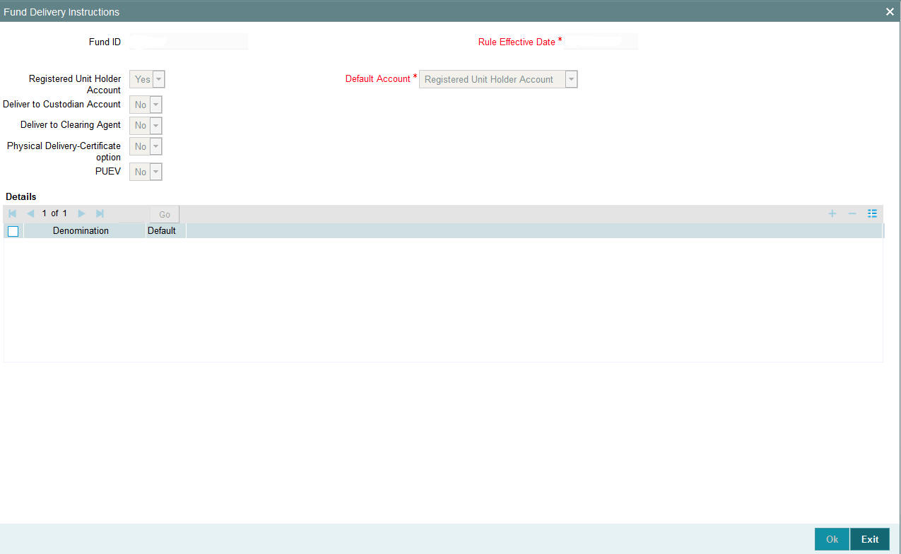

3.1.16 Fund Delivery Instructions Button
You can specify the fund delivery instructions details by clicking ‘Fund Delivery Instructions’ button in ‘Fund Rule Details’ screen.
Fund ID
Display
This field indicates the ID fund for which you are setting up the Fund Investment Account profile. This information is defaulted from the Fund Demographics screen.
Rule Effective Date
Display
Registered Unit Holder Account
Optional
Select if the unit holder account is registered or not from the drop-down list. The list displays  the following values:
l Yes
l No
Deliver to Custodian Account
Optional
Select if the fund details are delivered to the custodian account or not from the drop-down list. The list displays the following values:
l Yes
l No
Deliver to Clearing Agent
Optional
Select if the fund details are delivered to the clearing agent or not from the drop-down list. The list displays the following values:
l Yes
l No
Physical Delivery - Certificate Option
Optional
Select if the certificate-based funds are physically delivered along with certificates to the customer or not from the drop-down list. The list displays the following values:
l Yes
l No
PUEV
Optional
Select if PUEV option is yes or not from the drop-down list. The list displays the following values:
l Yes
l No
Default Account
Optional
Select the default account options from the drop-down list. The list displays the following values:
l Registered Unit Holder Account
l Deliver to Custodian Account
l Deliver to Clearing Agent
l Physical Delivery-Certificate Option
Details
Denomination
Alphanumeric; 200 Characters; Optional
Specify the denomination details.
Default
Optional
Select if the denomination details are defaulted or not from the drop-down list. The list displays the following values:
l Yes
l No
3.1.17 Fund Investment Account Button
To associate the allowable fund investment account types for a fund, you can use the Fund Investment Account screen. When you are setting up a fund, you can invoke this screen from the Fund Demographics screen by clicking on the Fund Investment Account link.
Note
You can also use the Fund Investment Account screen to map provident fund account types as well as non-provident fund account types (such as cash nominee account types) to a fund.
In this screen, select the allowable fund investment account types for the fund, in the Account Type field.
For each investment account type that you associate for the fund, you must specify a validity period, by indicating a start date for validity and an end date.
Operations on Fund Investment Account Specifications
The Fund Investment Account specifications can be copied for child umbrella funds or made part of a fund template. They can also be uploaded from a bulk client as fund rules for a fund.
Through the fund rule amendment function, you can change the account types allowable, by revoking an existing allowable account type, and allowing a new type.

3.1.18 SI Specific Information Button
In this section, you can maintain the rules for standing instruction generation that are to be applicable for the fund. Click ‘SI Details’ button in ‘Fund Rules Detail’ screen. The following window is displayed:
Fund ID
Display
Rule Effective Date
Display
Details
Transaction Type
Specify the transaction type for which the amount limitations are to be maintained. Alternatively, you can select the transaction type from the option list. The list displays all the valid transaction type maintained in the system.
Account Type
Specify the account type for which the amount limitations are to be maintained. Alternatively, you can select the account type from the option list. The list displays all the valid account type maintained in the system.
Holiday Rule
Mandatory
l Prior
l After
Calendar Basis
Mandatory
l Actual Calendar
l Fund Calendar
l System Calendar
Mandatory
l Daily
l Monthly
l Quarterly
l Weekly
l Yearly
l Bi-Weekly
l Half-Yearly
SI Description
Specify the SI description.
Specific Gen.Day
SI Generation Freq.
Mandatory
l Monthly
l Quarterly
l Half Yearly
l Yearly
SI Minimum Amount
Specify the SI minimum amount.
SI Maximum Amount
Specify the SI maximum amount.
SI Minimum Units
SI Maximum Units
SI Cut-Off Day
SI Cut-off Lag
Enforce Generation
Mandatory
Max. Validity(Days)
Max No. of SI Txns
Last Day of SI Gen Cycle
Optional
Select if last day of SI generation cycle to be considered from the drop-down list. The list displays the following values:
l Yes
l No

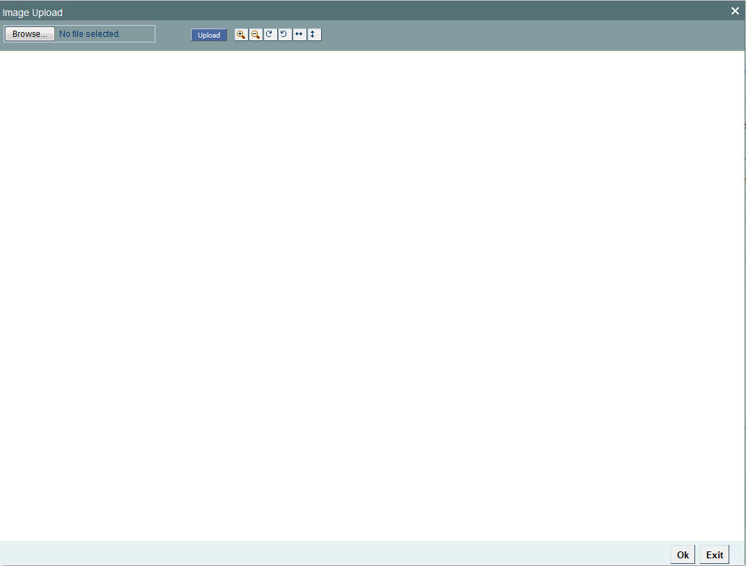

3.1.20 Documents Button
Click ‘Documents’ button in ‘Fund Rules Detail’ screen to upload the documents.
You can upload the required documents by clicking ‘Upload’ button.

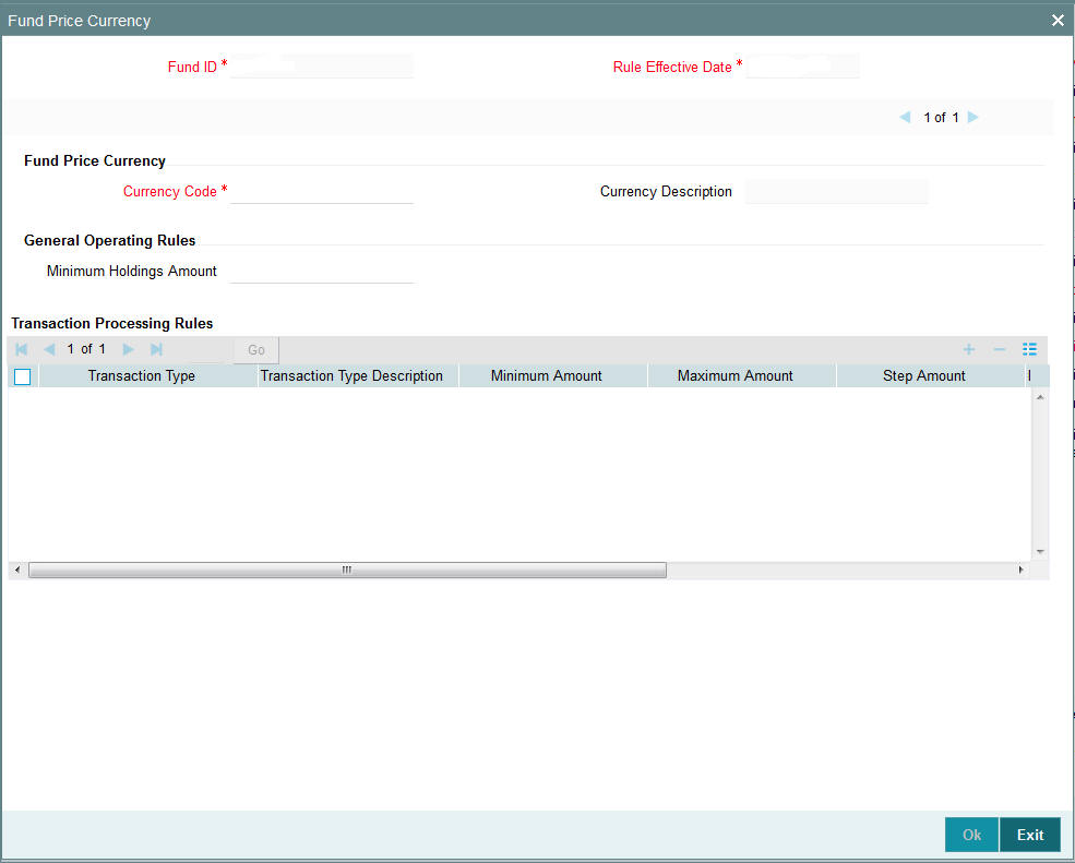

3.1.22 Fund Price Currencies Button
If the fund created is a currency of expression fund then you can maintain the fund price currencies along with the general operating and transaction processing limits for each fund price currencies. You can maintain fund price currency by clicking ‘Fund Price Currencies’ button in ‘Fund Rules Details’ screen.
Fund ID
Display
The system displays the fund ID for which the fund price currency is being maintained.
Rule Effective Date
Display
The system displays the rule effective date of the fund.
Fund Price Currency
You can maintain the allowed list of currencies for the fund.
Currency Code
Specify the currency code which is added as fund price currency
Currency Description
Display
The system displays the description for the specified currency code.
You can maintain the holding amount limit validation for the fund price currency added.
Minimum Holding Amount
Specify the minimum holding amount.
You can maintain the minimum and maximum amount limits for the transaction types for the fund price currency added.
Transaction Type
The system allows the following list of transactions types:
l IPO
l Subscriptions
l Redemptions
l Switch (normal and pseudo)
Transfers not allowed as part of this list
Display
Minimum Amount
Specify the minimum amount limit for the currency selected.
Maximum Amount
Specify the maximum amount limit for the currency selected.
Step Amount
Specify the step amount for the currency.
Initial Min. Transaction Amount
Specify the minimum initial amount limit.
Initial Max. Transaction Amount
Specify the maximum initial amount limit.
On saving the fund rule,
l The currency field (list of values) in FPC TAB will list all currencies except the fund base currency. Fund base currency will not be present in the option list
l If there is any fund price currencies maintained then the system will default the ‘Currency of Expression Fund’ field value to ‘Yes’ in the fund demographics.
l If a Currency of Expression fund is amended and the FPC maintenance is deleted then the system will default the Currency of Expression fund value to ‘No’ in the fund demographics.
l The Currency of Expression checks further will not happen for this fund from the rule effective date. The system will display a warning message as ‘Fund price currencies maintained for the fund is being deleted.’
During the Pre EOD check, the system will check if the price in fund price currencies are maintained for the day. If the system does not find the Price in currency of expression, then the transaction entered in currency of expression will not be allotted.
3.1.23 Processing Holding Limit in Currency of Expression
The system will validate holding limit for fund price currencies for the outflow transactions only if the limits are maintained in the general operating rules (Fund Price Currency Tab) and accordingly generate warning message for the outflow transactions.
If the transaction base currency is the unit holders’ currency of expression; then TBC should be validated against the Unit Holders’ ‘Holdings/balance’ and the fund’s minimum holdings/balance in that currency of expression to conclude whether or not the minimum holdings/balance amount has been breached.
If the transaction base currency is a fund price currency for the fund, but not a unit holders’ currency of expression, and if limits are maintained for the fund price currency then TBC should be validated against the Unit Holders’ ‘Holdings/balance’ and the Fund’s minimum holdings/balance in FPC to conclude whether or not the minimum holdings amount has been breached.
If the transaction base currency is a Fund price currency for the fund, and limits are not maintained, then the transaction amount is to be converted into the FBC (based on the latest price) and should be validated against the Unit Holders’ ‘Holdings/balance in FBC’ and the Fund’s minimum holdings in FBC to conclude whether or not the minimum holdings/balance Amount has been breached. The system will use COE factor in this case.
If the transaction base currency is FBC; then that amount should be validated against the unit holders “holdings/balance in FBC” and the fund’s minimum holdings in FBC to conclude whether or not the minimum holdings amount has been breached.
If the transaction currency is neither the FBC nor a FPC nor unit holders’ currency of expression, then the amount is to be converted into FBC based on the exchange rate and then validate against the UHs ‘holdings in FBC’ and the fund’s minimum holdings in FBC to conclude whether or not the minimum holdings amount has been breached.
If the transaction currency is neither the FBC nor a FPC nor unit holders’ currency of expression, then the amount is to be converted into FBC based on the exchange rate and then validate against the UHs ‘holdings in FBC’ and the fund’s minimum holdings in FBC to conclude whether or not the minimum holdings amount has been breached. The system will validate holding/balance limit for FPC for all modes of transactions (outflow transaction) i.e. manual inputs and uploads as well.
The UH/CIF balance = UH fund balance * declared NAV in FBC
The Min/Max holding check is maintained in the ‘Fund Price Currency’ tab. The values for “minimum holding indicator, minimum threshold limits and minimum holding apply for” will be looked at what is maintained for fund base currency at the GOR. In case values are not maintained here then it will be same logic as is for fund base currency.
The system will perform the following checks for the different values maintained for minimum holding indicator:
Case 1: Minimum holdings indicator =Amount
Balance to be checked = minimum holding amount + (minimum holding amount * threshold percentage)
If UH/CIF balance is less than or equal to the balance to be checked, then the system will display warning message as ‘The unit holder balance has reached the threshold value’.
If UH/CIF balance is 0 then the system will display warning message as ‘This is a terminating transaction, Unit holder balance will be Zero.’
Case 2: Minimum holdings indicator =lower of amount/units
Balance to be checked = least of minimum holding amount and (minimum holding units * declared NAV in currency of expression) + (least of minimum holding amount and (minimum holding units * declared NAV in currency of expression)) * threshold percentage)
If UH/CIF Balance is less than or equal to balance to be checked then the system will display warning message as ‘The Unit holder balance has reached the threshold value’.
Case 3: Minimum holdings indicator = higher of amount/units
Balance to be Checked = higher of minimum holding amount and (minimum holding units * declared NAV in currency of expression) + (higher of minimum holding amount and (minimum holding units * declared NAV in currency of expression)) * threshold percentage)
If you try to amend an existing fund or add new currencies (fund price currencies-FPC’s) and prices are not maintained/available for the new fund price currencies and the same currency is used for redemption transactions then system will display warning message while saving the transactions.

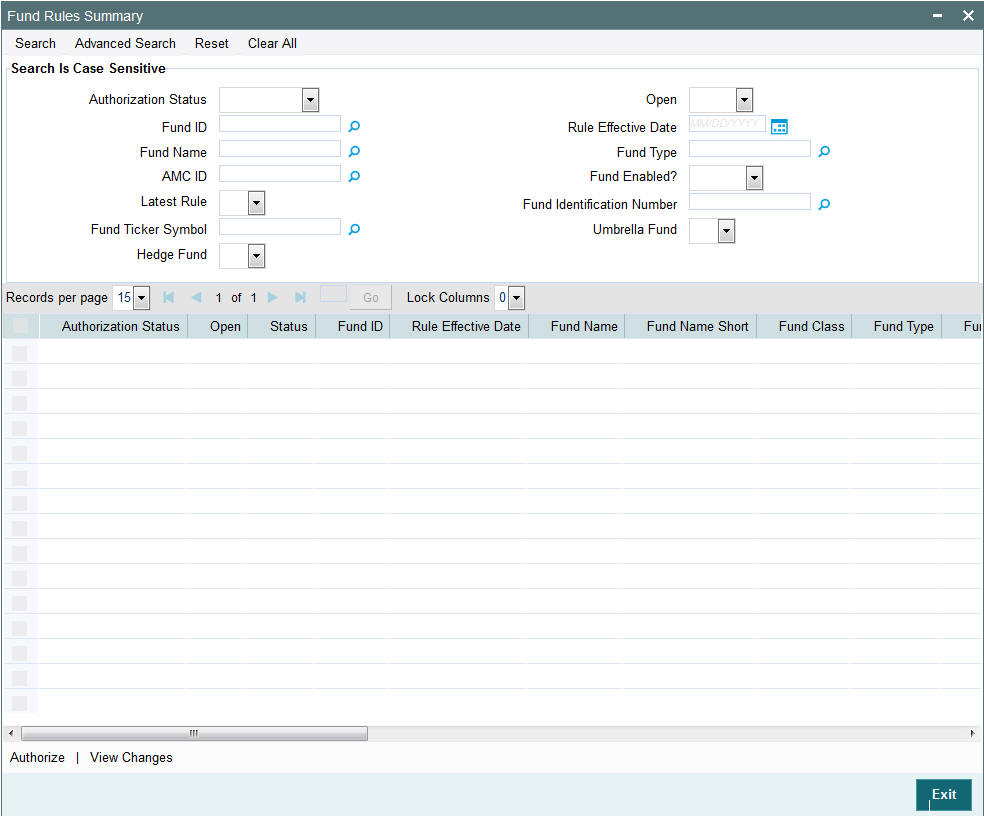

3.2.1 Retrieving Record in Fund Rules Summary Screen
You can retrieve a previously entered record in the Summary Screen, as follows:
l Invoke the ‘Funds Rule Summary’ screen by typing ‘UTSFNDRL’ in the field at the top right corner of the Application tool bar and clicking on the adjoining arrow button.
Specify any or all of the following details in the corresponding fields:
l The status of the record in the Authorization Status field. If you choose the ‘Blank Space’ option, then all the records are retrieved.
l The status of the record in the Open field. If you choose the ‘Blank Space’ option, then all records are retrieved
l Fund ID
l Fund Name
l AMC ID
l Latest Rule
l Fund Ticker Symbol
l Hedge Fund
l Rule Effective Date
l Fund Type
l Fund Enabled?
l Fund Identification Number
l Umbrella Fund
Click ‘Search’ button to view the records. All the records with the specified details are retrieved and displayed in the lower portion of the screen.
Note
You can also retrieve the individual record detail from the detail screen by querying in the following manner:
Press F7
Input the Fund ID
Press F8
You can perform Edit, Delete, Amend, Authorize, Reverse, Confirm operations by selecting the operation from the Action list. You can also search a record by using a combination of % and alphanumeric value.
Example
You can search the record for Fund ID by using the combination of % and alphanumeric value as follows:
l Search by A%: The system will fetch all the records whose Fund ID starts from Alphabet ‘A’. For example, AGC17, AGVO6, AGC74 and so forth.
l Search by %7: The system will fetch all the records whose Fund ID ends by numeric value’ 7’. For example, AGC17, GSD267, AGC77 and so forth.
l Search by %17%: The system will fetch all the records whose Fund ID contains the numeric value 17. For example, GSD217, GSD172, AGC17 and so forth.

You cannot edit or delete an authorized fund rule
You can map agents to a fund, set up backdating limits, and enter transaction prices for a fund only after you authorize it.  Similarly, the tracking of limits, and acceptance of unit holder transactions into the fund can only take place after authorization.
You cannot authorize a fund until you have maintained the following fund rules for it:
Fund Demographics
Fund Sale Country rule
Fund Restriction rule
Fund Transaction Currency rule
The following fund rules are not mandatory for a fund, and it can be authorized without them:
Corporate Actions
Fund Price Currency
Fund Formula Maintenance
Fund Load Setup
These fund rules may be maintained as and when necessary.

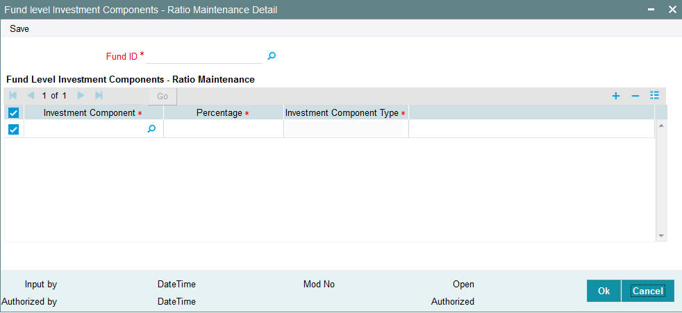

3.3.1 Maintaining Fund Investments Component
To validate the Prudential Investment Guidelines it is mandatory to define the various investment components that constitute the fund investment for a product or policy. Investment components are a division of the fund that is allocated for investment in policies. These components may be individual components or a combination of two or more components. Based on the relation of the allotted fund characteristic, these components are allotted a percentage or ratio, which describes the relation of these funds to the total Fund Investment.
Refer the chapter ‘Prudential Investment Guidelines Standard’ and ‘FOREX Compliance’, in the LEP User Manual for more information on maintaining Prudential Investment Guidelines and forex compliance.
To maintain the Fund Investment Components, you need to:
l Define the various investment components as part of system parameters maintenance under the parameter code “INVESTMENTCOMP”
l Specify the Investment component code and its corresponding description.
Note
The system does not differentiate onshore /offshore components at this level.
You need to maintain ratios for respective investment components type according to the following considerations:
l The total sum of these ratios must be equal to 100
l The list of Investment Components is available as per the system parameters maintenance
You can invoke the ‘Fund level Investment Components – Ratio Maintenance Detail’ screen by typing ‘UTDFICRM’ in the field at the top right corner of the Application tool bar and clicking on the adjoining arrow button. Select ‘New’ from the Actions menu in the Application tool bar or click new icon to input the details of the fund component.
Fund ID
Specify the Fund ID. Alternatively, you can select fund ID from the option list. The list displays a record of all stored fund types.
Fund Level Investment Components-ratio Maintenance
After selecting the required fund types you are provided with the records matching the input information specified to the system.
Component Type
Specify the component type. This adjoining option list displays all valid component type maintained in the system. You can choose the appropriate one.
Display
The portion of the allocated Fund investment is displayed here as the Investment component.
Percentage
This is the ratio or percentage of the Total Investment Fund including the selected component. It should be input as 100.
After capturing these details, click ‘Ok’ button to save the component.

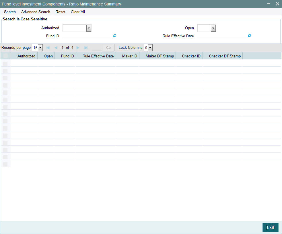

3.4 Fund Investment Component Summary Screen
l Section 3.4.1, "Retrieving Record in the Fund Investment Component Summary Screen"
l Section 3.4.2, "Editing Fund Investment Component Record"
l Section 3.4.3, "Viewing Fund Investment Component Record"
l Section 3.4.4, "Deleting a Fund Investment Component Record"
l Section 3.4.5, "Authorizing a Fund Investment Component Record"
l Section 3.4.6, "Amending Fund Investment Component Record"
l Section 3.4.7, "Authorizing Amended Fund Investment Component Record"
l Section 3.4.8, "Copying Attributes"
3.4.1 Retrieving Record in the Fund Investment Component Summary Screen
l Invoke the ‘Fund level Investment Components – Ratio Maintenance Summary’ screen by typing ‘UTSFICRM’ in the field at the top right corner of the Application tool bar and clicking on the adjoining arrow button.
l The status of the record in the Authorized Status field. If you choose the ‘Blank Space’ option, then all the records are retrieved.
l Fund ID
