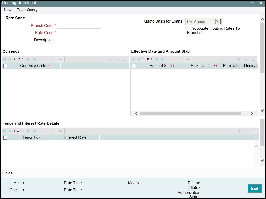

The Interest Rate Type of a product can be one of the following:
A Floating Rate corresponds to the market rates for the day. These rates are maintained and updated daily (or whenever they change,) in the Floating Rates Table. The rates can be applied on a contract with or without a spread.
You can invoke the ‘Floating Rate Input’ screen by typing ‘CFDFLTRI’ in the field at the top right corner of the Application tool bar and clicking the adjoining arrow button.
The floating interest rates are defined through this screen.
Each Rate Code is associated with a currency. You can define rates for the same Rate Code in different currencies.
A Rate Code identifies a set of rates defined for a combination of Currency, Amount Limit (optional) and Effective Date. When processing a contract initiation, you should link it to the Floating Rate Table by indicating the Rate Code. The rates defined for the Rate Code are applied on the contract.
Propagate Floating Rates To Branches
Select this option to indicate that the rate code should be available across all branches.
Specifying Effective Date and Amount Slab Details
Amount Slab
For a specific Rate Code and Currency combination, you can define an amount slab structure for application of interest rates. You should specify the upper limit of the slab to which a particular rate should be applied. A rate that has been defined for an Effective Date - Amount Slab combination is applicable to an amount less than or equal to the specified amount. You can define interest rates for a slab structure.
Effective Dates
Each rate that you define for a Rate Code and Currency combination should have an Effective Date associated with it. This is the date on which the rate comes into effect. Once a rate comes into effect, it is applicable till a rate with another Effective Date is given for the same Rate Code and Currency combination.
Note
The rates are applied to a contract depending on whether it has been defined with Auto Rate Code Usage or Periodic Rate Code Usage. You can specify this in the ‘Interest Class Maintenance’ sub-screen of the ‘Loans and Commitment Product Definition’ screen.
Borrow/Lend Rate Indication
For every Amount Limit - Effective Date combination, you should define the rate to be applied as a borrow rate or a lend rate. Borrow rates are applied for loans taken by the bank and lend rates apply on placements. You also have the option to specify mid-rate.
Tenor and Interest Rate Details
The rates that are applied for a given combination of Amount Limit – Effective date – Lend/Borrow Indication can be tenor based. In the table, you can define the interest rates for different tenors. The rate that is applied to a contract is based on the interest parameters specified in the ‘Interest Class Maintenance’ sub -screen of the ‘Loans and Commitment Product Definition’ screen.
The index rate code which was picked up to derive the resultant composite rate is stored as ‘Picked Up Rate Code’ for the effective date, which has the reset tenor zero.
The rates picked for the index rate codes are for the maximum amount maintained in the amount slab. The composite rate rebuilt is stored with the amount slab as “999,999,999,999.00”. After applying the additional rate (specifically when the additional rate indicator is ‘-‘), if the resultant rate becomes –ve, then it is considered as 0 as –ve rate is not allowed.
Units
Displays the drop-down list with the values Days, Years, Months.

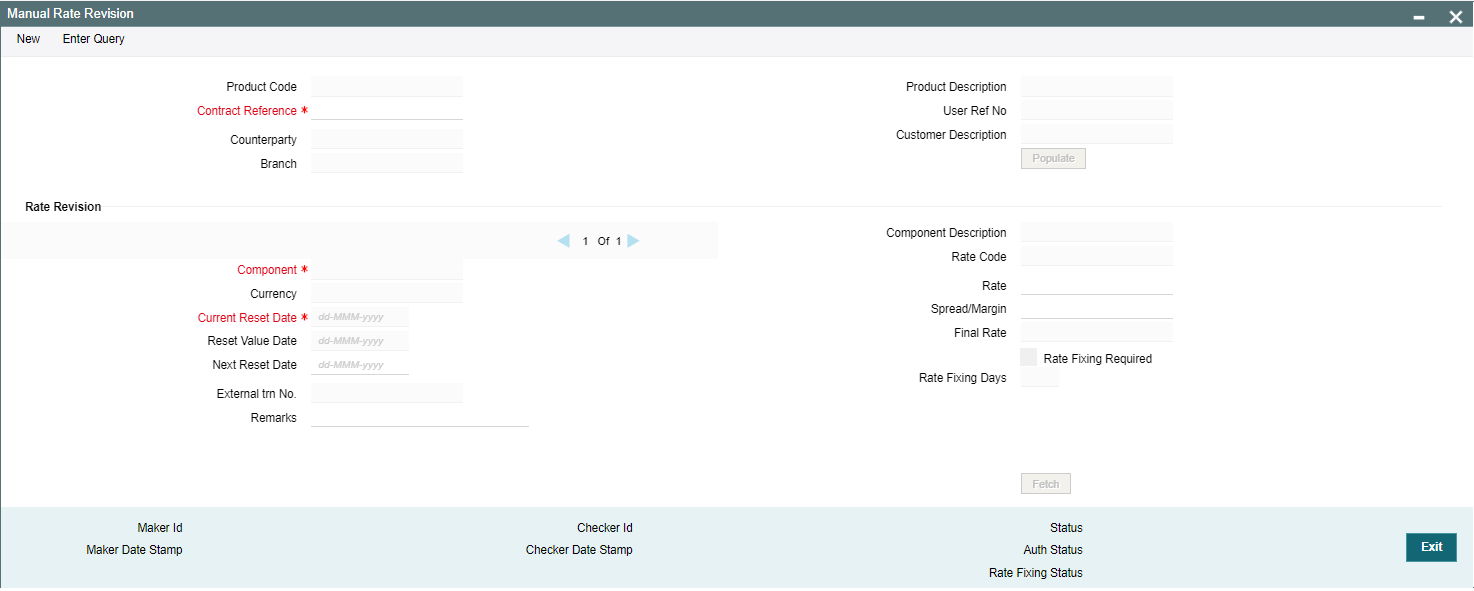

You can invoke the ‘Floating Rate Input’ screen by typing ‘OLDRTFIX’ in the field at the top right corner of the Application tool bar and clicking the adjoining arrow button.
The manual interest rates are defined through this screen.
Product Code Product Description
Product description will be defaulted from Contract details.
Contract Reference
select 'Contract reference number' from LOV to set new rate for new effective date or to modify rate for existing effective date.
Component description will be defaulted from contract details.
Current Reset Date
Current reset date is a read only field.It will fetch Next reset date given in Contract Rate fixing tab.
Reset Value Date
On click of New System will allow to set new rate for effective date.System will set earlier 'Next Reset Date' as reset value date and new effective date should be provided in Next Reset Date. On Unlock and amending the rate for an existing window, system will not change the Reset Value Date.
Next Value Date
User is allowed to enter date till maturity date of 'rate fixing type' loan contract.
In case of Floating Periodic Manual, Rate can be fetched from given floating rate code, same can be modified manually at rate fixing screen.
Rate
This field allows user to Input / Modify rate manually.
This field allows user to Input / Modify Spread / Margin value.
System populate this field value based on sum of Rate and spread/margin values. Following rate types are allowed for rate fixing in OL
Note
Before Auth, Delete Action will be enabled for New record.

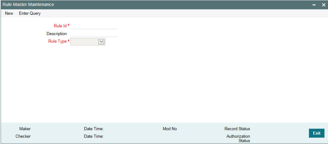

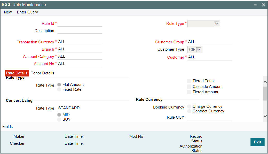

An Interest Rule identifies the basic nature of an interest component.
An interest rule is defined in the ‘Rule Master Definition’ and ‘ICCF Rule Maintenance’ screen.
As you are defining an interest type of component, (that is, a tenor based component), you need to specify only the following details through the ‘Rule Master Definition’ and ‘ICCF Rule Maintenance’ screen:
All the other details of the component are to be specified through the ‘Interest Class Maintenance’ sub -screen of the ‘Loans and Commitment Product Definition’ screen.
You can invoke the ‘Rule Master Definition’ screen by typing ‘LFDRLAVL’ in the field at the top right corner of the Application tool bar and clicking the adjoining arrow button.
Rule ID and Description
Each Interest Rule is defined by a four-character code, called the Rule ID. Attributes are defined for this Rule ID, which is then linked to a product. When a contract is processed, the interest attributes defined for the Rule ID linked to the product is applied on the contract, some of which can be changed.
Rule Type
The Rule Type identifies the type of ICCF component you are defining. In this case it is Interest. The attributes applicable for a component depends on its Rule Type.
For example, you can define any component that is tenor based − an annual fee, for example - as a component of Rule Type Interest. If INTEREST1 is your main interest, your annual fee can be defined as INTEREST2, as it is tenor based. Only on an Interest type of component, you can have the floating rates.
You can invoke the ‘ICCF Rule Maintenance’ screen by typing ‘LFDRUMNT’ in the field at the top right corner of the Application tool bar and clicking the adjoining arrow button.
Rule ID
Specify the valid interest ‘Rule ID’ to the interest classes that you maintain in your bank. The adjoining option list displays the list of all rule IDs available in the system. You can select the appropriate one. These rule IDs are fetched from 'Rule Master Definition' screen.
Rule Description
The ‘Rule Description’ appears based on the rule id.
Rule Type The ‘Rule Type’ ‘Interest’, Charges/Fees, ‘Tax’ are defaulted from the 'Rule Master Definition' screen. You cannot change the rule type.
The Rate Type indicates whether the rate to be applied for the Rule ID is a flat amount or a percentage of the contract amount. The specific rates and amounts applicable have to be specified in subsequently through this screen. These rates or amounts can be changed during contract processing.
You can choose the rate code as ‘Mid’, ‘Buy’ or ‘Sell’ only when the basis amount currency and the rate currency is different from the contract currency. The rate code is used to arrive at the exchange rate if the rate currency is different from the contract currency.
Booking Currency
You can choose one of the booking currency.
Based on the booking currency specified, the system will decide the currency in which the charge needs to be calculated.
Minimum Amount
If the charge is based on a fixed rate, you should specify the minimum amount that can be applied on a contract involving the Rule ID. If the charge calculated using this Rule ID falls below this amount for a contract, the minimum amount specified in this field will be applied instead of the amount calculated using the fixed rate.
Maximum Amount
If the charge is based on a fixed rate, you should specify the maximum amount that can be applied on a contract involving the Rule ID. If the charge calculated using this Rule ID exceeds this amount for a contract, the maximum amount specified in this field will be applied instead of the amount calculated using the fixed rate.
Basis Amount Currency
Charges or fees can be calculated for a transaction on the basis of tiers or slabs. When building a charge rule, you should also indicate the currency of the tiers or slabs based on which you levy the charge. This is the Basis Amount Currency. If the transaction is in a different currency, then the charge is calculated after converting it to the currency of the tiers and slabs.
Basis Amount To
You should specify the upper limit of the slab or tier to which a particular rate or amount should be applied as a charge.
Fixed Rate
If the charge is a percentage of an amount, specify the applicable rate. This rate will be applied on the Basis Amount To, depending on whether you have defined the application basis, as a slab or a tier.
Charge Unit
The Charge Unit specifies the unit for rounding up a charge basis amount or fee basis amount to the nearest amount. The charge or fee will be calculated on the rounded basis amount.
Floor Amount
You should specify this only if the Amount Basis is a Tier. This will be the upper limit of the previous tier limit. By default, the amount specified as the ‘Basis Amount To’ for the previous tier limit will be displayed. For the first limit in the tier do not specify this. This amount, along with the Floor CCF Amount, is used to calculate the charge.
Flat (CCF) Amount
To levy a flat charge, specify the flat amount. This amount will be applied on the Basis Amount, depending on whether you have defined the application basis as a slab or a tier.
Tenor Details – Tenor From and Tenor To
The tenor is in days. For instance, If Tenor from and Tenor to are given as '0' and 91, the tenor slab is from '0' days to '91' days.

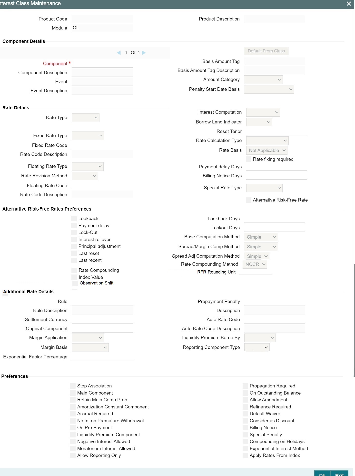

You can specify the interest components applicable to a product in the Interest Class Maintenance’ sub -screen of the ‘Loans and Commitment Product Definition’ screen.
From the Loans and Commitment Product Definition screen (OLDPRMNT), click ‘Interest’ to access ‘Interest Class Maintenance’ sub-screen.
You should necessarily use an interest class that you have created, to indicate the interest components applicable to the product. An interest class is a specific type of interest component that you can build with certain attributes.
Associating an interest class with a product
The attributes defined for the interest class defaults to the product. You have the option to modify the attributes defined for the class, to suit the requirement of the product you are creating.
Associating several interest classes with a product
You can associate several interest classes with a product.
To navigate between the classes associated with a product, you can use the arrow icons that are provided.
To disassociate a class from the product, navigate to the class using the arrow icons described above and click ‘Delete row’ button.
For an interest class, you can define the following:
Dissociating an Interest class from a product
The interest classes defined for a product is automatically applied to all contracts involving the product. If, for some reason, you want to stop applying a particular interest class to new contracts that are initiated (involving the product), you can do so by selecting the ‘Stop Association’ check box.
In effect, stopping the application of an interest class component for a product would be equivalent to deleting the class from the product. By specifying that the application of a class should be stopped, you have the advantage of using the definition made for the class again. To do this, you have to deselect ‘Stop Association’ check box . Contracts that are subsequently initiated picks up the class.
Specifying the main interest component
You can define any number of interest classes for a product. If you have defined more than one interest class, you can specify one of them as the main interest component. This interest component that is used for capitalization or amortization purposes if the repayment schedules are defined.
The details of this Main Component is shown in the Loans and Commitment - Contract Input’ screen (OLDTRONL) and you can change them there without having to invoke the ‘ICCF Details’ sub-screen. Components other than the main component have to be processed through the ‘ICCF Details’ screen.
Specifying to retain main component properties
You can specify to retain the properties of main component for a particular component. The details of main component including gets applied to the selected component. And any changes made to the attributes of main component are reflected to this particular component also. When you select this option, you cannot enter the interest definition details either at product or contract level other than selecting this component for discount.
You have to define an interest class first with the ‘Amount Category’ as ‘Expected’ and the same component can be linked at the product with ‘Retain Main Comp Prop’ selected. As per this component, interest is computed on Expected Balance which is later be used for IRR computation.
Note
Rate revision schedule definition can not be done for such components.
Specifying the event for association
Specify the association event in ‘Event’ field. The event, at which you would like to associate an interest component to a contract, is referred to as the association event.
At this event, no accounting entry (for the interest component) is passed.
Specifying the basis amount tag
The basis on which interest is calculated is referred to as the basis amount. In ‘Basis Amount Tag’ field, you have to specify the ‘tag’ associated with the basis amount. Interest is calculated on the amount represented by this tag.
Specifying the amount category
Indicate the category of the component on which the interest has to be applied. The available options are:
If the Basis Amount Category is Normal, the balance on which interest has to be applied is the Expected Balance (assuming that all the scheduled repayments, defined for the contract, are made on time). An example of this category is the application of interest on the principal of a loan.
If the Basis Amount Category is Overdue, the balance on which interest has to be applied is the amount that is outstanding, based on the repayment schedule defined for the contract. An example of this category is the application of penalty interest, on the principal or interest, when a repayment has not been made as per the schedule.
Select the applicable category using the drop-down list. The system defaults to Normal.

When you specify the Basis Category as Expected, the interest is applied on the Expected Balance.
Specifying whether Interest is to be accrued
For a product, you should specify whether accruals have to be carried out for the accruable components. If yes, the frequency of accruals (daily, monthly, quarterly, half-yearly or annually) should be specified for each product (through the ‘Loans and Commitment Product Definition Preferences’ screen).
The accruals are carried out at the specified frequency by the Automatic Contract Update function. In addition, accruals are done whenever an event (like a rate change with a Value Date, a payment, and so on.) is triggered as of a date beyond the date on which the last accruals were carried out.
Specifying the penalty start day
Oracle Lending calculates the penalty in case the loan payment is not made on the schedule date. However, if the payment date falls on a holiday, the penalty can be calculated depending on the start date that you specify in this screen:.
If you have specified that penalty start date basis as the due date, the penalty is calculated from the due date of payment even if it falls on a holiday.
If you have specified that the penalty start basis be next working day, the penalty is calculated from the working day following the holiday. Thus, the system l waives the penalty for the holiday (s).
The ‘Penalty Start Date Basis’ specifications you maintain for the Interest Class is defaulted here and the system does not allow you to change these options.
Example
Assume a loan principal payment schedule falls on 11th October 2003, which is maintained as a holiday in Oracle Lending. In addition, there is a deficit of funds in the customer’s account for making the payment.
If you have selected the due date option and payment delay days is 5 days, then the ‘Pay By Date’ is 16 October 2003. The system calculates the penalty from 16 October 2003 not from due date (11th October 2003).
If you have selected the next working day option, the system calculates the penalty from 18th October 2003 and waives the penalty for 16th and 17th October (assuming 16 and 17 are holidays).
For information on ‘Alternative Risk-Free Rates’, refer to ‘Interest Class Maintenance’ in this User Manual.
If you specify Auto Rate Code usage, all the rate changes made during the liquidation or accrual period will be considered. If you specify periodic rate code usage, the rates are periodically refreshed and the rates as of a specific frequency is applied.
This frequency is specified in the Contract Schedules screen while the Rate Code Usage is specified in the ‘Interest Class Maintenance’ sub -screen of the ‘Loans and Commitment Product Definition’ screen.
Note
If you want the floating rates to be applied automatically every time they change, you should specify Auto Rate Code usage in the ‘Interest Class Maintenance’ sub-screen of the ‘Loans and Commitment Product Definition’ screen.

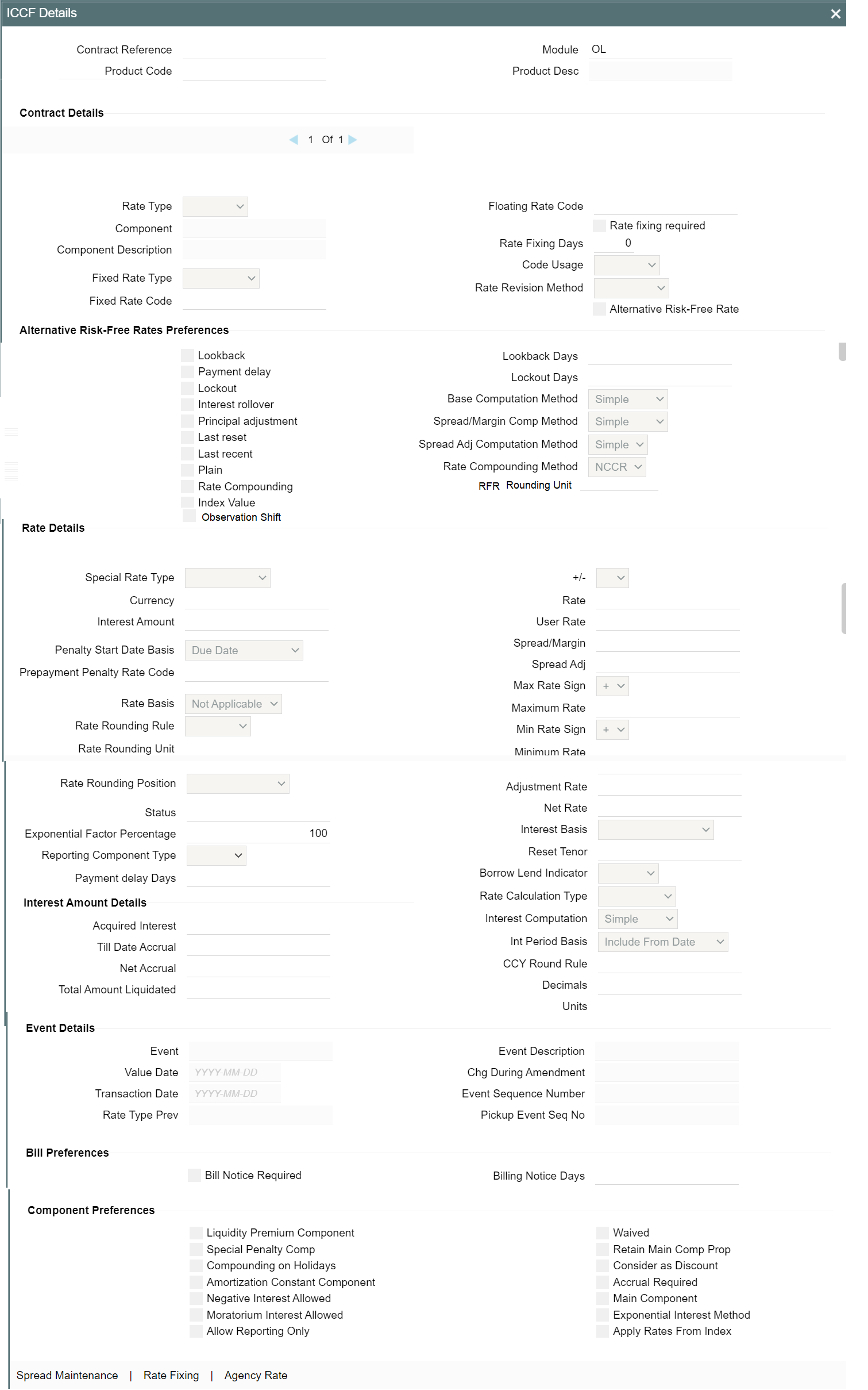

Rate Type - The Rate Type indicates whether the interest is a Fixed Rate, a Floating Rate or a Special amount. When creating a product, you should specify the Rate Type based on which interest is computed.
Floating Rate Code - If the Interest Rate Type has been specified as Floating, indicate the Rate Code to which the product has to be linked. The Rate Code corresponds to the rates, defined in the Floating Rates table, that have to be applied for the product. A Rate Code identifies a set of rates defined for a combination of Currency, Amount (if it is necessary) and an Effective Date.
Select the Rate Code applicable for the product you are defining from the option-list provided. The Rate Code can be changed during contract processing.
Floating Rate Type - In addition, you should specify the method in which the rates in the Floating Rates table have to be applied on the loan. It could either be automatic application (meaning the rate has to be applied every time it changes), or periodic application (meaning the rate has to be applied at a regular frequency, defined for each contract involving the product).
Borrow Lend Ind - For floating rate interest, you should also indicate if the interest rate for a given rate code to be applied, from the Floating Rates table, is the Borrow rate, Lend rate or Mid rate.
Reset Tenor - If interest rates are defined for the tenor of a contract, you should specify the Reset tenor. This will indicate the tenor for which the floating rate (when applied automatically) needs to be picked up from the Floating Rates Table, for contracts using this product.
Rate Calc Type - Interest rates based on the tenor of a contract could be applied in any of the following ways:
Example
The Floating Rates table has the following tenor-based interest rate definitions:
Tenor |
Interest Rate |
5 |
12% |
15 |
16% |
The tenor of the contract to be processed is 9 days. This falls between the 5 day and 15 day slabs for which interest rates are defined in the table.
Depending on the Rate Cycle Type specified, the interest rate for 9 days are applied as follows:
You can specify the various floating rate parameters explained above for a fixed rate type of interest. The appropriate floating rate is then applied at the beginning of the contract, however, this rate is subsequently remain fixed during the contract.
Fixed Rate Type - If the rate type is ‘Fixed’, you have to indicate whether the rate would be entered by the user or needs to be picked up from the rate maintenance table. The following options are available:
For more details, refer the section titled ‘Identifying products for agency contract creation’ in the ‘Defining the Attributes specific to a Loan product’ chapter of the Bilateral Loans User Manual.
Interest Computation - You have to specify the method to be used for computation of interest. The available options are:
Compounding on holidays - You can opt to compound interest on holidays. Select the ‘Compounding on Holidays’ option to indicate the same.
The ‘Interest Computation’ and ‘Compounding on Holidays’ options are available only for Loan and Commitments products. These options can be specified only for a product. You cannot change them at the contract level.

Specifying the prepayment details
Waiving interest on premature withdrawal - You can opt to waive Interest on premature withdrawal of the loan. Select the ‘No interest on premature withdrawal’ option to indicate that interest needs to be waived if premature withdrawal (partial of full) is done for the loan.
Reapplying Interest rate on prepayment – If the ‘Fixed’ rate type is ‘Standard’, you can opt to reapply interest when a prepayment is made.
You can reapply interest on one of the following:
Specifying the Rule ID
You can link a rule to a product. In the Product ICCF Details screen, in the Rule ID field, pick the rule you want to link to the product. For an interest type of rule, all the interest-related details have to be specified in the Product ICCF Details screen.
Specifying the Settlement Currency
The Settlement Currency is the currency in which the interest amount will be calculated. The interest amount applicable for a contract will be calculated in this currency. The appropriate conversion rate (defined for the product as the applicable Rate Type) will be applied to carry out a conversion if the repayment account is in a different currency.
Specifying whether Interest Details can be amended
A change to a contract (after it has been authorized) that involves a change in its financial details constitutes an Amendment on the contract. You can indicate whether such an Amendment, called a Value Dated Change, should be allowed for the interest component being defined.
You can amend the following through this function:
To amend a contract, you have to invoke the contract, ICCF Details’ screen of the ICCF module through the Value Dated Changes function.
Specifying whether refinancing is required
While creating a loan product, you have the option of indicating whether the accruals/liquidations involving a particular component should be tracked for refinancing. Select the check box positioned next to this field to indicate that Refinancing is required
Specifying the original component
If you enable the ‘Refinancing Required’ option, you have to identify the original component for the refinance component.
Enabling the Consider as Discount option
While defining an interest component for either the loans or the bills module, you can indicate whether the interest component is to be considered for discount accrual on a constant yield basis.
The consider as discount option is available for
The value of this field is defaulted from the ‘Interest Class Maintenance’ screen. However you can change it over here.
For Bearing contracts, if the option ‘Consider as Discount’ is checked then the option ‘Accrual Required’ also has to be checked. If the option ‘Accrual Required’ is not checked, the option ‘Consider as Discount’ is disabled.
For Discounted contracts, you can select either one of the options or both together. If the options ‘Accrual Required’ and ‘Consider as Discount’ are selected then discounted interest is considered for IRR calculation. If the option ‘Accrual Required’ is not selected and ‘Consider as Discount’ is selected, then discounted interest is considered a part of the total discount to be accrued.
If neither option is selected, the interest is directly recognized as income during interest liquidation.
Note
This option is not available if the amount category is Penalty.
Enabling Negative Interest Allowed option
Negative Interest Allowed is added at interest class level which is applicable for main interest classes of OL module. Following are the important functionalities of the ‘Negative Interest Allowed’ option.
Note
The ’Net Negative Interest ‘ check box is available in the ‘Product Preferences’ screen.
If this check box is selected, then during interest liquidation, the system internally nets the positive and the negative amounts being paid to the customer.
This check box is only for products with negative interest allowed is selected for main component.

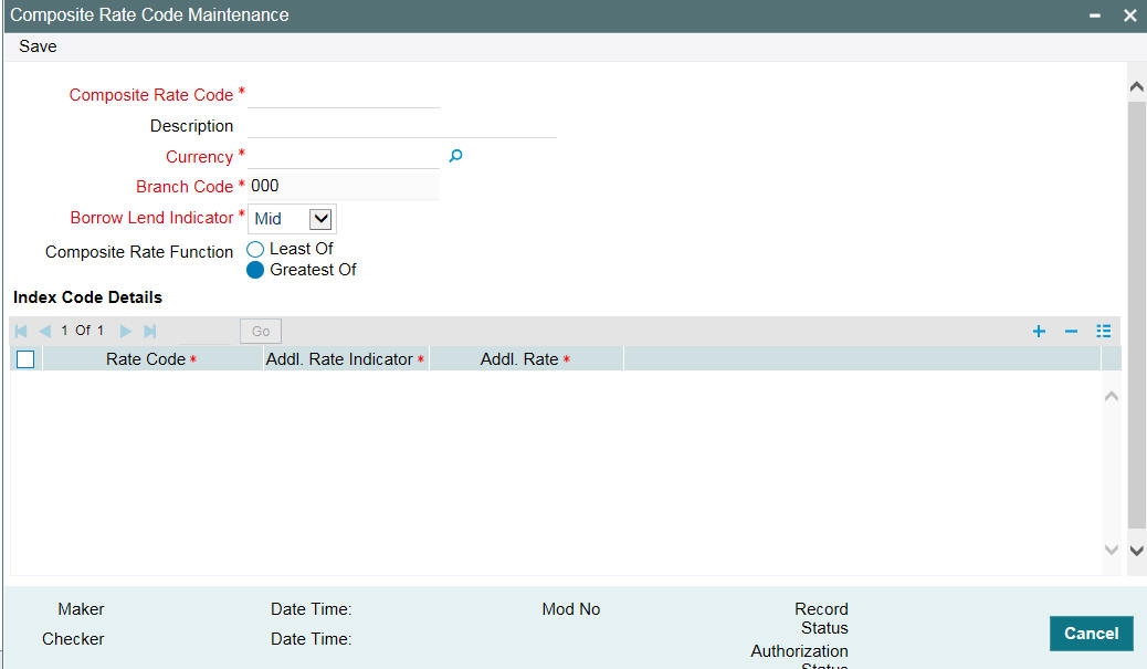

You can maintain the composite rate code from the head office using ‘Composite Rate Code Maintenance’ screen.
You can access this screen by typing ‘OLDCMPMT’ in the field at the top right corner of the Application tool bar and clicking the adjoining arrow button.
Specify the following details here:
Composite Rate Code
Specify the code you want to maintain for the composite rate.
Description
Specify a small description for the composite rate code.
Currency
Select the currency for which the composite rate code is maintained.
Branch Code
Select the branch for which the composite rate code is maintained.
Rate Function
Select if the composite rate should be the least or greatest of the rates maintained plus the additional rate for the rate codes.
Following index code details are populated here:
You can perform following operations in the ‘Composite Rate Code Maintenance’ screen:

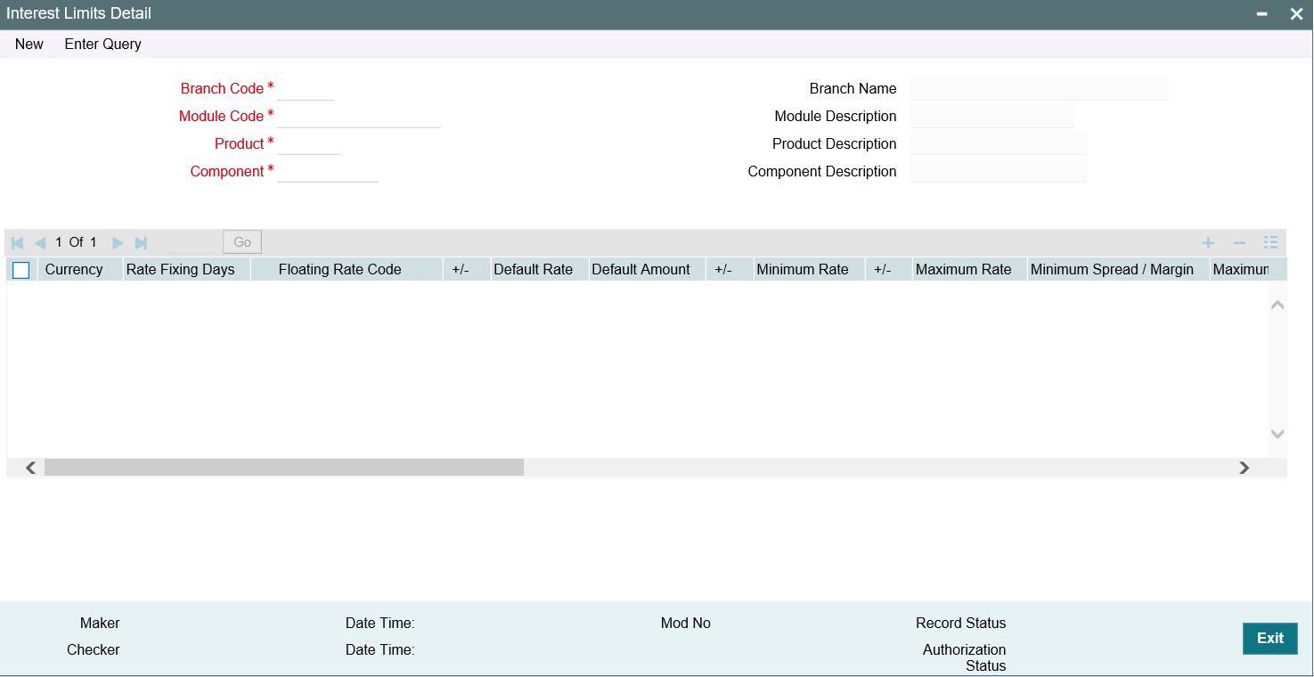

You can maintain tenor based, currency-wise interest limits for a combination of Product and Interest Component through the ‘Interest Limits Detail’ screen. You can access this screen by typing ‘OLDINTLM’ in the field at the top right corner of the Application tool bar and clicking the adjoining arrow button.
When an interest class for which currency-wise interest limits have been maintained is associated with a Loans product (in the Interest Class Maintenance’ screen), the product inherits the limits, by default. Such default limits can be modified if required, when the interest limits for the product and branch combination are maintained, in the ‘Interest Limits Detail’ screen.
This maintenance would be applicable for all contracts for which:
You can maintain the following information to set up the tenor-based, currency-wise interest limits for a product, interest component, and branch combination:

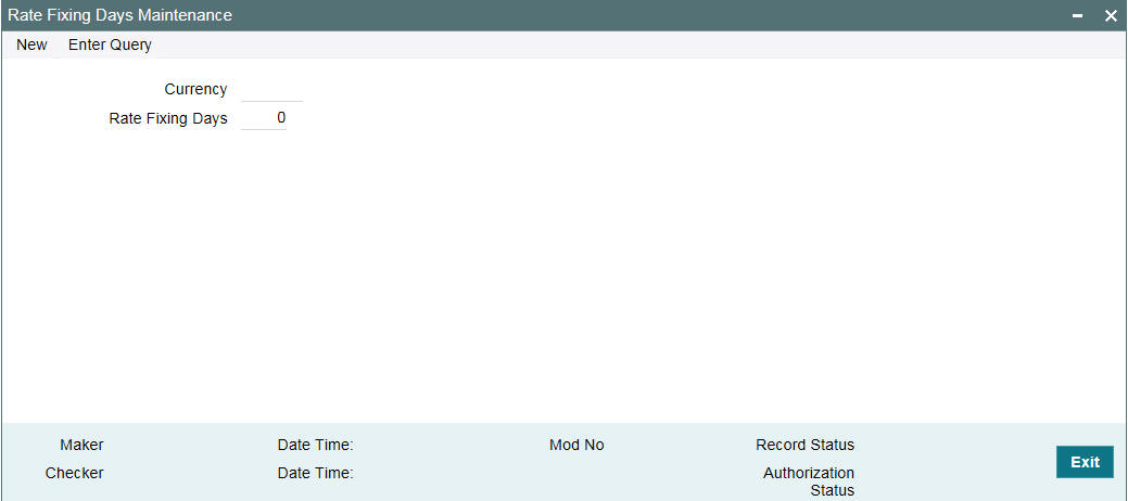

Capturing the Rate Fixing Days
The rate fixing days gets defaulted from the ‘Rate Fixing Days Maintenance’ screen. This is a numeric field. The system checks for the following:
Capturing the Floating Rate Code
Floating rate code is applicable for floating products. You cannot use floating rate code for fixed rate type. If floating rate code are different in ‘Interest Class Maintenance’ screen (LFDINTCL) and 'Bilateral Loans Product Definition’ screen (OLDPRMNT), then the system takes the floating rate code from the ‘Bilateral Loans Product Definition’ screen. If you want to change the floating rate code, you can change in this screen.
Capturing the Default Amount or Default Rate for Late Payment Charge
For components defined with Rate Type ‘SPECIAL’ in ‘Interest Class Maintenance’ screen, you can specify a default flat amount or a default rate at the interest limit level which is defaulted to the ‘Interest Limits Details’ screen.
Based on the value of ‘Special Rate Type’, you can either maintain the ‘Default Rate’ or ‘Default Amount’ for late payment charge applicable to the loan product.
If the value of ‘Rate Type’ is ‘SPECIAL’ and ‘Special Rate Type’ is ‘FIXED’ in the ‘Interest Class Maintenance’ screen, then you can specify the default fixed rate to be applied as late payment charge to all loans created under this loan product.
You can specify the default late payment charge (either fixed rate or flat) by selecting the loan product code and the late payment charge component. This component should already be linked to the loan product through the ‘Interest Class Maintenance’ screen.
For interest rate components, you can specify the minimum and maximum rate that can be changed at the contract level.
For Alternative Risk-Free Rates
If base rate + spread adjustment falls below minimum rate, base rate is adjusted to bring base rate + spread adj to minimum rate.
Example, if minimum rate is 2 and base rate received is 1 and spread adj is 0.5, 1+0.5 = 1.5 which is less than 2 so base rate is adjusted to 1.5, so that 1.5+0.5 = 2 (same as min rate)
If base rate + spread adjustment falls above maximum rate, base rate is adjusted to bring base rate + spread adj to maximum rate.
Example, if maximum rate is 5 and base rate 4 and spread adj is 2, 4+2 = 6 which is more than 5 so that base rate is adjusted to 3, so that 3+2 = 5 (same as max rate)
For Fixed Rate products
If the interest rate specified for a contract is less than this minimum rate, the minimum rate is applied on the contract. Similarly, if the interest rate specified for a contract is greater than this maximum rate, then the maximum rate specified is applied on the contract.
By defining minimum and maximum rates for a fixed interest, you can ensure that your rates stay within the stipulated limits.
For penal interest components, you can specify the overdue tenor for which the penalty interest should be applied.
For Floating Rate Products
For Floating Rate products, specify the Minimum and Maximum spread that can be applied on the floating rate.If the spread specified during contract processing is less than the value specified as the minimum spread, this value will be picked up as the spread. Similarly, if the spread specified during contract processing is more than the value specified as maximum spread, this value is picked up as the spread.
By defining minimum and maximum spread for floating interest, you can ensure that your spread stays within the stipulated limits.
The rate maintained for the maximum tenor is used if the Overdue days extend beyond the maximum tenor maintained.

Alternative Risk-Free Rates Preferences
For OL module, the contract defaults RFR parameters like 'Lockout Days', 'Payment Delay Days', 'Lookback days', ‘Index Value’ and ‘ RFR Rounding Unit’ from 'Interest Limit' screen.
For LB module, RFR parameters like 'Lockout Days', 'Payment Delay Days' and 'Lookback days' are defaulted from 'Interest Limit' screen to 'DD Product' subsystem in Tranche screen. Then while booking DD Contract, the system defaults these parameters from Tranche to Drawdown screen.
Penalty interest is charged when a principal repayment is defaulted on. Penalty interest is charged either on the entire outstanding principal amount or on the principal schedule that is overdue, for the overdue period. You also have the choice of applying different penal interest rates for different overdue periods.

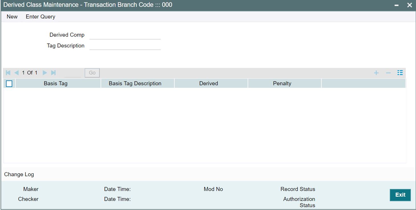

Using this screen, you can create a derived component and the mapping to the original Basis Amount. You can invoke the ‘Derived Class Maintenance’ screen by typing ‘LFDDRVTG’ in the field at the top right corner of the Application tool bar and clicking the adjoining arrow button.
The derived Component Balance Amount Tag (_BAL) Tag can be selected as the 'Basis Amount' like for any other component.
If a penalty component is based on a derived tag then if anyone or multiple of them are due, the penalty is computed on the sum of the total basis amount.

From the ’Loan and Commitment- Contract Input’ screen, click ‘ICCF’ to access the contract ‘ICCF Details’ screen.
It is possible to define more than one interest component. You can have several interest components, which you link to a product. The contract involving the product, in turn, will be linked to these interest rules.
Example
There can be one interest rule for the main interest (for example, 14%). You can have a tenor-based commission defined as an interest rule for the same product (for example, 3%). Both these are applicable to the contract.
In the contract ‘ICCF Details’ screen use the set of two buttons to go to the next or previous that has been linked.

System defaults the maintenance done for ‘Special Rate Type’ in the ‘Interest Limits Maintenance’ screen. However, you can edit this value and select the special rate type from the adjoining drop-down list. This list displays the following values:
Specifying Interest Rate Rounding Components
The ‘Rate Rounding Rule, ‘Rate Rounding Unit’, and ‘Rate Rounding Position’ values get defaulted from ‘Interest Limits Detail’ screen. If required, you can change these values

You can fix the rate of interest for fixed rate type and floating periodic manual type of loans while contract booking by clicking ‘Rate Fixing’ button in the ‘ICCF Details’ screen.
You can specify the periodic rate manually here.
The following details in the screen are displayed from the parent screen:
Reset Value Date
Specify the effective date from which the rate should be applicable for the contract.
Next Reset Date
Specify the end date of rate effective end date. The last effective date of the rate entered here.
Rate
The interest rate applicable for Main Interest Component is defaulted from previous period. However you can edit it.
Spread
The spread rate applicable for the Main Interest Component (User Input) is from the previous period. However you can edit it.
Final Rate, the net rate applicable for the Contract (Rate + Spread) gets displayed here.
Note
Current Reset Date is populated as Value date of the contract for both current dated and back valued contracts.

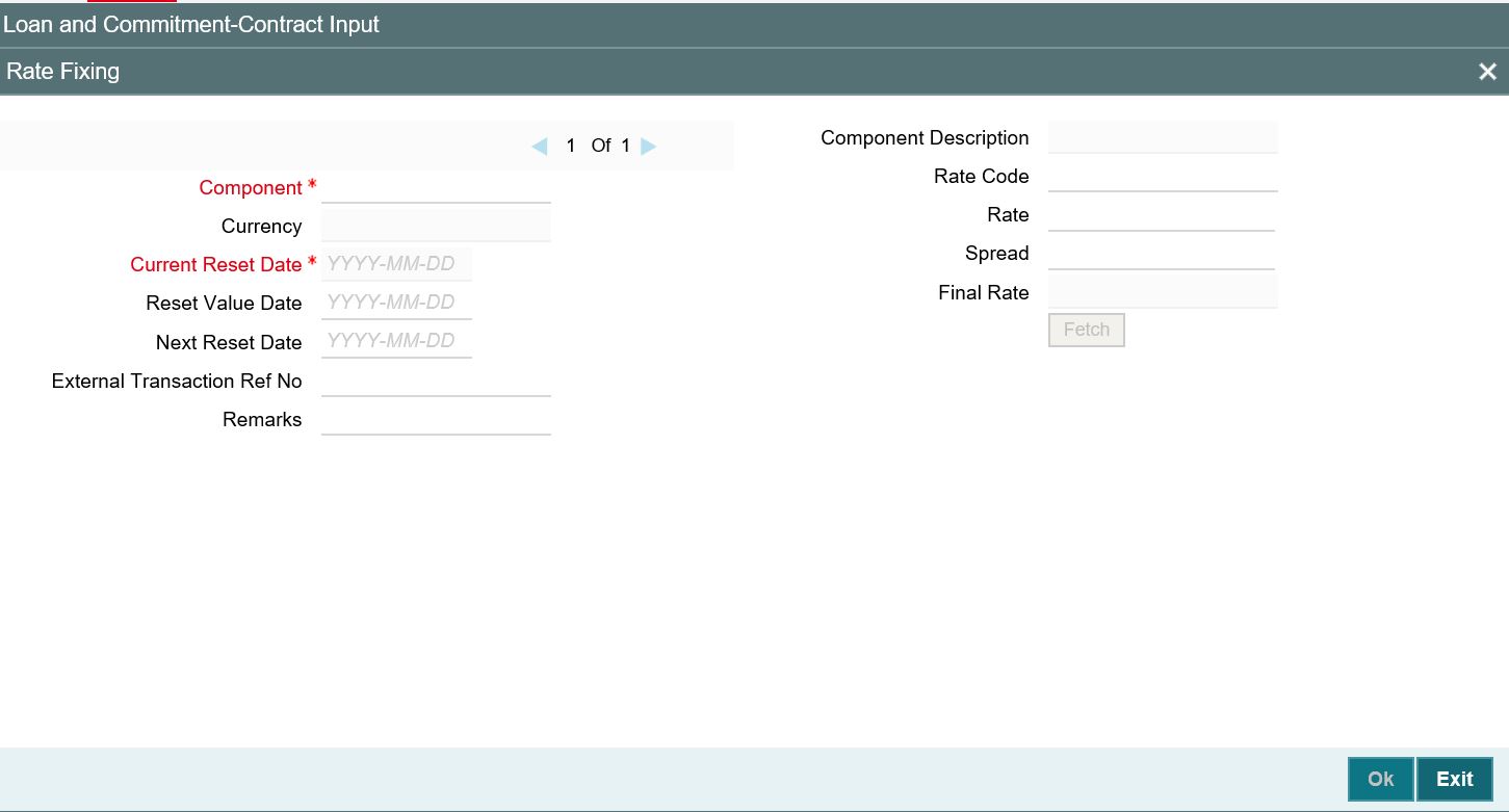

Manual rate fixing can be done for fixed rate type and floating periodic manual type of loans in Manual Rate Revision (OLDRTFIX) screen. You can perform following operations in the ‘Manual Rate Revision’ screen:
The loan index rates (Base rates) are loaded to the system always with effective date. This means that rates upload date is same as effective date at the rates data store. Index rates available today to upload in to the system is the effective date same as today. The rates are uploaded always at the HO branch and subsequently these rates are propagated to all the transaction branches.
Whenever rate derivation is done in OBCL, the system considers the index rates as of value date prior to rate fixing days, therefore it is referred as ‘Rate Fixing Days’.
For example, if you book a contract today but you need index rate prior to 3 days, then you can mention “=3” in ‘Rate Fixing Days’. Then the system considers 3 days prior index rate.
In case index rates are not available in the system, then an error message is displayed.
OBCL does not allow EOD process when index rates are not available for a day and there are any rate exceptions that need to be reprocessed.
For bilateral loans, rate fixing is applicable during the following life cycle of a loan.
You can invoke the ‘Rate Fixing Days Maintenance’ screen by typing ‘OLDCCYRF’ in the field at the top right corner of the Application tool bar and clicking the adjoining arrow button.
Specify the following:
Currency
Enter the currency. You can maintain rate fixing days for each currency. The currency details are defined in the Currency Details screens (‘CYDCDEFE’).
Rate Fixing Days
Enter the rate fixing days. The rate fixing days must be greater than zero and not greater than 5 days.
