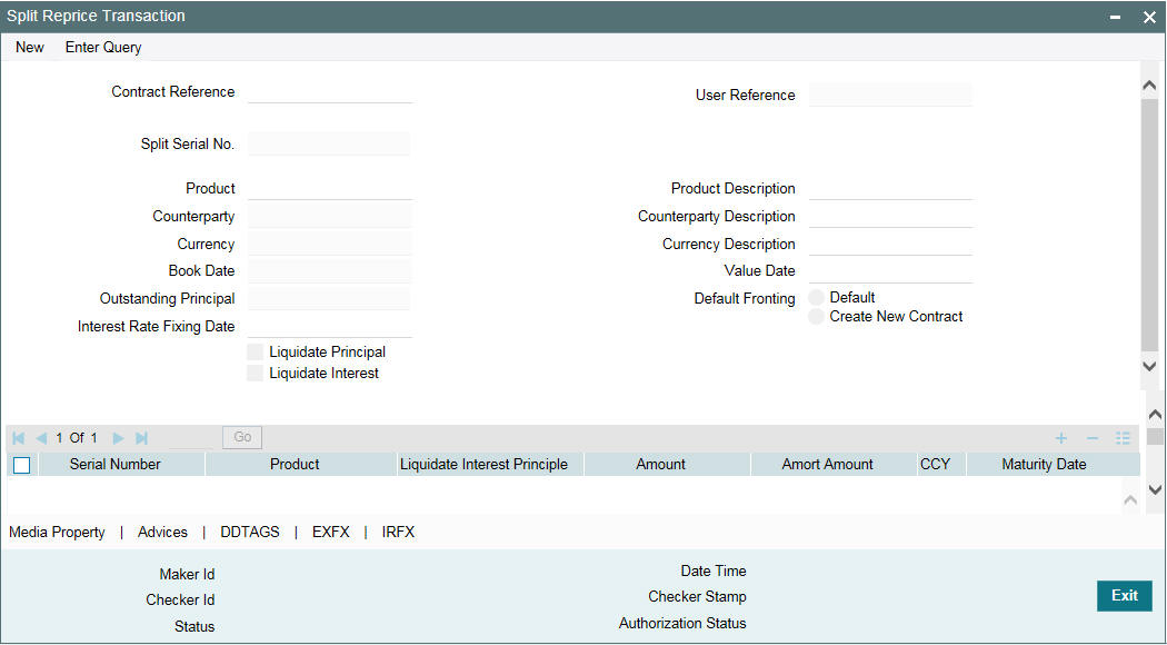

12.2 Capturing Split Re-Price Instructions
When you re-price a contract, the amount is taken from the parent contract into the ‘Re-Price Suspense GL’ (specified in the ‘Preferences’ sub-screen of the ‘Branch Parameters – Detail’ screen) before moving it to the child contract.
You can re-price a transaction (or part amount) into a new transaction or multiple transactions through the ‘Re-Price Transaction (Split Details)’ screen.

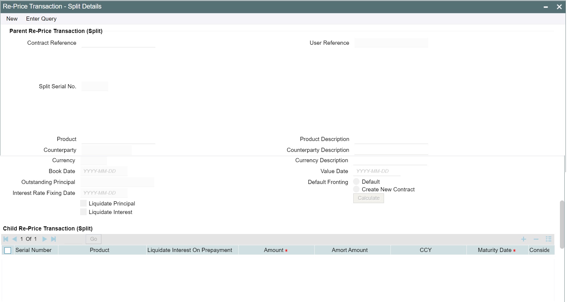

You can invoke the ‘Split Reprice Transaction’ screen by typing ‘LBDREPRS’ in the field at the top right corner of the Application tool bar and clicking the adjoining arrow button.
The current system date is displayed as the ‘Book Date’ (you are not allowed to change this date) and ‘Value Date’ of split re-pricing.
In addition, you have to specify the following:
Contract Ref No
Select or enter the reference number of the contract to be re-priced. When you enter the reference number, the following details are displayed for the parent contract:
The Split Serial No. gives you the number of split transactions carried out on the parent contract till date. It starts with one and increments by 1 for every subsequent split transaction.
Note
Value Date
By default, the system displays the current date. You can change this date provided the new date is less than the maturity date or greater than or equal to the value date of the contract.
Liquidate Principal
By default, the system selects this check box if the total amount of the child contracts is less than the outstanding principal balance. It instructs the system to liquidate the outstanding principal for the parent contract at the time of re-pricing. You can deselect this check box, if required.
Liquidate Interest
By default, this check box is deselected. If you select this check box, the system liquidates the outstanding interest for the parent contract at the time of re-pricing, if interest payment schedule exists on that day. If you do not check this box, the interest remains with the parent. On the event of complete liquidation of principle or re-price amount more than the principle outstanding also you can select or deselect the Liquidate Interest check box.
Interest Rate Fixing Date
The system displays the interest Rate Fixing Date.
In the case of prime loans, this box is not applicable and prime interest liquidation happens to the extent of the re-price amount and principle if any.
Default Fronting
Indicate if the fronting detail has to be defaulted for the increase in amount during rollover / reprice. You can select one of the following options:
On selecting the ‘Default Fronting’ option, the front/fund details is defaulted from the past disbursement events to the new disbursement event (VAMB/VAMI) which is triggered as part of reprice processing. System generates BPMT to the borrower for the fronted/funded investor’s portion and proceed with the reprice processing.
On selecting the ‘Create New Contract’ option, the system defaults the front/fund details to the new disbursement event (VAMB/VAMI) which will be triggered as part of reprice processing, but the BPMT event is not fired based on these default options. Further, as part of Reprice processing, one of the child contractsare created for the increase in amount without any default fronting/funding options. In the split child contract, for the increased amount, the funding details are captured and borrower payment is also be sent from this child contract.
12.2.1 Specifying Child Contract Details
In the ‘Child Re-Price Transaction (Split)’ section of the screen, you can specify the following details of the child contracts.
Product
Select the product under which the child contract is to be created during re-pricing.
Liqd Int on Prepayment
The system allows you to check this option only if the product you select is defined as a ‘Prime Loan’ product (in the ‘Loans Syndication – Borrower Product Preferences’ screen). If selected, the system liquidates the interest component along with the principal either on the frequency-based schedule date or at the time of principal prepayment. In case of the latter, system calculates interest only on the principal prepaid.
Amount
Specify the transaction amount for the split/child contract. After you specify the amount, the system displays the following information:

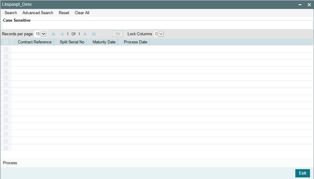

12.3.2 Generating Child Contracts for Future Dated Re-Pricing
In the case of future dated re-pricing, Oracle Banking Corporate Lending allows you to create child contracts in advance, that is,. before the value date of the split. You can create the child contracts through the ‘Partial Split Instruction Processing’ screen. You can invoke the ‘Partial Split Instruction Processing’ screen by typing ‘LBSPASPT’ in the field at the top right corner of the Application tool bar and clicking the adjoining arrow button.
In this screen, the system displays all future dated parent contracts for which child contracts are yet to be created. You can select the contracts for which you wish to create the child contracts in advance. Check the box against each record to select a contract.
Click ‘Ok’ to generate the child contracts for the selected parent contracts.

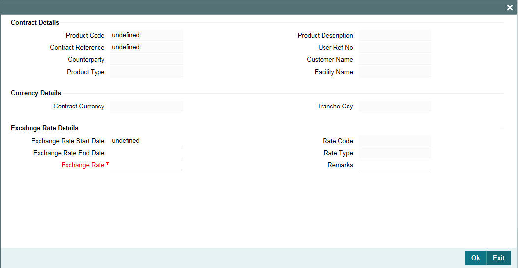

12.3.3 Fixing Exchange Rate for Child Contracts
If drawdown currency is different from the linked tranche currency, you have the option to fix exchange rate for each child contract. You can do this through the ‘Exchange Rate Fixing’ screen. Click ‘Exchange Rate Fixing’ button in the ‘Re-Price Transactions (Split Details)’ screen.
For more details on the above screen, refer the section titled ‘Fixing exchange rate for drawdown currency’ in the ‘Loan Syndication Contracts’ chapter of this User Manual.

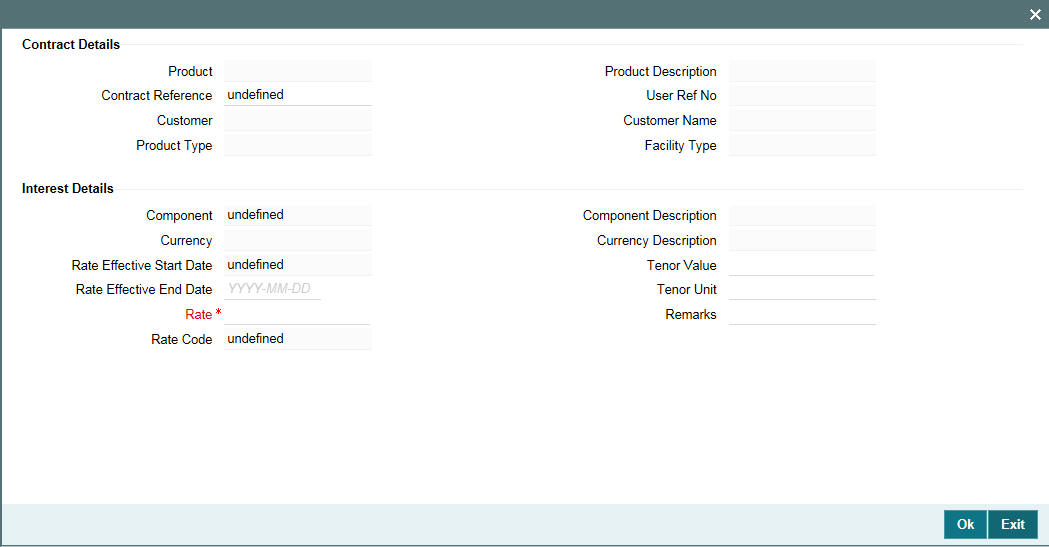

12.3.4 Fixing Interest Rate for Child Contracts
If you have checked the ‘Rate Fixing Required’ box for the interest component at the product level (in the ‘Interest Definition’ screen), you can fix the interest rate for such components in the child contracts, at the time of re-pricing. To do this, click ‘Interest Rate’ button in the ‘Re-Price Transactions (Split Details)’ screen.
For details on the above screen, refer the section titled ‘Fixing interest rate after drawdown booking’ in the ‘Loan Syndication Contracts’ chapter of this User Manual.

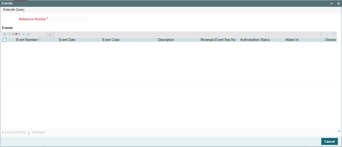

12.3.6 Viewing Event Details
You can view the events, accounting entries and advices generated for contract in the ‘Event Log Details’ screen. Click ‘Events’ to invoke this screen.
For more information on the ‘Event Log Details’ screen, refer the section ‘Viewing events for the facility’ in the ‘Loan Syndication Contracts’ chapter in this User Manual.

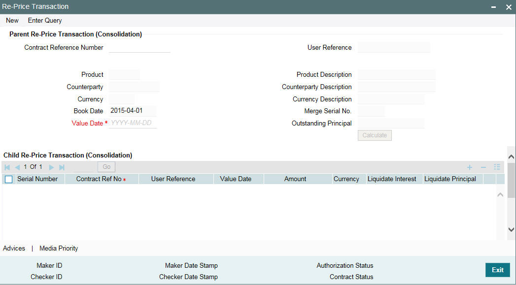

12.4 Capturing Consolidation Re-Price Instructions
You can consolidate one or more re-priced child contracts with a parent contract. The same can be done through the ‘Re-Price Transaction (Consolidation Details)’ screen. You can invoke the ‘Re-Price Transaction’ screen by typing ‘LBDREPRC’ in the field at the top right corner of the Application tool bar and clicking the adjoining arrow button.
Note
You cannot capture split/merge reprice instructions for the same contract if any reprice is pending for the process.
The current system date is displayed as the ‘Book Date’ (you are not allowed to change this date) and ‘Value Date’ for consolidated re-pricing. In addition, you have to specify the following details:
Contract Ref No
Select the reference number of the parent contract into which the selected child contracts (in the ‘Child Re-Price Transaction’ section of the screen) are to be consolidated. When you enter the reference number, the following details of the selected parent contract is also displayed:
The ‘Merge Serial No.’ gives you the number of merge transactions carried out on the parent contract.
Value Date
By default, the system displays the current date as the merger value date. You can change this date provided the new date is less than the maturity date or greater than or equal to the value date of the parent contract. The system allows current dated, forward dated or back dated merger re-pricing. However, back dated merge re-pricing cannot be beyond the:

In the ‘Child Re-Price Transaction (Consolidation)’ section of the screen, you can specify the following details of the child contracts that have to be consolidated to the selected parent contract.
Contract Ref No
Select the reference number of the child contract that is to be merged with the parent contract. The option list displays the reference number of all the non-LC type of drawdowns which are eligible for merge reprice contracts. Contracts which satisfy the following conditions are displayed in the option list:
Upon selection of the child contract, the following details are displayed:
Amount
The amount of the child contract which is re-priced and consolidated with the parent contract is displayed here. This is the outstanding principal amount of the child contract. The amount can be less than or equal to the outstanding principal.
The system displays the sum total of the merged amount in the ‘Total Merge Amount’ field.
Currency
The currency of the child contract is displayed here. You can merge only those child contracts that have the same currency as the parent contract.
Merge Reprice is not allowed for contracts with 'Partial Prepayment Allowed' option selected.
Liquidate Interest
By default, this box is deselected. If you select this check box, the system liquidates the outstanding interest for the child contract at the time of re-pricing, if interest payment schedule exists on that day. If you do not select this check box, the interest remains with the child.
Note
If the child contract is prime loan, the system liquidates the interest which has been ac­crued till date (the re-price value date) irrespective of the ‘Liquidate Interest’ option.
Liquidate Principal
By default, the system selects this check box if the total amount of the child contracts is less than the outstanding principal balance. It instructs the system to liquidate the outstanding principal for the child contract at the time of re-pricing. You can deselect this check box, if required.
Remarks
You can capture additional remarks for the consolidation transaction, if required.

12.6.0.2 Rate Setting
To set the rate setting rules for the Split Re-Price Instructions, click the ‘Rate Setting’ button in the ‘Split Re-Price Instructions’ screen (LBDREPRS) and invoke the ‘Rate setting’ screen.
Specify the following details.
Contract Details
Product code
The system displays the product code.
Contract Ref number
The system displays the contract ref number.
User ref number
The system displays the user ref number.
Customer
The system displays the customer name.
Facility name
The system displays the facility name.
Split Details
Split number
The system displays the split number.
Principal roll amount
The system displays the principal roll amount.
Interest roll Amount
The system displays the Interest roll amount.
Roll Product
The system displays the roll product.
Total roll amount
The system displays the total roll amount.
Maturity date
The system displays the maturity date.
Interest rate rounding rules
Rounding rule
Select the rounding rule from the adjoining drop down list. Select one of the options listed below:
Rounding Unit
The rounding unit enables only if the you have selected the ‘rounding rule’ as ‘Down’ and ‘Upto’.
Interest rate period
Select one of the interest rate periods from the options given.
Note
Once all the Rate setting rules are maintained and when you come out of ‘Rate Setting Rule screen’ by clicking OK button , following override message is displayed displayed.
