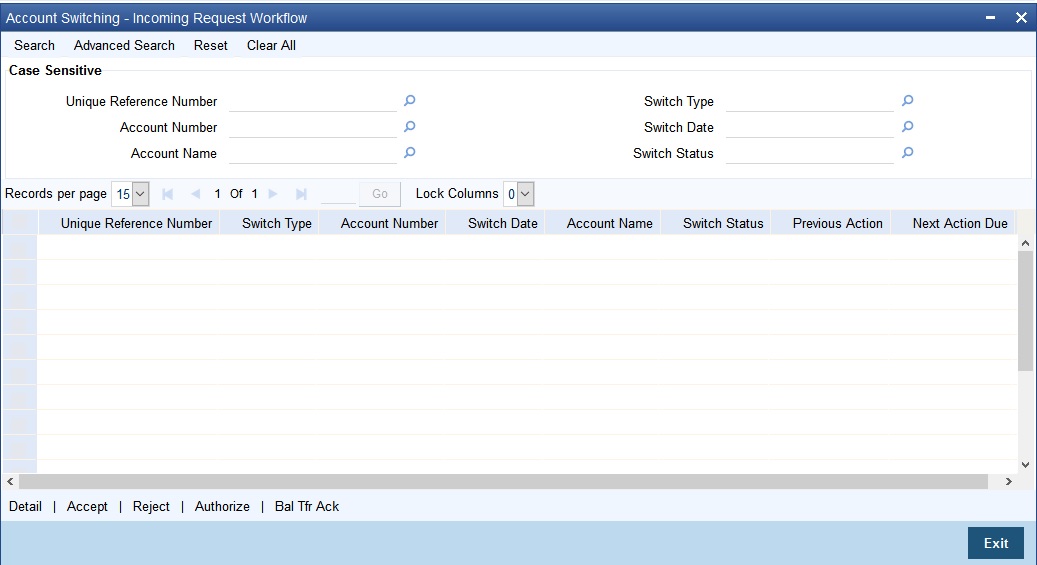

10.3.7 Incoming Request Workflow
You can query records, view the details of a record, accept, reject or acknowledge balance transfer actions through ‘Account Switching Incoming Request Workflow’ screen. To invoke this screen type ‘STSASIRW’ in the field at the top right corner of the application toolbar and click the adjoining arrow button.
In the above screen, you can base your queries on any or all of the following parameters and fetch records:
l Unique Reference Number
l Account Number
l Account Name
l Switch Type
l Switch Date
l Switch Status
The system displays the following details depending upon the selection criteria:
l Account Number
l Switch Type
l Switch Status
l Previous Switch Action
l Next Action Due

10.3.14 Cancelling Payment Arrangements
You can cancel the payment arrangements of a partial switch service through ‘Account Switching Cancel Payments’ screen.To invoke the screen type ‘STDASCNP’ in the field at top right corner of the application toolbar and click the adjoining arrow button.
You can view the following details in this screen:
l Routing Unique Reference Number
l Switch Type
l Switch Date
l Service User Number
l Switch Action
l New Account Number
l New Account Name
l Old Account Number
l Old Account Name
Credit Transaction Details
The system displays the following credit transaction details:
l ID
l Credit Account
l Credit Account Name
l Financial Institution Member ID
Other Details Code
Specify the other details code for outgoing request. For incoming request, the system displays the other details code from incoming payment cancel message.
Cancel
Check this box if the payment should be cancelled by the old bank.
Direct Debit Details
The system displays the following direct debit details:
l Mandate ID
l Name
l Organization ID
l Last Collection Date
Cancel
Check this box to cancel the direct debit by the old bank.
Message ID
The system displays the message ID.
Creation Date Time
The system displays the message creation date and time.
Technical Rejection Details
The system displays the following technical rejection details:
l Response Code
l Additional Information
The system uploads technical rejection on Cancel Payment Arrangement message based on the unique reference number and switch action TRJT. To resubmit the cancel of payment arrangement message, you can mark the info response as TRJT.
10.3.14.1 Outgoing Cancel Payment Arrangements Message
You can generate the outgoing cancel payment arrangement message by configuring intra day or end of day batch process. All the authorized cancelled payments, cancel parameter enabled records with ‘Switch Action’ as CNCP will be generated through this batch process.
A message ID in the following format is generated and stored in the Account Switching Outgoing Message Browser:
l Position1 to 6 - Service User Number
l Position 7 to 8 - 2 digits year
l Position 9 to 11 - 3 digits day of year (001 to 366)
l Position 12 to 13 - 2 digits Message number. For Switch Termination Message it is 03
l Position 14 to 28 - 15 characters. Unique Reference Number by stripping the SWI and having only F or P as the first character.
l Position 29 to 35 - 6 digits running sequence number
10.3.14.2 Uploading Incoming Cancel Payment Arrangements
The incoming cancel payment arrangements message is processed from the Account Switching Service Incoming Message Browser. The message is decomposed and then uploaded to Account Switching Cancel Payments of the account branch.
10.3.15 Auto Completion for Partial Switch
The system processes the partial switch requests which are not marked for completion based on the auto completion months at the Account Switching Service bank parameters. The switch action of the request will be COMP. The switch complete message will not be generated for these requests because the Account Switching Service will automatically mark the request as completed, at the end of EOTI, on reaching the date.
10.3.16 Authorizing Account Switching Service
You can authorise account switching service through Account Switching - Authorization’ screen. You can invoke the screen by typing ‘STDASAUT’ in the field at the top right corner of the Application toolbar and clinking the adjoining arrow button.
You can specify the following in this screen:
Specify the unique reference number.
Switch Action
The system displays the action of the selected unique reference number.
Switch Status
The system displays the status of the selected unique reference number.
Click ‘Authorize’ to authorize the switch service.
10.3.17 Completing Account Switching Service
You can query a unique reference number applicable for outgoing switch workflow and notify the account switch completion status through Account Switch Completion screen. You can invoke this screen by typing ‘STDASCMP’ in the field at the top right corner of the application toolbar and click the adjoining arrow button.
Switch Action
Switch Status
Click ‘Complete’ to mark the switch service as completed.
The switch action will be updated as ‘COMP’ and the switch complete message will be generated once ‘Complete’ button is clicked on the queried unique reference number.
