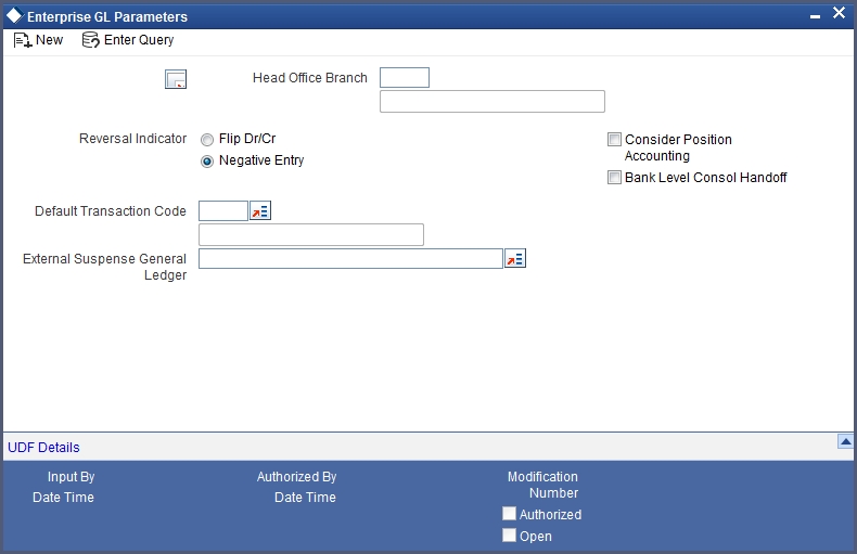

7.1.2 Maintaining Enterprise GL Parameters
Enterprise GL parameters can be captured in the ‘Enterprise GL Parameters’ screen. This is a head office (HO) level maintenance screen where only one set of Enterprise GL Parameters is allowed. Hence, this screen allows you to maintain only one record at the HO Branch level.
You can invoke the ‘Enterprise GL Parameters’ screen by typing ‘EGDGLPRM’ in the field at the top right corner of the Application tool bar and clicking the adjoining arrow button.
The following information can be captured in this screen.
HO Branch
Head Office branch code is defaulted to this field. You can not modify the value.
Reversal Indicator
In cases where Enterprise GL systems are not able to accept negative numbers in the amount field, the reversal entries will be handled by flipping the accounting entry indicator (Dr/Cr) and always quoting an absolute number in the amount fields. Reversal Indicator provides an option to choose among flipping the accounting entry indicator or providing negative amounts.
Consider Position Accounting
Choose this option if you want the position accounting entries to be included for reporting.
Bank Level Consol Handoff
If you choose this option, the handoff creation process will be triggered only after the data extraction is completed in all the branches.
Note
Data extraction in Oracle FLEXCUBE will always be performed at branch level.
Default Transaction Code
Specify the transaction code that should be used to handle report accounting entries when there is a change in the customer account reporting GL. This change could be due to current balance movement or account status change or reporting GL maintenance change.
A brief description of the chosen transaction code is displayed alongside.
External Suspense GL
During data extraction the system validates whether the accounting entries posted to the GLs are valid or not based on the branch and currency restrictions specified in the EGL Master screen. In case such violations are found the system will have to post those accounting entries in a separate suspense GL.
You can specify the suspense GL that should be used to report such accounting entries, here This should be a valid external GL.
You can select the appropriate suspense GL from the adjoining option list which displays all the GLs defined in the ‘EGL Master’ screen.

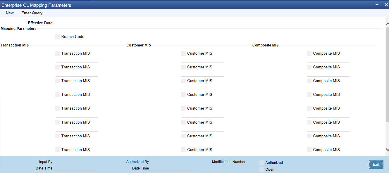

7.2.1 Specifying Enterprise GL Mapping Parameters
You can map different combinations like the GL code and currency in Oracle FLEXCUBE to a GL in the Enterprise GL system. These parameters can be maintained for a given effective date and any modification made will be effective from corresponding business date. Change in the mapping will not have any effect on the historical information that has been already extracted or handed off.
You can invoke the ‘Enterprise GL Mapping Parameters’ screen by typing ‘EGDMAPRM’ in the field at the top right corner of the Application tool bar and clicking the adjoining arrow button.
Mapping parameters can be chosen as any of the following fields:
Effective Date
The date from which mapping is effective is displayed here. This field is always defaulted to the application date and you can not change it.
7.2.1.1 Specifying Mapping Parameters
Branch Code
Check this option if you wish to include branch as on of the mapping parameters
Transaction MIS
The system displays all the transaction MIS classes defined in Oracle FLEXCUBE. However only the ones that have been defined as ‘mandatory’ in the MIS Class Maintenance screen will be enabled. Choose the class that you want to include in the mapping parameters.
Customer MIS
The system displays all the customer MIS classes defined in Oracle FLEXCUBE. However only the ones that have been defined as ‘mandatory’ in the MIS Class Maintenance screen will be enabled. Choose the class that you want to include in the mapping parameters
Composite MIS
The system displays all the composite MIS classes defined in Oracle FLEXCUBE. However only the ones that have been defined as ‘mandatory’ in the MIS Class Maintenance screen will be enabled. Choose the class that you want to include in the mapping parameters

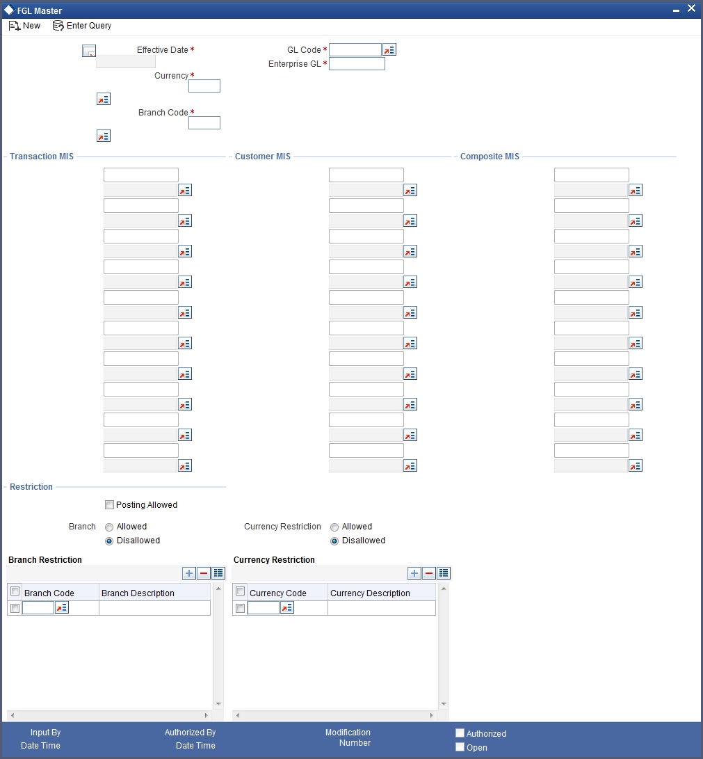

7.2.2 Defining Enterprise GL Master
You can define External GLs for a combination of Oracle FLEXCUBE attributes in the ‘EGL Master’ screen. This maintenance is effective date based and any modification made to the existing data will be effective from the date of modification. This screen is also a Head Office function.
You can invoke the ‘Enterprise GL Master Maintenance’ screen by typing ‘EGDEGMST’ in the field at the top right corner of the Application tool bar and clicking the adjoining arrow button.
Effective Date
The application date of the Head Office is defaulted here on creation of any new record or modification to the existing data.
GL Code
Specify the Oracle FLEXCUBE GL Code which should be mapped to the External GL. The adjoining option list displays all the GL codes maintained in Oracle FLEXCUBE. You can choose the appropriate one.
Enterprise GL
Enter a GL code to which you wish to map a Oracle FLEXCUBE GL. You can specify a GL maintained in the Enterprise GL system or a GL code to represent suspense GL (for posting violated accounting entries).
Refer the section titled ‘External Suspense GL’ under ‘Maintaining Enterprise GL’ Parameters for further details on violated accounting entries.
Currency
Choose the currency that should be mapped along with the chosen Oracle FLEXCUBE GL to the External GL. The adjoining option list displays all the currency codes maintained in Oracle FLEXCUBE. You can choose the appropriate one. You can also choose or the wildcard ‘***’.

7.2.3.1 Specifying Restrictions
Posting Allowed
By default this option will be selected. Uncheck this option if you want to impose a restriction.
Branch Allowed/Disallowed
From the set of available branches, you can maintain a list of Branches which are either allowed or disallowed for the external GL.
Select the required branch from the option list. You can add additional branches by clicking add icon.
Accounting entries can be posted to this GL only from the branches selected here.
Currencies Allowed/Disallowed
From the set of available currencies, you can maintain a list of currencies which are either allowed or disallowed for the external GL.
Select the required currency from the option list. You can add additional currencies by clicking add icon.
Accounting entries can be posted to this GL only in the currencies selected here.
