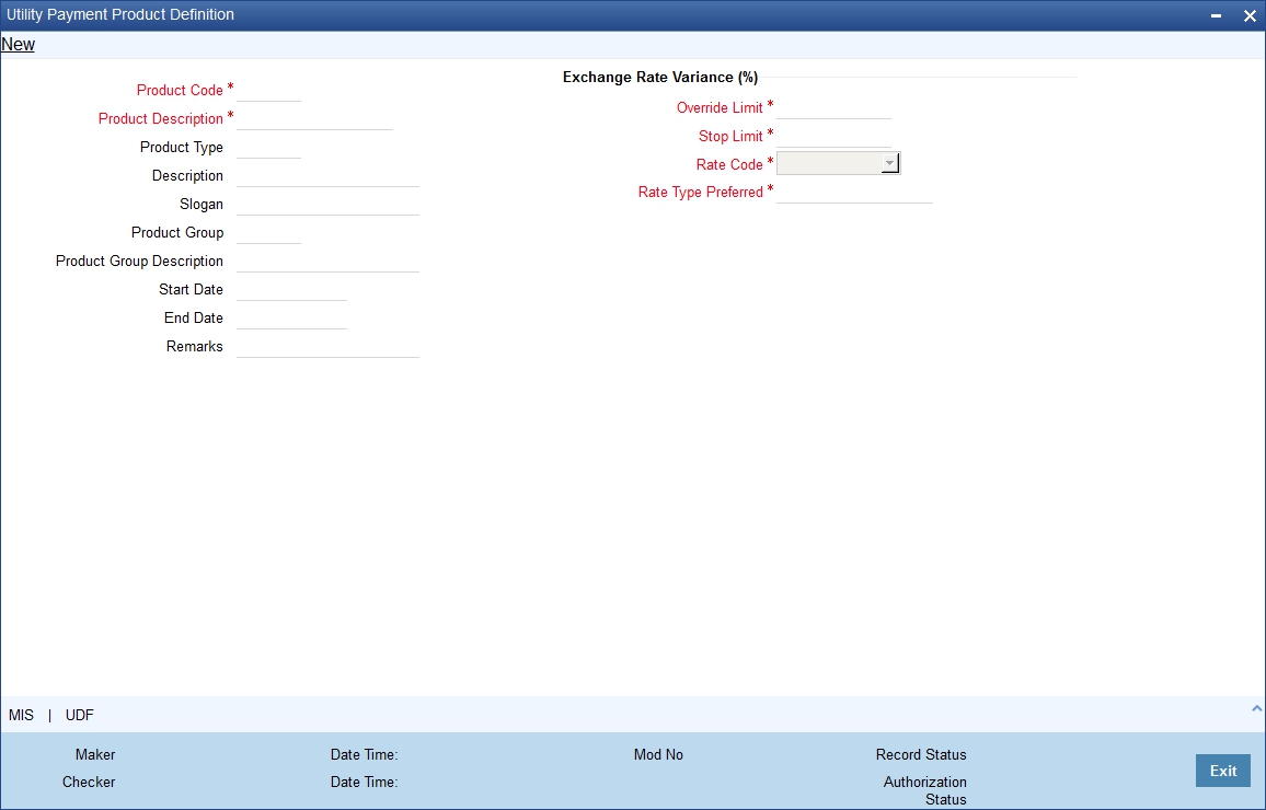

To create a product for utility payments of customers, you must specify basic details such as the Product Code, Group, Description, and so on in the ‘UP Product Definition’ screen. You can invoke this screen by typing ‘UPDPRDMN’ in the field at the top right corner of the Application tool bar and clicking on the adjoining arrow button.
In this screen, you can only set up a basic profile for the product. You cannot associate any account details or charge details for a specific utility provider. To maintain these details for a specific utility provider for a specific product, you must use the Accounting Rates and Charges Maintenance (ARC) screen.
Refer to the chapter Accounts Details and Charges in this user manual, for information about the ‘ARC Maintenance’ screen.
3.4.2 Features of Utility Payment Product Definition Main Screen
You must specify the following details for a utility product in the UP Product Definition main screen:
l An identifier or code for the product, which is unique to it
l A concise description of the product
l A slogan for the product
l The group under which the product is classified
l The life-span of the product
l Any narrative regarding the product (remarks)
l The limits with regard to exchange rate variance that would apply to any transactions involving the product
Product Code
The product code is a unique identifier for the product in the system, across all modules. You can specify a code consisting of four characters. You cannot use the code that you specify here for any other product in the system, in any module. If, for instance, you have specified PWBL as the product code for a utility product in this screen, you cannot specify the same code for any other product in any other module in the system.
For any utility product, you must specify a code. Specify an indicative code.
Product Type
The product type indicates the category under which the product can be placed, and the type of transaction that will be processed against the product. A utility payments product can only be used to process utility payments made by customers in favor of a particular utility provider.
Product Description
Give a brief description of the product. This description can be used to easily locate and retrieve information regarding the product.
For any utility product, you must specify a description. Specify an indicative description.
Slogan
Specify a catchphrase for the product. You could specify a marketing motto, or any other saying that encapsulates the product in a few short words.
For any utility product, you must specify a slogan.
Product Group
Products are classified into different groups, based on similar characteristics. The classification makes it simple to retrieve information about a class of products.
A list of product groups maintained in the Product Group Definition is displayed in the list box, from which you can select the appropriate group.
Start and End Date
To recall, a product is a scheme or service that your bank offers customers. Typically, a scheme or service is available to customers within a fixed period. This period is the life span of the product.
You specify the product life span by providing a Start Date and an End Date. The period between the two dates is when the product is available for use. If you do not specify an end date, the product can be used indefinitely, or until it is closed.
Remarks
You can specify information about a product that will be used for reference, within your bank. It will not be printed on any correspondence with customers, but will be displayed when the details of any payment transaction involving the product are displayed or printed.
3.4.3 Defining Other Attributes of Utility Payment Products
After specifying all these basic details of a product, you can indicate certain specific attributes for the product. Each of these attributes can be defined in the corresponding screen that you can invoke from the ‘UP Product Definition’ main screen, by clicking the appropriate icons. Attributes with common characteristics are grouped together in common screens, simplifying the process of defining them.
Click ‘Fields’ button to specify any user-defined fields that would be required during entry of transactions involving the product.
Click ‘MIS’ to specify any MIS details that would be applicable for any utility payment transactions involving the product.
3.4.4 Saving Utility Payments Product
After you have specified all the mandatory information required for the product in the product definition screens, you could save the product. You will not be allowed to save the product until you have specified all the mandatory information.
