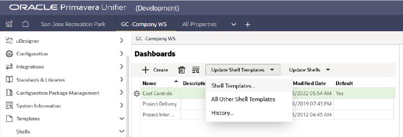

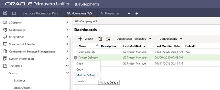

Administrators can now set a default dashboard within shell templates. A shell template can have only one default dashboard.
This image displays the default column of the Dashboards log.
There will be a new column titled "Default" set to "Yes" for the dashboard that was the default prior to this upgrade.
A default dashboard can be pushed to some or all shells using Update Shell Templates.
