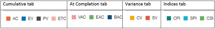

The middle section of the EVA sheet contains the following tabs:
- Cumulative
- Incremental (only applicable to period based graph.)
- At Completion
- Variance
- Indices
Depending on the tab that you select, you get the pertinent graph.
Curve Picker: Filter curves you want to view by selecting or deselecting the colored boxes in the legend.
