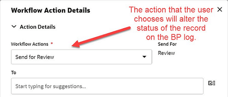

A record status indicates the position a form is in at any point in a business process, such as "approved," "pending," or "closed." Each business process includes at least one, and sometimes many, steps during its workflow. At each step, the Unifier user must apply a record status to the form. The status is the action that links two steps in a workflow. The action the link takes appears as a choice the user makes on the form. This choice moves the task to the next step.
When designing a business process, you will be specifying what statuses the user can choose from at the completion of each step in a workflow. Inactive record statuses are not displayed to users.
The action that the user chooses will alter the status of the record on the BP log.
