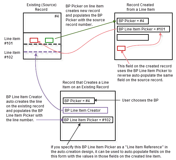

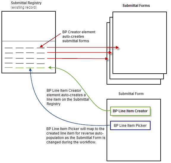

Line Item Auto-Creation
Line item auto-creation is useful for adding new line items to an existing record. For example, a submittal registry record could contain line items that auto-create separate submittal business process forms for each contractor on a project. In the course of work, someone might realize that the original submittal registry record is missing a submittal for an architectural drawing. That person could submit a new submittal record that would add the missing architectural drawing submittal to the original registry record.

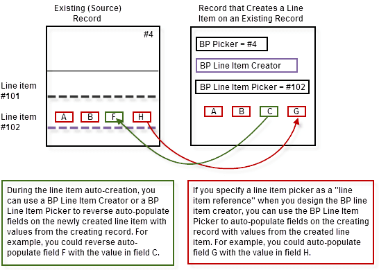

uDesigner provides a BP line item creator element to auto-create line items. You can place this creator element on either an upper or detail form. This element will auto-create a new line item on another, existing, record and populate the fields of that line item with the values of the fields on the form (upper or detail) that auto-created the line item.
You can set up reverse auto-population so that the line item added to the existing record can be updated with information as the record that created the line item moves through subsequent steps in a workflow.
How Creator Elements and Pickers Function in Line Item Auto-Creation
Pickers and creator elements work together to auto-create line items.
Auto-Population and Reverse Auto-Population in Line Item Auto-Creation
To populate and reverse auto-populate fields on business processes and line items with line item creation, you can use the following data elements in collaboration:
- BP Line Item Picker
- BP Line Item Creator
Note: You cannot use a BP Line Item Picker in an Activity Attribute Form.
