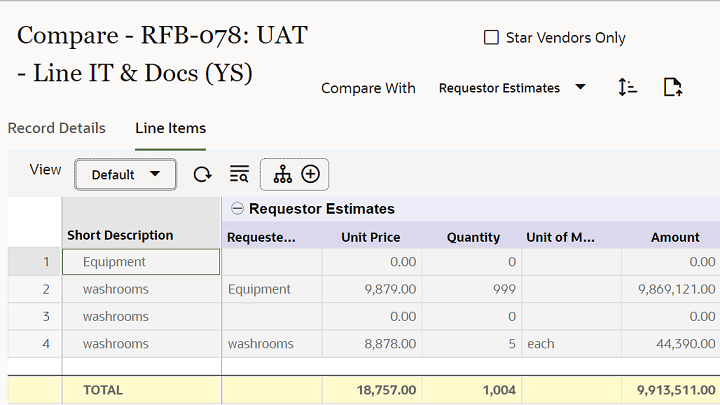

For the Request for Bid (RFB) business process, Unifier includes an bid tabulation feature. This feature provides a default comparison sheet with which users can compare the bids they receive from vendors.
The default bid comparison sheet (shown above) shows only the bid dollar amounts for each line item for which the vendor submitted a bid.
Alternatively, you can design a custom bid tabulation sheet in uDesigner that can include more information in a layout specific to your company's needs. Using a custom bid comparison sheet, you can compare vendors on criteria besides price, such as certifications and re-negotiated line item prices. You could also add comments to the submitted bid that can be displayed on the bid tabulation. This sheet becomes part of the RFB process; users can view this sheet from the RFB when the bidding has ended.
