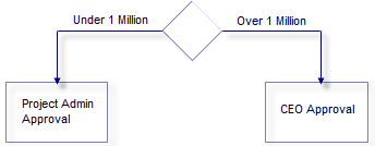

This graphic displays how a condition can trigger two different steps if the amount is more or less than a set amount.

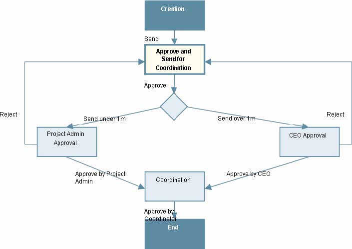

  1. In the Workflow Designer window, click the Condition button.
  2. Click the canvas. The conditional step appears as a diamond shape.
    You can include multiple conditional routings in a workflow, but only one condition per step.
    This image depicts an example conditional workflow.

    2. In the Conditional Name field, enter a name for the action of the conditional link; for example, "Under 1 Million" to route an invoice approval to one authorizer, or "Over 1 Million" to route it to another authorizer.
