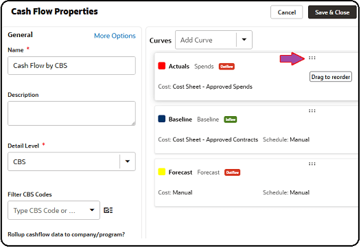

To change the order of the Cash Flow curves, on the cash flow worksheet graph:
- Go to the Cash Flow log and select the cash flow.
- Open the gear menu ( ) for the selected cash flow and select Properties to open the Cash Flow Properties window.
- On the right pane, hover over the Drag to order icon (
) for the curve that you want to move, right-click the icon and hold. - Move the curve to where you want it to be displayed on the cash flow worksheet graph and release the hold.
Note: Changing the curves order in the Cash Flow Properties window will also change the curve order in the All Curves tab of the cash flow worksheet.
