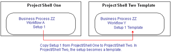

In this copy action, you copy a workflow setup from a business process in a project or shell and make it a template in the BP you copy the setup into.

A copy window opens, listing all the workflow setups for that BP that exist in all the projects and shells in your environment.
- Select the setup you want to copy and click Copy. The Workflow Setup window opens.
- On the General tab, enter a name and description for the new setup and make the status Active or Inactive as necessary.
- Click Apply.
- Click the Settings tab. The Settings tab opens, showing the workflow of the setup you copied.
On this tab, you can make any changes you want to the setup you copied to accommodate the new setup.
- To save the new setup, click OK.
The system makes a template of the setup you copied and adds the template to the workflow setup log. If the setup Active is active, the system performs an error check on the new schema and notifies you of any errors it encounters; otherwise, the error check will not occur until the setup is activated.
