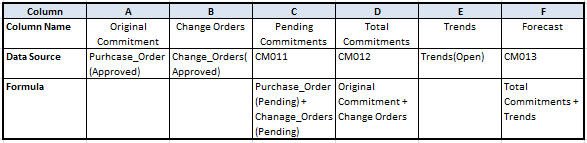

If a source column is a single data source, the destination column will be created with that single data source if it does not exist. (Column A or B in example below)
If a source column is a formula with only single data sources, pushing the source column will create that column in the destination cost sheet, if it does not exist. (Column C in example below)
If a source column is a formula with columns included in the formula, as long as all constituent columns contain single data sources, the source column can be pushed; for any columns that do not exist in the destination cost sheet, the formula will be changed to a single data source in the formula. (Column D in example below)
If a source column is a formula with constituent columns that include logical data sources, the logical data source must exist in the destination cost sheet. The formula for the logical data source may be different in the destination cost sheet. Any column that contains a single data source will follow the rule above. (Column F in example below)
This table is used to illustrate how columns are pushed to cost sheets.
