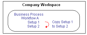

At the Company Level, Copy a Setup from Another Setup in the Same BP
In this copy action, you copy a setup to another setup in the same business process in the same company workspace.
To copy a workflow setup
