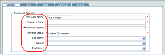

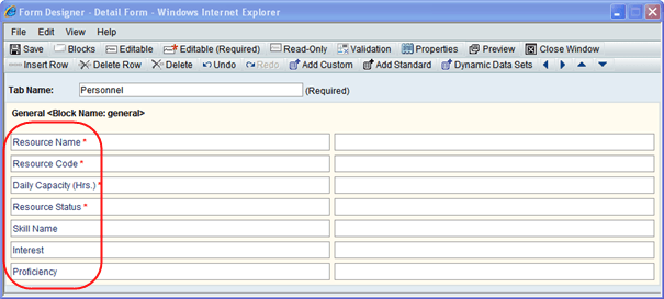

For example, this Resource Attribute form, designed in uDesigner ...
... appears as the General tab of the Create Resource form that an administrator uses to add a resource to the company's pool of resources ...
... which in turn, populates the resource picker with the names the user can choose from.
