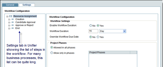

As you design a workflow, you are likely to add steps to the canvas in a random order and rearrange them as you work on the design. This is usually how workflows are designed; however, it has an inconvenient affect on the process of setting up the workflow in Unifier. When you configure the workflow, the steps appear on the Settings tab in the order you added them to the canvas. This is not likely the order they were in by the time the workflow design was finished, nor the chronological order an administrator needs to see them in when configuring the workflow.
The settings tab in Unifier shows the list of steps in the workflow. For many business processes, this list can be quite long.

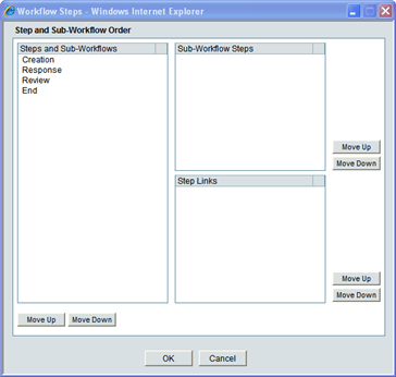

To arrange the step and link order
  1. In the Workflow Designer window, click the Step Order button. The Step and Sub-Workflow Order window opens.
    The window divides the workflow into steps, sub-workflow steps, and link actions.
    This image displays the workflow steps and link actions.
  2. To arrange the steps in their logical workflow order, highlight each step and use the Move Up or Move Down buttons.
  3. Use the Step Links section to arrange the actions into a more usable order for the list that appears when the user clicks the Workflow Actions drop-down list on the form.
  4. Click OK.
