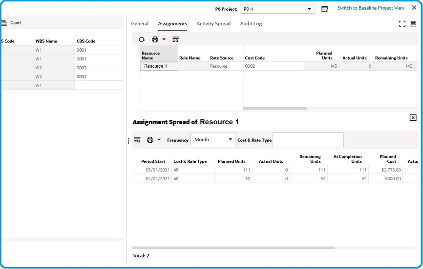

Click a resource row, click gear menu icon for that row, and select View Assignment Spread. This option (for any selected resource) displays the spread data for that resource, in a split screen "Assignment Spread of ..." at the bottom, as shown.
You can view the daily spread data of the resource. The Frequency drop-down field and the Cost & Rate Type field will show additional options to select.
- In the Frequency list, change the granularity level of the spread to Week, Month, or Year.
- In the Cost & Rate Type list, select Cost or Units. Column headings change accordingly.
The "Assignment Spread of ..." pane also displays spread details, such as Period Start, Panned Units, and so forth in columns.
All of the resources associated with the activity are displayed. Both the CBS Code and the Rate Source columns are editable. By default, the picker icon is not displayed until you click the cell of the columns.
