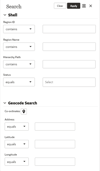

  3. From the toolbar in the left pane, click Search ( ) to open the Search window. The Search window has the following options:
    • Clear
    • Apply
    • Dock Right / Dock Bottom
    • Close
  4. Scroll down and enter values in the fields under the Geocode Search section.
    • Clear
    • Apply
    • Close
  4. Enter values in the fields under the Shell section.

This image displays the find window.
