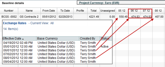

Future exchange rates let you plan ahead for currency fluctuations. The system uses the active exchange rate based on the effective date; however, cash flow curves show currency rate changes at the beginning of the first full month the rate is in effect.
In the Baseline details example that follows, you can see differences in values due to future exchange rate conversions.
- The transaction currency is INR.
- The project currency is EUR.
- The distribution is linear.
- The distributed values are 37,000 INR per time period.
- May and June rates take effect on the first of the month, respectively.
- A July future exchange rate takes effect in Unifier on 07/02/2012, so the system continues to display the value of the June rate in the cash flow.
- The August rate shows up in the cash flow curve on 08/01/2012.
