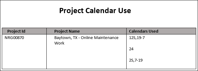

Project Calendar Use
Description
Lists the calendars used by the selected projects grouped by project.
Location
  1. Click Reports.
  2. On the Report page:
    1. Click the Reports tab.
    2. Expand the P6Reports folder.
    3. Expand the Administrative folder.
    4. Click Project Calendar Use.
