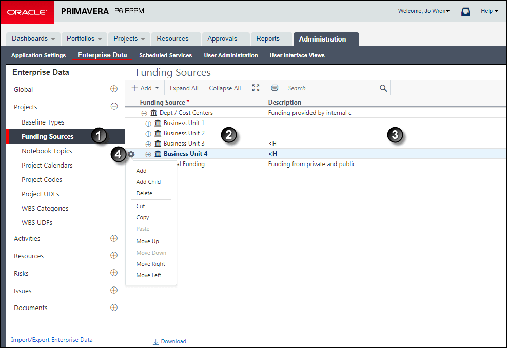

This illustration is a graphical representation of the text in the following table.
Table of Enterprise Data Funding Sources
Item
Description
item one
Funding Sources: You will use the Funding Sources page to view, add, and edit funding sources.
item  two
Funding Source field: You can customize the name of the funding source by double-clicking in the Funding Source field.
item  three
Description field: The Description field allows you to write a description of the funding source which includes any additional information about the funding source.
item  four
Row Actions Menu: You can configure funding sources, including creating new sources, and moving sources to new positions in the hierarchy from the Row Actions menu. If funding sources are affiliated with a particular group, you can group funding sources with that group. You can use the Move Up and Move Down items to move a funding source below or above other funding sources. The Move Right and Move Left items can make the funding source a child or parent to other funding sources.

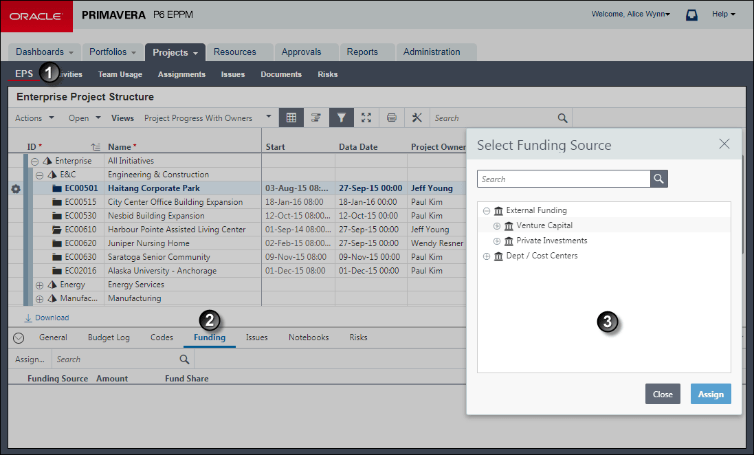

Table of Funding Source Assignments
Item
Description
item one
EPS Page: Use the EPS page to assign funding sources and edit funding source information for a project or entire EPS element.
item  two
Funding detail window: Click the Funding detail window to add funding sources. You can then edit the Amount and Fund Share fields, or you can remove the funding source from the project. Clicking remove will just remove the funding source from the project; it will still be available to assign to other projects. The total of all the funding source rows appears in the Activity Table in the Total Funding column.
item  three
Select Funding Source dialog box: You can assign the same funding source multiple times with varying amounts and fund share percentages for different levels of the EPS.
