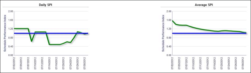

Daily vs. Average SPI by Resource Section
Daily vs. Average SPI by Resource section Daily SPI and Average SPI line graphs.
Purpose
The Daily SPI and Average SPI line charts show the Schedule Performance Index (SPI) using a green line. The blue line shows the target (set at 1.0). The Average SPI is based on the cumulative average over time from the beginning of the chart. Once the chart exceeds 30 days, the average is of the 30 days prior to the data point.
The x-axis for both charts shows dates. The y-axis for both charts shows the SPI.
