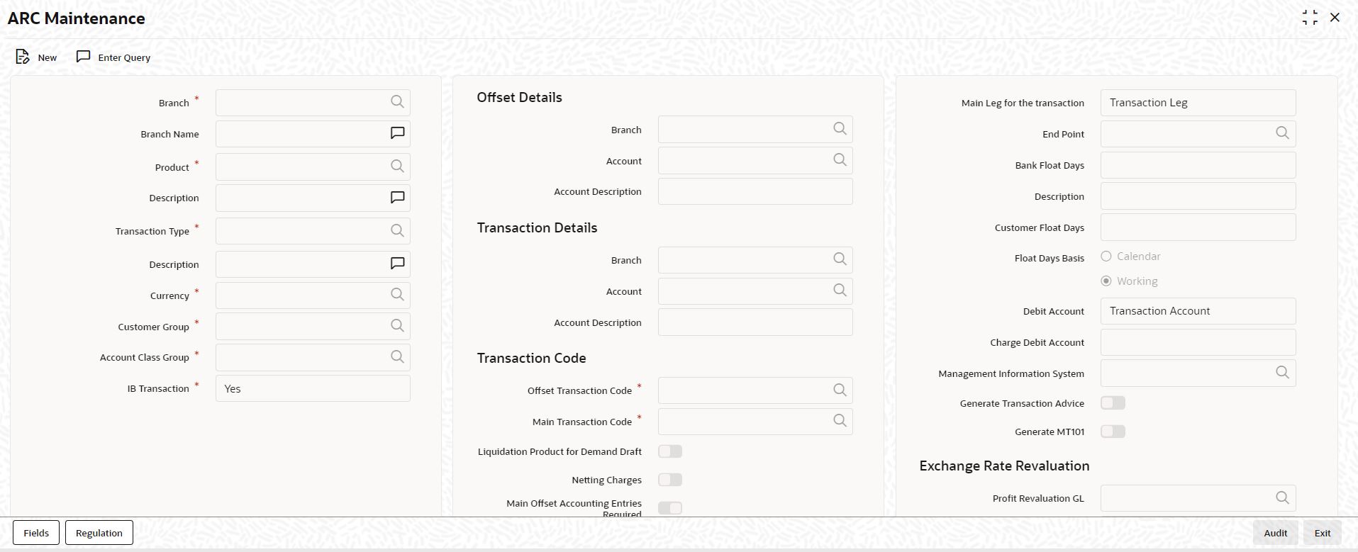

3.2.1 Invoke ARC Maintenance screen
In the ARC Maintenance screen, you maintain accounting and charges information that would be applicable for processing retail teller transactions involving a specific branch, retail teller product and specific currency combination.
You can invoke the ‘ARC Maintenance’ screen from the application browser. You can invoke this screen by typing ‘IFDATMMN’ in the field at the top right corner of the Application tool bar and clicking on the adjoining arrow button.
In the ARC Maintenance screen, you maintain accounting and charges information (known as ARC details) that would be applicable when processing retail teller transactions involving a specific branch, retail teller product and specific currency combination.

3.2.2 Identifying Offset Account
You can specify the offset account or GL into which offset entries are to be booked, as a result of the teller transaction involving the product, branch and currency.
You can also indicate the branch in which the offset account resides. You can also choose the “ALL” option, which the system interprets as the branch in which the transaction is being input.
Indicating the offset account as the debit account
You could indicate that the offset account is to be the debit account for the transaction, in teller transactions involving the product, branch and currency combination. To indicate this, select the ‘Offset Account’ option in the Debit Account field on this screen.
Indicating the offset account as the default charge account
You could indicate that the offset account is to be the default charge account for the transaction, in teller transactions involving the product, branch and currency combination. This means that the charges would be recovered from this account. To indicate this, select the ‘Offset Account’ option in the Charge From Account field on this screen.
Note
If the offset account you have specified uses an account class that is restricted for debit or credit transactions for the product, an override is sought when you attempt to save the con­tract.
3.2.3 Identifying Transaction Account
You must specify the transaction account for the retail teller transaction, as well as the branch in which this account resides. The branch information you specify here could also be used in the case of an inter-branch transaction.
If you wish to maintain ARC details for a specific customer, you can specify a valid customer account here. In such a case, the ARC record will be applicable to all retail teller transactions involving the customer, product, branch and currency combination that you have specified in this record, in this screen.
Indicating the transaction account as the debit account
You could indicate that the transaction account is to be the debit account for the transaction, in teller transactions involving the product, branch and currency combination. To indicate this, select the ‘Transaction Account’ option in the Debit Account field on this screen.
Indicating the transaction account as the default charge account
You could indicate that the transaction account is to be the default charge account for the transaction, in teller transactions involving the product, branch and currency combination. This means that the charges would be recovered from this account. To indicate this, select the ‘Transaction Account’ option in the Charge From Account field on this screen. Typically for a “Cash Deposit” type of a transaction, in which the customer account will be specified when the transaction is entered, the same account would also be used to debit the charges.
Note
If the transaction account you have specified uses an account class that is restricted for debit or credit transactions for the product, an override is sought when you attempt to save the contract.
3.2.4 Identifying Offset and Debit Transaction Codes
In addition, you have to also identify the transaction codes against which offset and debit related entries for the transaction ought to be tracked.
For instrument-based products (such as check deposit / check withdrawal products) you must ensure that you specify a transaction code for which check numbers are mandatory.
Charge Debit Account
You can choose the charge debit account from the adjoining drop-down list. The available options are:
l Offset Account
l Transaction Account
Main Offset Accounting Entries Required
Check this box to pass the Main accounting entries along with charges defined at ARC for a Product, else only the charges accounting entries defined for the product alone will get passed which is used for Online charge collection.
Note
When RT products are used for On-line charge definition (STDCHGMN) this checkbox has to be unchecked.
Generate Transaction Advices
You can indicate that advices must be generated for retail teller transactions involving the product, branch and currency combination.
Generate MT101
Check this box to generate MT101.
3.2.5 Indicating Service Charges for Inter-branch Transactions
In a transaction, if the account branch of the teller transaction is different from the transaction branch, then charges maintained by inter-branch product will be applied to the transaction.
If you select the IB transaction as 'Yes' for a RT product at ARC, the system picks up and process the charge entries as maintained.
If you select the IB transaction as 'NO' for a RT product at ARC, then the charges maintained in Non-IB product are applied to the transaction.
IB Transaction
Check this box if you want the system to pick up the product, for inter-branch transactions.You will notice the difference in the service charges processed for two transactions with same kind of product.
Note
This is supported for Cash Deposit (1401), Cash Withdrawal (1001) and Account to Ac­count Transfer (1006)
Netting Charge
You have the option to net the accounting entries for the debit leg of the charges along with the main transaction entries.
Check this box to indicate that the debit leg of the charges is to be netted before passing the accounting entries. Leave the box unchecked to pass the entries without netting the charges of the debit leg.
End Point
In case of Outward Clearing, Clearing House is derived based on the End Point maintained for the ARC combination.
Description
End Point Description (Display Only field).
Bank Float Days
In case Bank Float Days is not maintained at the Clearing Bank/Branch level, it is picked up from here.
Customer Float Days
In case Customer Float Days is not maintained at the Clearing Bank/Branch level, it is picked up from here.
Float Days Basis
Whether to consider the Calendar Days or Working Days for computing the Value Date based on the Floats maintained.
3.2.6 Indicating Exchange Rate Revaluation
You can specify the following details:
Profit Revaluation GL
Specify the profit revaluation GL details.
Loss Revaluation GL
Specify the loss revaluation GL details.
Exchange rate values are maintained at CCDRATES. Rate type and Rate code preferred is maintained at product level and Negotiated cost rate is maintained at transaction level.
The Revaluation amount = (Transaction amount/exchange rate) - (Transaction amount/negotiated rate),
Where,
Exchange rate is picked for the rate type and rate code maintained at Product level.
The system will display an override message if the negotiated rate is not within the exchange rate variance maintained at the product.

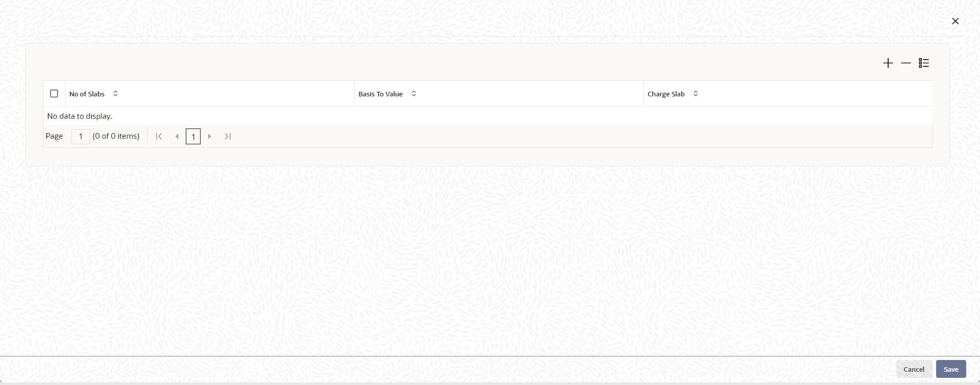

Select whether the Charge computation has to be over different Amount Slabs or Tiers (0-100 @ 10, 101-500 @ 15 etc.).

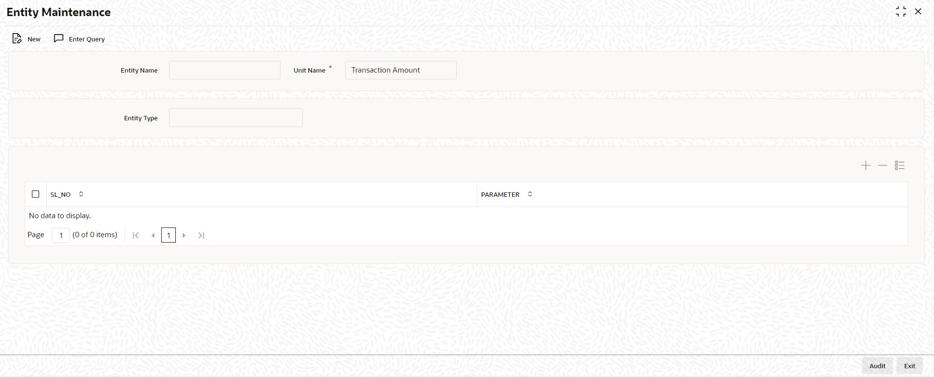

Entity Name
The field is enabled if ‘System Entity’ is selected in the ‘Basis’ field. Select the Entity Name, from the adjoining option list. The list of values are populated from the ‘Entity Maintenance’ screen (STDENMNT). Further details on the ‘Entity Maintenance’ screen is provided in subsequent sections of this chapter.

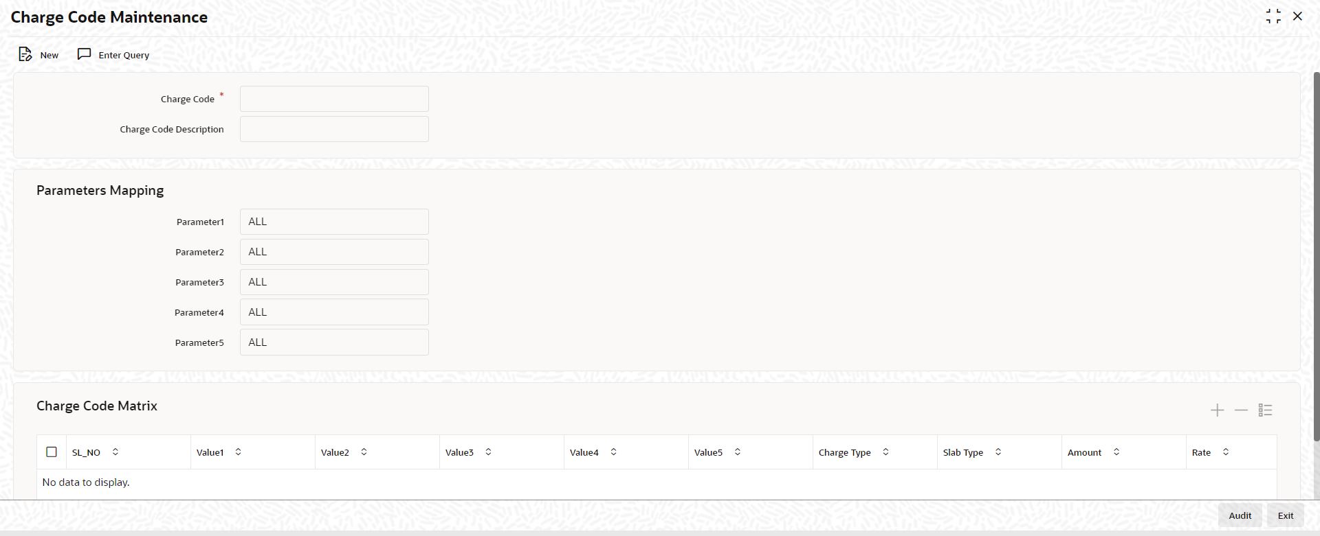

Based on Charge Code
Check this box to indicate whether the charge is based on the charges maintained in the ‘Charge Code Maintenance’ screen. If this field is checked, then the system checks the parameters applicable to the selected charge code from the ‘Charge Code Maintenance’ screen (which is detailed in the subsequent section) and passes the relevant parameter value(s). The system also passes the “Basis” amount to the charge code as the basis is captured at ARC charge level.
If the system is unable to pass a parameter value to a charge code because of unavailability of data, the same parameter is treated as *.*.
Charge Code
This field is enabled if ‘Based on Charge Code’ field is checked. Select the charge code from the adjoining option list. All charge codes as maintained in the charge code maintenance screen is listed in this field.

If two or more accounting entries, for the same event, are to be passed to the same account, on the same Transaction Date, these entries can be netted. You can choose to net the charge leg of the Transaction Account (debit) entry with the main leg of the customer accounting entry.
Transaction Code
You can indicate the code using which the accounting entries would be booked, for each charge.
Rate Code and Rate Type
While settling charges for cross currency transactions, you can choose to debit the customer by applying the mid rate, buy rate or by using the buy/sell spread over the mid-rate. Therefore you need to specify the Exchange Rate details for each ARC definition record that you maintain in the system.
Firstly, indicate the Rate Code for which different rates can be maintained. A list of all the rate codes maintained in the Floating Rates Maintenance screen is displayed in the list. You can choose the appropriate code.
In addition to specifying the Rate Code you have to indicate the Rate Type which should be picked up for exchange rate conversions involving settlement of charges for cross currency transactions.

3.2.8 Charge Code Maintenance
In the ‘Charge Code Maintenance’ screen, charges based on some additional parameters which are not a part of ‘ARC maintenance’ can be maintained. The charge matrix in this screen can be attached to the ARC maintenance screen for arriving at charges based on additional parameters.
You can invoke this screen by typing ‘STDCHGCD’ in the field at the top right corner of the Application tool bar and clicking the adjoining arrow button.
Specify the following details in this screen:
Charge Code
Specify a unique identifier to identify a charge code.
Charge Code Description
The description of the charge code is defaulted here.
Parameters Mapping
In this section, parameters based on which charges are differentiated are mapped to fixed parameter IDs. There are 5 parameter IDs provided in this section. At least one parameter should be mandatorily defined. Select the appropriate value from the adjoining option list. This list contains the following values:
l TRANSACTION_BRANCH_GROUP- This is the ARC branch group code to which the transaction branch belongs to. If the transaction branch is not grouped under any ARC branch group *.* is returned for the same.
l ACCOUNT_BRANCH_GROUP - This is the ARC branch group code to which the account branch belongs to. If the account branch is not grouped under any ARC branch group *.* is returned for the same.
l PAYABLE_BANK_CODE - This is the beneficiary Bank Code which is used while sending an outgoing interbank BC/DD/TT.
l PAYABLE_BRANCH_CODE- This is the beneficiary Bank’s branch Code which is used while sending an outgoing interbank BC/DD/TT.
The list of factory shipped parameters which is made available in this screen are as follows:
Parameter Specific To
Differentiating Parameter
Description
Applicable to transaction
Customer
CUSTOMER_CATE­GORY
Customer category speci­fied at customer CIF level
ALL
GROUP_CODE
Group code specified at customer CIF >Additional tab level
ALL
CLEARING_GROUP
Clearing group specified at customer CIF >Additional tab level
ALL
TAX_GROUP
Tax group specified at cus­tomer CIF >Additional tab level
ALL
CUSTOMER_CLASSIFI­CATION
Customer Classification specified at customer CIF >Additional tab level
ALL
NATIONALITY
Nationality specified at customer CIF level> per­sonal/corporate tab
ALL
Transaction
TRANSAC­TION_BRANCH
Branch code at which transaction is being done
ALL
TRANSAC­TION_BRANCH_GROUP
Branch group to which transaction branch belongs to
ALL
ACCOUNT_BRANCH
Branch code of the trans­action account
ALL
Branch group to which account branch belongs to
ALL
PAYABLE_BANK_CODE
Payable bank code for BC/DD/TT
BC/DD/TT
PAYA­BLE_BRANCH_CODE
Payable Branch for BC/DD/TT
BC/DD/TT
TO_AC­COUNT_BRANCH
Branch code of the Credit account
LOCH and Account to Account trans­fer
TO_AC­COUNT_BRANCH_GROUP
Branch group to which credit account branch belongs to
Charge Matrix
Values 1 to 5
Values 1 to 5 correspond to the respective parameter value in the Parameter Mapping section. For example: Value 1 corresponds to the Parameter Value 1 and so on and so forth. Select the specific values from the adjoining option list.
Charge Type
Select the charge type from the drop down list. The charge type can be flat or percentage.
Amount
Specify the charge amount in this field.
Rate
Specify the rate in this field.
Minimum Charge
Specify the minimum charge in this field.
Maximum Charge
Specify the maximum charge in this field.
Slab Type
Select the Slab Type as Slab or Tier from the drop down list. If Slab Type is Slab or Tier, then provide the slab or tier details in the slab or tier sub-screen by clicking S button.
In this screen, you need to specify the number of slabs, the basis to value, and charge slab details.

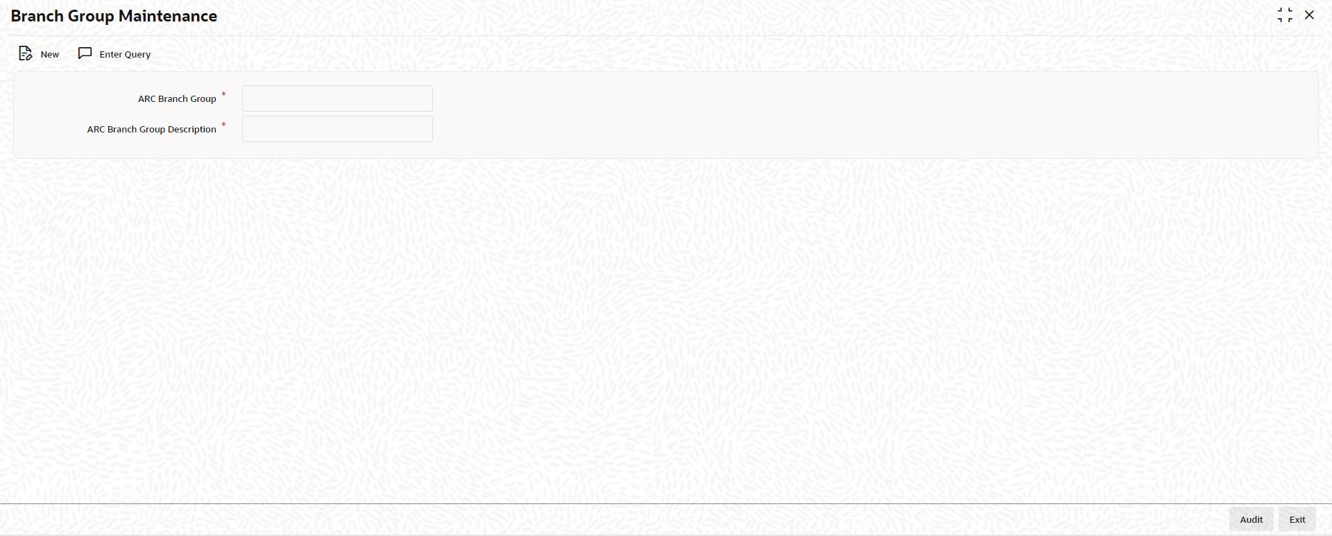

3.2.9 ARC Branch Group Maintenance
To define branch groups which are equivalent to cities or regions that the bank operates in, invoke the ‘ARC Branch Group Maintenance’ screen by typing ‘STDBRGMT’ in the field at the top right corner of the application tool bar and clicking the adjoining arrow button.
ARC Branch Group
Specify a group code to identify a group of branches.
ARC Branch Group Description
Specify a description for the branch group.
After specifying details in the ‘ARC Branch Group Maintenance’ screen, all the ARC branch groups are displayed in the Branch Parameter Maintenance’ screen (STDBRANC). Select the branch group from the ‘ARC Branch Group field.
For more information on the Branch Parameters Maintenance screen, refer section 5 ‘Branch Parameters’ in the Core Service module.
3.2.10 Entity Maintenance
In the ARC Maintenance screen, fees or charges as a percentage of the transaction amount can be calculated for transactions exceeding the restriction amount. To calculate this fee or charge, you need to select ‘System Entity’ in the ‘Basis Field’ in the ARC Maintenance screen. Thereafter, the ‘Entity Name’ field is enabled which displays values obtained from the ‘Entity Maintenance’ screen. You can invoke this screen by typing ‘STDENMNT’ in the field at the top right corner of the application tool bar and clicking the adjoining arrow button.
Specify the following in this screen:
Entity Name
Specify the entity name to be considered for fee maintenance.
Unit Name
Select a value for charge consideration from the drop down list. The value provided in the drop down list are as follows:
l Exceeded Amount
l Transaction Amount
During ARC Maintenance, the following scenarios are considered if exceeded amount is selected:
l If the transaction is not exceeding the restriction utilization, then the value provided is 0.
l If the transaction is exceeding the restriction utilization partially, then the portion of the transaction amount which exceeds the restriction amount, is provided.
During ARC Maintenance, the following scenarios are considered if transaction amount is selected
l If the transaction is exceeding the restriction utilization partially, then the transaction amount is provided.
l If the transaction is exceeding the restriction utilization fully, then the transaction amount is provided.
Entity Type
Select the Entity Type from the drop down list. The values provided in the drop down list are as follows:
l Null
l Restriction Code
Parameter
Select the Parameter if ‘Restriction Code’ is selected in the Entity Type field, from the adjoining option list. All active restriction codes as maintained in the system are displayed in this field. For more information on restriction code maintenance, refer to the section ‘Restriction Amount Maintenance’ in the Core Services Module.

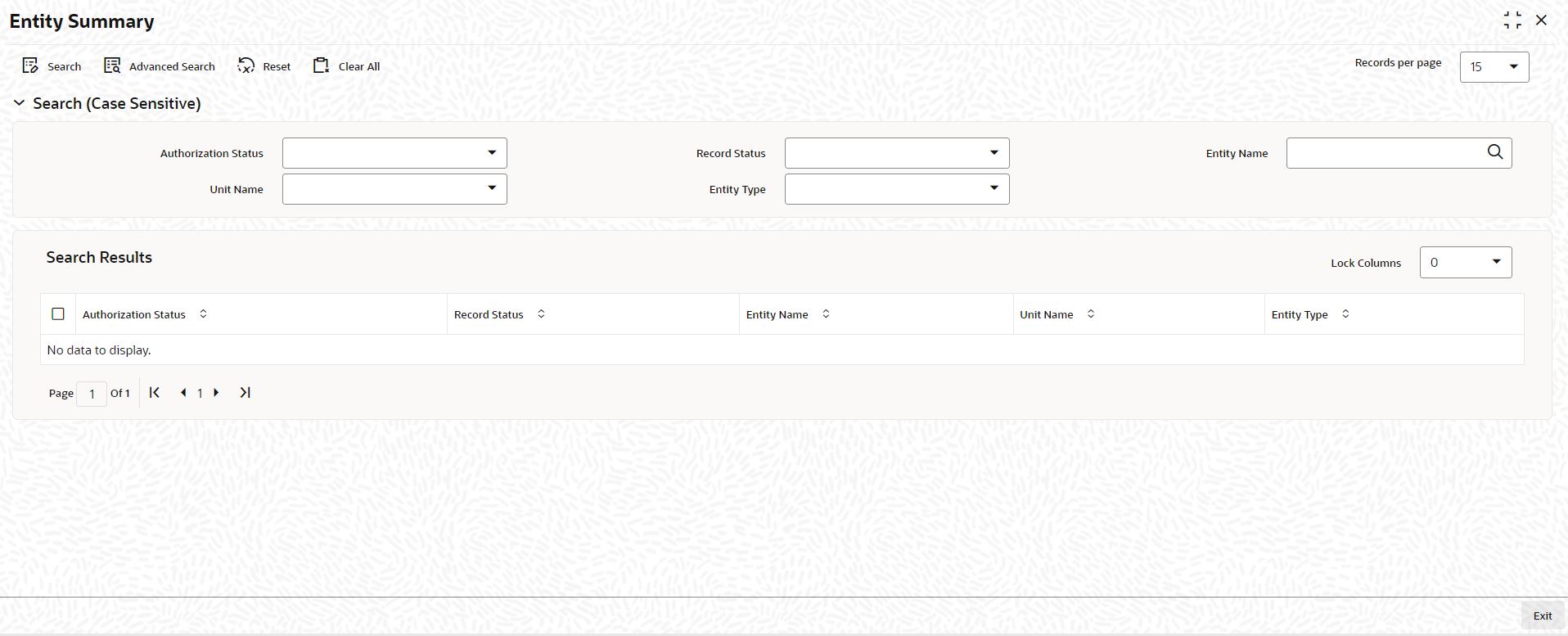

3.2.10.1 Viewing Entity Types
You can view the entity types in the ‘Entity Summary’ screen. You can invoke this screen by typing ‘STSENMNT’ in the field at the top right corner of the application tool bar and clicking the adjoining arrow button.
You can search for entities by specifying values in the following fields:
l Authorization Status
l Record Status
l Entity Name
l Unit Name
l Entity Type
On updating these details and clicking the ‘Search’ button, the following columns are populated:
l Record Status
l Entity Name
l Unit Name
l Entity Type

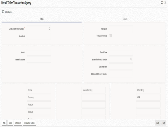

3.3.1 Viewing Teller Transactions
You can view retail teller transactions in the ‘Retail Teller Transaction Query’ screen. Invoke this screen from the application browser.
You can invoke this screen by typing ‘DEDQUERY’ in the field at the top right corner of the Application tool bar and clicking on the adjoining arrow button.
In this screen, you can view the following details for each teller transaction:
l Product
l Related Customer
l Branch Code
l External Reference Number
l Exchange Rate
l Contract Reference Number
l Route Code
l Transaction Tanked
l Additional Reference Number
3.3.2 Viewing Transaction Leg Details
Here you can view the following details:
l Transaction Currency
l Transaction Branch
l Transaction Code
3.3.3 Specifying Offset Leg Details
l Offset Currency
l Offset Branch
l Offset Account
l Offset Amount
l Transaction Code
3.3.4 Viewing Instrument Codes
You can view the following details here.
l Value Date
l Local Currency Amount
l Narrative
l Track Receivable
l Cheque Number
l Cheque Date
l Credit GL
l Repair Reason
l Liquidation Date
