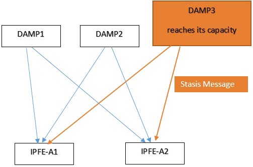

- Cause:
The application server has reached is maximum resource capacity.
When one or more of the DAMPs in the cluster reaches its capacity. The DAMP servers that reach their capacity send Stasis messages to the IPFE servers.
When the IPFE servers received this stasis message, the IPFE will:
- Raise this 5005 alarm.
- Keep processing the existing connection to this stasis DAMP server.
- Route any NEW connection (TCP SYN, SCTP INIT) to other un-stasis servers in the cluster.
The IPFE clears this alarm when the IPFE server receives no more stasis message from the DAMP servers.
It usually means more back-end DAMP servers are required to extend the capacity when this alarm displays. Contact the Oracle support team to help diagnose the issue.
