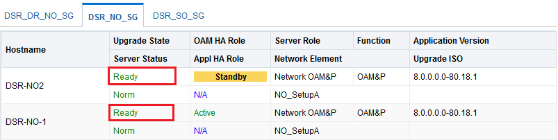

  14. In the NOAM VIP GUI, check the Upgrade Acceptance status on all servers. Expand the Administration option, navigate to Software Management, and click Upgrade. Verify if the Upgrade State column does not show ACCEPT or REJECT.
    Upgrade must be accepted on all servers before activating DCA.
    Figure 12-10 Upgrade
    Upgrade
    Upgrade State should be Ready. If the Upgrade State is ACCEPT or REJECT, follow the procedure documented in DSR C-Class Software Installation and Configuration guide or DSR Software Upgrade Guide (as applicable) to accept the upgrade on all servers before activating DCA.
