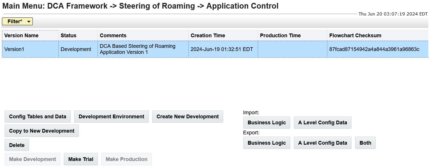

- From the Main Menu, navigate to DCA Framework, and Steering of Roaming, and then Application Control. Ensure that an entry is added in DCA application version details table.
- Select the required Steering of Roaming version name.
- Click A Level Config Data in the
Export section of the Application
Control page.
Figure 2-1 Application Control Page

- From the NOAM GUI Main Menu, navigate to DCA Framework, and Steering of Roaming, and then Application Control.
- Click A Level Config Data in the Import section of the Application Control page, select the file, and then click Import to import the NOAM configuration data.
