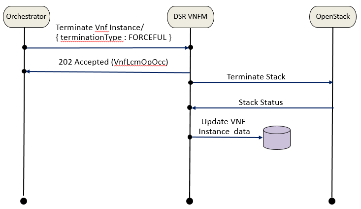

15.1 Forceful Termination
If the VNF is still in service, requesting forceful termination can adversely impact the network service.Figure 15-1 Forceful Termination
Terminating DSR and SDS VNF Instance Forcefully
Sample Request:
Request URL:
POST:
https://<<VNFM HOST IP>>:8443/vnflcm/v1/vnf_instances/< VNF ID
received from create request>/terminate
Accept:
application/json
Content-Type:
application/json
X-Token: Token
generated after login
"terminationType": "FORCEFUL"
Sample Response
Response Code: 202
location: https://localhost:8443/vnflcm/v1/vnf_lcm_op_occs/lcmOp-fb21f9d3-43ad-46cd-a03f-7220bb36a5c6
date: Tue, 29 Jan 2019 10:39:24 GMT
content-length: 0 content-type:
application/xml

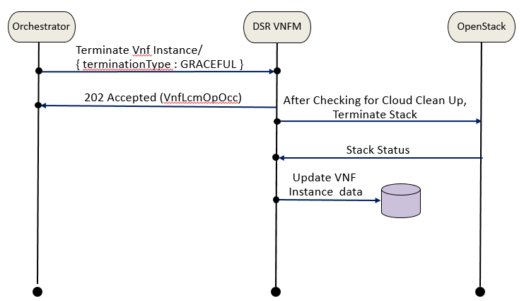

15.2 Graceful Termination
The VNFM first validates if the VNF configuration is cleaned up after accepting the request. Once that configuration is cleaned, the VNFM deletes the VNF. Then the instance file is updated with VNF Operational State set to STOPPED.
If AppWorks configurations are not cleaned manually and the orchestrator tries to do graceful termination for that VNF, then the termination of VNF fails.
User must manually cleanup the AppWorks configurations before doing Graceful Termination.Steps for cleaning up the AppWorks Configuration for Signaling Stack of DSR and SDS:
- Open corresponding Active NOAM GUI of the Signaling instance.
- In Status & Manage Tab, under HA, edit the Max Allowed HA Role of instances of the Signaling stack as OOS.
- In Configuration Tab, under Server Groups, edit the corresponding server groups of the instances and uncheck SG Inclusion for the Server, and press OK. After this step, the excluded Servers must disappear in Status & Manage -> Server section.
- Finally, go to
Configuration ->
Servers section, select the servers that needs to be deleted and click
Delete.
For DSR / SDS Signaling VNF clean up, the user must perform the above steps twice, first for C-level servers and then repeat the steps for B-level servers.
Figure 15-2 Graceful Termination
Terminating DSR and SDS VNF Instance Gracefully
Sample Request:
Request URL:
POST:
Accept:
application/json
Content-Type:
application/json
X-Token: Token
"terminationType": "GRACEFUL"
Sample Response
Response Code : 202
application/xml
