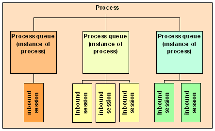

Inbound process structure: Underneath each inbound process at the Work with Integration Layer Process Screen are one or more process queues. Multiple process queues are useful for inbound messages, so that you can receive and process messages from more than one remote system. For example, you might receive inventory transactions from both a warehouse management system and a POS system.
When there are multiple process queues, each queue is an instance of the Inbound program for the process; however, each queue should have a unique Inbound job name so that you can identify and troubleshoot each process separately.
The # inbound sessions for each process queue can be one or more. For example, you might set the number of inbound sessions higher for the process queue that processes orders from your web storefront, to prevent delays; however, you might require only one inbound session for orders you receive from a remote order entry service, because you receive these orders at a scheduled time, and an immediate response is not required.
Inbound process example:

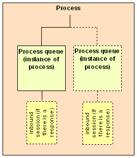

Outbound process structure: Underneath each outbound process at the Work with Integration Layer Process Screen are one or more outbound queues. Multiple outbound queues allow you to send outbound messages to more than one remote system. For example, you might send item information to your POS system and warehouse management system. If you define more than one outbound queue, the system creates a copy of the outbound message for each additional queue whose Enabled field is selected.
An outbound process requires an inbound session only when a response from the remote system is expected.

Work with Integration Layer Process Queues Screen
Purpose: Use this screen to work with the process queues that run for each process displayed at the Work with Integration Layer Process Screen. Inbound processes might have multiple process queues if you receive messages from multiple remote systems; similarly, outbound processes might have multiple process queues if you broadcast messages to multiple remote systems. See Process Overview for more information on how processes relate to process queues.
It is not necessary to set up queues for a process that uses an external web service (Type at the Work with Integration Layer Process Queues Screen = WS).
Note:            You cannot create multiple process queues for the CC_TOKEN, CCAUTH_BTH, CCAUTH_ONL, DEPOSITS, SVC_OUT (not currently used), SVC_BALANC, SVC_REVRSL, MERCH_LOC, EMAIL_OUT, or EC_ITEMAVL processes. If you create multiple process queues for any of these processes, the system will only process messages for the queue with a sequence number of 1.
How to display this screen: Select Work with Queues for a process at the Work with Integration Layer Process Screen.

Note:  If this field is unselected for all process queues, you will not be able to start the process.
For outbound processing, the system sends the outbound message to queues only if their Enabled field is selected.

The number of sessions to run under this process queue. You might run multiple sessions for process queues that require an immediate response, such as the process queue that receives new order messages from the web storefront. Multiple sessions are used only for inbound process queues; outbound processes should have this field set to 1 for their process queues.
Note:  If you leave this field blank, you will not be able to start the process queue. If this field is blank for all process queues for a process, you will not be able to start the process.
