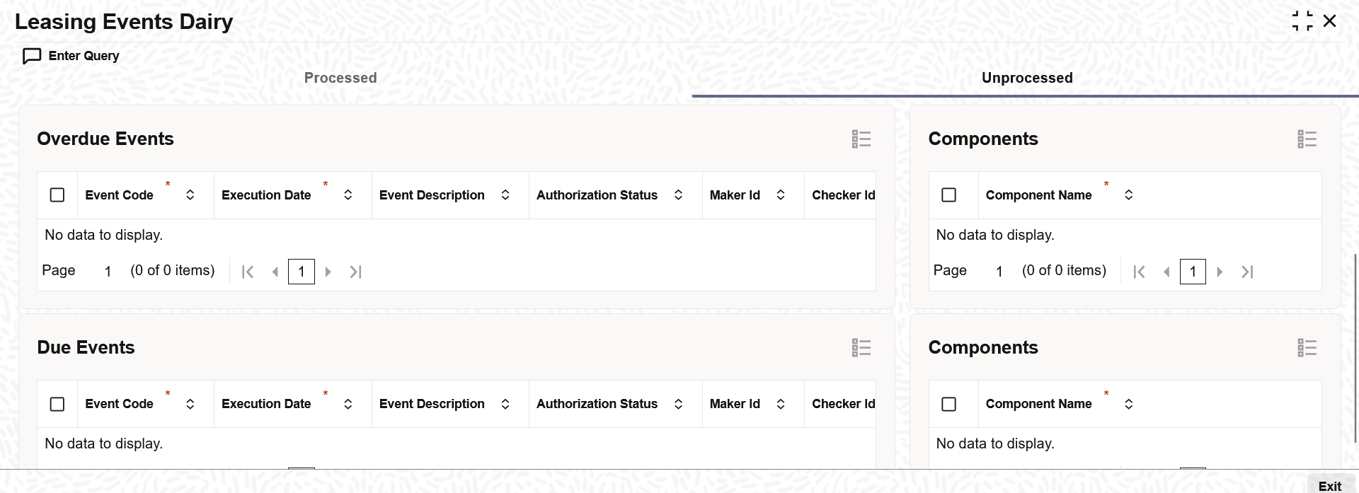

9.1.6 Interest Posting (INTP Event)
You need to make a provision to post an income into a separate GL. This income is the interest which you pay to the customer who has a lease account.  On the interest posting date, a transaction occurs to move the receivable and the income from one GL to another. This transaction distinguishes between receivables from the income which is due and not due. Also, this interest posting is applicable for the main interest component only.
The INTP event runs at the BOD for a lease product against which it has been defined.
The following points are noteworthy:
l You can pick the INTP event during the lease product definition and maintain the accounting entries against this event. To recall, you need to click on the ‘Events’ tab in the ‘Consumer Lending Product’ screen where you specify the various events which need to be run.
l At the time of lease account creation, Oracle FLEXCUBE populates the events diary with one record of the INTP event for each schedule due date. This has the status as ‘Unprocessed’. This is done for the main interest component schedule only.
l The system also creates a record for the end of each calendar quarter during the moratorium period in the case of amortized lease products.
l Any rebuilding of repayment schedules results in the rebuilding of records in the events diary.
l The batch process picks up all the unprocessed INTP records from the events diary having the execution date on or before the current application date. The process is limited to the active accounts belonging to the current branch.
l The amount and date of due for the main interest component is fetched from the component schedule due details.
l The accounting entries get passed on the schedule due date or the calendar quarter end, as defined for the event INTP through the ‘Consumer Lending Product’ screen under the ‘Events’ tab pertaining to a lease product maintenance.
l For term leases, the transaction posting date is the same as schedule due date of the main interest component. The same is followed for amortized leases also.
l For an amortized lease with a moratorium period, the transaction posting date is the end of the calendar quarter and the end of the moratorium period. If the moratorium period is different from the end of the calendar quarter, the entries passed will not tally with the actual amount due. This difference gets passed on the schedule due date of the moratorium period.
l There are no changes in the INTP event execution behaviour in case of a partial pre-payment.
l If a lease is getting pre-closed with a complete settlement, the system does not wait till the schedule due date or calendar quarter end for passing the INTP entries. It posts the interest accrued till the current date on the date of the pre-closure.
l In case of any failures during the INTP batch process, the system logs the error details for the account and processes the subsequent accounts.

9.2.4 Viewing Event  Details
Click ‘Events’ button on the ‘CL User Defined Events Triggering’ screen and invoke the ‘Events Diary’ screen.
9.2.4.1 Unprocessed Tab
Click this tab to view the unprocessed event details.
Refer the section ‘Events Diary’ in the chapter titled ‘Account Creation’ in this User Manual for details about the ‘Events Diary’ screen.
