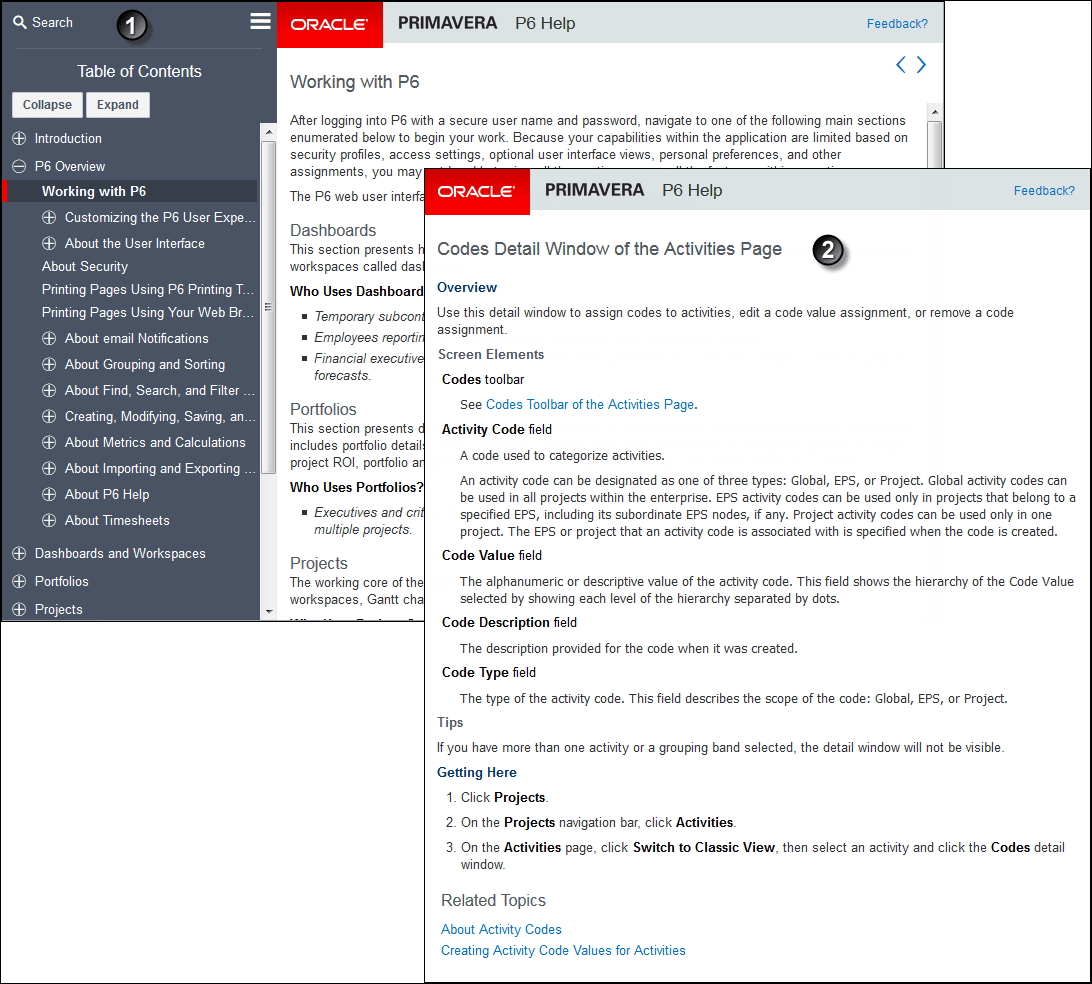

Working with P6 Help Topics
The online help appears in your default web browser whenever you need help using P6.
This illustration is a graphical representation of the text in the following table.
Table of Key Concepts: P6 Help
Item
Description
item one
Key Help Window Elements: The Contents tab presents the table of contents for the help system showing topics arranged by subject. Use the Search tab to find help content by entering your own choice of characters, keywords, or phrases.
The search feature will help you find partial word matches. For example, searching for site will return pages that include site, website, or sitemap. The search uses combination AND logic when you type multiple words or fragments. Only help topics that include all of the words or fragments appear in the results (e.g., word 1 AND word 2).
If the topic is in the table of contents, click Previous Topic to view the previous help topic in the order shown in the table of contents. Click Next Topic to view the next help topic in the order shown in the table of contents. After a search, click Contents, if available, to view the topic within the table of contents.
item  two
Key Help Page Elements: Context-sensitive help topics include an overview, details for all screen elements on the actual P6 page, a Getting Here section listing the steps required to navigate to the page, and related topic links. Other types of topics include conceptual topics that tell you about main ideas, conceptual topics that summarize how a feature works often with sample screen images, task topics that take you step-by-step through a procedure, and reference topics that describe icons, fields, and other information. All topics may also include applicable notes, tips, examples, and other information.
