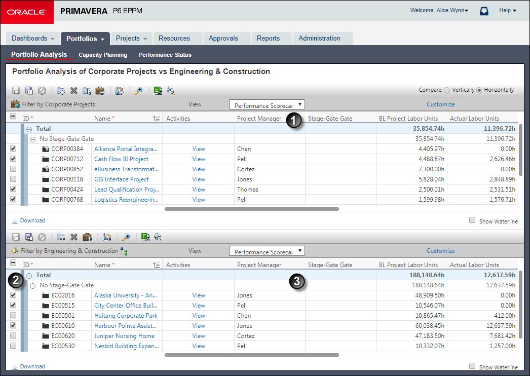

This illustration is a graphical representation of the text in the following table.
Table of Key Scorecard Elements
Item
Description
item one
Scorecard work area: The first scorecard will appear in this upper work area.
item  two
Project Selection options: Select an option to add a project's data to the cumulative Total line.
item  three
Scorecard work area: The second scorecard will appear in this lower work area. In this example, the user has customized the view with a waterline. Use a waterline to analyze a project group by sorting projects into two separate groups based on a defined sorting and constraint limit. Projects above the waterline, displayed with a white background, are those that fall outside the constraint limit value; all other projects, displayed with a light blue background, appear below the waterline.
Note: To support comparative analysis, the Portfolio Analysis work area is divided into two parts. The elements above generally appear within both parts.

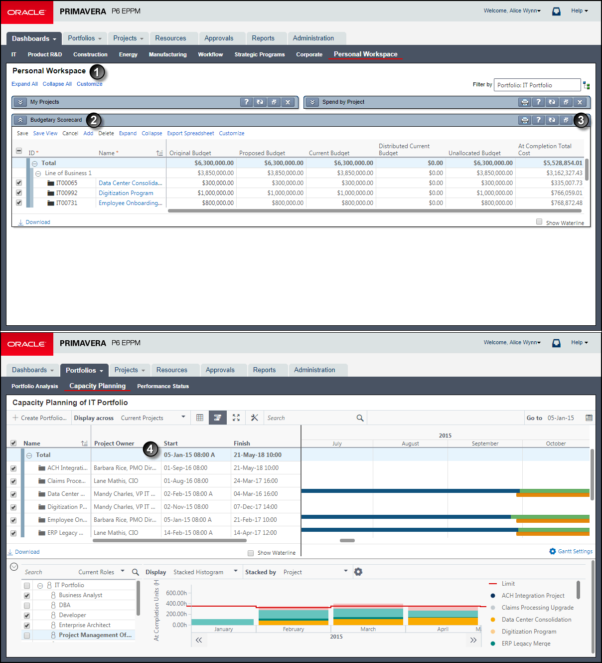

Table of Related Scorecards
Item
Description
item one
Dashboard: The Personal Workspace dashboard. You can show portfolio views on private, multi-user, or global dashboards.
item  two
Scorecard in a portlet: The Budgetary Scorecard displays in a portlet on a dashboard. This example demonstrates a named portfolio view scorecard.
item  three
Click here to maximize or minimize this section icon: Click to maximize and expand the scorecard. Additional command links will appear at the top of this portlet when it is maximized.
item  four
Scorecard on the Capacity Planning page: This example demonstrates a general table format also referred to as a scorecard; however, this is not a named portfolio view scorecard.
