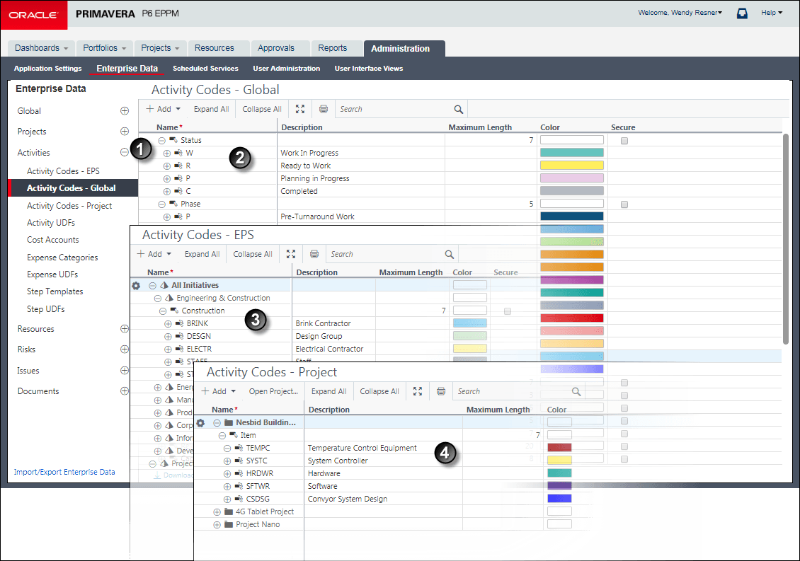

| Navigation Controls: Expand Activities and select Activity Codes - EPS, Activity Codes - Global, or Activity Codes - Project in the Enterprise Data pane to configure activity codes. |
| Activity Codes - Global page: In this example, Phase is a global activity code. Like all activity codes, each of its values contains a short code Name, Description, and Color. For example, INSTL is the Installation Phase activity code value for the Phase activity code. |
| Activity Codes - EPS page: In this example, Construction is an EPS activity code. DESGN is the Design Group activity code value. |
| Activity Codes - Project page: This tab displays a third set of activity codes arranged by project for use only within that project. |

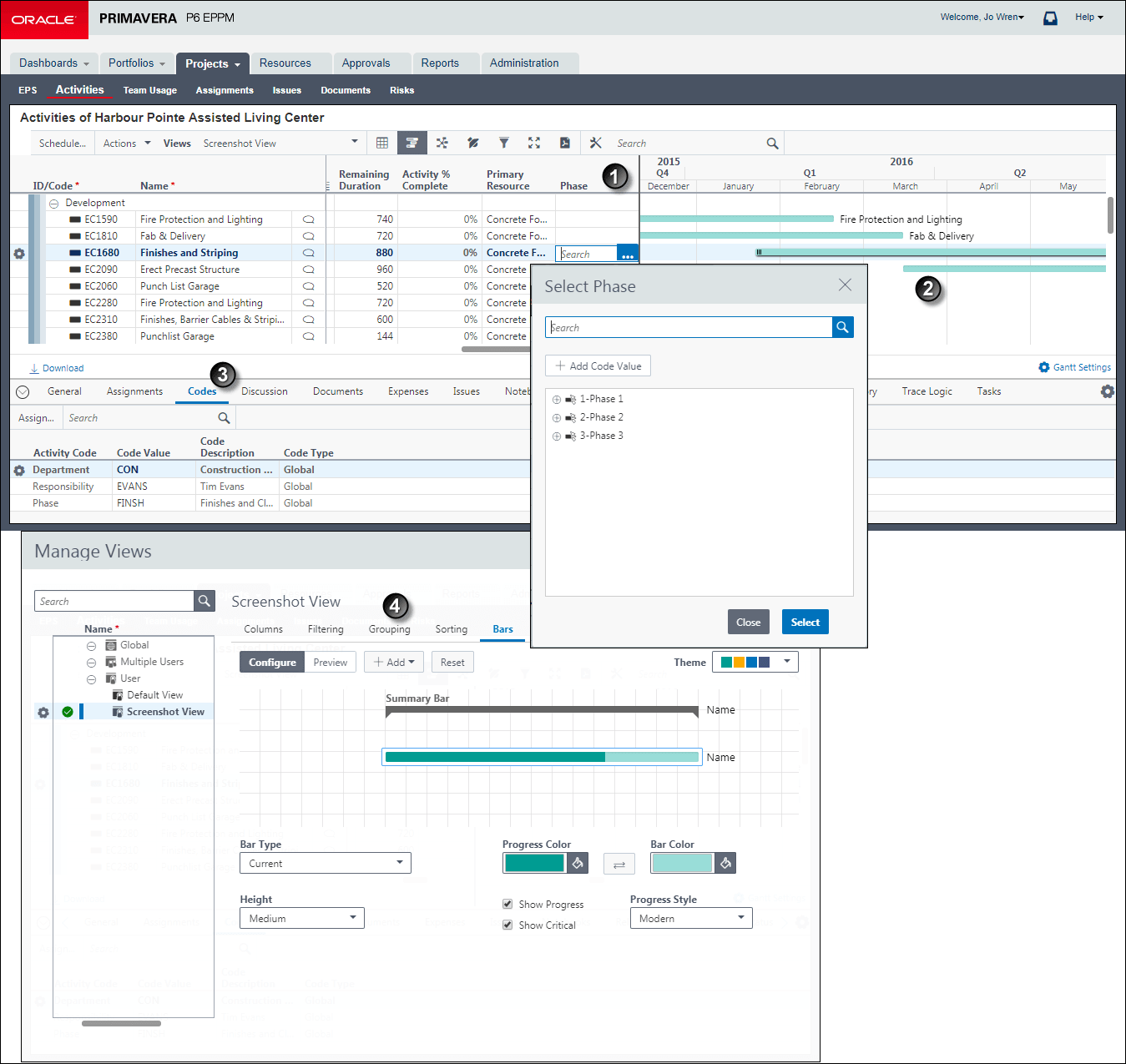

| Phase activity code field: In this example, the user has added the Phase activity code field to the columns in the table and has assigned the STRUC - Structural Phase code value to the selected activity. |
| Activity Gantt chart: The color of the bars can be configured to display the corresponding colors of the assigned activity code. |
| Codes detail window: Use this detail window to assign global, EPS, or project activity codes to the currently selected activity. |
| Bars tab of the Customize Activity View dialog box: In this example, the Phase activity code will determine the color of the bar in the Gantt chart. |
