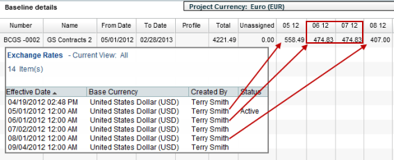

In the Baseline details example that follows, you can see differences in values due to future exchange rate conversions.
- The transaction currency is INR.
- The project currency is EUR.
- The distribution is linear.
- The distributed values are 37,000 INR per time period.
- May and June rates take effect on the first of the month, respectively.
- A July future exchange rate takes effect in Unifier on 07/02/2012, so the system continues to display the value of the June rate in the cash flow.
- The August rate shows up in the cash flow curve on 08/01/2012.
