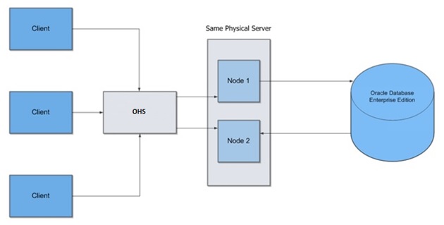

Vertical clustering
In cases where you observe that the application transaction response times are degraded due to increased usage, if the hardware resources of the server (Memory and CPU) have enough head room, you can implement vertical clustering by adding two, or more, server nodes of the application on the same physical server.
The following figure shows vertical clustering.
