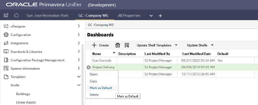

Administrators can set a default dashboard within shell templates. A shell template can have only one default dashboard.

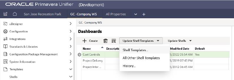

This image displays the default column of the Dashboards log.
There is a column titled "Default" set to "Yes" for the dashboard that was the default prior to this upgrade.
A default dashboard can be pushed to some or all shells using Update Shell Templates.
