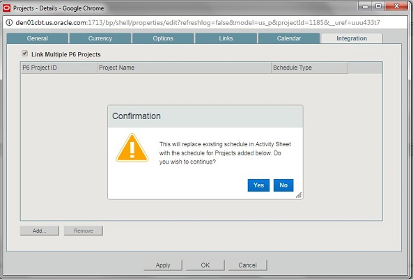

- The Summary sheet Integration will not work when you enable link to multiple projects in the Integration tab of a shell.
- All existing Activities data, and corresponding Audit log data, will be deleted when you enable link to multiple projects in Integration tab of a shell.
- When the P6 project id is added in General tab of a Shell Details (which is already added in another Shell Integration tab), priority is given to the shell in which the p6 project id added in Integration tab on running Get Data from any of the shells.
