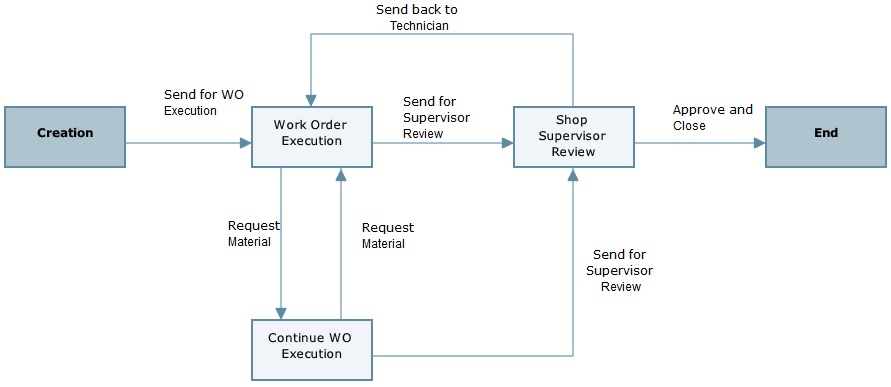

Preventive Work Orders (PWO) BP - Workflow
This is an image of the business process workflow.
