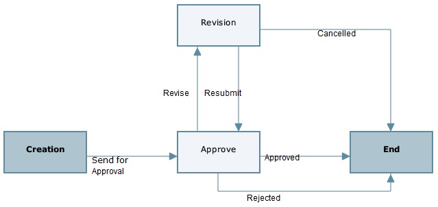

Property Taxes BP - Workflow
This is an image of the business process workflow.
Record Statuses
