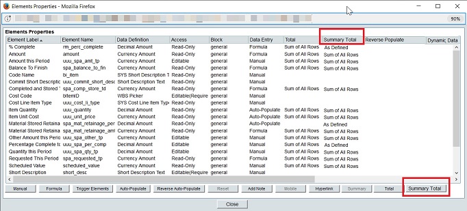

If you add a DE "refid" that has been configured to point to a Base Commit BP of SOV type Summary Payment Applications to the Upper Forms of a Cost-type BP (sub-type: Line Items with CBS Code and classification: Payment Applications), the Elements Properties window (of the Detail Form) displays these additional elements:
- Summary Total column (appearing after the 'Total' column, highlighted on the image below)
- Summary Total option (at the bottom of the window, highlighted on the image below)
Note: The Summary Total option is only available to define the Summary Total calculation for the Payment Applications of SOV Type = Summary Payment Applications. This option is not available for Payment Applications Business Process (BP) or any other BP types. Also, if the DE "refid" has not been configured to point to the Upper Forms, or it has not been configured to point to some other type of BP, the Summary Total option will not be available.
