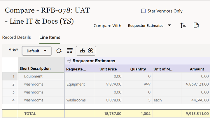

For the Request for Bid (RFB) business process, Unifier includes a bid tabulation feature. This feature provides a default comparison sheet with which users can compare the bids they receive from vendors.
The default bid comparison sheet (shown above) shows only the bid dollar amounts for each line item for which the vendor submitted a bid.
