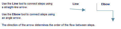

You can link steps using two types of connectors:
Connecting the Steps
The Create step can have only one outgoing line; the End step can have multiple incoming lines, but only one incoming line from any single step.
To connect the steps:
- Click the Line or Elbow tool.
- Hover over the step until you see a border of red x's. These points (x's) indicate where you can attach a connector line.
- Click the step and hold, and then drag the arrow to the next step. When you see a red border of x's, release the mouse.
- Continue to add lines until you have connected all the steps in the workflow.

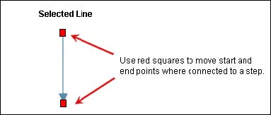

To modify a line:
- Click the Select tool, and then click the line you want to modify.
- Click and hold the red squares to move the start and end points of the line.

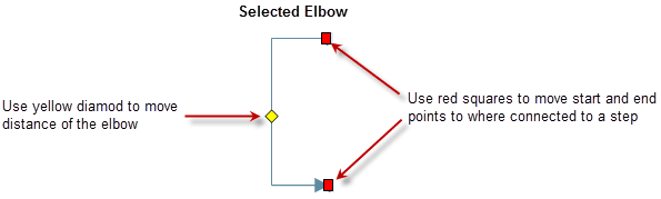

To modify an elbow:
- Click the Select tool, and then click the elbow you want to modify.
- Click and hold the yellow diamond to expand the distance of the elbow, or click the red square to move the start and end points connected to the step.

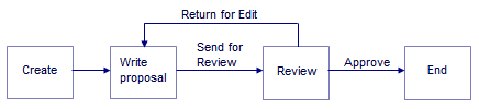

Specifying Each Link's Action
Each link between steps denotes the progression of the business process through the workflow.
The action the link takes (Approve, Return for Edit, and so on) appears in Unifier as a choice the user makes on the business process form. This choice moves the task to the next step.

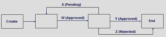

Here are the rules that govern terminal statuses:
- The status of any link leading to an end step must be a terminal status. When you choose the statuses for these links, uDesigner will display only those statuses that have been specified as terminal.
- If a step's inbound action has a terminal status, all outbound actions from that step must have the same terminal status.
- A terminal status creates a permanent record that populates each BP log, line item, or asset with all the information that was generated during the workflow (or step, if it uses a terminal status), including the forms, documents, comments, and other data that was collected during runtime.
- For this reason, once a record, line item, or asset reaches a terminal status, that status cannot change.
- Statuses assigned to links Y and Z must be terminal; they reach the end step.
- If link W has a terminal status (Approved) and link X has a non-terminal status (Pending), the workflow will produce an error because the status of the step changed from a terminal to a non-terminal status.
- Likewise, if link W has a terminal status (Approved) and link Z has a terminal status (Rejected), the workflow will produce an error because the record changed from terminal status Approved to terminal status Rejected.
