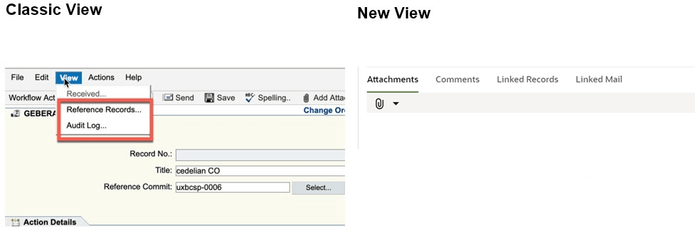

In a workflow business process, at any given step of a business process record, only those options (both tabs and menu) that are applicable to the given step will be displayed. For example, in the Classic View the Reference Records and Audit Log options were seen in the creation stage (although not applicable to the creation step). In the Standard View, these options are not displayed, as shown below:
Reference Records and Audit Log Become Hidden

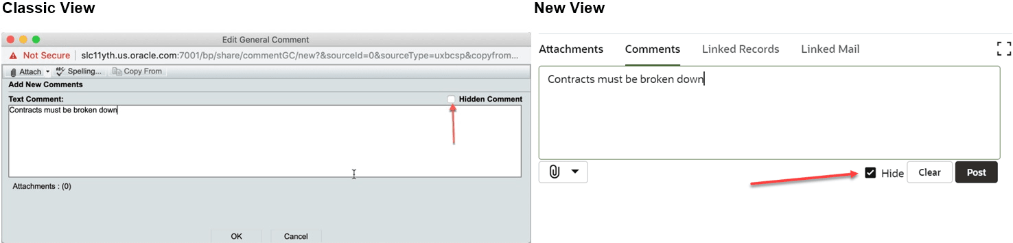

In the Standard View of both the workflow and non-workflow business processes, when you add a comment, by default the check box of Hide is selected, as shown below. This means that a comment is hidden by default and if you want your comment to be viewed by everyone, you must deselect this option.
Hidden Comment Becomes Hide

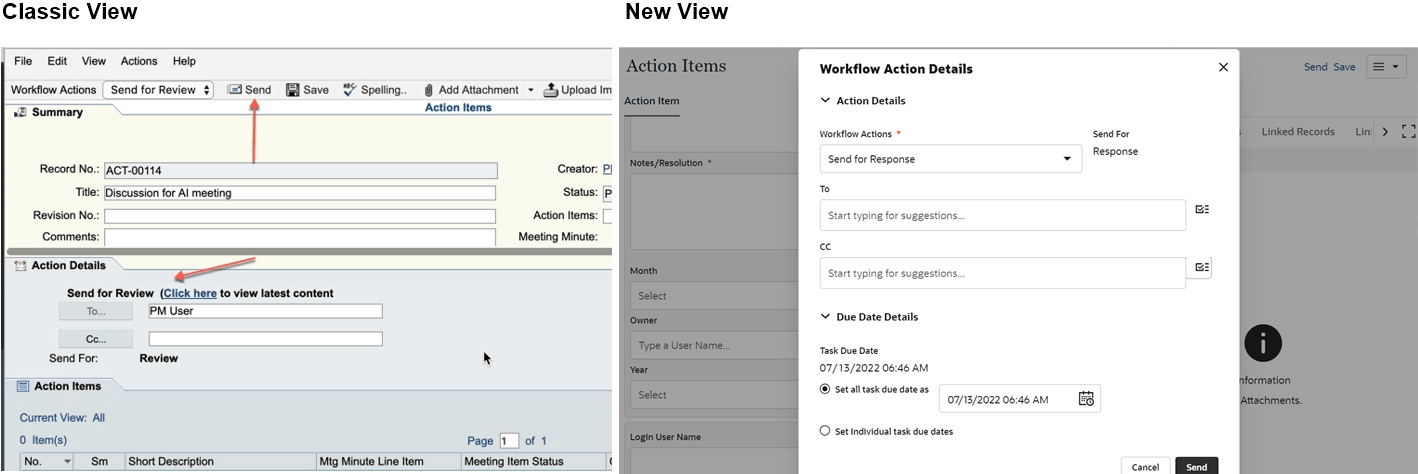

In the Standard View, the workflow details are displayed after you click Send. When the workflow details are displayed, the data validations, filtering of assignees (if applicable), and so forth, have already been completed.
Send Shows Workflow Details

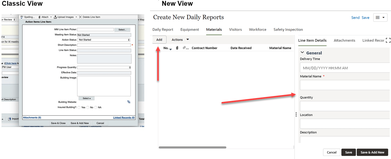

In the Standard View, the line item forms are no longer displayed as pop-ups. Instead, the line item detail form (Line Items Details) opens on the right-side of the line item list, as shown below:
Line Item Forms Open on Right Side of Line Item List

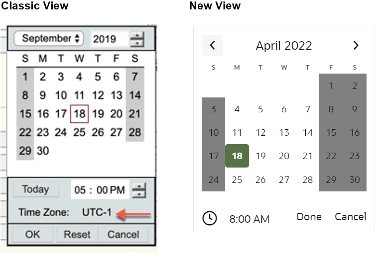

In the Standard View, the Date Picker controls will not have the Time Zone information, as shown below:
Date Picker Has No Time Zone Information

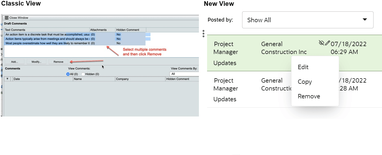

In the Standard View, you cannot delete multiple draft comments (from the Comments tab), as shown below:
Multiple Draft Comments Cannot Be Deleted

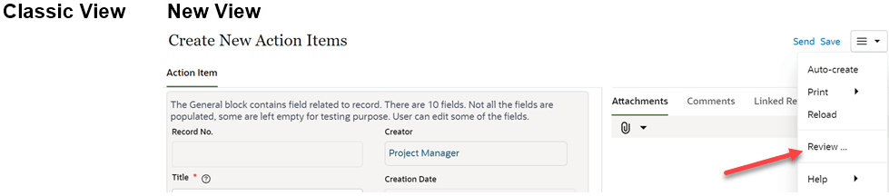

In the Standard View, the Document Review option is present at the time of creating the record, unlike Classic View where the option is seen only after creating the record, as shown below:
Document Review Option Present When Creating The Record

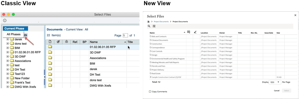

In the Standard View, the document management picker (displayed when adding attachments from Unifier Document Manager) does not show phase selection, as shown below:
No Phase Selection Of Document Management Picker

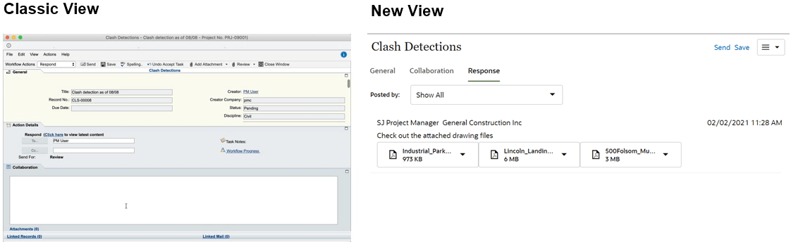

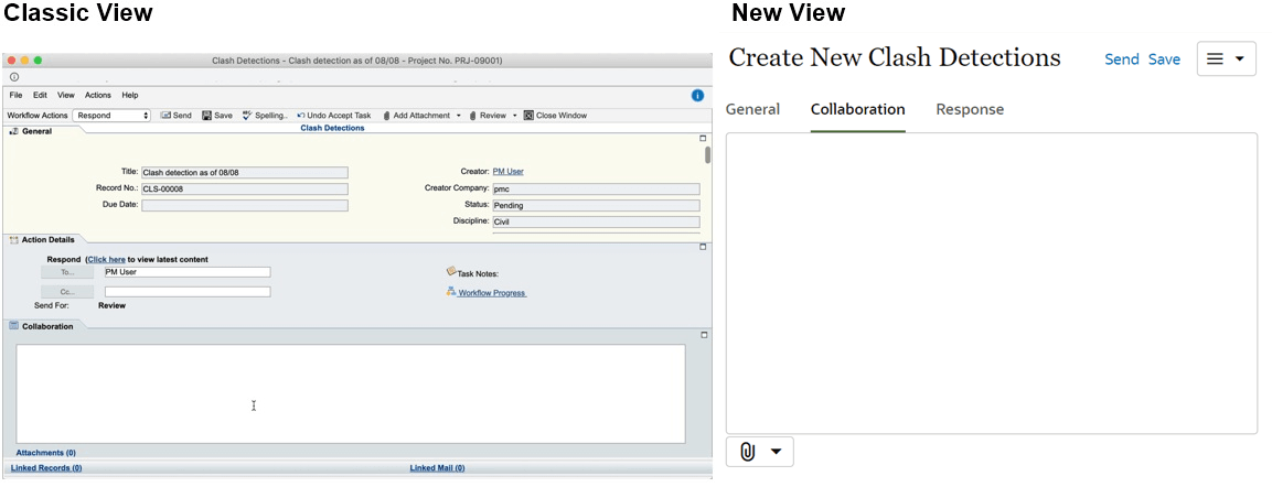

In the Standard View, for the Text-type business process, the way the comments are added and displayed has changed, as shown below:
Comments In Text-Type Business Processes Have Changed
Standard View, for the Text-type business process, you can view previous comments in the Response tab, as shown below:
Previous Comments In Response Tab

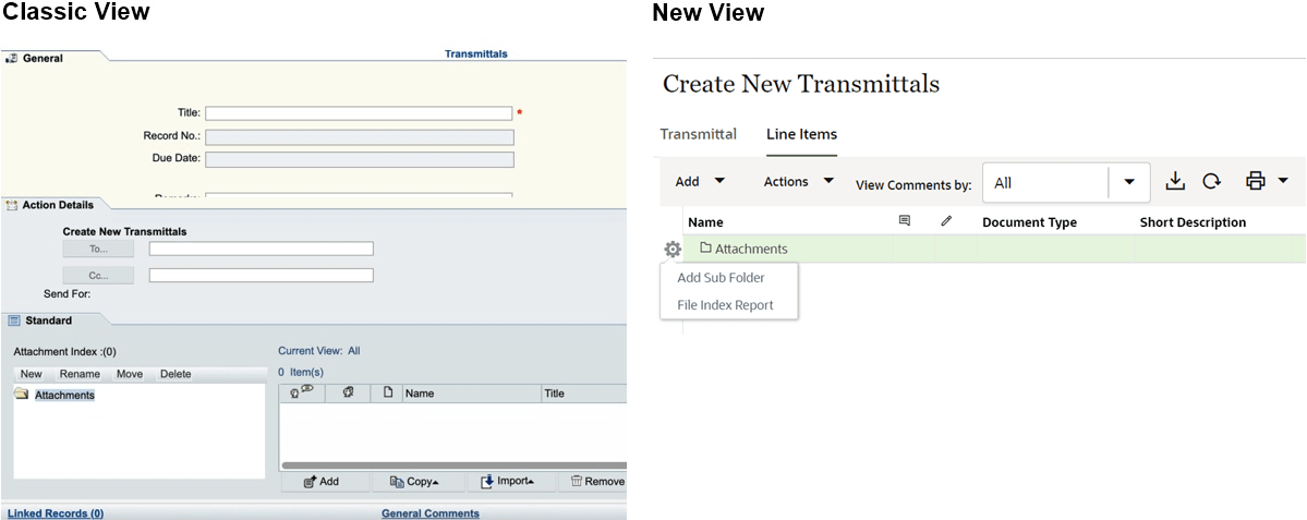

In the Standard View, for the Document-type business process, the steps to create folders and line items have changed, as shown below:
Creating Folders And Line Items Have Changed

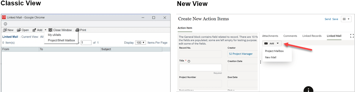

In the Standard View, in the Linked Mail tab, the Add drop-down list includes the options:
See below for details:
Add Drop-Down List in Linked Mail Has Mailbox And New Mail

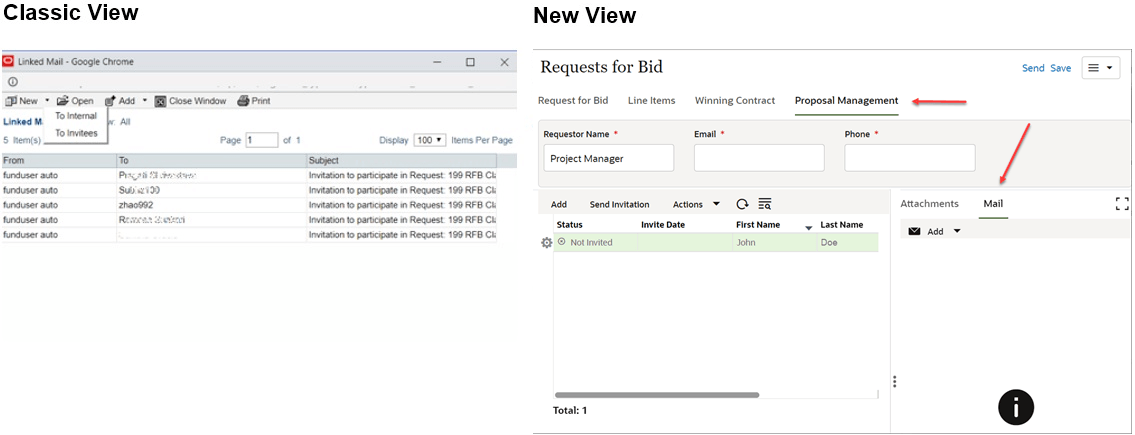

In the Standard View, in the Linked Mail tab of the RFB-type (Request for Bid) business process, you can send emails to Unifier users and bid invitees in the Proposal Management tab. The right pane has the Mail tab, which is used to send mail to users. The option to send mail to bid invitees is located in the gear menu ( ).
Note: In the Classic view, you used the New menu option to send emails to users and bid invitees.
Send E-mails To Users and Bid Invitees Through Linked Mail

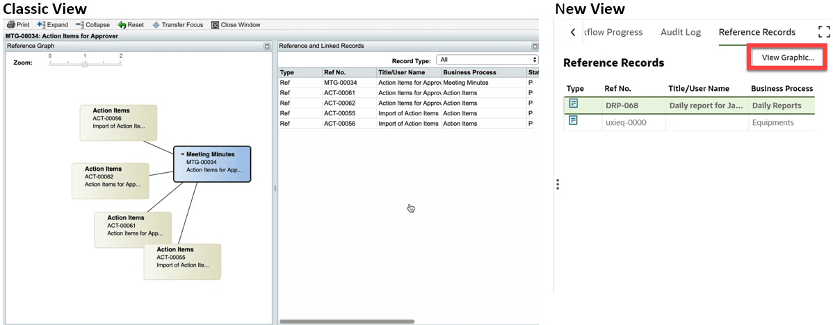

In the Standard View of both the workflow and non-workflow business processes, the graphical diagram and the list view (while viewing of reference records in the Reference Records tab) have been enhanced, as shown:
Graphical Diagram And List View Have Changed
